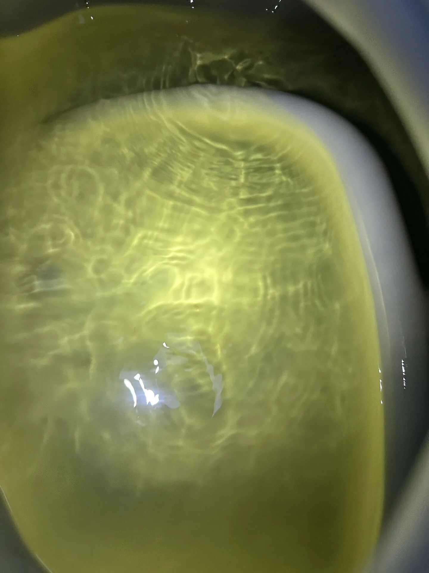

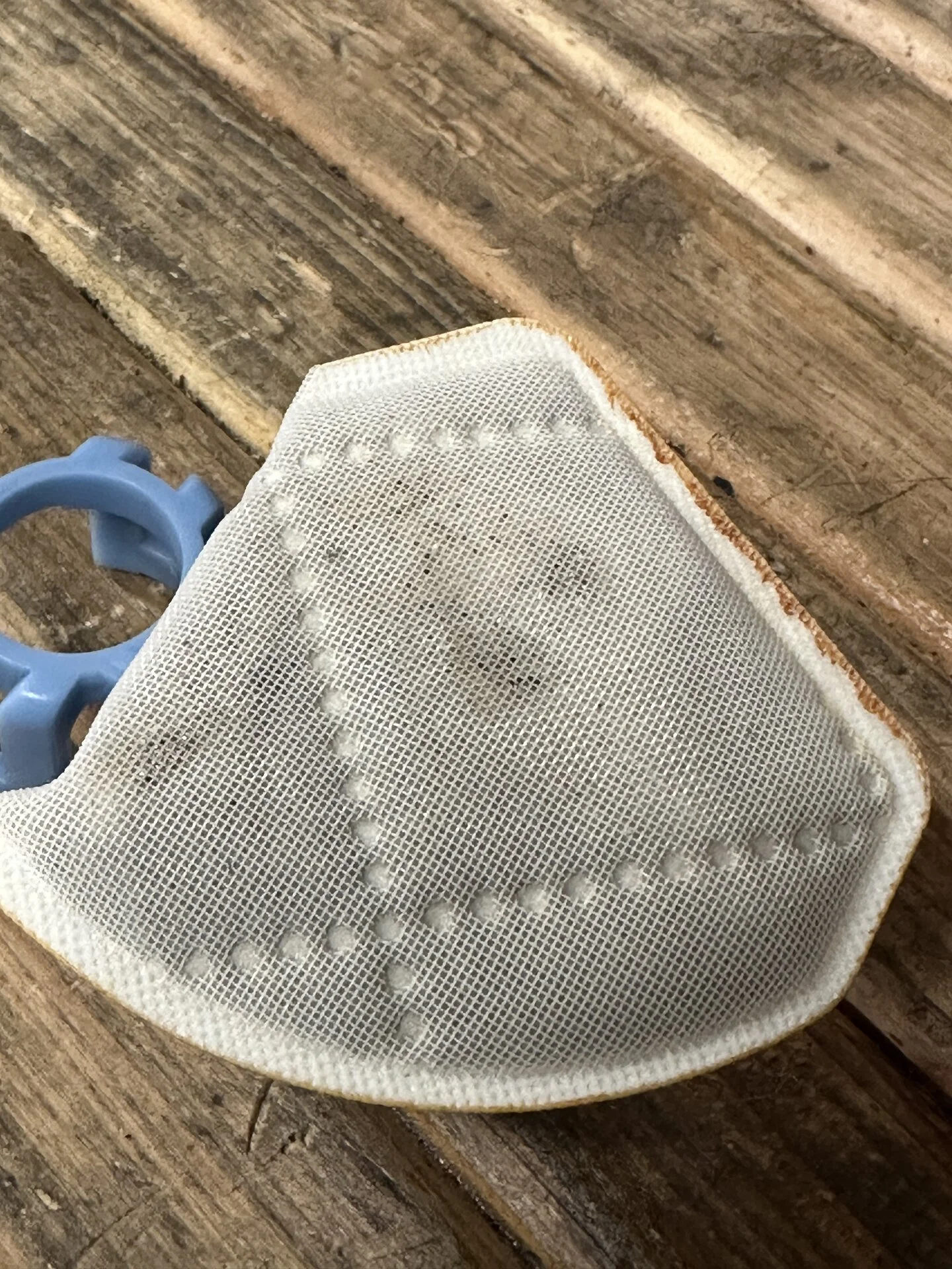

I'm throwing my rig a bit of a 200k mile birthday party, and as part of that I dropped the tank and installed a new fuel pump as PM. The logic for this was the few reports of bad fuel pumps (Teckis, others), or fuel pump ECUs (CharlieS, seems like a couple more) which I believed at the time had fuel pump issues contributing.
Many of us were surprised to find that our trucks don't have a real fuel filter. After decades of working on cars of all kinds I took for granted that it was necessary.. and this super-reliable rig not having one never sat right with me. Well, after dropping the tank.. toyota knew what they were doing.. at least with the fuel put into this truck for 100k before I got it, and the 6000+ gallons over 100k miles I've added.
So here's a short thread to share what was inside my tank after double what much of america considers a vehicle too old to own.
TL;DR. As long as we use decent fuel in the US, we don't need a fuel filter.
Yep.. that's it. The inside of the tank was totally debris-free, and the filter sock only had minor grime. I'd run that filter sock for 500k of the same fuel without reservation.
Edit: I can also say after disassembling the fuel pump that in my case it didn't need to be changed. It didn't have the wear that Teckis' did and probably had plenty of life left. Next step is considering tossing in a fuel pump ECU.

Thanks for the pics! Impressively clean, although not surprising to me.
For curiosity sake, do you generally run your tank low every fill up, or do you fill up at 3/8 of a tank (or something more than when the light comes on) just to not ingest the (non existent apparently) trash at the bottom of the tank as some folks recommend?
I run mine down to 1/8 or lower every time to stretch range, and because I don't believe there is much to worry about from running the tank low, as your pictures show.

As it is the inside of the tank has some interesting baffles and channels to direct fuel to the pump module bucket when it is low.. IMO even without the tank being low I believe things resting on the bottom will end up near the pump module anyway, due to natural movement of the vehicle and downstream effects of that movement triggering fuel flow.
One thing is certain.. this is not just a wide open fuel tank with a pump and sock at the bottom. The pump module is quite interesting.. there is a small bleed line off the pressure side that creates a siphon to fill the pump module bucket even if the rest of the tank is very low.. and the fuel in the module is what the pump actually draws from to feed both the rails and the siphon. All of this was impressively clean.

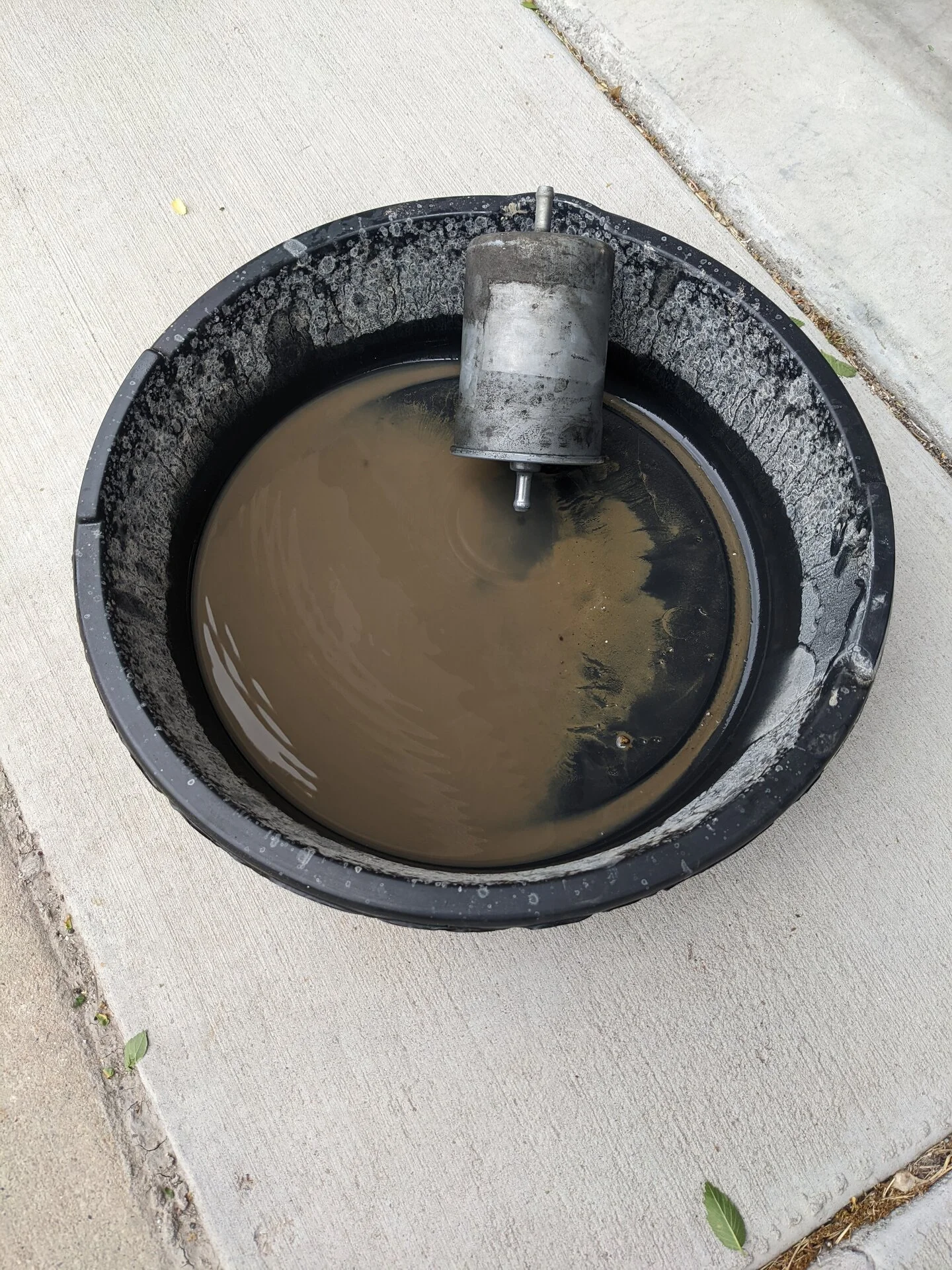

I killed a fuel pump in my 100 with dirty fuel. Loaded up two brand new fuel filters with junk and the pump couldn’t push through.
Also, here’s a picture of my fuel filter from my E34. That drain pan was new when I put the filter in it and let it drain out from the fill port.
As a bit of a counterpoint/devil’s advocate:
