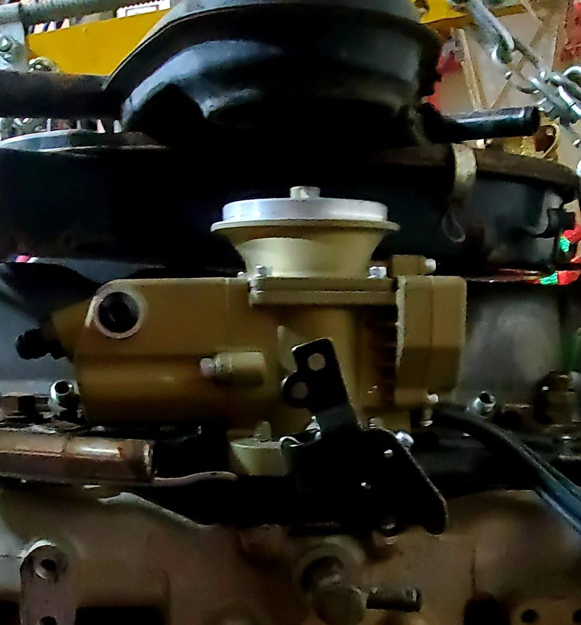

Pulled the engine for a rebuild but wanted to see how the Sniper 2GC would fit and what modifications would be needed.

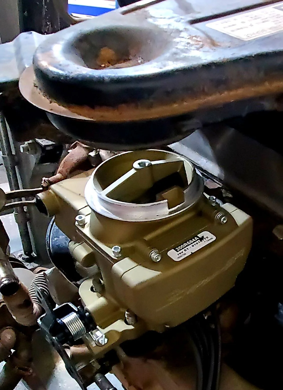

I'm happy to report that I was able to get the 2GC fitted with 10 minutes of time, and a 10mm drill bit.
The only thing remaining to do is a 2" spacer between the heat riser and Sniper unit. Another option would be to add a spacer on top of the Sniper, but I think having it below will help with heat, and air flow.
The stock air cleaner is a perfect match to the opening of the 2GC in both size and alignment of the mounting stud.

I'm assuming this involved drilling new mounting holes in the sniper?
Exactly...
It's about 1.5mm larger.
With the increased size there's still no interference or weakness in the throttle body. And super easy to drill being aluminum.

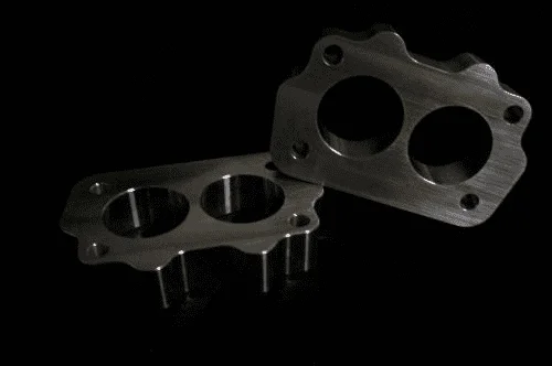

A quick google search yesterday showed aluminum 1" base spacers for the large bore 2GC readily available from the net for very affordable prices, there were even some phenolic ones (heat insulator). That is if I was looking at the right items, I think I was. They have a wider mounting surface to make sure the vacuum passages on the base of the unit are covered well. Then a spacer under the aircleaner, which were also available, in varying thicknesses and this would almost be a bolt on affair. The original phenolic spacer will take care of the heat still.

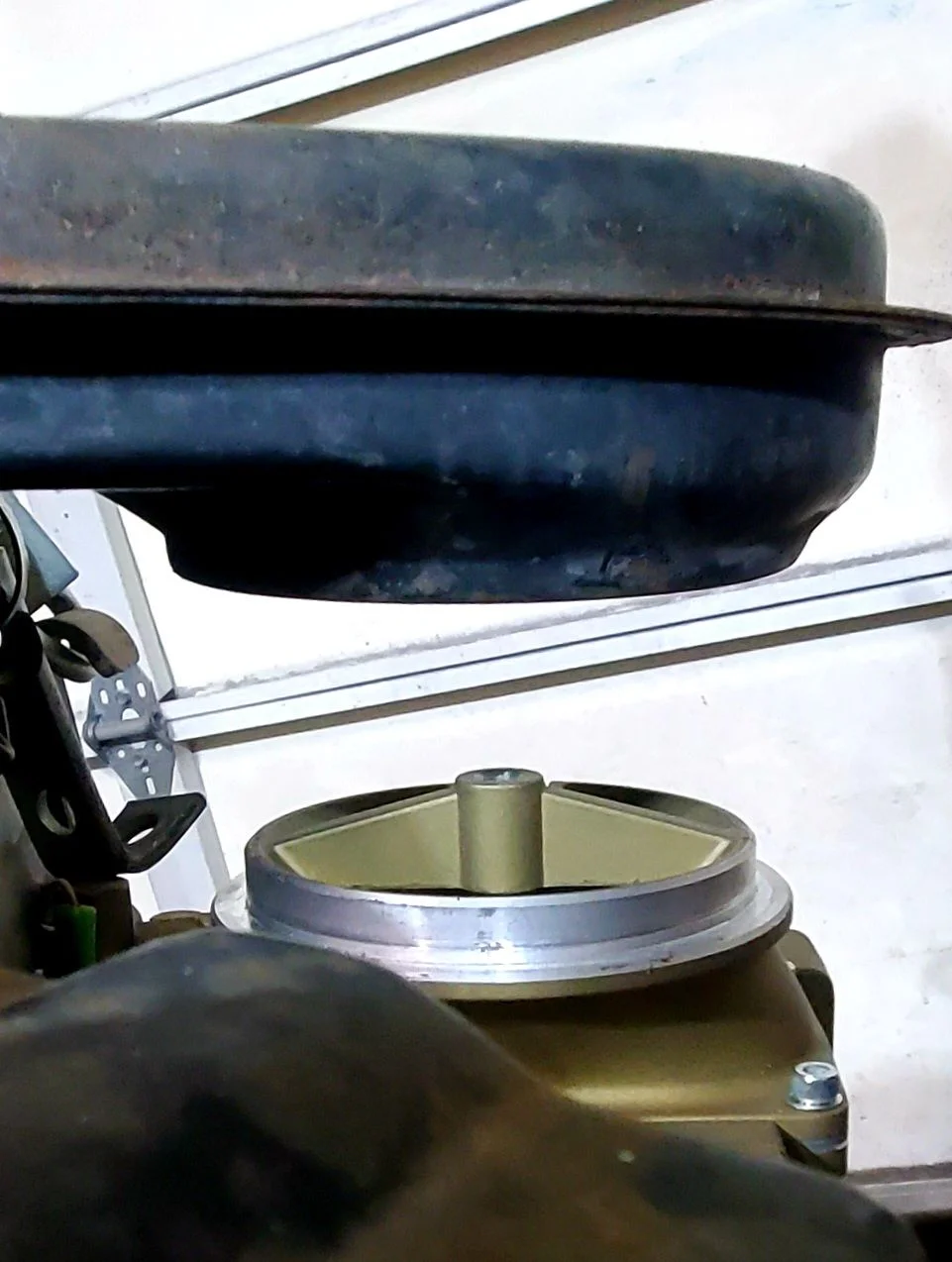

So I tried out a 2 inch tall x 3 inch ID pipe spacer between the aircleaner and Sniper body (ABS just for fitting) and found that it fits like a glove around the throttle body opening, but does not slide inside the aircleaner. So you would need to either machine or sleeve whatever spacer / pipe you were using. Not a big deal, but something to consider.

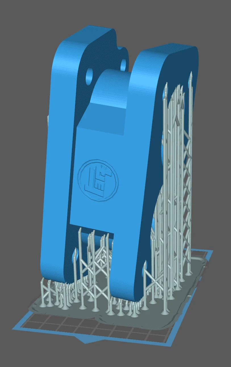

Riser in slicer. 3D Printing a prototype for mocking up and measurements.

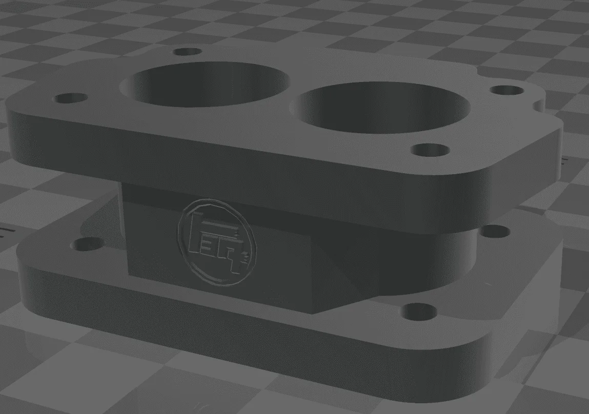

If anyone is interested the mounting holes on a 2F Manifold are 2" x 3.55" The 2GC is 2" x 3.68"
This design will allow a one piece two gasket solution that won't require modifying the Sniper unit.
