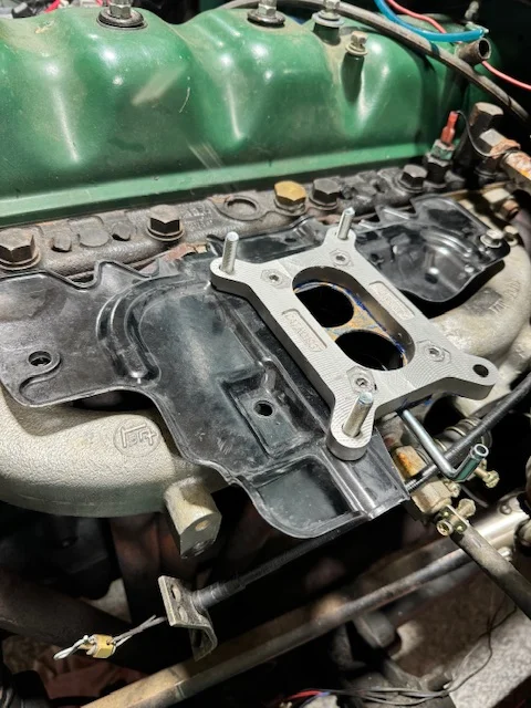

This is the adapter for the 2300
@wngrog suggested sealing the mounting bolts. You can see the rtv if you zoom in

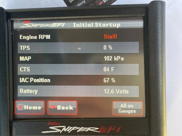

After getting the Large Bore back in place and checking all the connections, it started, ran poorly, began to smoke and I shut it down. Below are the pictures of the handheld at Stall, upon startup at 706 RPM, and as it started to smoke at 574 RPM.
Made no changes outside the wizard. I realize now I had the Large Bore, but the only installation instruction I could find was the Small Bore, and the only selection available to me in the setup was Small Bore. I have never adjusted the idle screw. It only got above 160 degrees a few times, entering Learn mode.
I thought I'd try the handheld sent with the Small Bore. Surprise surprise. The software has been updated in the last year. Now, I get 2GC by the last 3 digits of the model number, so I was clearly able to select the Gold Large Bore model. Didn't seem to make a significant difference. It started, but did not reach the 1,000 RPM as in the past. It ran rough and peaked out near 700 RPM. From there, it was downhill on RPM until it started smoking and I shut it down. Acting on the vacuum, I disconnected the new brake booster, just in case. I didn't have time to look at the vacuum gauge I have mounted on the firewall.
Again, thanks for your interest, and any other advice you might have. There was about four days about 2 months ago where it ran, and ran better each day (Learning), and I was thinking the nightmare was over. Then it started to flood, again. I don't think it's a Lemon. I'm thinking its electric.
That MAP is SOOOOOOOOPER high, like 23-30” hg.
The idle screw will need adjustment to properly run, they aren’t good to go out of the box. I think your IAC is at 100% because it’s trying to compensate for the throttle blades not being open enough (or at all), which also may be why the fuel spray doesn’t look like a spray (not enough vacuum through throat).
I’d start by giving the idle screw 1 full turn and see what that does. You can look down at the throttle blades and see if unscrewing moves them and if not, they are completely closed.
