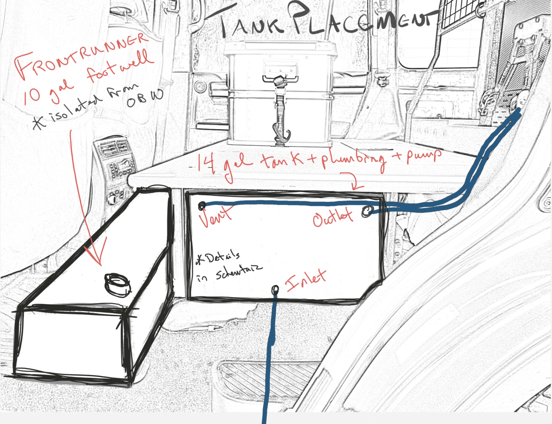

I have a viable "off-the-shelf" option on the OBW tank front, now. I'm still waiting on custom fabrication quotes from a couple places but am not optimistic of anything coming back within my budget for the project. The compromise off-the-shelf option I'm entertaining is to go with two internal tanks. Only one (a 14 gal) would be formally part of the OBW setup. The other (likely the 10 gal Frontrunner footwell tank) would only be included for longer trips and would be isolated from the system.

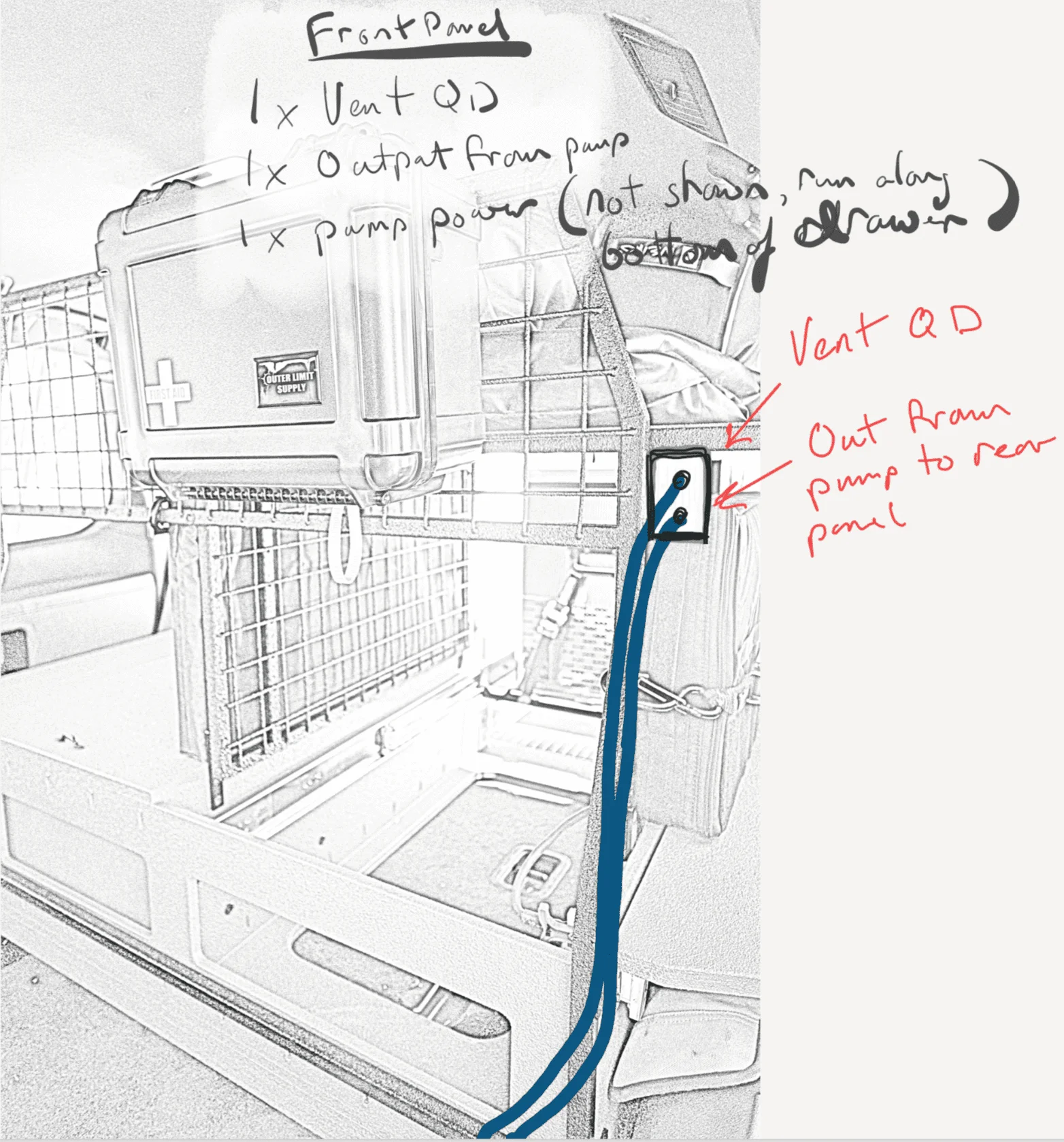

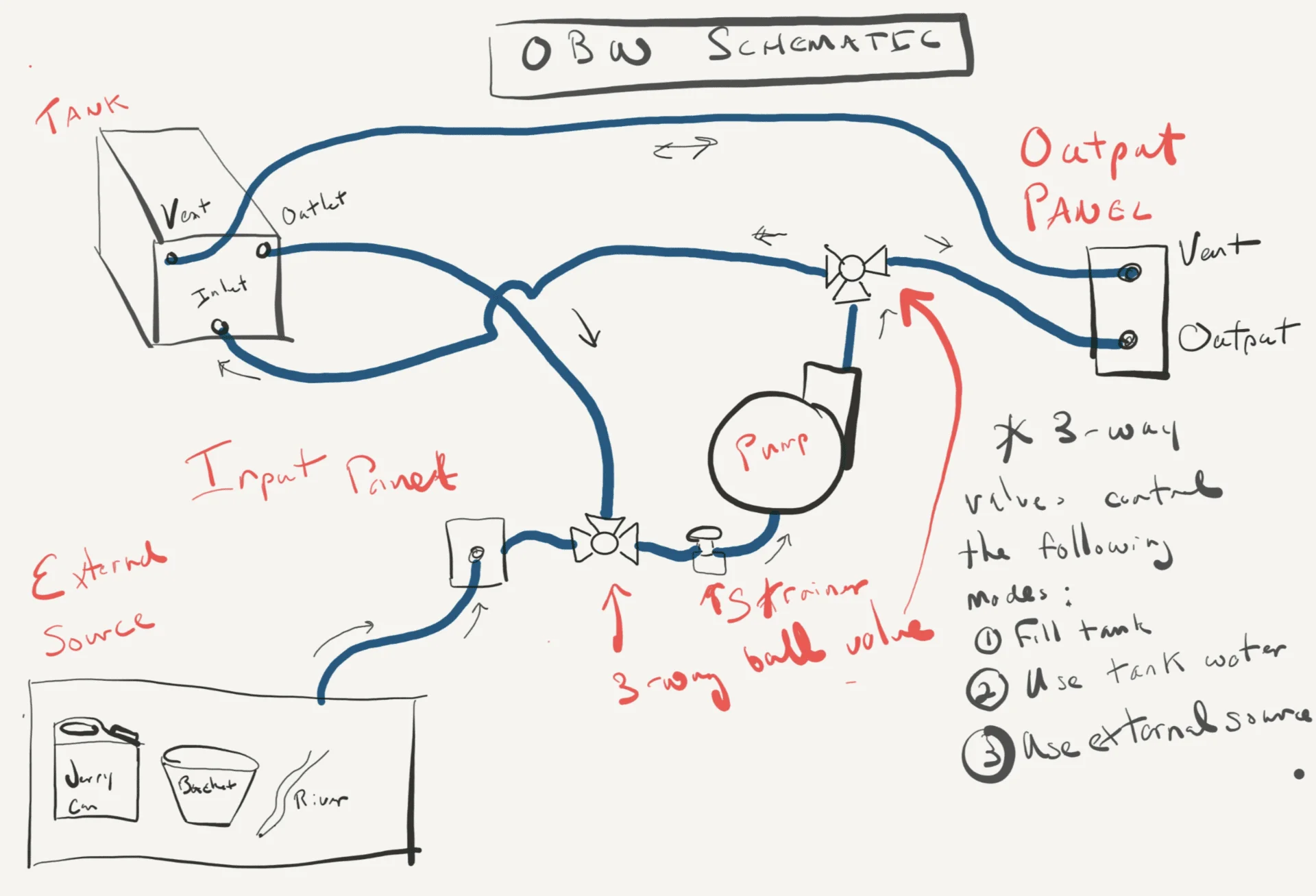

I also made some decent progress on the overall design as well as tracking down the proper fittings. The current design will require some custom brackets that will play well with the Trekboxx though that shouldn't be too much of a bottleneck. I'm mainly struggling to figure out whether to go with brass fittings all around or black poly alloy fittings. I'm also trying to find 3-way poly alloy ball valves.
In lieu of the typical wall of text, here's a plumbing schematic and some concepts where things would go in the truck. You'll note that I'm expecting potable water to always be in this system as I have no affordances for filtering. I do have thoughts on how I'd handle that if/when the time comes but didn't feel like it was a priority for travel in the US/Mexico as potable or bottled water is always available.

If you ever use non-potable water in it for showering (or cooking, if boiled), you can sanitize the tank later. I do it annually in my trailer. I can never remember the ratio but it's a few oz of bleach per 10 gallons of water, pump into any lines, let it sit a few hours, then drain. You can get rid of the bleach taste that remains with a few tbsp of baking soda in your tank with more water, flush the lines with it and drain the rest.
