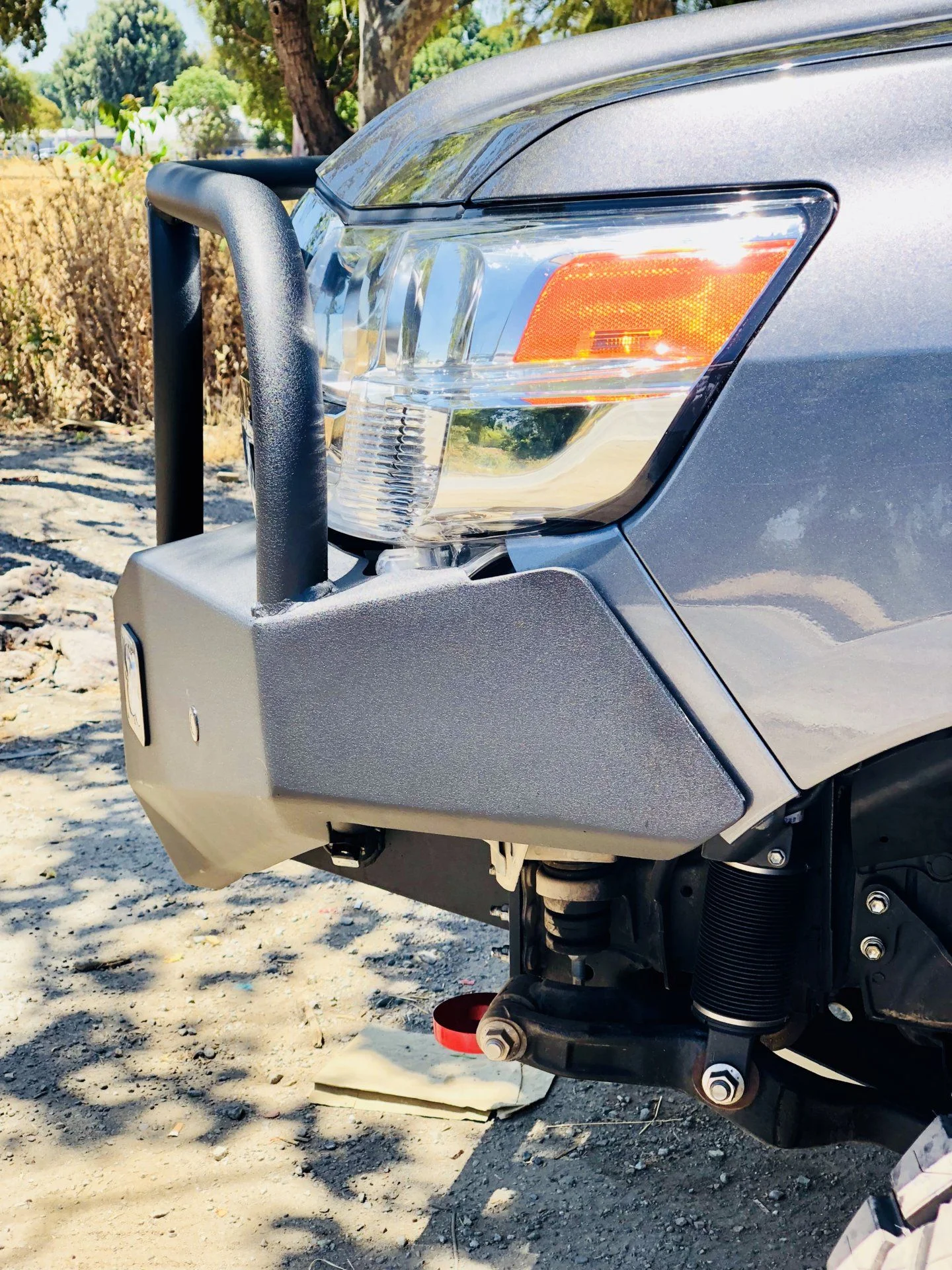

Hidden Winch Mount turned Front Bumper
It's old news now in terms of the build but I ultimately ended up with a full front bumper from Trail Tailor instead of a Hidden Winch Mount. However, my very first communications with Jason were related putting together a state-side hidden winch mount solution for this community. People have had mixed results with the Asfir option and I knew Jason wouldn't do it unless it was it was a complete solution.
After Baja, the truck went back up to Redding for a few weeks of R&D focused on both the hidden winch mount and the 16+ bumper. Well, once I saw the truck modeling the 16+ bumper I decided that I had to go that direction. I loved the idea of added protection in the front, had continued to have issues with 34s rubbing, and wanted a better platform for a light bar than the roof. The integration of Baja Designs lighting solutions sold it for me as I've had nothing but good luck with their lights for many years.
I have zero complaints thus far with the front bumper. Like the rear, it kept the parking sensors. The forward camera still works without a hitch, and the Baja Designs Squadrons wired directly into the factory fog light harness. There's ample room for a winch (I have a Comeup 9.5 in there). The overall design and geometry is both practical and aesthetically pleasing.
In terms of the winch, in hindsight I kind of wish I'd gone with one of the integrated units from Comeup or a Warn Zeon series. The winch controller fit easily enough behind the grill but I'd have preferred to not block any airlow (though I doubt it's blocking enough to be concerned.
