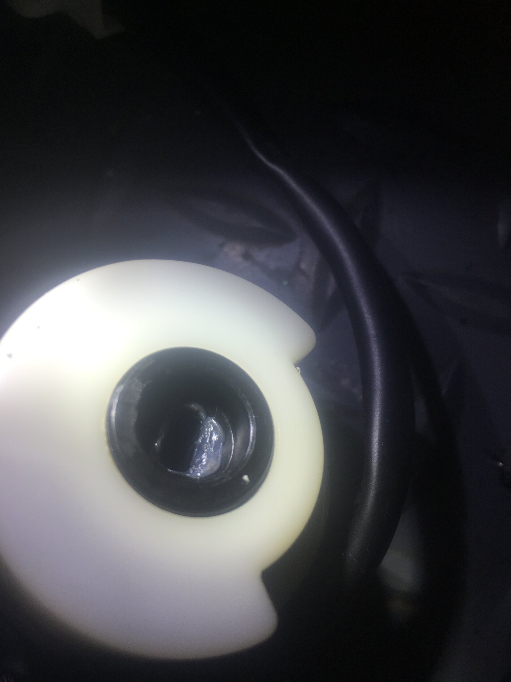

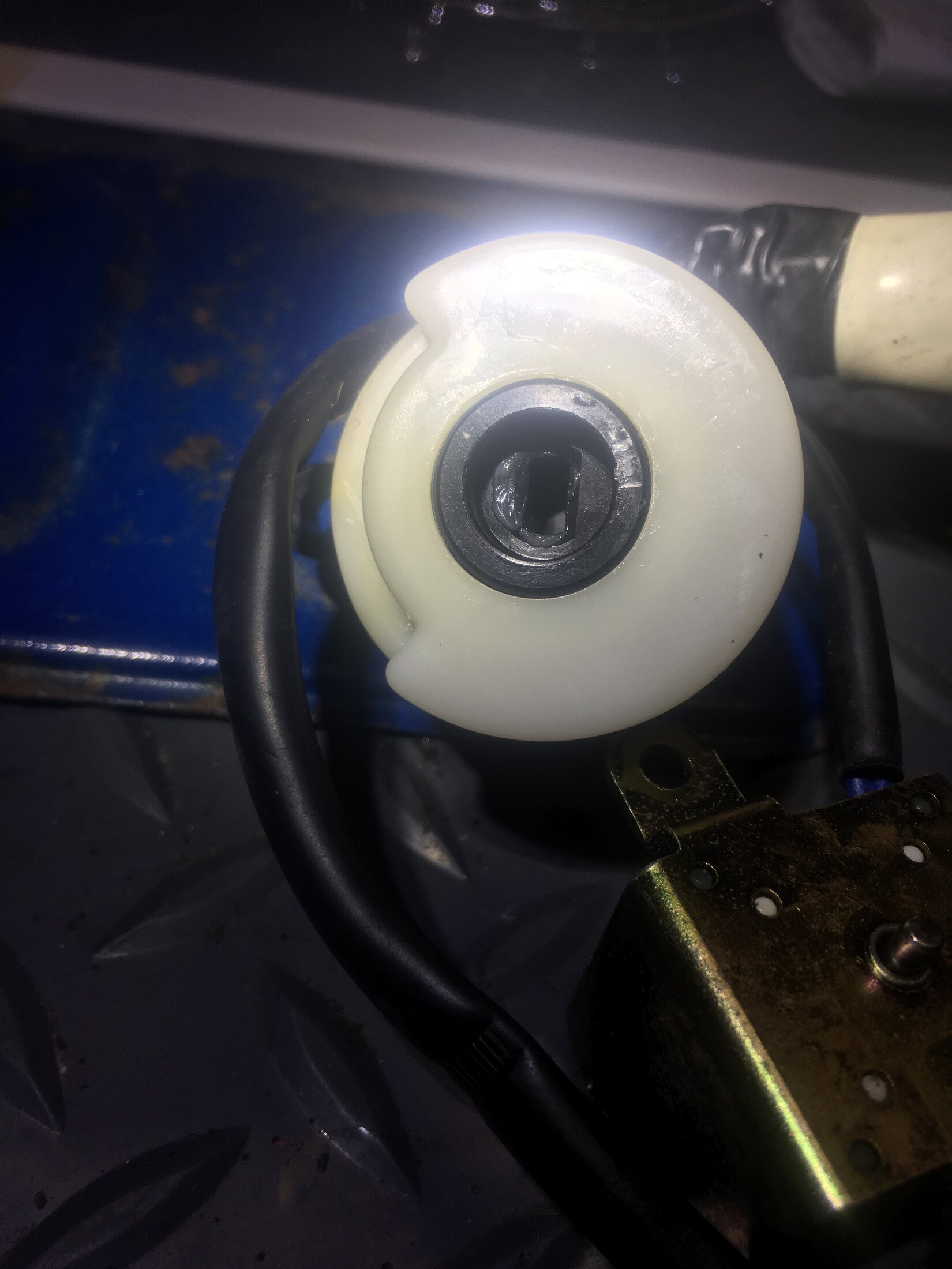

My 97 80 series was giving me occasional but random symptoms of turning the key to nothing at all, no start, no clicks, no power, no noise, just nothing. And no timing or driving history was a culprit; short drive, sometimes it would happen sometimes it would be fine, it could sit over night and fire right up, or nothing. Was seemingly totally random. Solution in the moment would be patience, superstition, and jiggling the key in ignition.
Did a reman starter, with new contacts, did a fusible link, battery and alt tests, chased wiring for awhile. Nothing changed, issue still there.
Finally, about 6 months ago I did the ignition switch. I feel confident now saying that was 100% my issue, and it is totally resolved. OP correct PITA job, knuckle cuts galore, need 3 hands and 7 fingers.
I would like to add a theory below. See pics of removed OEM part. Looks melted, but just severely worn and melded plastic when looking live. But I’m thinking that the times I would get no ignition response was the key turning and rolling over that worn plastic and not setting into the switch properly to engage a turn.
