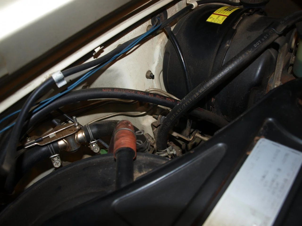

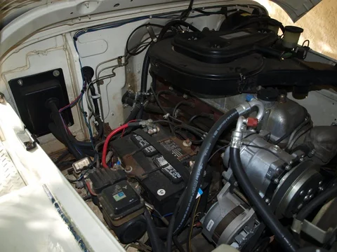

Yours looks to have been desmogged. Whether is was "proper" will take some additional work. Here's some threads to start you off:
https://forum.ih8mud.com/threads/77-fj40-federal-2f-desmog.440852/ - Realize that I have a '78 carburetor with a '79 distributor, but some of the basic info is good.
https://forum.ih8mud.com/threads/77-fj40-2f-desmog-correct-vacuum-routing.809378/
If you need something beside the FSM to get you by for now, the Haynes manual is pretty inexpensive and, from what I've found, pretty good and easy to use for a '77.

You should be able to get 12-15 mpg out of a good running 2F. Remember though that a 2F has more displacement than an F, so in general it might not get quite as "good" of mileage.
