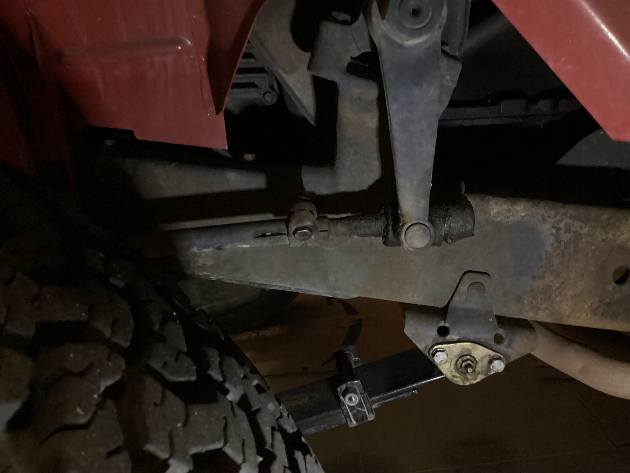

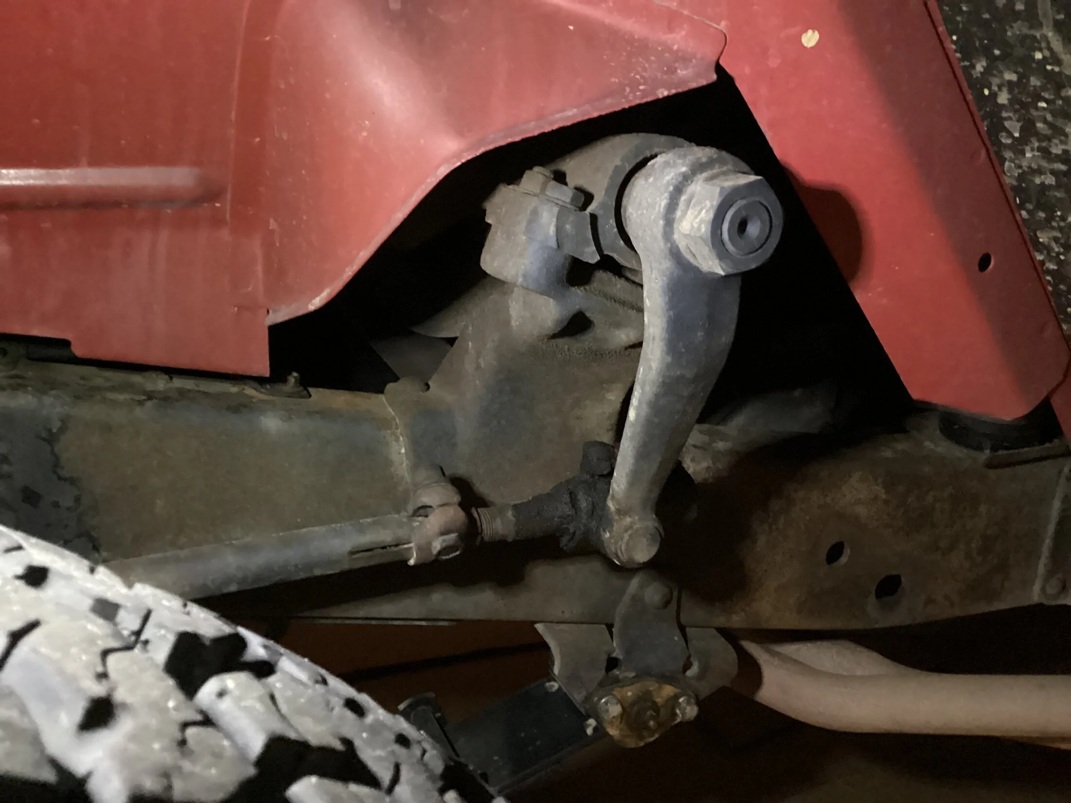

I have a complete OEM power steering setup from a 1979 FJ40. If I want to add it to a 1983 FJ40 my understanding is I must cut the steering shaft. Instead of cutting steering shaft can I by an after market mounting cradle for the gearbox (JT outfitters, Georg) and use the steering column without cutting. I realize this will not be a collapsable steering column.

I would fit it all up and not worry about shortening the steering shaft until you see no other way to make it work. There is a bit of wiggle room in the whole setup. I know people who have also just spaced the steering column off the floor a bit to make room for the longer steering shaft.

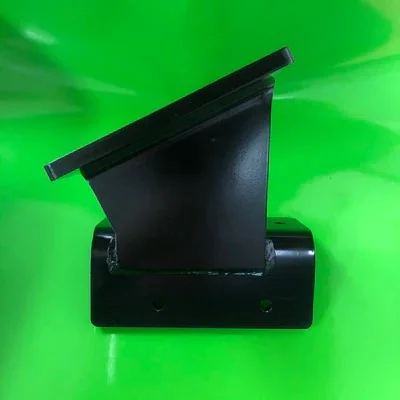

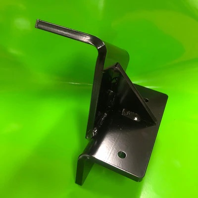

Thanks!
Believe this pedestal is for using mini truck power steering on a 40 series. Made to change the angle of the steering box not the spacing of the steering column.

why not just shorten the collapsable section of the steering shaft, cut it, drill hole, install dowel pin
and as stated above 40 mounts are the same, mini truck mount has a different angle
