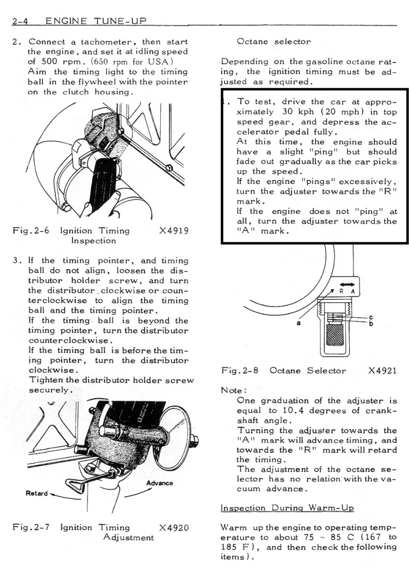

Here is what the book says but it's older and probably not directly applicable.
I don't think your dizzy has an "octane adjustment" but the "ping" adjustment that I put a box around is pretty general for all engines. To understand the feeling of timing adjustment you really ought to drive an old model T or similar vintage tractor that has manually adjusted timing.
