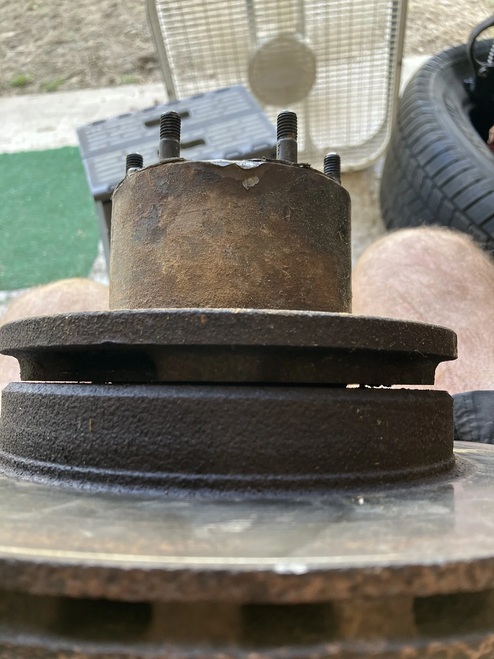

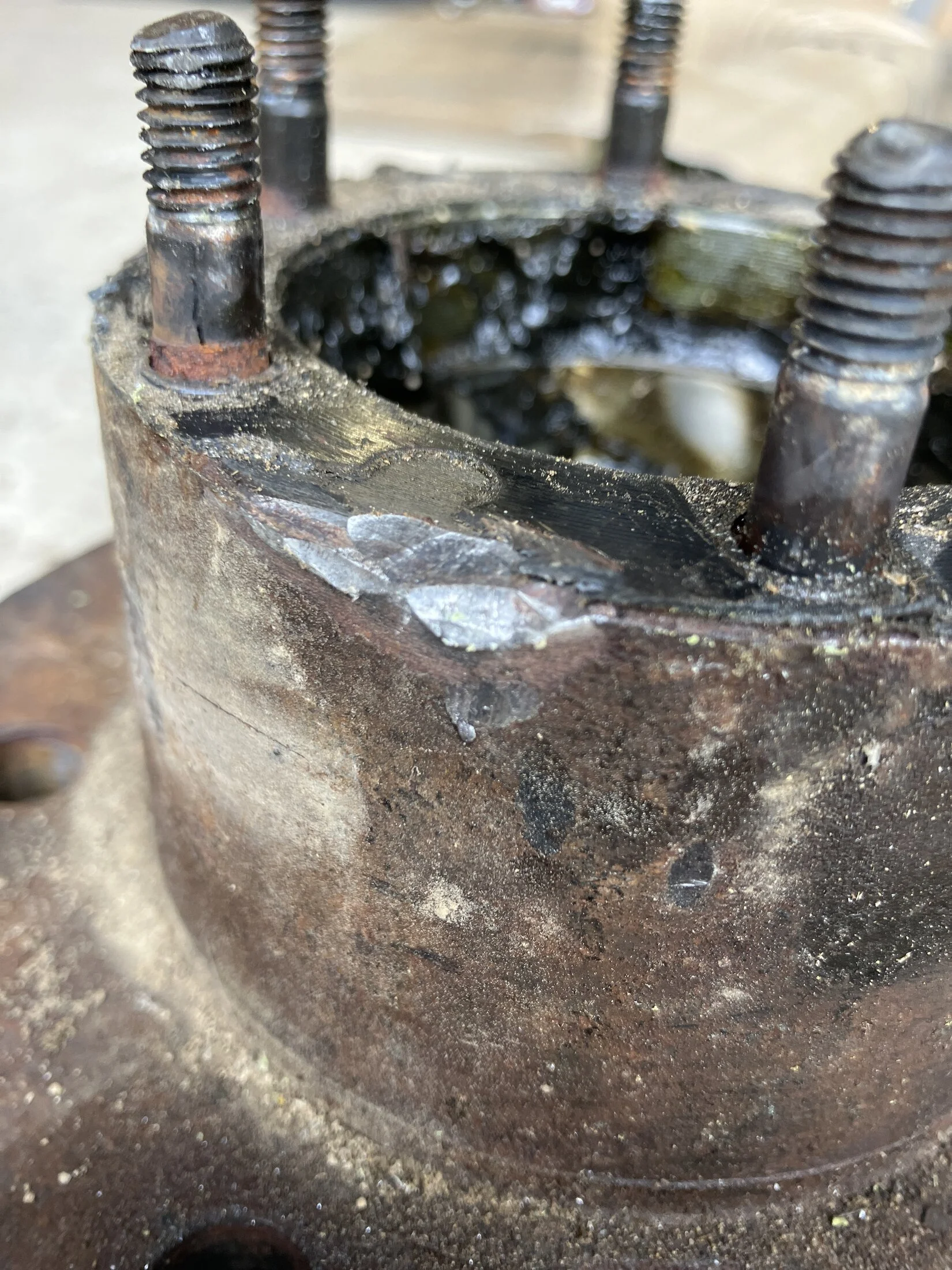

Is this going to be a problem when I put it back together? I needed a bigger hammer
Yup. Both. Man I hate being stupid
You do know how to get the cone washers out, yeah?
No need to live up to your name bud.
You definitely need new studs.
I’m about an hour and half from you and have an extra set of studs (and hubs if those didn’t survive) you can have if you feel like making the trip.

Yeah I just tapped the end of the studs and out they came. Had no idea these studs were replaceable. Thought I had to get a new hub. Frankly I can’t get the rotor off of the hub either. I have a rebuild kit and new rotors already so looks like I will need a new hub. Man I’ll drive to you. I’ll shoot you a dm. Thanks!

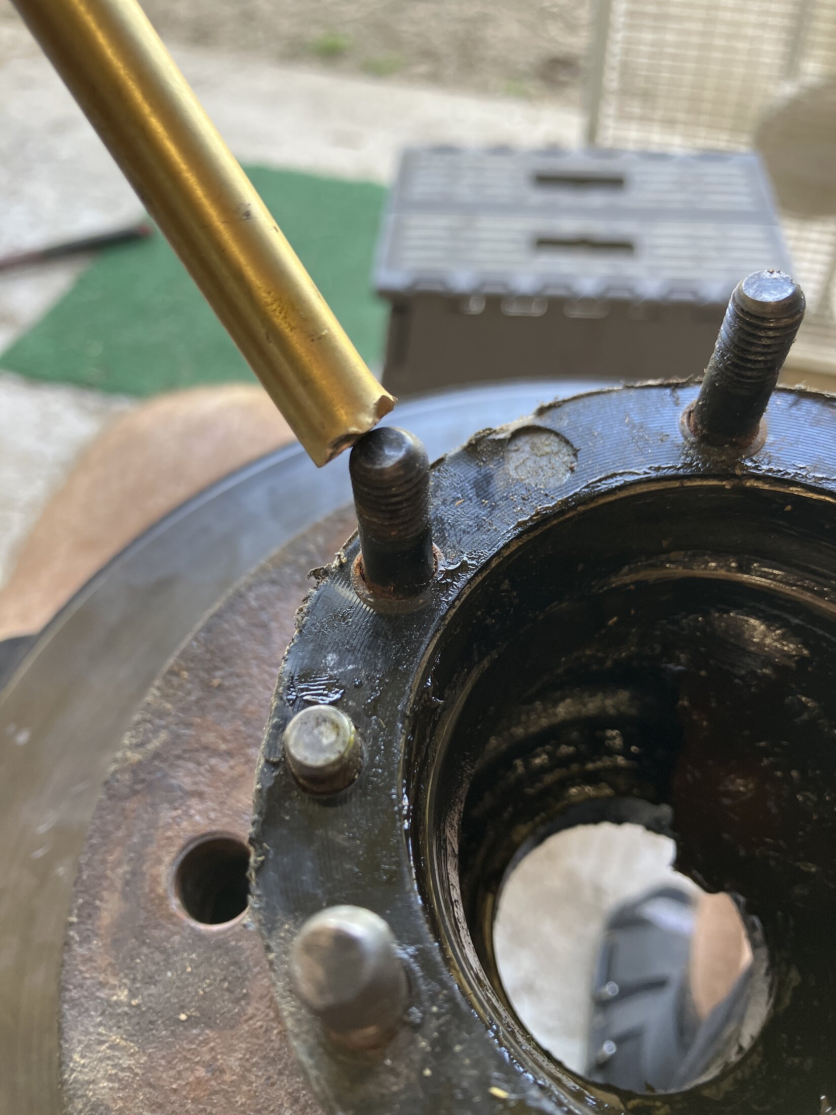

This was the biggest drift Napa had online or in the store. My aim is bad I guess.

This is how you (properly) pop the cones out without damage to the studs/hub surface, using a brass drift:

The rotors are held on to the hub with two bolts accessed thru the back AND the wheel studs. Wheel studs have to be pressed or hammered out .... If you don't have a press might be best to take to a machine shop to have the rotors fitted. Wheels studs are still available from Toyota. If you bugger them, DON'T use the aftermarket, they don't fit right.
Good timing. Just bought all 12 studs from Napa where I got the rotors. Kinda thought they would be universal. I usually buy aisin or Toyota but not this time. Hmmm. I need a bigger brass drift.
