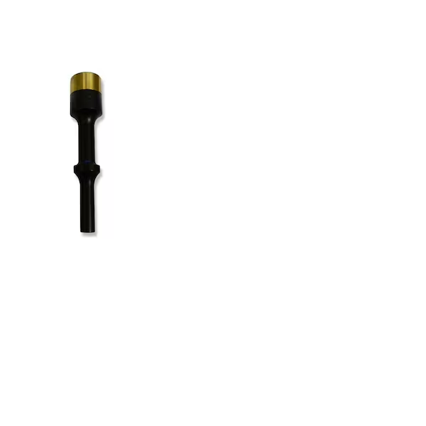

Using an air hammer has saved me more time and damage than anything else. Leave the nut on the stud covering the threads and bump it with the flat attachment on an air hammer.
99% of the time it does the trick and loosens most others at the same time.

I wonder if the majority of home mechanics have an air hammer or a even a compressor large enough to run one but good to know what else works.

Air Hammer does work great and is very fast, if you have the equipment. I use with a brass punch I found at a Garage sale, years ago... Still sold.

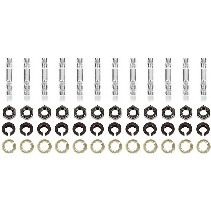

I went with these on my mini truck hubs. Easy to just unscrew the stud if needed. Has a hex head on the end of the stud. Expensive though and ARP is twice as much.
