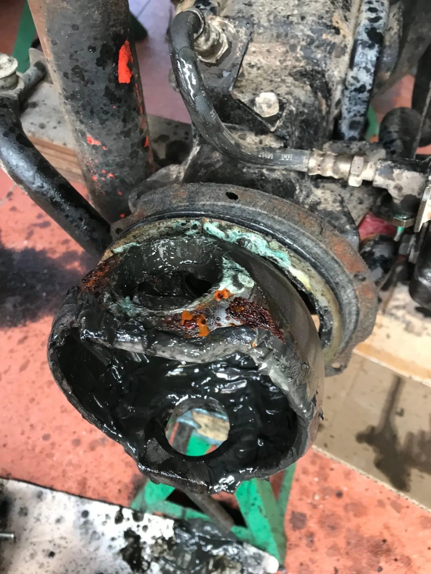

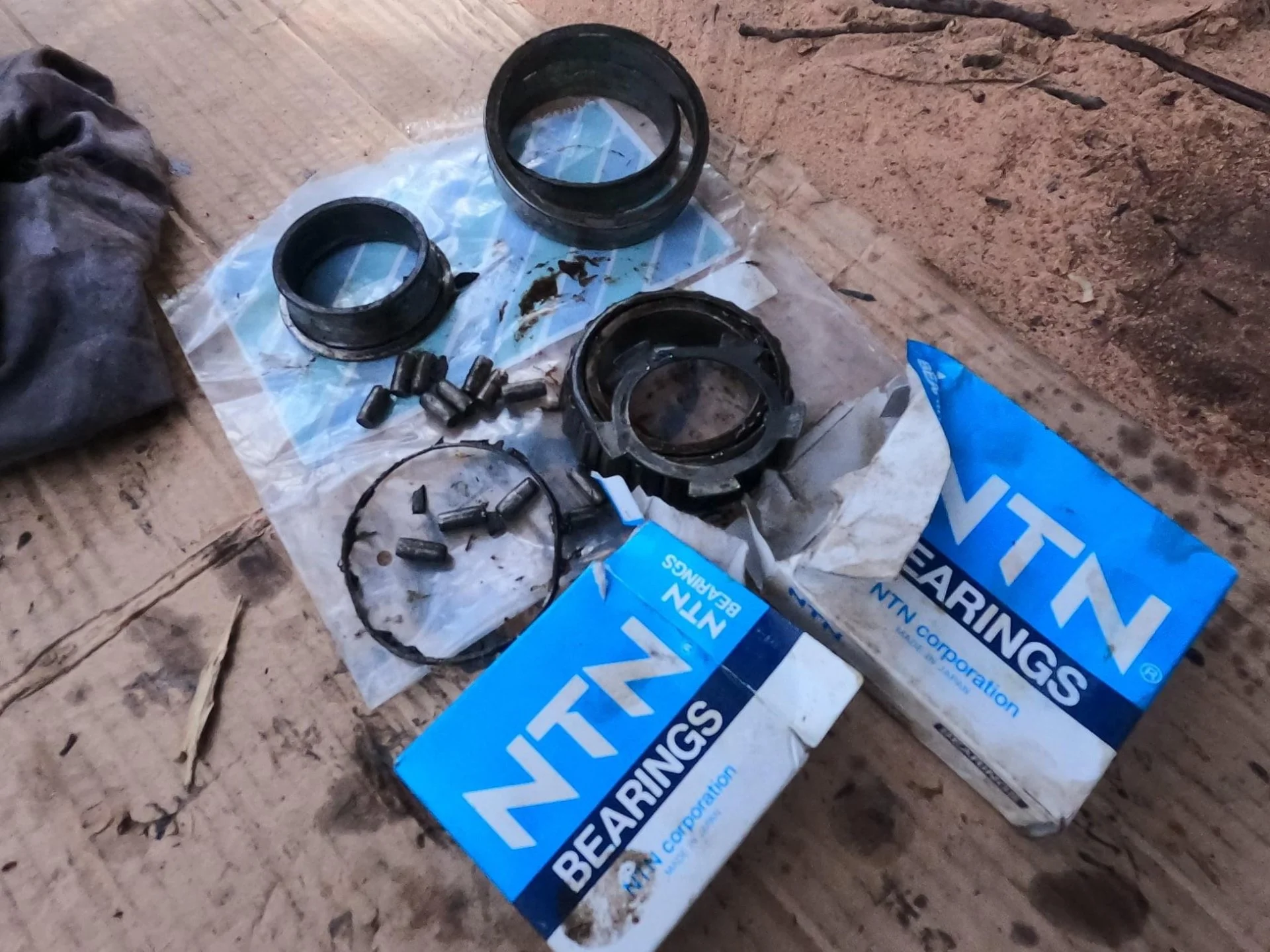

The problem initially started after getting water in the swivel housing which intern ended up in the hub ceasing the outer bearing. The bearing spun on the stub axl, thust washer broke the tab off and in-turn loosened the bearing.
I replaced the bearing out in the middle of no where whith a new one. At the time I didn’t have a replacement thust washer and for the next 1000 klm to get home I had to retighten it 4-5 times on the side of the road.

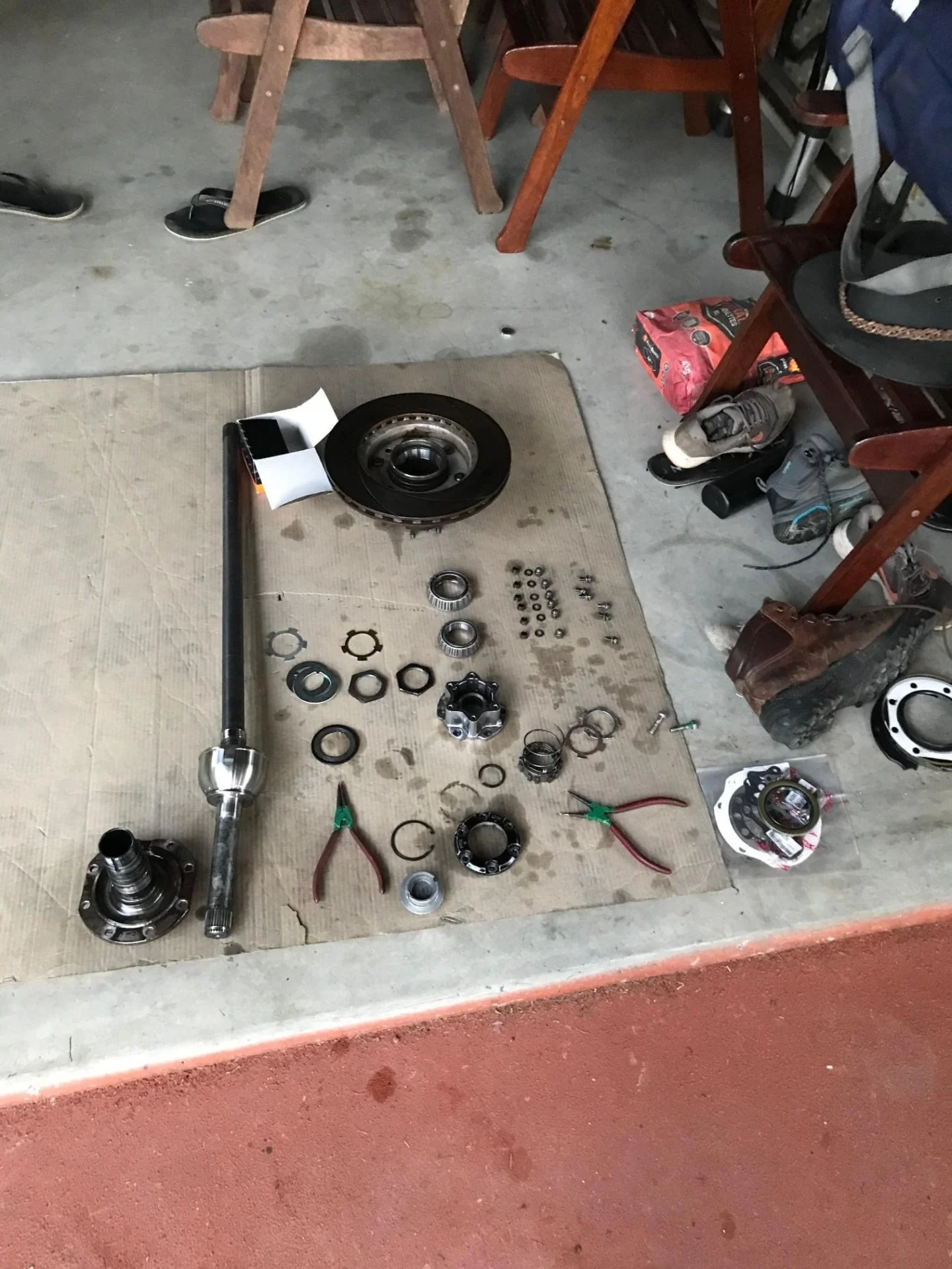

After getting home I pulled it all down replaced all the seals in the swivel housing, re greased all the bearings.

If you spun a bearing you may have damaged the spindle ?
Do you have any closeup photos of the spindle?
