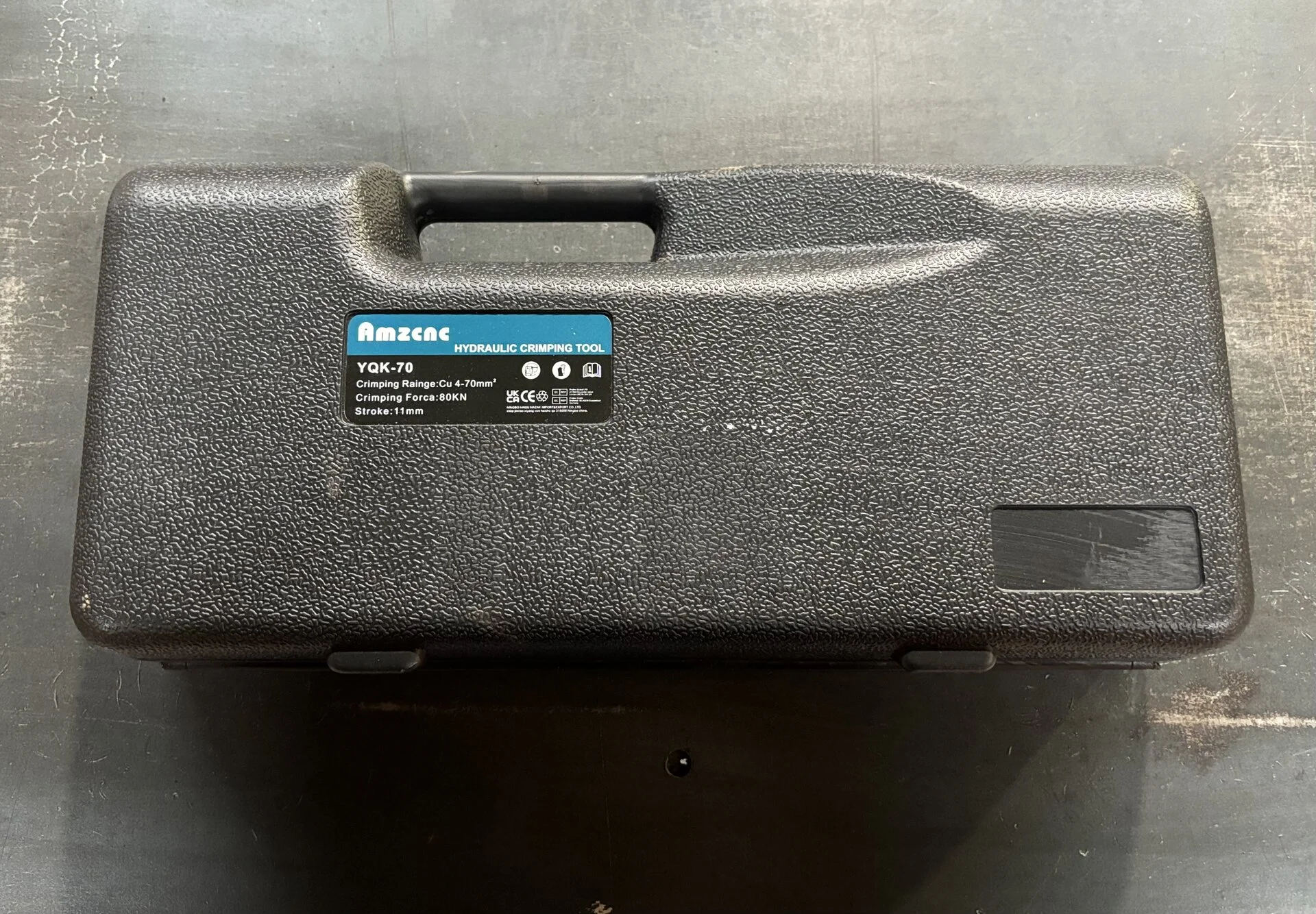

This tool topic has been touched on a couple times in some different threads, but I didn’t see much in the way of application, so here’s a new hydraulic crimper thread.
I’m currently in the process of rewiring my FJ55, and have purchased several types of hand crimpers for completing this task.
A small part of this job includes crimping a #8 Deutsch pin and socket onto some 8AWG wire to supply my engine fuse panel with sufficient amperage. Standard Deutsch crimpers crimp #20, #16, and #12 pins, and require different high dollar crimpers to address #8’s and #4’s.

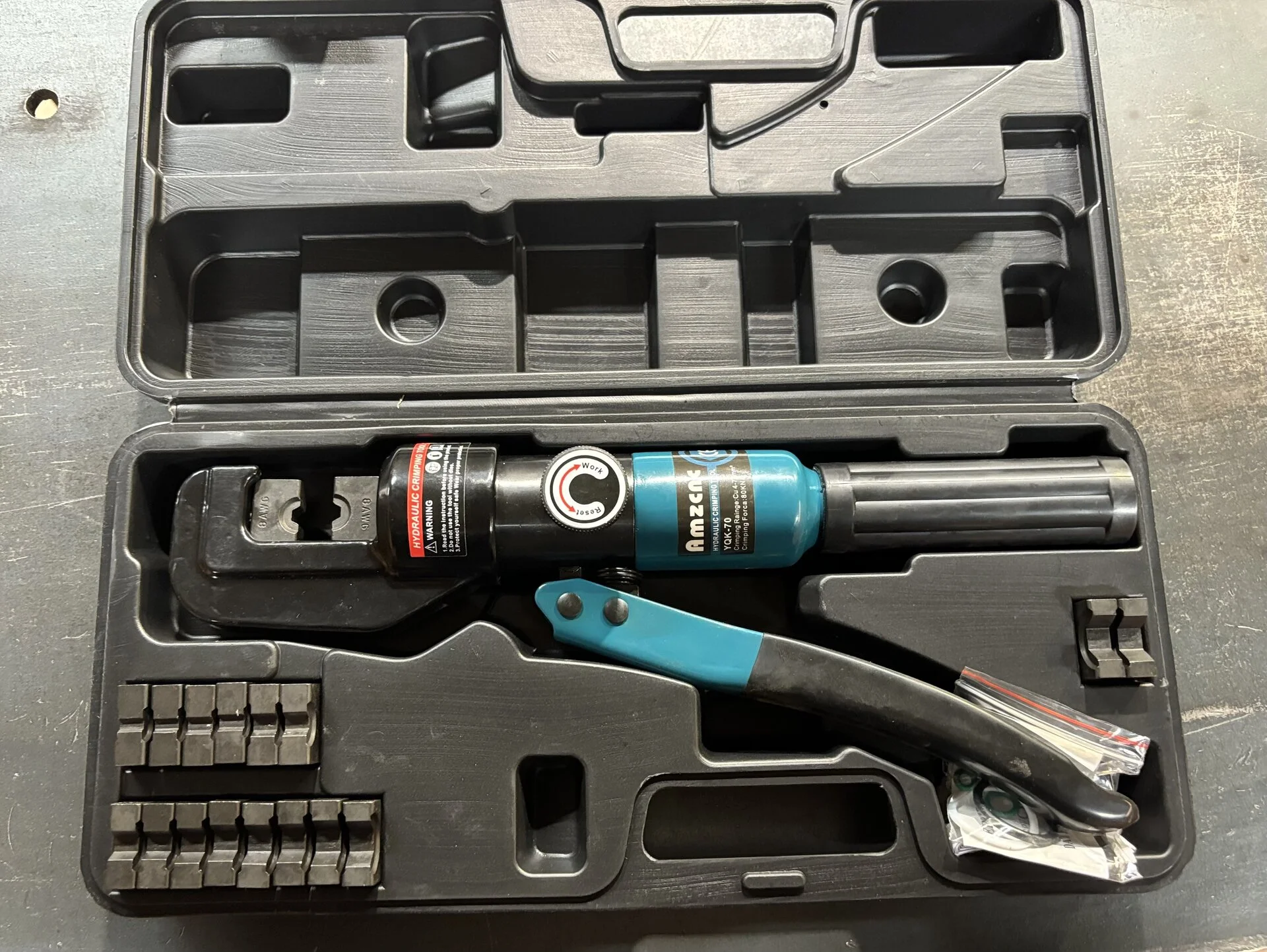

I can’t remember what exactly brought me to these plentiful and cheap hydraulic crimpers, but after a couple days of browsing through what are essentially the same two or three designs, I settled on this AMZCNC YQK-70. It has 9 die sets from 12AWG to 2/0. I wanted to see how well it would work for crimping a #8 Deutsch terminal, and take care of my 1AWG battery cables. For $40 I thought I’d give it a shot.
I've used mine (very similar) with generally satisfactory results. Sometimes there is a bit of a mismatch in size between the typical US connectors and the dies (which I believe to be actually metric). If the die is too small, it makes big ears at the seam (these can be cut with a flush cutter), if too large, well it may not not be as tight as it should be. So, sometimes a bit of an issue there, but it's reasonably OK to use, overall. I also make a point of turning and recrimping the connectors in the dies once or twice to even things out a bit, that seems to make it a bit better as well.
(Smart that you got one with the rebuild kit, will double its lifetime...)

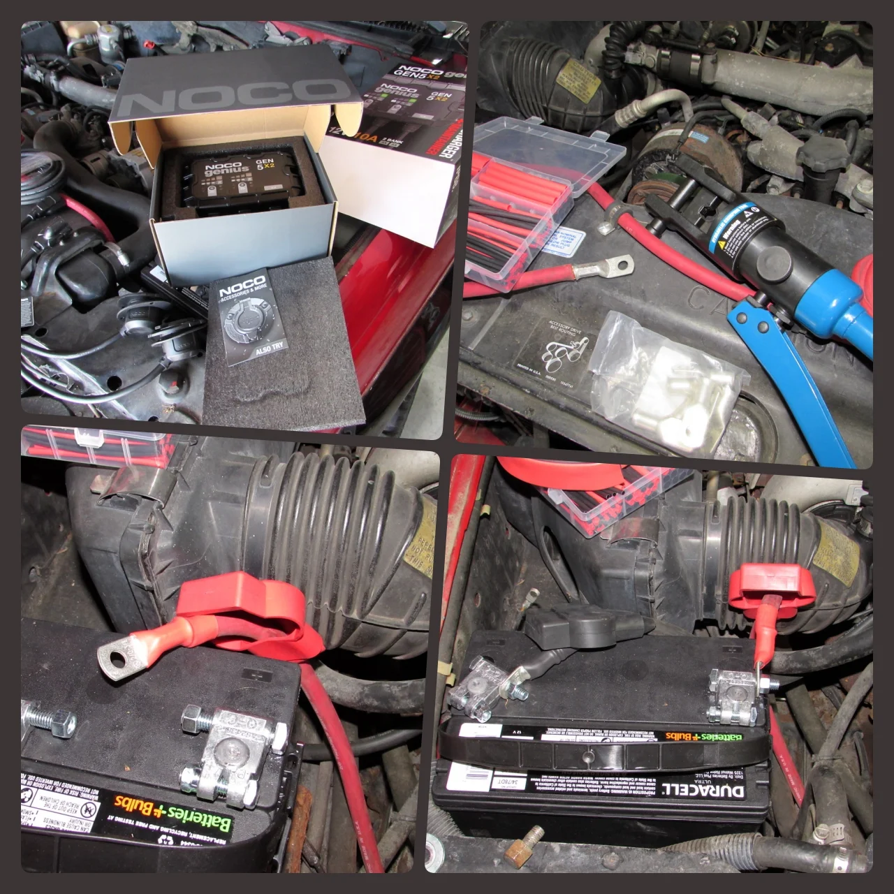

Yeah, there are some drawbacks I’ve found. Despite the die sizes being capable of making a crimp on the larger cable sizes (1AWG and bigger), unless you’re just crimping a ring lug and can pull the cable and terminal straight back out the opening - if you crimp an actual battery terminal on, with this particular style, you can’t get the cable or terminal out of the dies. With the bigger jobs like that, the open, top loading die style would be better.
I have the same (visually) crimper and get the ears too. Never understood why.
