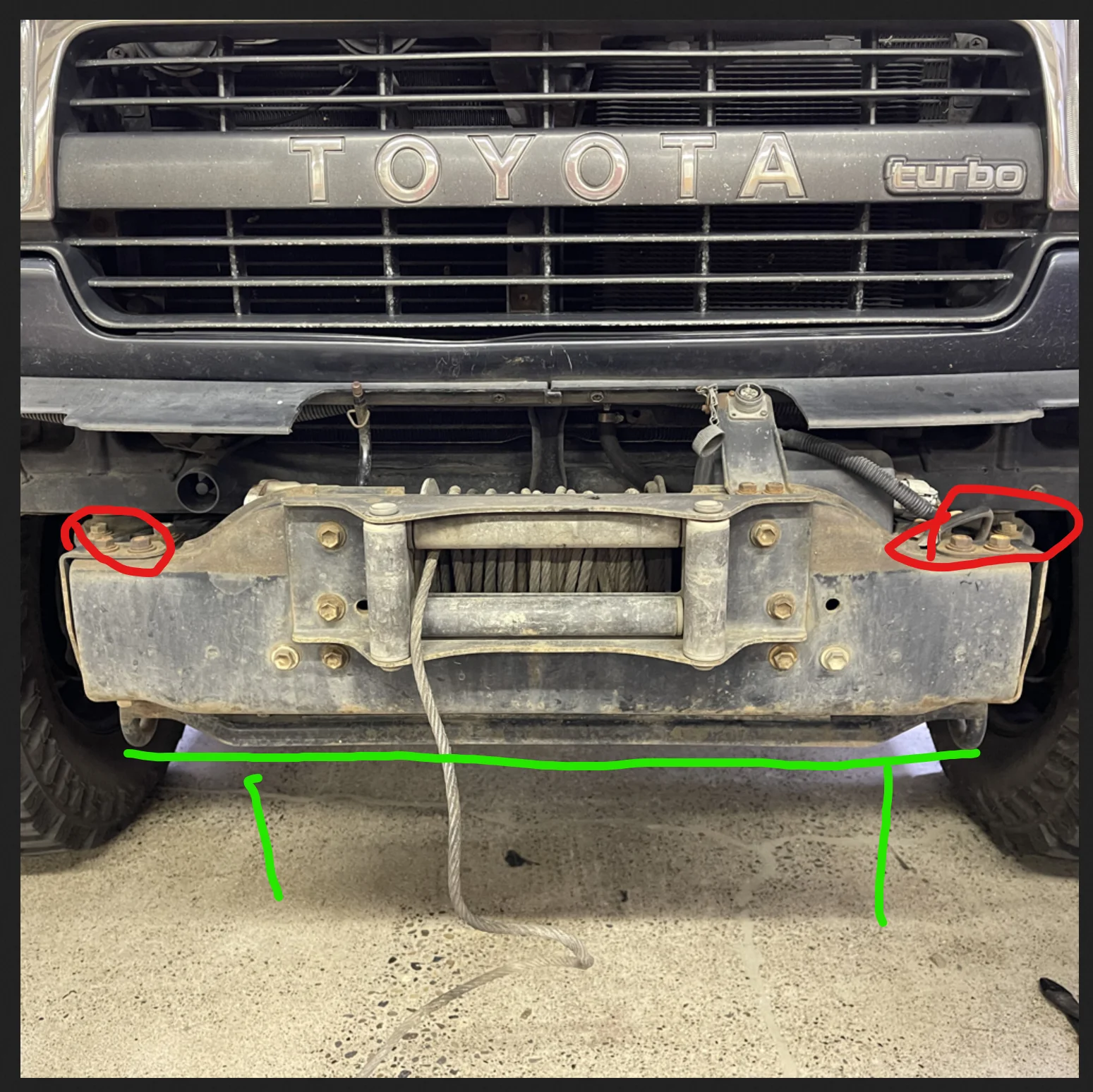

Am I right that the winch would need support where the green line is, and then undo the red bolts? Or are the front facing bolts also supporting? (major thanks to Absolute Wits End, as that's the guide I'll be following to disassemble the rest of the winch)
You should be able to remove the bolts circled in red as well as the front bolts that hold on the front crossmember and fairlead. Removing those will lighten the winch and make it easier to handle. Then the winch will just be held in by the four bolts on the bottom of the winch cradle that is bolted to the underside of the frame.
Lower winch plate, fairlead support plate and frame connectors should be removed together...

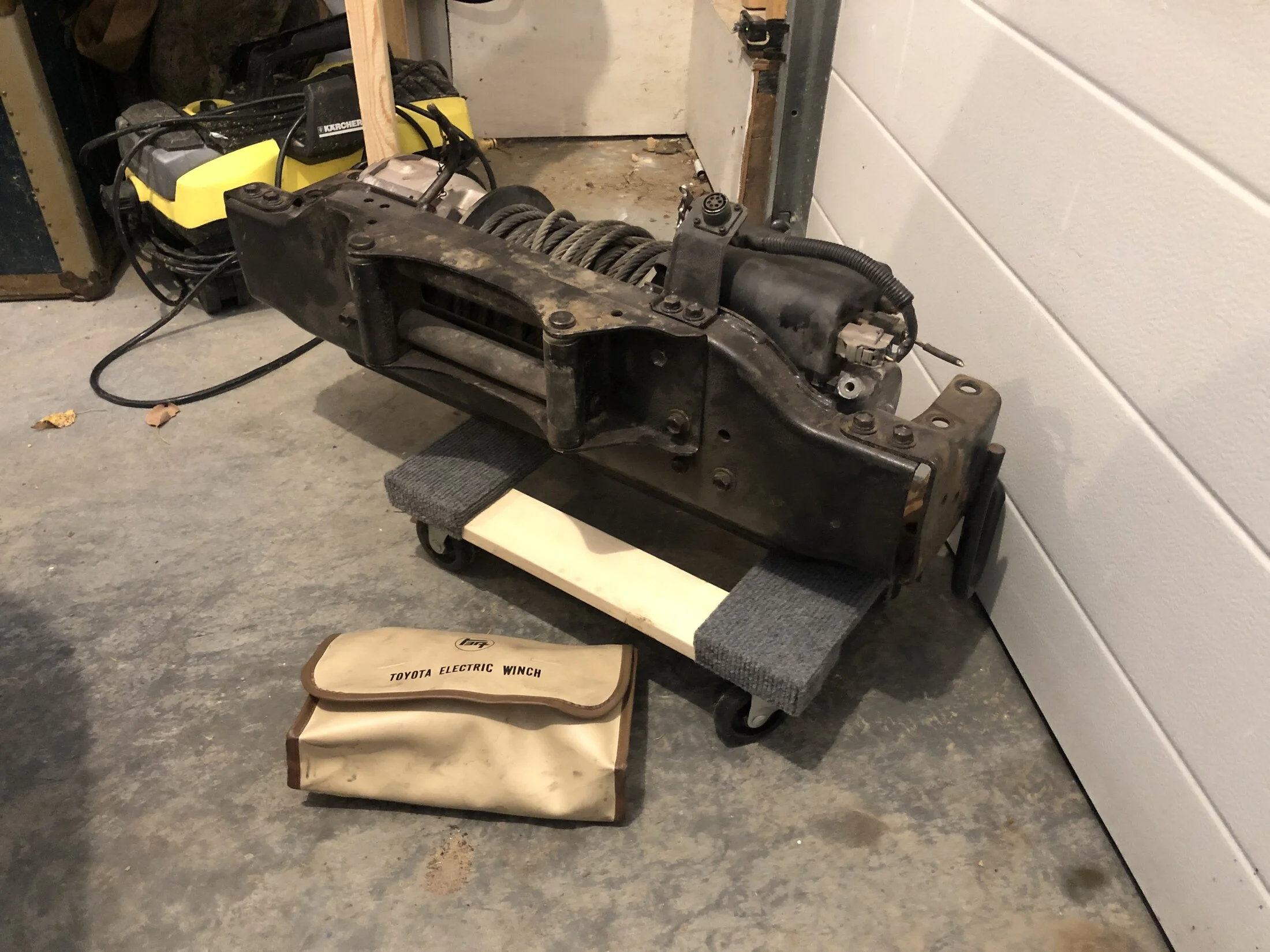

You could also spool out the line and remove it to shed some pounds. Sounds like you’re going to need to strip it anyway. Might be easier now mounted than rolling around on a dolly.
Thanks. I ended up getting a hydraulic table and it made my life a LOT easier. Removing the line does save around 10kg, so that's definitely helpful; and once you undo the bolts in red in the posts above, and sort of give it a few mm of lift with the hydraulic table, it will just slide out. It is indeed heavy as hell, so you cannot do it alone without a table; the heaviest part is the lower bracket and the couple of extra steel plates that are in it. The motor and the gear section are somewhat manageable by hand, though, but you need to flip the entire assembly upside down to undo the bolts that hold those modules in place.
