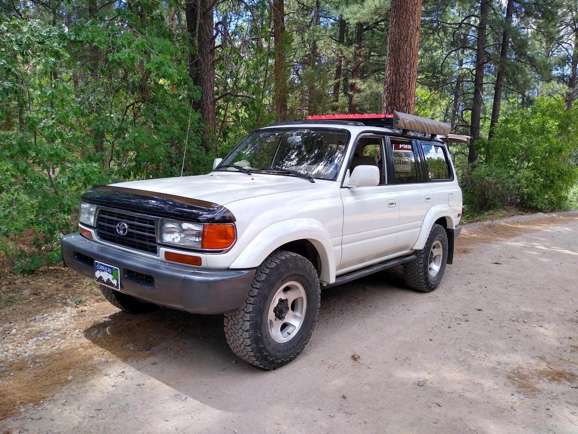

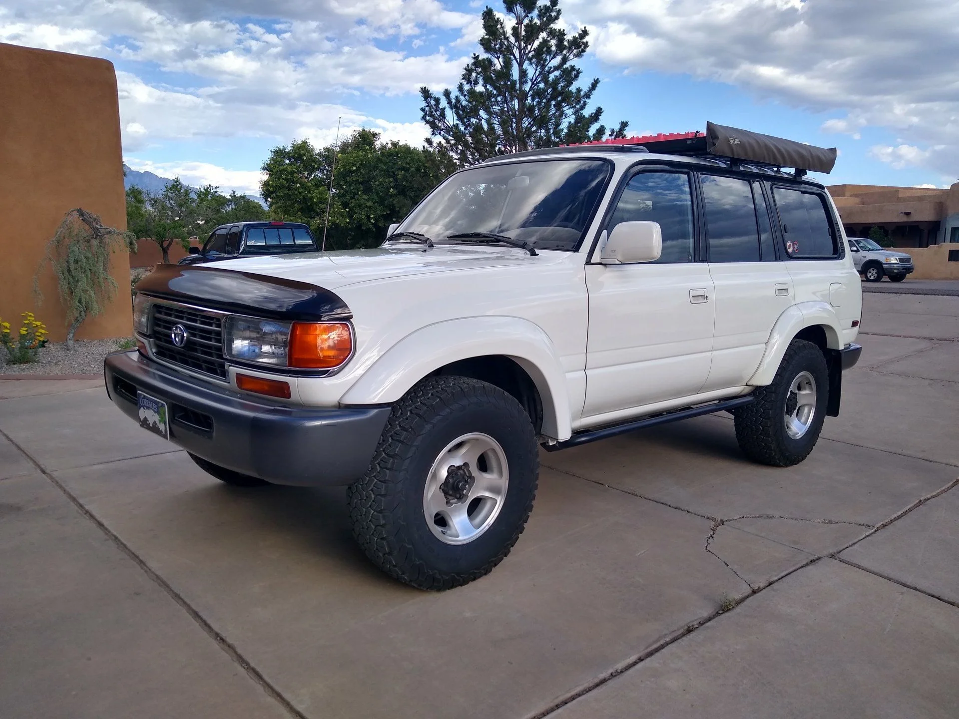

I replaced my tired springs with OME stock height with 10mm spacers all around. Got about an inch and a half of lift. Ride improved considerably. Also have the OME Nitro shocks and steering stabilizer. It does ride firmer than with the original set up. I'm usually on just BLM and Forest service roads so not into rock crawling. I'm also on 285 BFG KO2S. This setup has been great so far. I'm getting ready to drop the Tcase down and replace the high gear with an underdrive gear set to gain some gearing back after going to larger tires.
That is a beautiful truck (have always liked the white) and sounds similar to what I'm after. Are you pretty happy with the ride on paved roads around town or highway?
I'm seeing the OME's referred to in various different terms and part numbers but it looks like the kit they recommend with a front bumper (EK1302B1) results in a 50mm lift so perhaps around the same as yours. Thanks for chiming in. I didn't think about re-gearing after moving to 285's but they look really great! I've been happy in the brief time with my K02 265's and will keep them on until it's time for something new (about to buy a 5th for spare actually).
