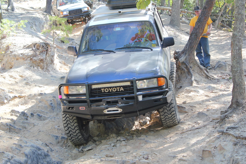

I love my ARB and hate my ARB. I've put soo many tools, drinks, cups, and my oil cap on the flat sections of the bumper under the headlights. Most of the time I drive around with them there but I recently lost a long 17mm wrench and bit driver that I left on the bumper after adjusting my steering box.
IMG_8655 by Jonathan Jones, on Flickr
What started this sequence was a very rough idle so that is what i was watching. The continued rough idle Saturday through wed day when i installed new blue top modulator and tubing. The trip down through the mountains was as silky smooth as the engine has ever run.
wheeling with coffee cup on bumper pic is pretty sweet :hillbilly:
I totally get that! I had to force myself to implement a rule about not leaving anything on the bumper. Lost too many things. Though, just last week, I drove around all day with a jug of coolant in front of a headlight. I was thinking my lights were a tough dim, too…
