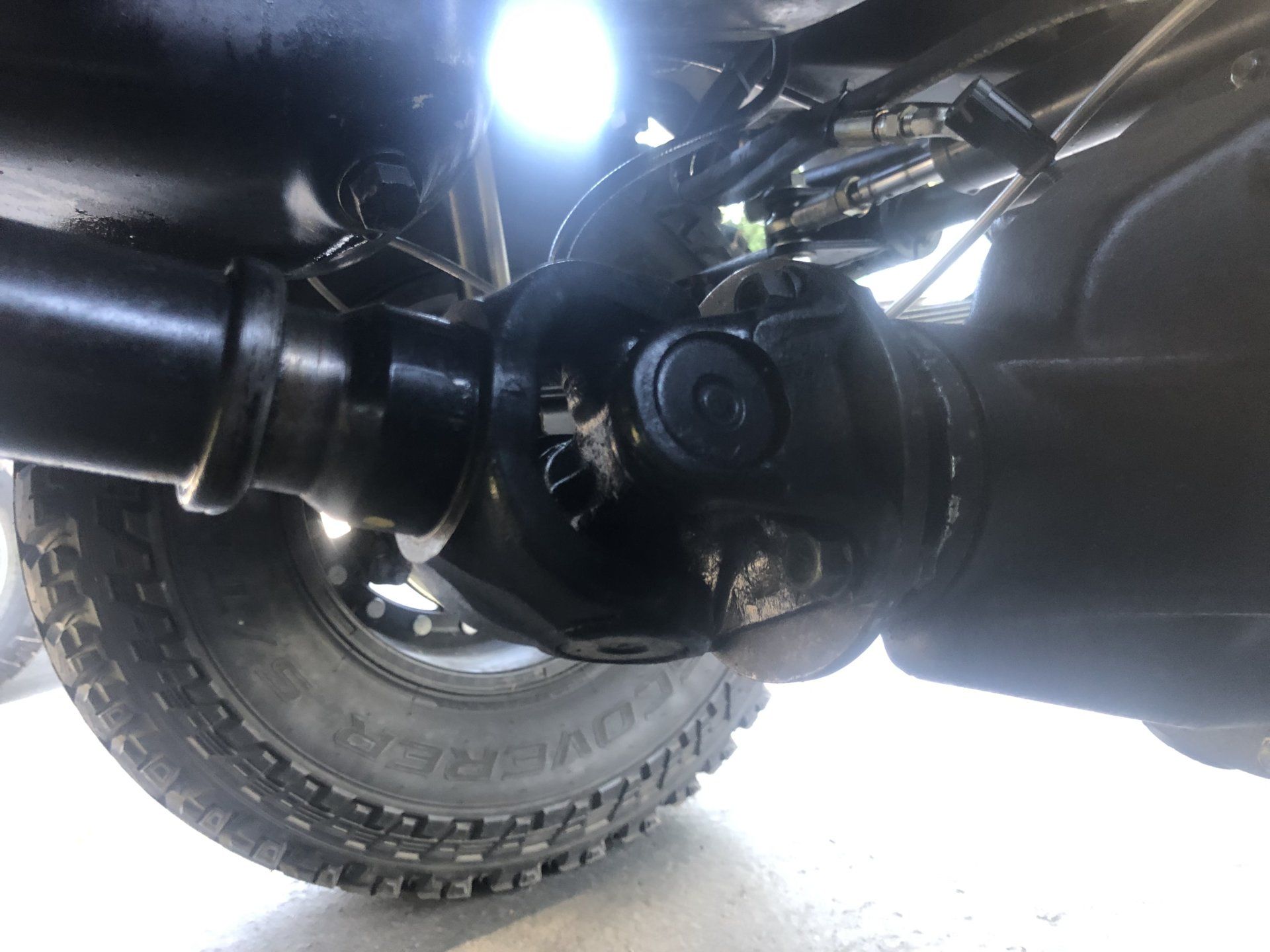

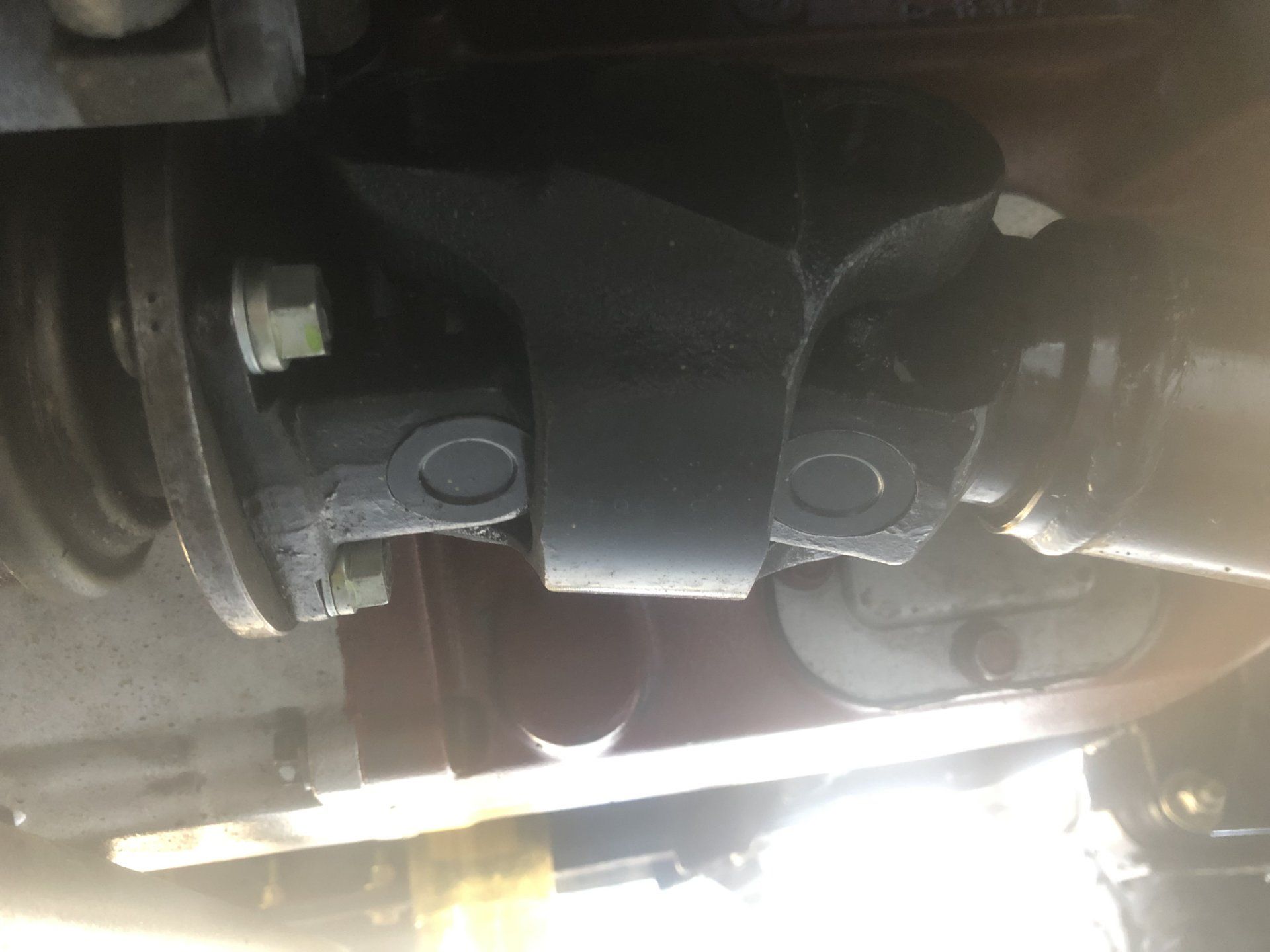

Here's my issue. It's not a big deal at slow speeds or when crawling. But you can feel it when going faster.
The front doesn't have that issue.

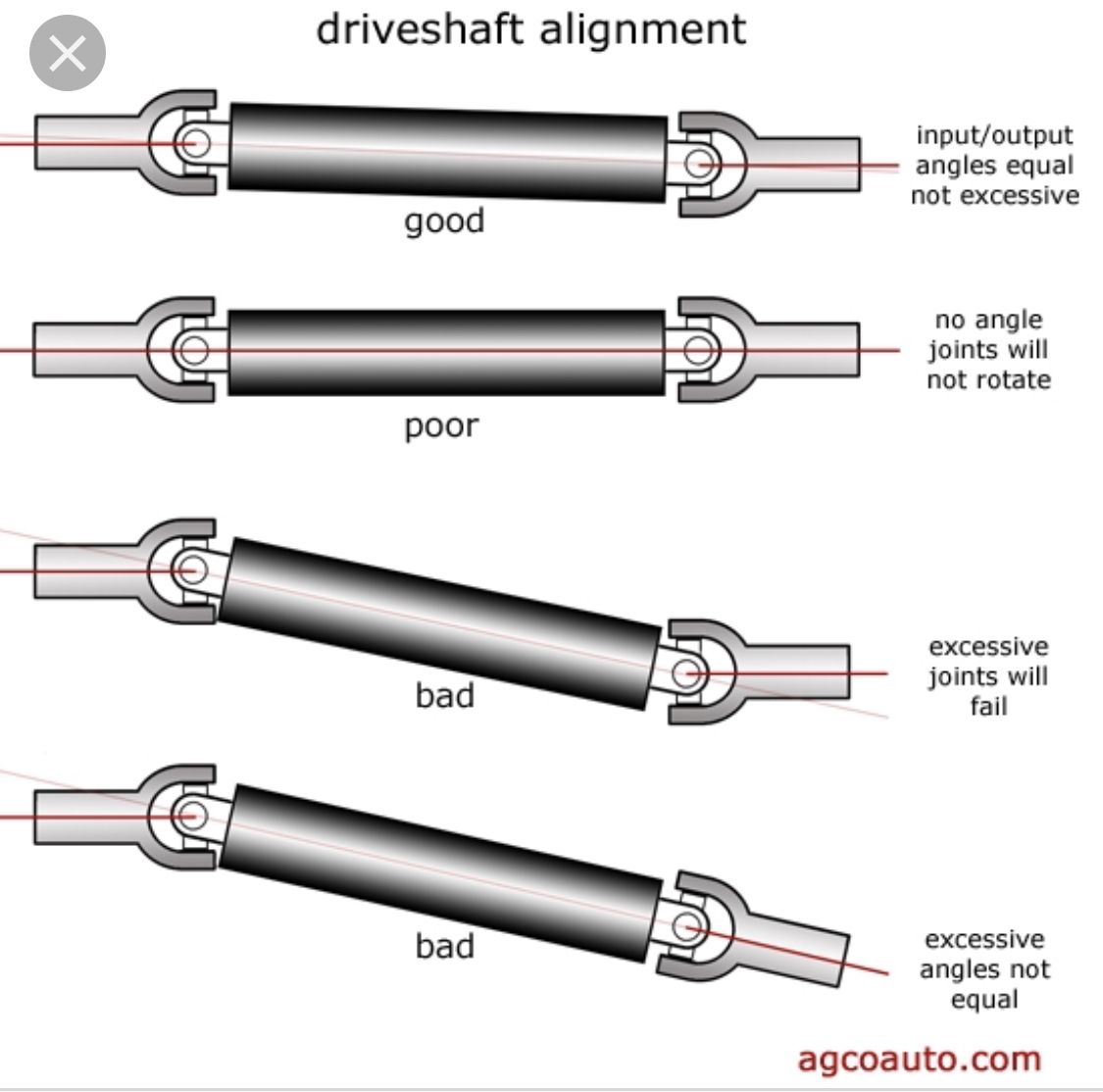

Wondering if a double cardan drive shaft will fix it.
I've also had the drive shaft installed the other way, same issue.
4WD or 2WD if that’s the rear drive shaft you think you’d notice that regardless. Only if the front had that would you notice in 4WD and not 2WD.
I’m sure a DC joint is you answer
It's the front.
Double Cardon might do it and with a balancing wouldn’t hurt.

I don't suppose you have the measurements of that drive shaft handy? thinking of ordering one from Tom Woods, unless you have a better suggestion
I could but all of our swaps are custom. Motor and axle placement are different. Find a driveline shop. I took mine there and gave him measurements from both faces of the flanges and he set me up.
