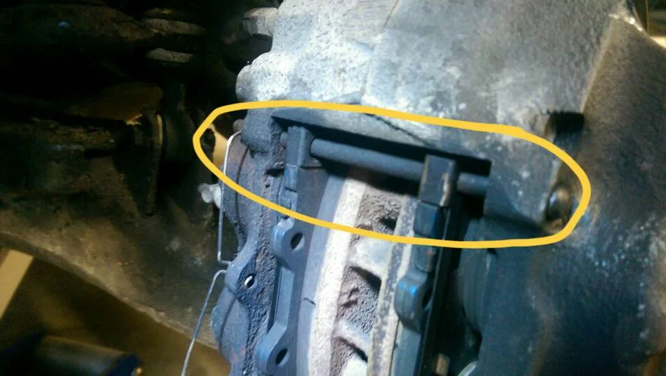

Photo of the fronts (Are these what you are talking about?):

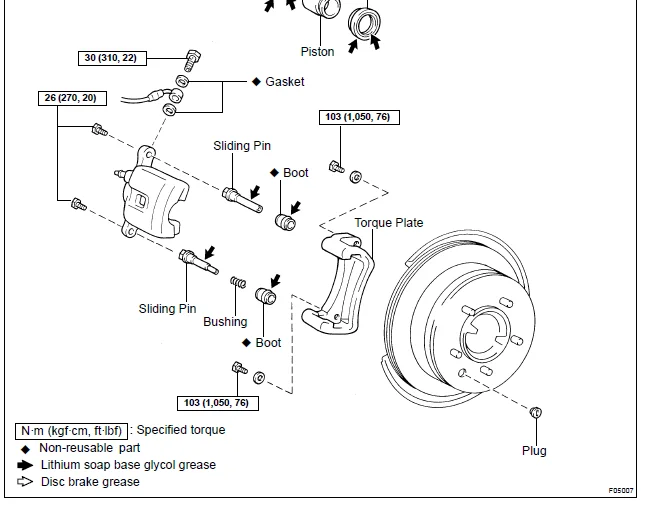

FSM for the rear:
sliding pins labeled in the picture. Sorry I didn't name them that way. I just thought everyone new since there's always talk about them.
I doubt they ever even get serviced til they seize, or someone has an issue at 100k or whatever.
I've always called those other things, pad keeper pins.
search , brake guide pins and you'll get all the info you need

Still can't find the P/N's for the fronts, but I found the rears, posting for anyone looking in the future...
Rear brake guide pin ("PIN, CYLINDER SLIDE")
Part Number: 47715-60010 OR 47715-60020 (not sure the difference, the 20 is the "sub")
Bushing for rear pin ("BOOT, PIN")
Part Number: 47775-30040

The 47775-30040 Boot goes on the rear pins.
