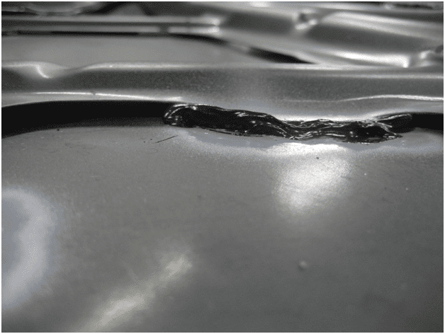

The paint on my truck's bonnet is failing so I took the bonnet off and hauled it away to get wrapped.
I removed the liner or insulator and found rust everywhere the skin of the bonnet was glued to the support frame.
I'll treat the rust when I get the thing back.
Should I use large globs of silicone to re-create the factory rubbery goop? What was that original stuff?

I used seam sealer in a caulk tube/gun to reattach the bonnet's frame and the sheet metal "skin".
I think I first found it years ago at Advance Auto or another parts place.
It was toothpaste tube size.
The caulk gun size I used this time was named "self leveling" silicone.
