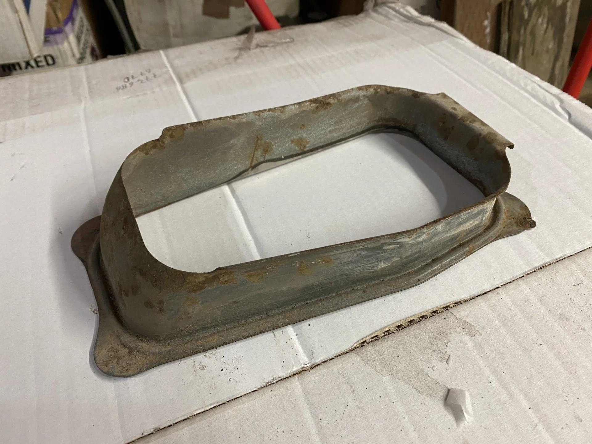

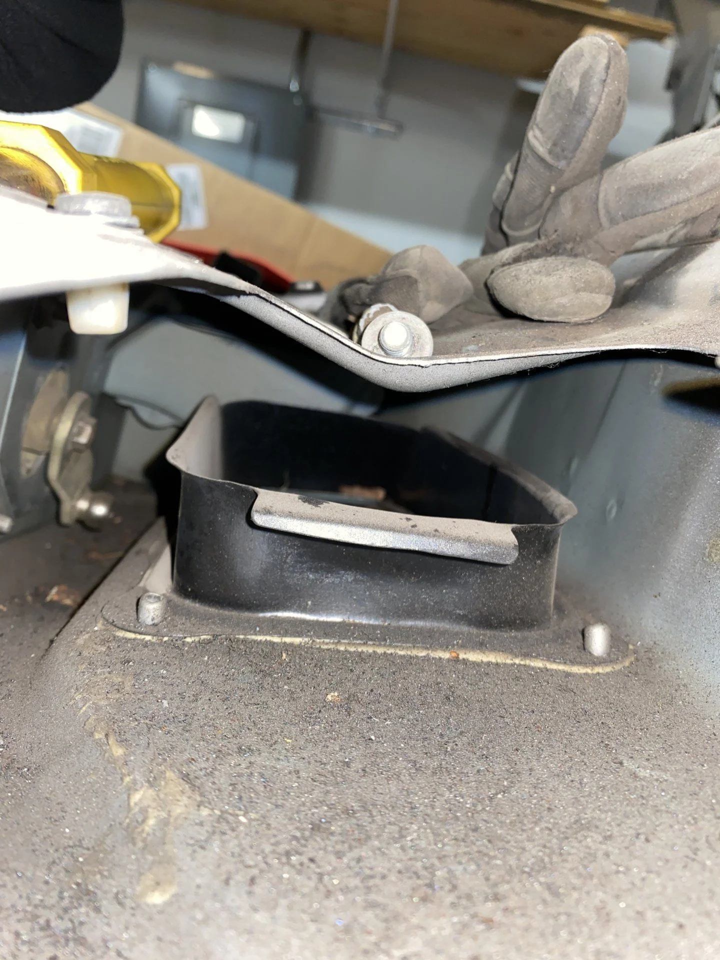

Rhd or lhd? Either way, one option is that the weather stripping around the debris wall, don’t know what else to call it, for the cabin air inlet is determined enough that when you get a lot of water at one time it pushes under the lip? Then the water would enter the area that the fan is in.

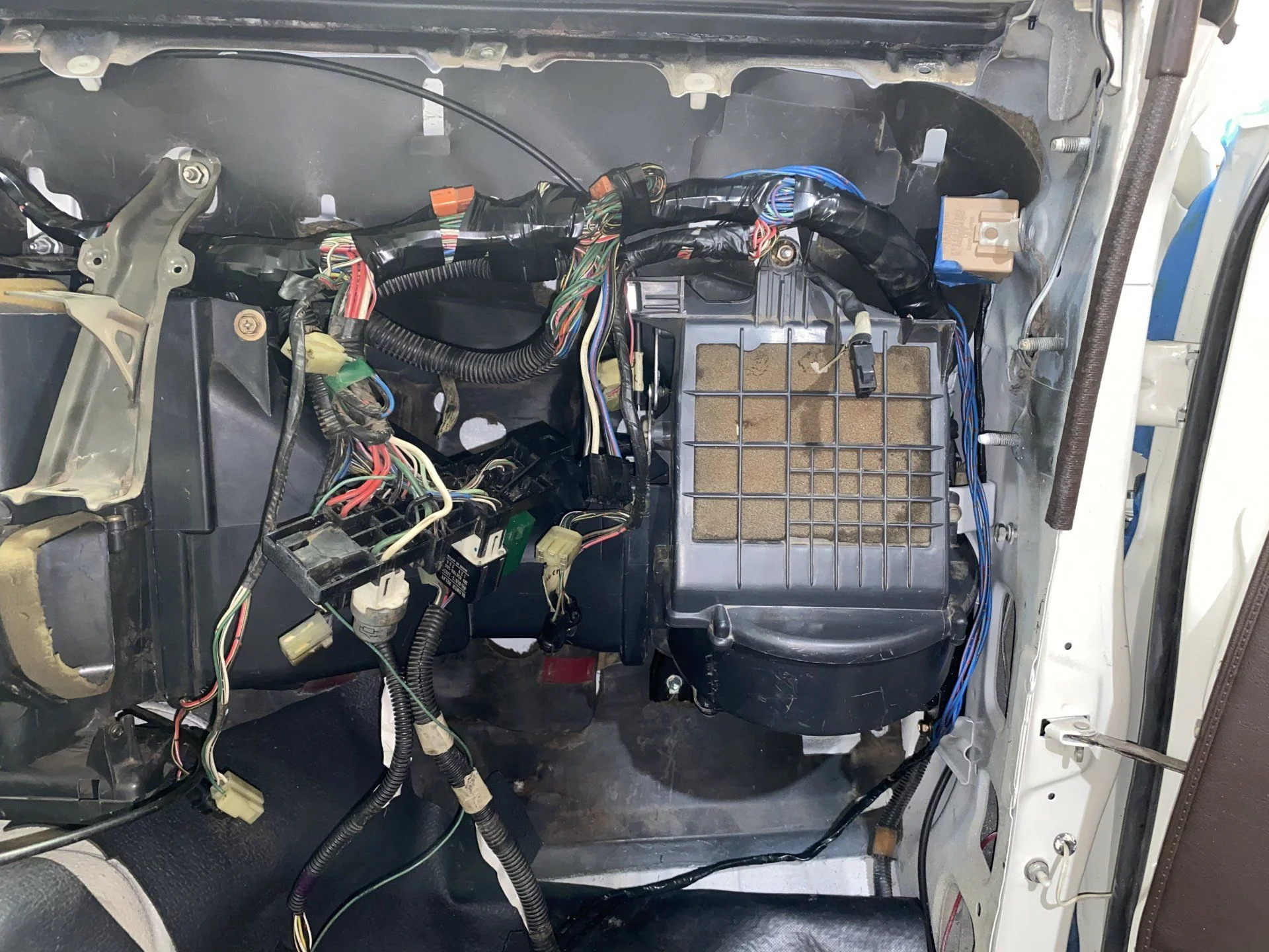

I had roughly the same problem but it was rust in the air intake behind the hood (bonnet). Mine were large holes in the firewall on both sides, so removed the dash and spent MANY hours on my back grinding cleaning prepping and fiberglass in the holes.
Yours sounds much simpler. Here in the US we have this stuff called flex-seal which is a rubbery liquid that dries hard and seals up small holes. It comes in many forms: paint can, spray can and even tape now. Depending on the hole size and product availability in your region (I’m guessing non-US) this could be the quick fix. Selling the rig is just silly talk.

The test was only through the bonnet Hinge recess which has a drain hole that drops onto a shelf below what you have pictured. Believe the crack/holes are somewhere lower than this debris wall. Not sure if it's the name for it but I like it.

Coldtaco, how do you get at this area? Take fender off?

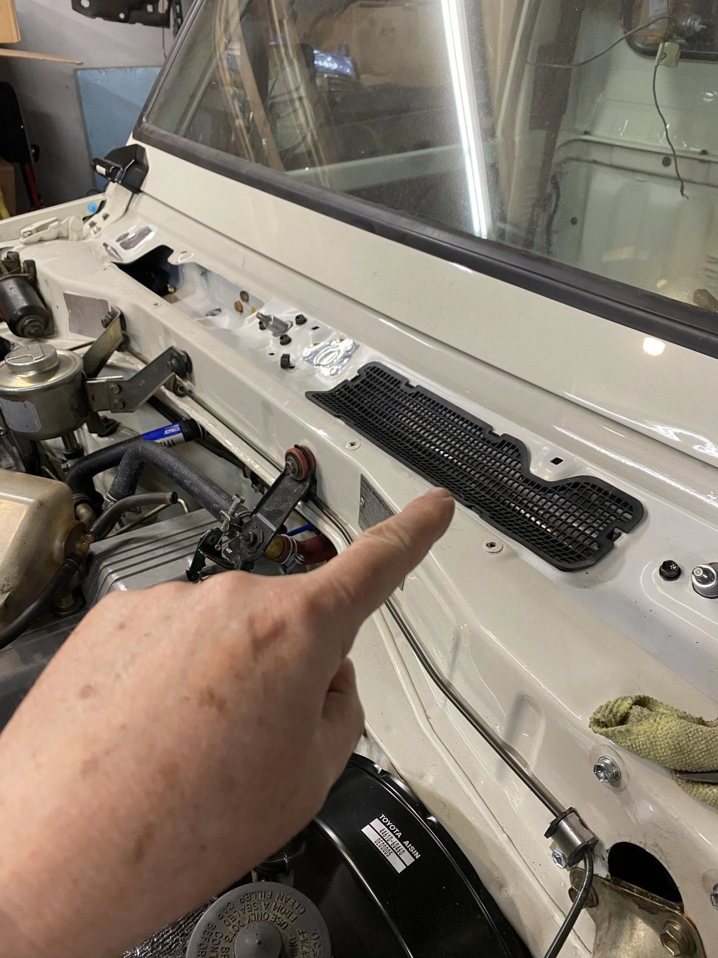

From the top and/or from underneath. Underneath you need to remove the blower assembly, all of it. From the top you have to remove the cowl in front of the windshield and remove the plastic grill (that should be there)
Red marks the spots were fasteners have to be removed. Removing the big parts can be a pain
I did removed the cowl on mine and the plastic grills(big & small), didn't see any protruding lip for the air inlet! I'll have to take a double look when time permits it. Mice can climb up the drain holes and bypass the plastic grills and into the air inlet if anyone has that problem:oops:

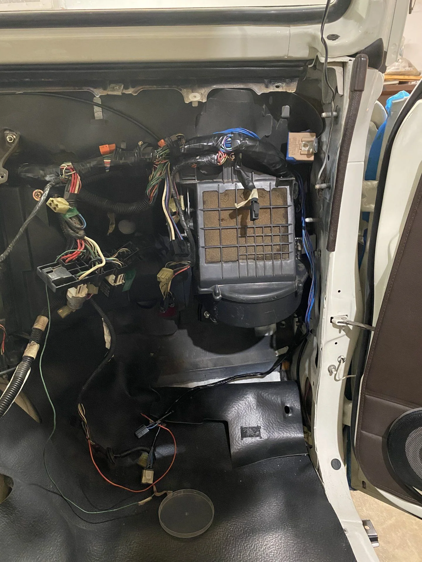

It's been a loong time since I have had to remove any of this parts, but I think if you remove the glove box that should be enough to access all the bolts and nuts you need to get to, it will be a pain and seem like it will not work. Getting the upper "hook" off the stud will be a pain, just give it a really good hard fast tug, don't try to do it slowly.

Hey thanks for all the info coldtaco, good to get a visual on what it takes. In those photos did you remove the whole dash? How long did it take to remove if you remember roughly?
