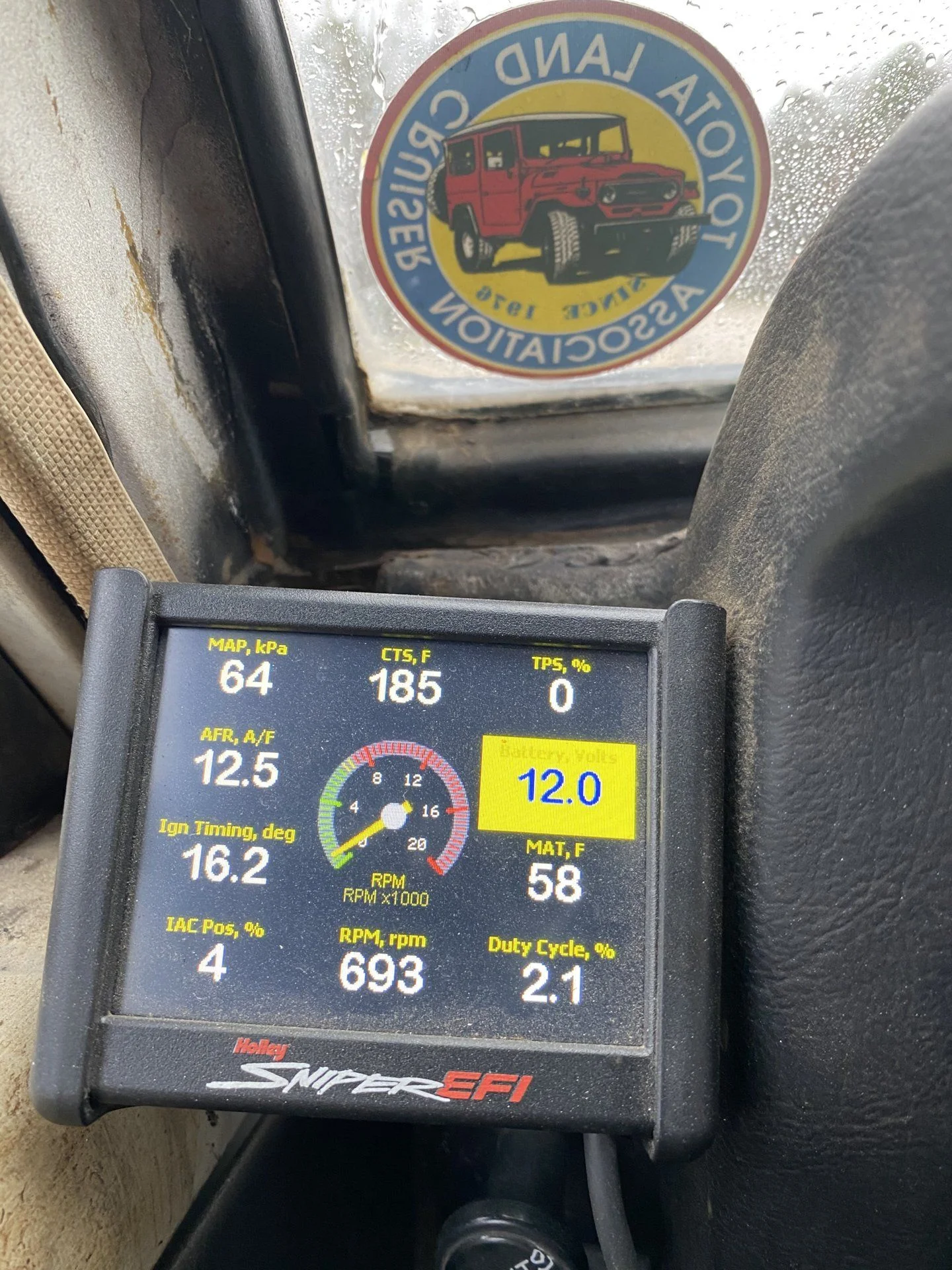

I happen to be in my Pig today. I think the computer is set at 690 rpm. See how it and the IAC dance.
Here is a look at my screen rolling down the interstate at 75 mph using between 25 and 45% throttle depending on the grade.
Nice and smooth for a 2F pushing 6000# of Pork
You make any adjustments? 73 at 3000 rpm. Sweet.
Adjusted the idle to 700. I still have a few issues. Still wants to stall every now and again when rolling to a stop. Also the iac was running perfect (4) at idle all throughout my ride until the end when it went to 1 and stayed there. I still get a tps of 1 which is a sticking throttle I think. I’ll go in and redo timing and recalibrate efi to what you talked about. Otherwise it’s pretty some cruising and throttle much more responsive than the carb.
