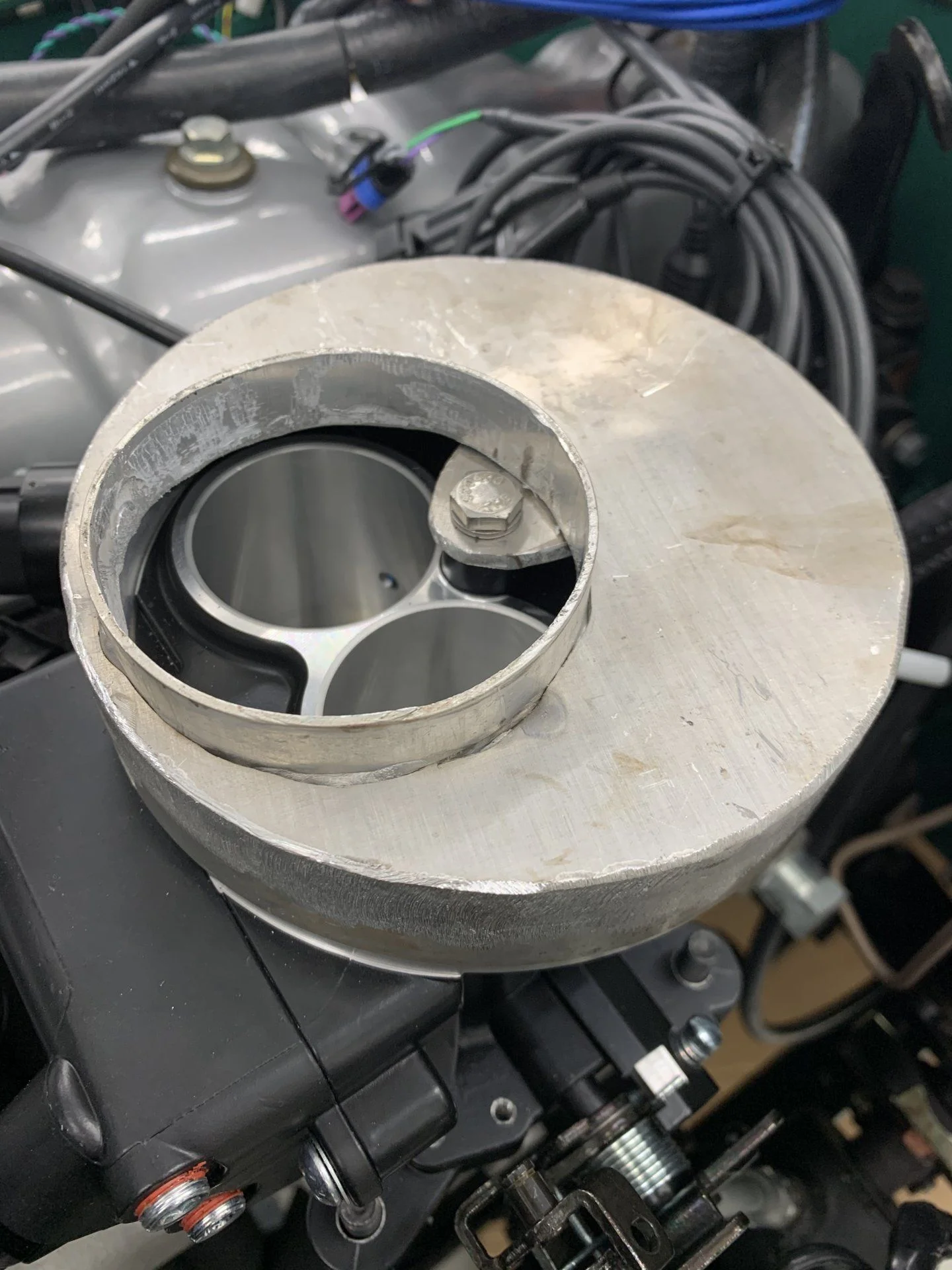

Finished up the F air cleaner adaptor. Originally used the all star 1/2” but it was too close to the Sniper. Final fit is the 1” adaptor and milled 1/2” off of Redline’s intake adaptor. I’ll clean it up and give it some paint next.

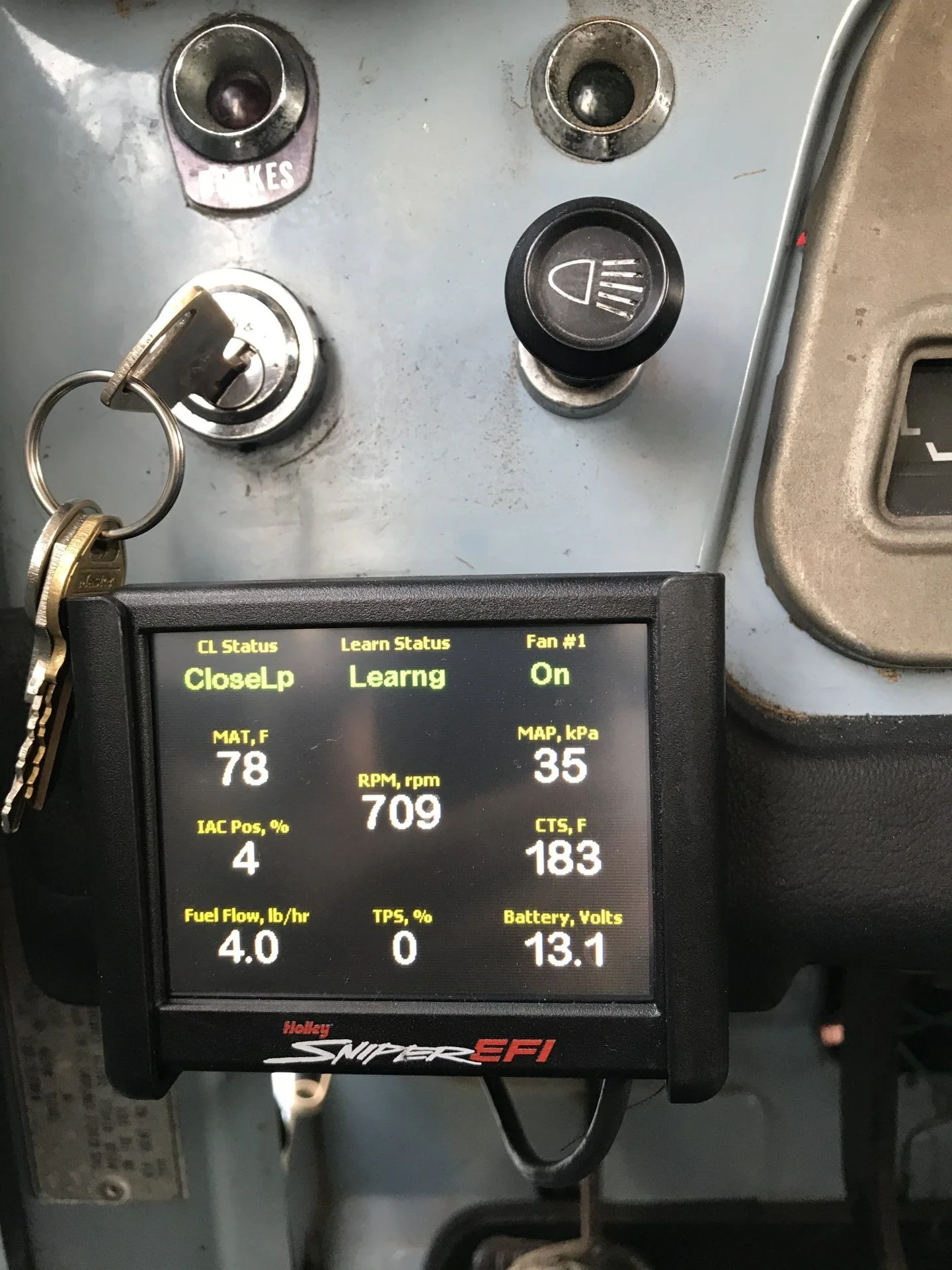

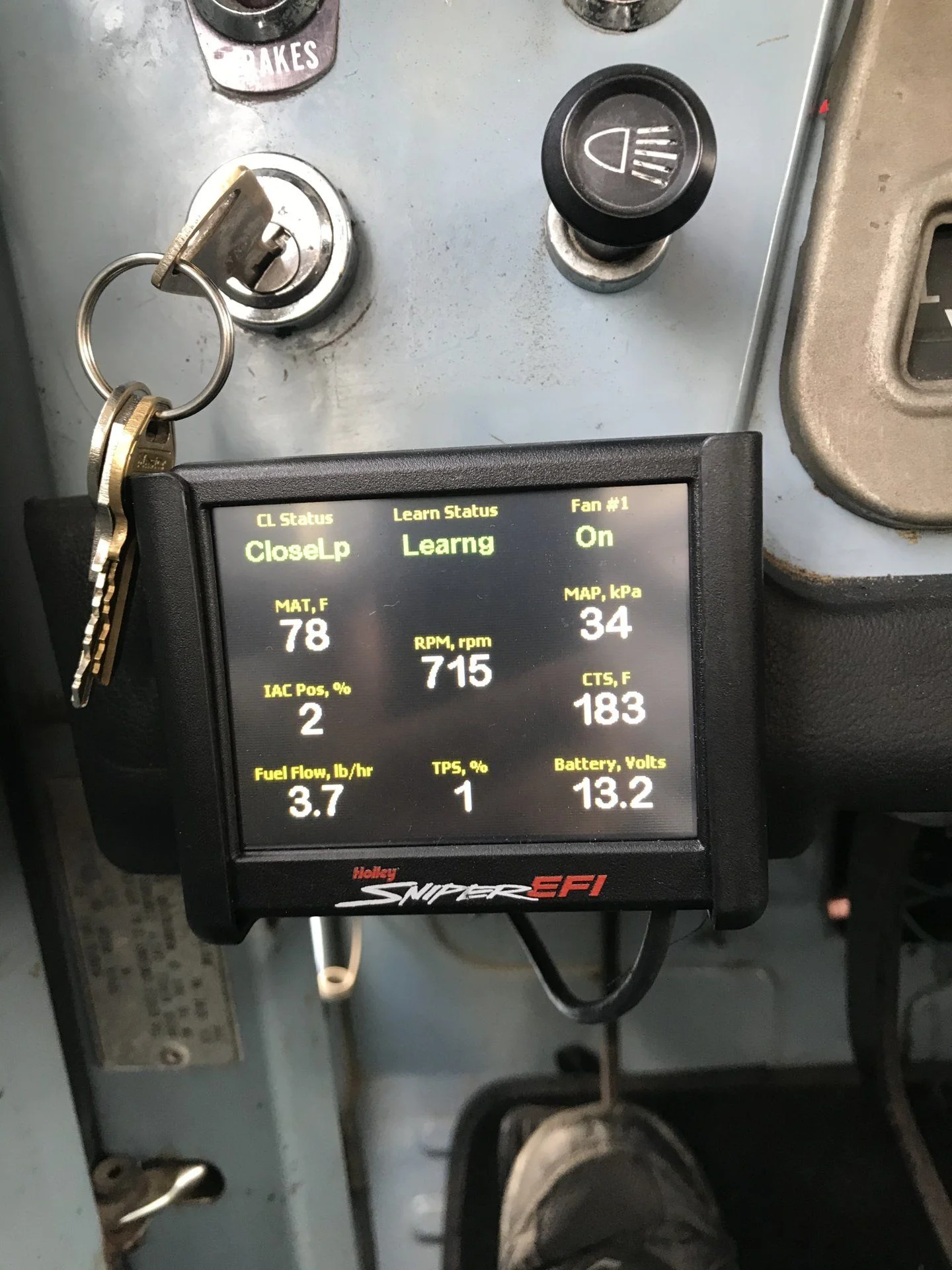

The TPS at one is not a big deal. Butterfly is closed.
My only problem is wondering if this is effecting the iac. Note the iac at 0 and at 1. I think I initially started at iac 6. It settled at iac 4 after driving for a bit.
I drove the 40 after it sitting for a few weeks and it drove great. I parked it then started again and the iac read 100. Went and adjusted screw and iac back down to ~ 6. Drove again, ran great. Turned off then started later and go the same 100 read. Not sure what’s going on

You can get an idea what the actual IAC is doing by putting your finger over the IAC port, the 1/2"ish hole on top, next to one of the barrels. If your display is reading 100, but your IAC is not actually open I'd say it's a bad IAC or bad connection somewhere. You should be able to hear and feel the air at the port, and the engine will slow if you plug the port.
On the TPS, keep in mind that it re-zeros whenever you cycle the ignition. If it doesn't return to zero then it is something that changed since the last time you started the rig. It doesn't really need to go back to zero every time you let off the gas, and doesn't really affect anything as long as it drops to 2% TPS or less. I did my best getting the throttle linkage and everything to move fee and clear but my TPS still doesn't always drop to zero. It just needs to get to 2% or less so that IAC will switch from the IAC hold position (% while you're driving), to controlling the idle speed.
There is always a lot of talk about getting the IAC % at idle to be between 2-10%. That is a good zone to be in, with the idle speed being dependent on the IAC. If the IAC is sitting at 0% it would not have any authority to slow the idle at all. Would cause no harm at all, you just might see it idle too high when the motor is warmed up. I have read having the IAC above 10% might affect the Ramp-down when you let off the throttle, possibly making the motor more likely to stall? But still not really that big of a deal. What I'm getting at is don't worry about getting the IAC position at idle just right. It tends to fluctuate a lot depending on different factors, that's what its supposed to do.

Thanks for the reply this is great info. It has gone back to normal after adjustment again. I’ve driven a few times since and no problem. Wondering if it is a defect or got stuck or something. I’ll monitor. I’ve found that having the iac set around 8-10 has suited my car better and no more stalls. Thanks for the info on the tps as well. It still starts at 0 but sticks at 1 after driving. I’ll learn to ignore

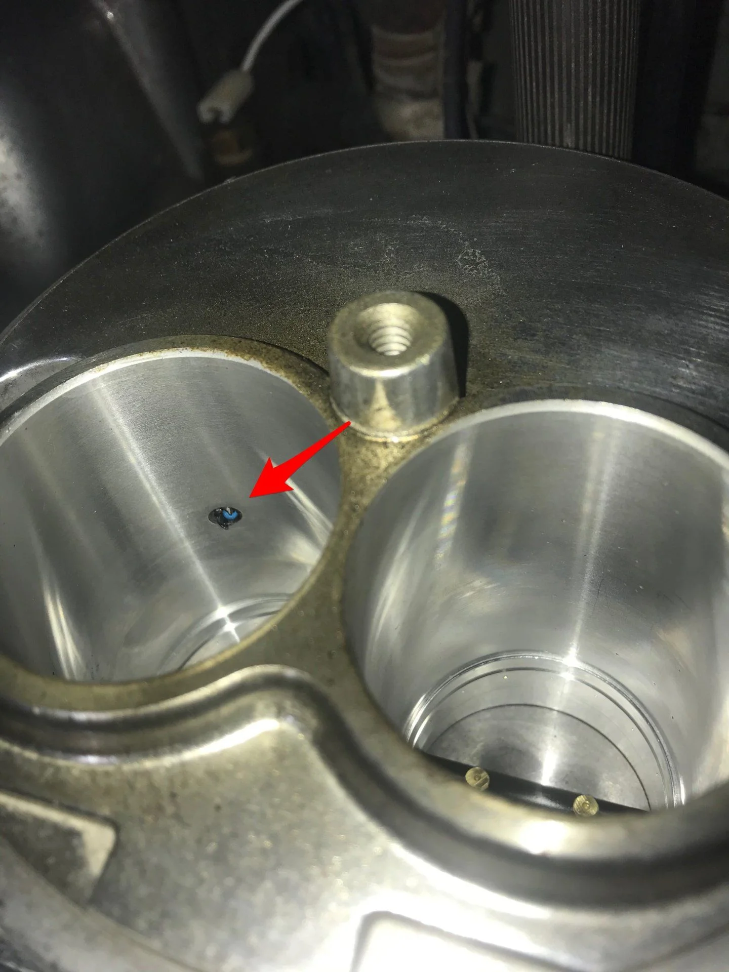

Still having iac issues. Not able to hold iac. Started at 100 again. Warmed to temp and adjusted. As soon as I get to around 10 it eventually does not hold and slowly drops to 0. Also, can someone tell me what the blue thing is and also I found much debris there clean off with a little carb cleaner and part of blue stuff came off.
Just another update. Started again, was able to set iac. I’m starting to believe it may be a bad iac motor.
Have you sent those pics to Holley to see what they think?
