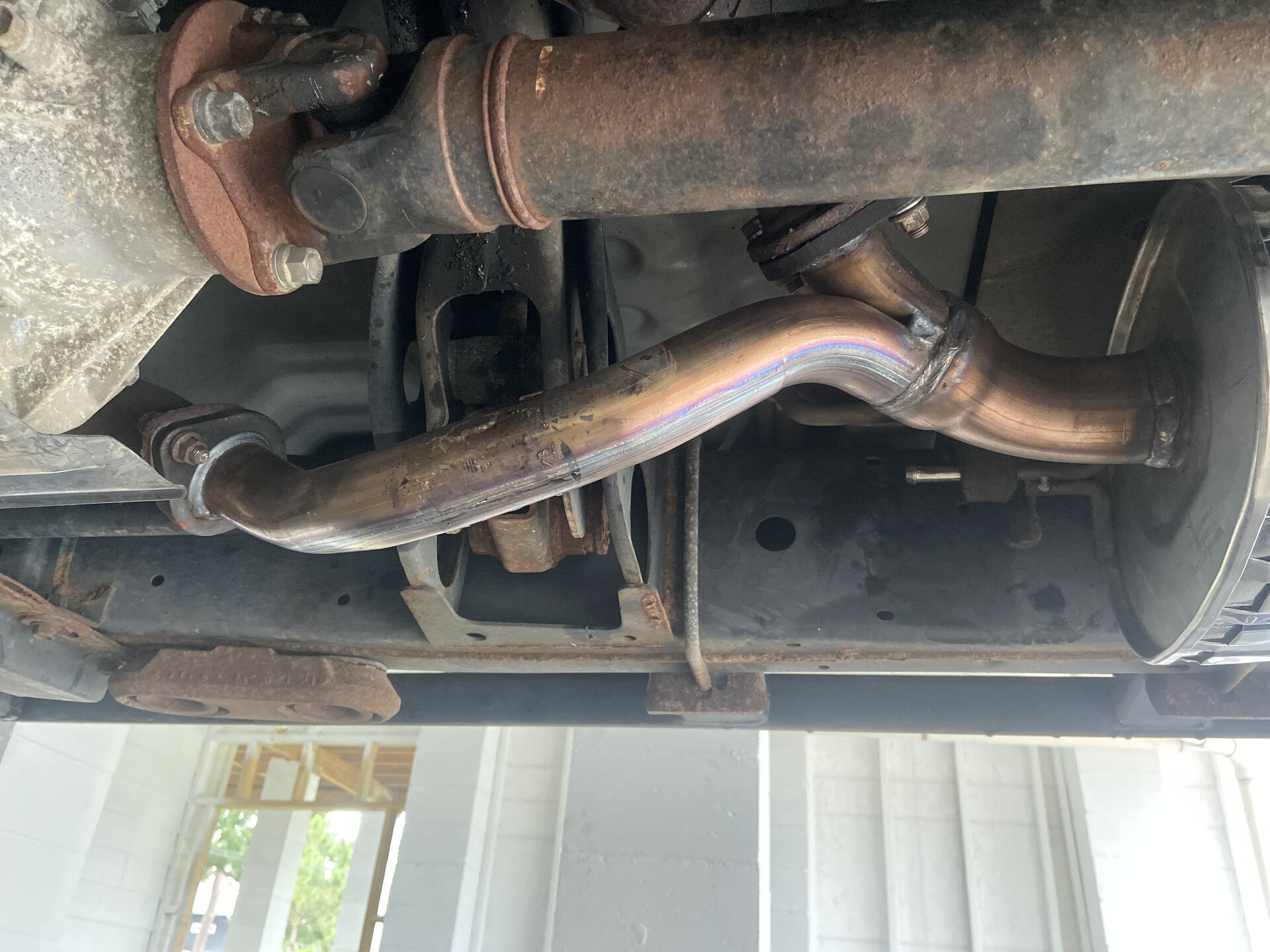

I’ve neglected to replace my OEM muffler for a while now and I regretted. While removing the old one I discovered why my locker hasn’t been working. These homes were also boiling the fuel in the fuel tank.
Just an FYI
In case someone find themselves needing a new muffler but wanting that stock sound, look no further. This thing might be quieter than stock…no joke!
Stainless Steel Exhaust Muffler compatible 1998-2007 LX470 Land Cruiser 4.7L https://a.co/d/1GhzyST
Rock Auto has a stainless Walker muffler (US made) for $118-ish.
Yes. I bought one and will document just how 'bolt on' it is. See it at www.Rockauto.com
The muffler claims to be stainless steel (in the Amazon ad) so maybe it doesn't matter. The trapped mud will be sound deadening ;-)

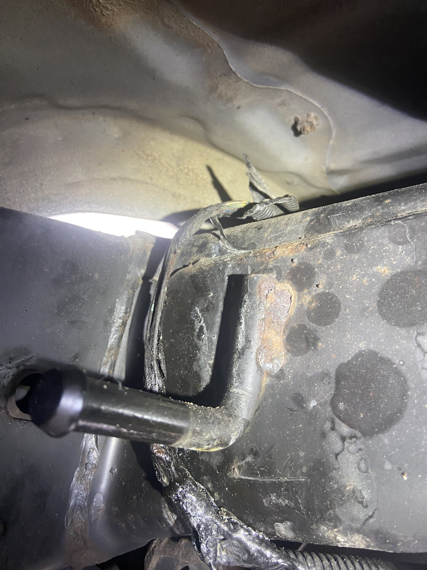

I just lost my rear locker to holes in the muffler, and the FlowMaster was an easy ~125 replacement. Thankfully the wiring fix was only another ~100. Doesn't sound as throaty though now that the exhaust is going out the back of the truck.

Did you get that harness section replaced or fix the burnt one?
