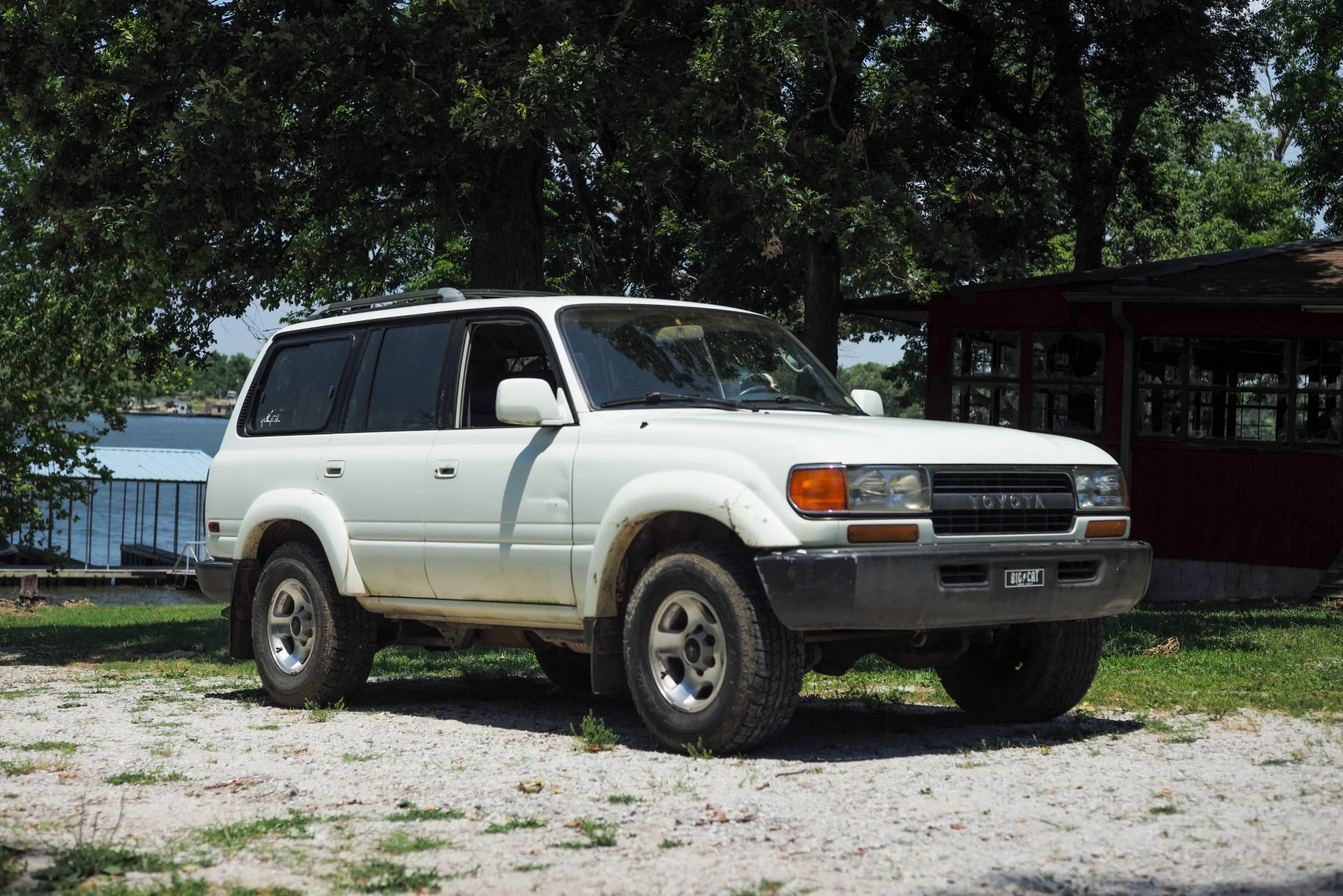

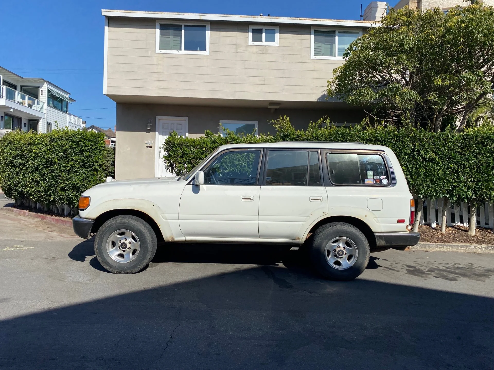

As we all do, I was lurking on Facebook/Craigslist/OfferUp while on vacation and I found what looked to be a solid, single locked 80 series in Missouri with 300,000 miles. The previous owner was preparing for a move the next day so I high tailed it over there to take a look. I decided it was good enough to make an offer based on a quick test drive and look around. I could hear the knuckles in need of attention while engaged in 4WD and saw a few outstanding issues straight in common areas, but no rust. I have no records to work from, so I'm flying blind with maintenance. The plan is to tackle basic maintenance, some while-you're-in-there items, and anything glaring we find along the way. I also noticed the radiator was leaking water once the truck shut off, so I'll likely be replacing the cooling system because who knows when that was touched. I did send off an oil sample to Blackstone and everything came back with a clear bill of health which is encouraging. The plan is to use OEM parts on everything I can get my hands on. As for the truck, I'd like to remove the flares, install some factory steel wheels, and find a cloth interior to build a simple truck for camping and wheeling. I've been using @PNWTreeOctopus 's thread as inspiration for a Pre-OBD 80 as well. Here's the list so far.

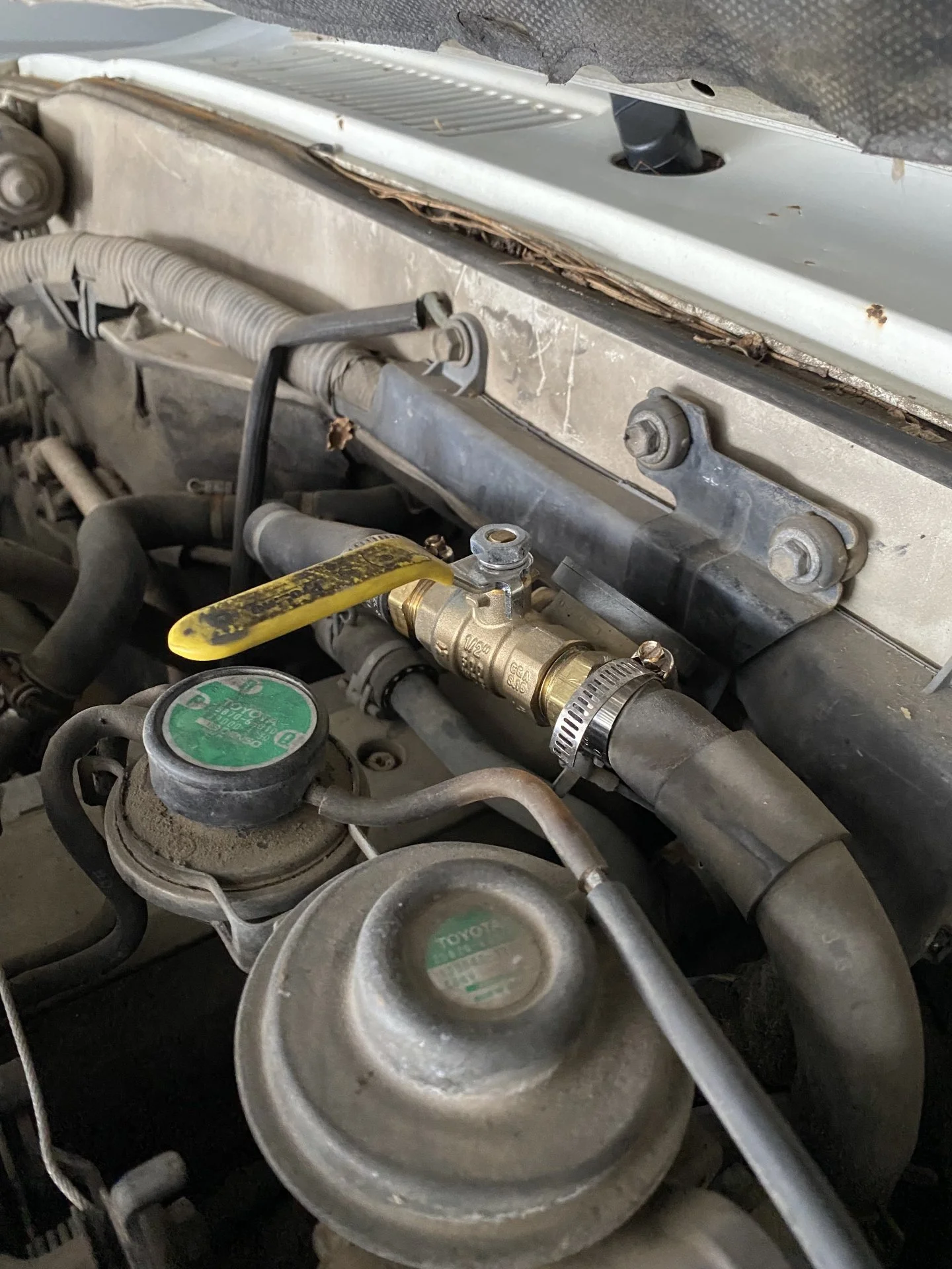

- Replace heater control valve and hoses: take a look at what I have now

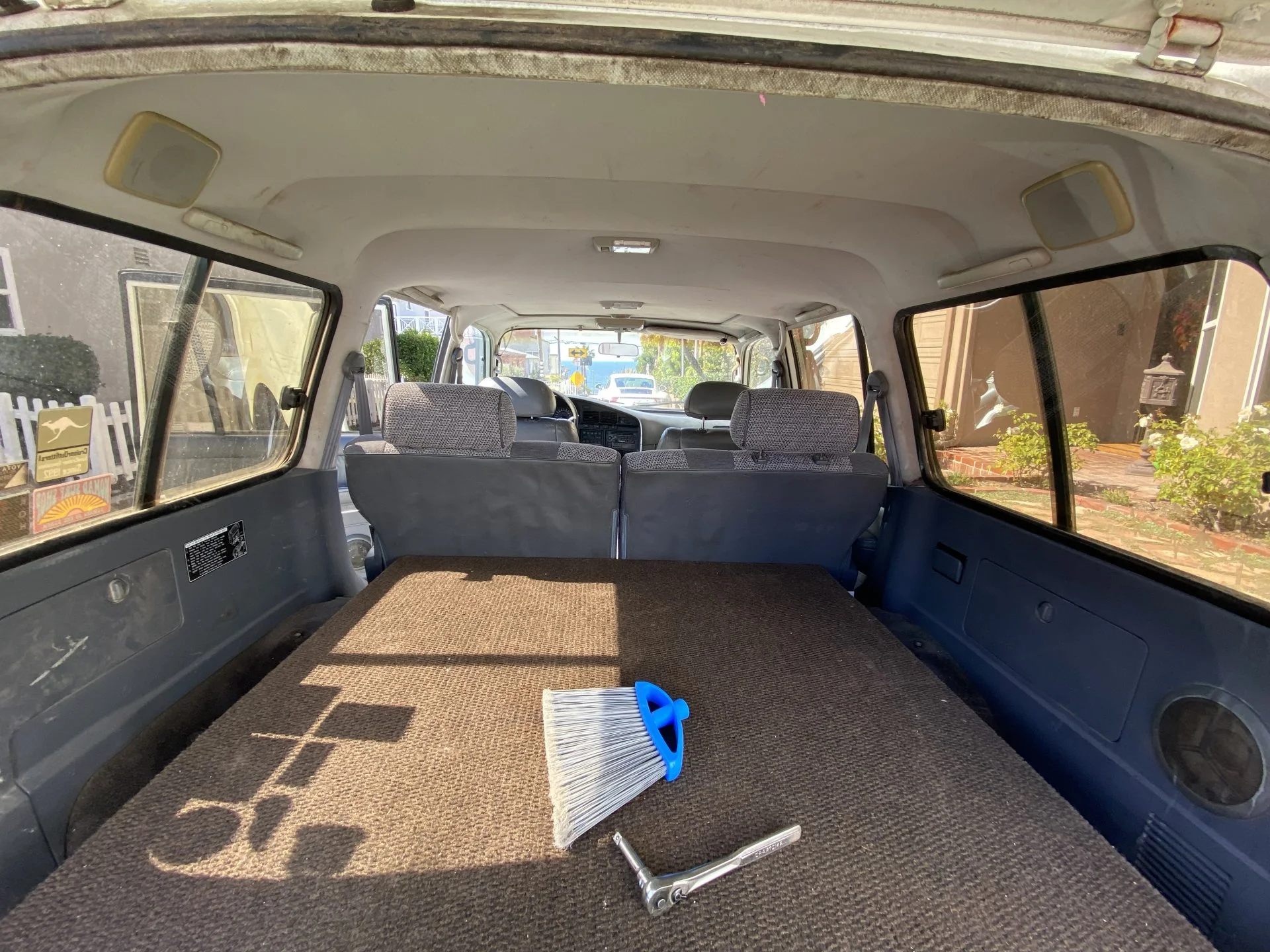

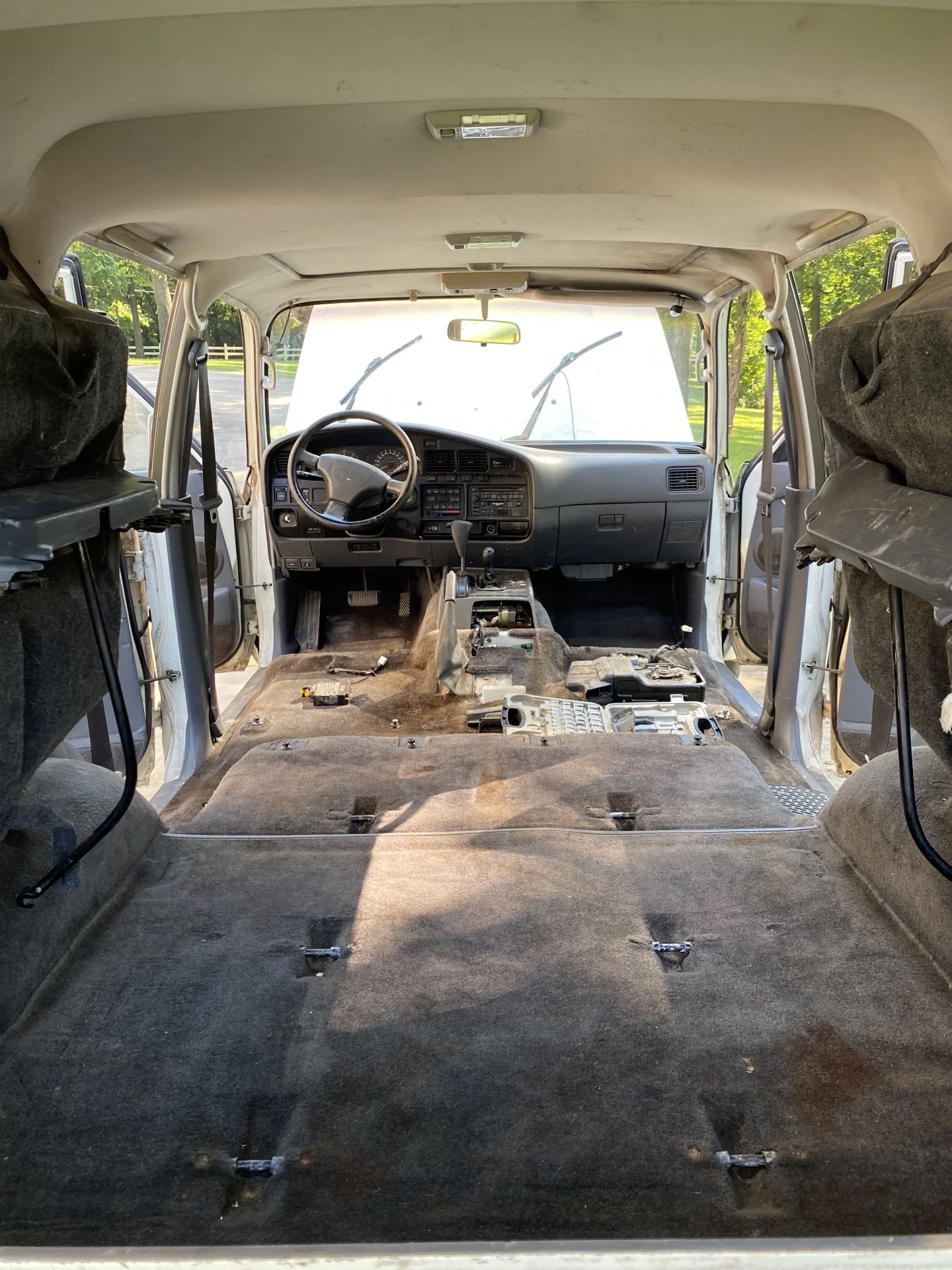

- Remove 3rd row
- Full clean

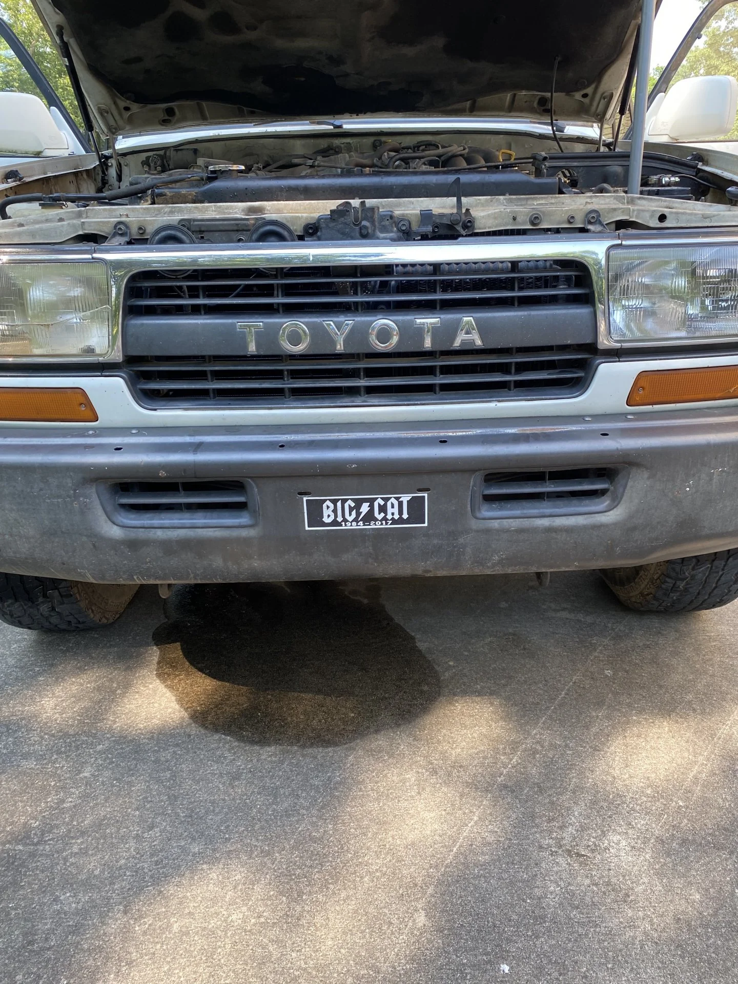

Nice 80, welcome. That’s some intriguing shade tree mechanic stuff going on in the engine bay. I’d be leery and check everything with a fine-toothed comb.

If that’s the “plumbing” do check the electrical carefully! Dont want to see a burning 80 on your thread!

Are you keeping the 2nd row seats? Was it cloth to begin with? I’m excited to see your rig saved from PO questionable maintenance. The ball valve heater “switch” would be so mad max if it was inside the rig!
@PNWTreeOctopus is a great foundation to follow. Looking forward to your journey.
Yes the heater valve switch gave me a bit of a laugh. That’s what I’m basing my level of trust for the PO on.

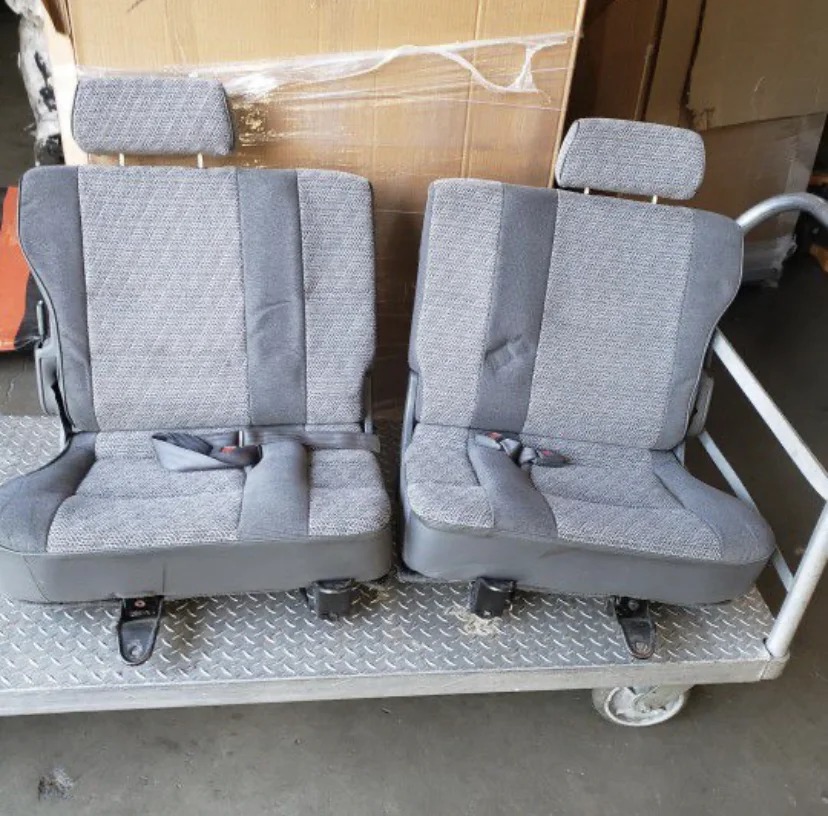

Picked up a cloth second row locally. Now hunting for front cloth seats if anyone has a set or a lead on a set. @slow95z do you happen to have any cloth fronts in good shape?
If I can’t find any, I’m leaning towards finding some Recaro L series seats in gray.
Not that I am looking to sell, sorry man. Things are hard to find and I am now hanging on to every set I get in. The local crew has dibs on the next 3 sets I come across

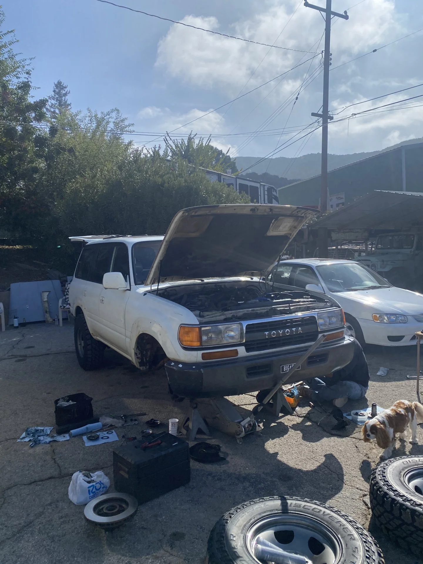

My brother @Hokie LX and I finally took some time to dig into the project. I ordered a heap of OEM parts from various sources. We had an ambitious schedule and a less than ideal workspace for the project. The plan was to get as much done as possible in the 3 days before hitting the road from Oklahoma to California. Up to this point I'd only driven the truck 3 miles. We had a craftsman 200-something-piece tool set, a floor jack, some jack stands, and a bag of screwdrivers, specialty tools and a new Milwaukee power ratchet. Love that thing. Here's what we got done;
  1. 100 series rear springs
  2. OEM rear shocks
  3. Complete cooling system overhaul - flush, drain, replace hoses, new Koyo radiator, new cap, toyota red, burp
  4. Fan clutch oil upgrade to 10,000 CST oil
  5. Water pump
  6. Thermostat
  7. Throttle body gasket
  8. Heater control valve + all available hoses
  9. Pesky heater hose
  10. Valve cover gasket
  11. Spark plugs + spark plug seals
  12. Distributor o-ring, cap, and rotor
  13. Misc. vacuum hoses
  14. PCV valve replacement
  15. Starter rebuild
  16. Air filter
  17. Knuckle rebuild + nut huggers
  18. Brake rotors
  19. Brake calipers
  20. Oil change + OEM drain plug
  21. Fresh diff and transfer case fluid all around + magnetic hex plugs
  22. Belts
We didn't get to the ATF flush, fuel filter replacement, oil pump seal, or the front shocks because of time. The old aftermarket shock retainer washers didn't fit my OEM units so they didn't go on. I did some searching and it seems like they're a common and expensive remedy.

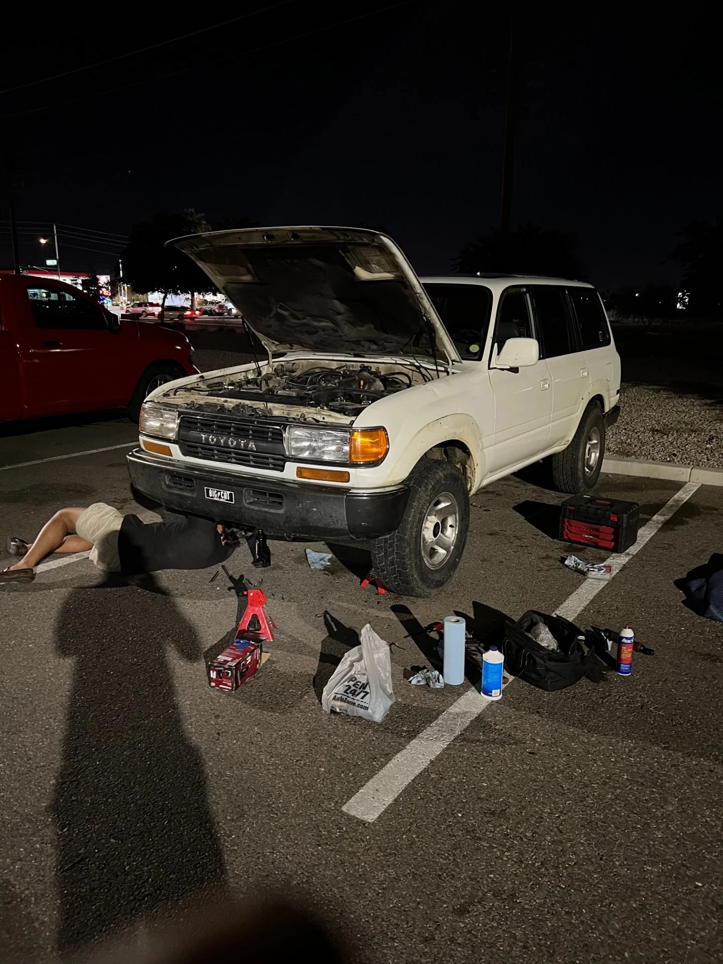

We hit the road from Oklahoma City to Amarillo to get an initial test drive in before the long haul to California. We learned a lot about the truck - what worked, what didn't, what was missing, and what needed addressed. We shoved some shop towels in the mirrors to stop the wobbling which did an amazing job, but I'll definitely need to find a long term solution. We also decided to tear into the knuckles since they were leaking really badly. The whole trip was a struggle of not having the right tools or a full garage to solve problems with so we took plenty of trips to the parts and hardware stores in between work.
We spent an extra day in Amarillo to wrap up the knuckle job and fit some fresh brakes on the front. I got hung up with the OEM axle seal retainer spring which popped out while I had a shop towel stopping the drainage. That was a demoralizing segment of the job, but I was able to wrangle it back into place without removing the seal and potentially damaging the only good one we had with us. My brother was fighting two broken knuckle studs which delayed his progress as well. Once we hit the road, things went smoothly enough. Our plan was to trek from Amarillo to Los Angeles in one straight shot (1,100 miles/16 hours). We made smashing progress until Prescott, AZ where I learned about the caliper bolts tendency to uninstall themselves. The bolts backed out, tossed the caliper off the rotor, and took the dust shield and brake line with it. Luckily we heard the bolts jump out and pulled off the highway just in time for the front wheel to seize.

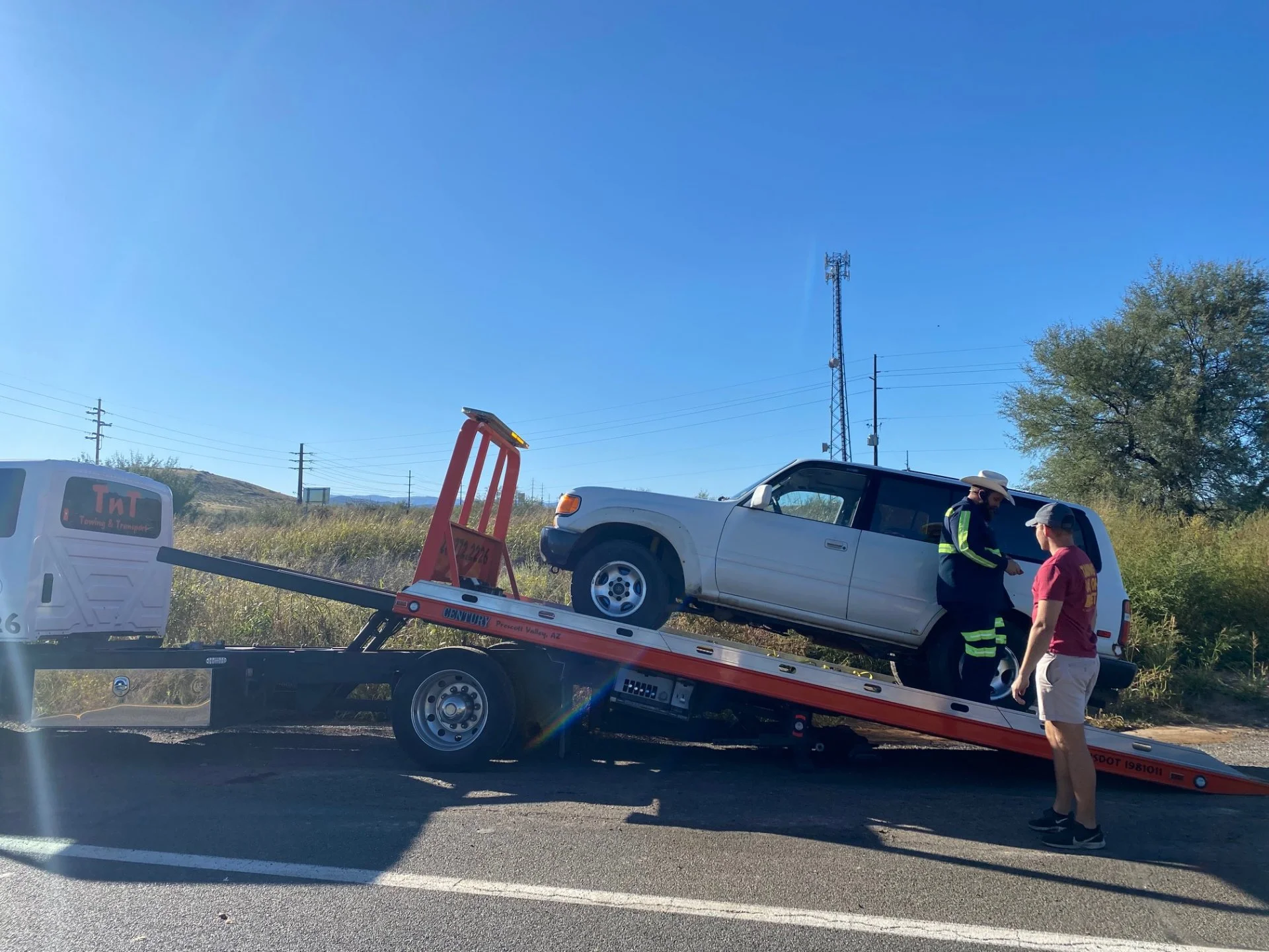

We were able to get a AAA tow to Phoenix where an AutoZone had everything we needed to fix the issue. After a 4 hour parking lot session to swap all the brake components, double check torque settings, assess damage and clean up we were back on the road. At this point, it had felt like two different days. We hit the road once again and made it to Los Angeles after 26 hours on the road.

Our workshop
The only "Brakedown"
Subsequent AutoZone repairs

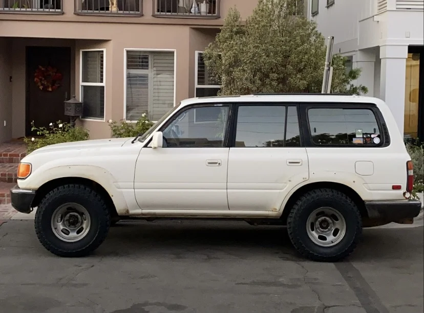

Once getting back to LA, I was eager to mount and install my new OEM steelies I picked up from @PDBJ70 and throw some fresh rubber on. Now that the flares had been removed (pending body filling and paint) I needed some skinnier tires to match the look I was after. I opted for the Cooper STT Pros in 255/85/16 measuring roughly 33" x 10" which I loved the look of. The options for this tire size were limited to mostly mud tires which I didn't want for the type of driving I do, so the Coopers were the only option I considered for an AT/MT middle ground.
Here's the before and after

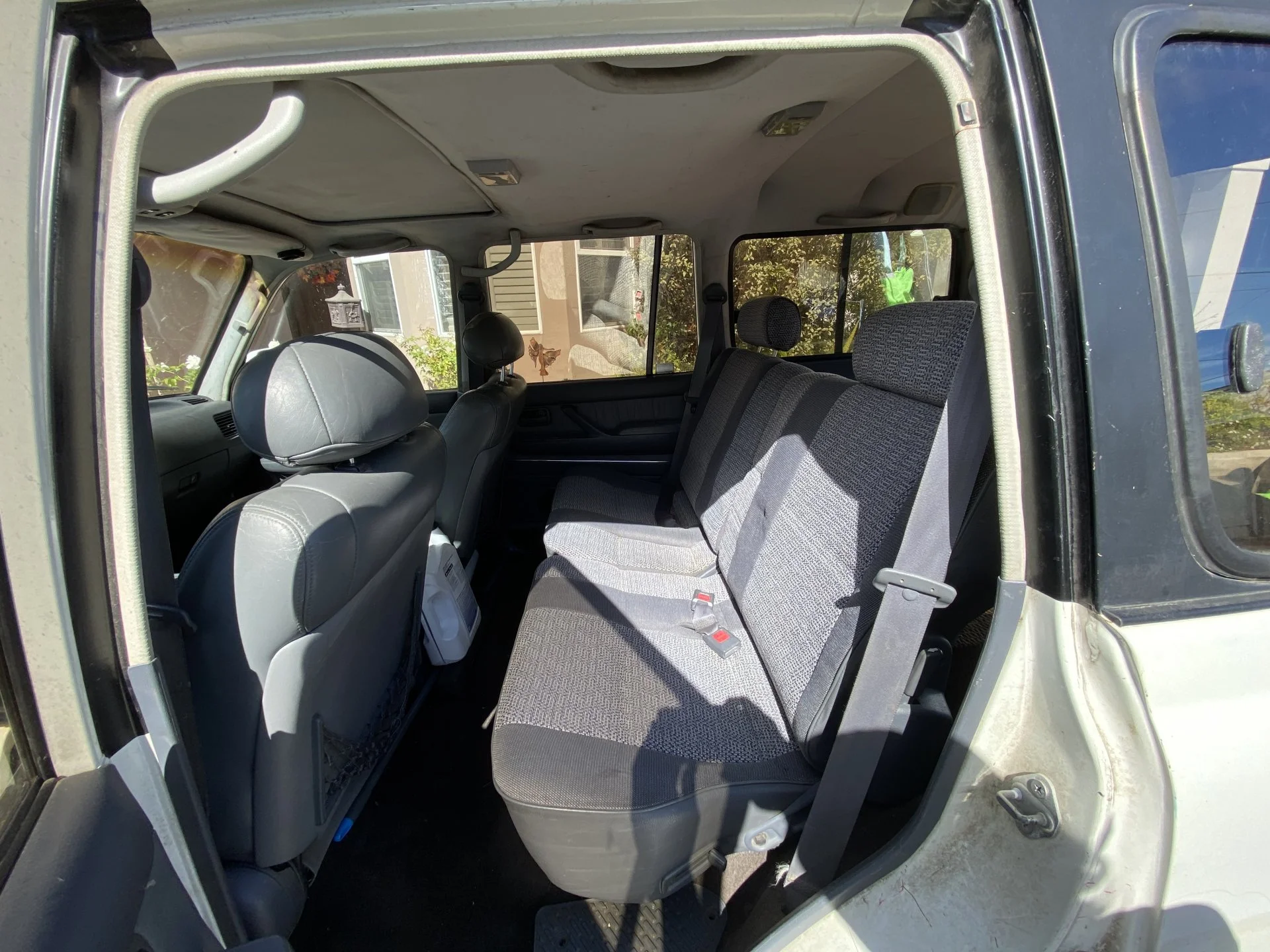

Installed some rear cloth seats I picked up locally. Still on the hunt for some gray cloth front seats if anyone had a lead on the west coast.

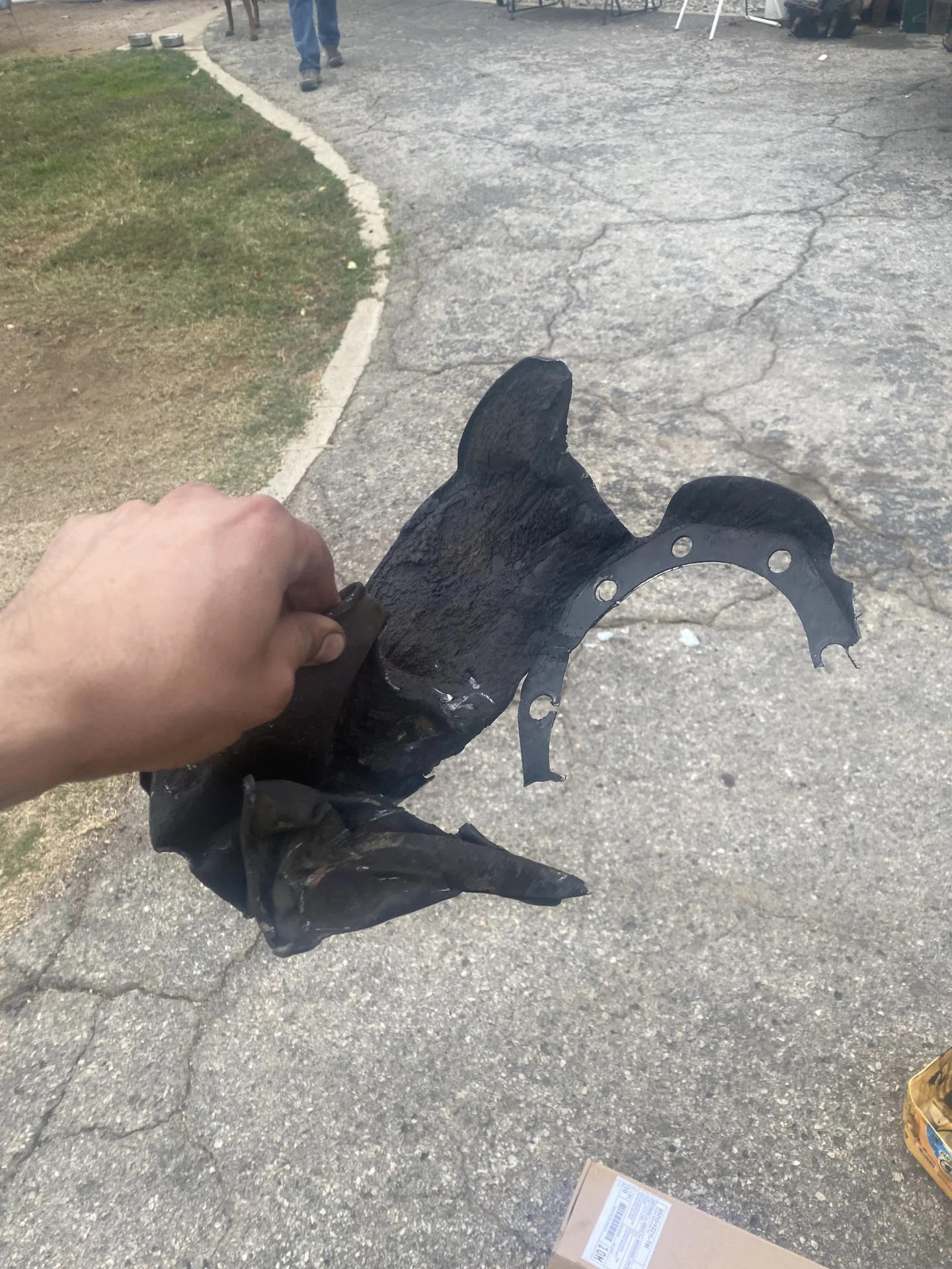

Finally had the chance to tear into the front axles with some good friends. My birfields were still clicking after the rebuild so I picked up some Joint Fuji units to swap in. My front dust shield was also totally mangled from the caliper incident so I needed to get back in there for two reasons.
I’m glad I went back in there because the drivers seal failed when the axle came out. Could have been a matter of time. I swapped in some marlin crawler eco seals, which I should have done in the first place.

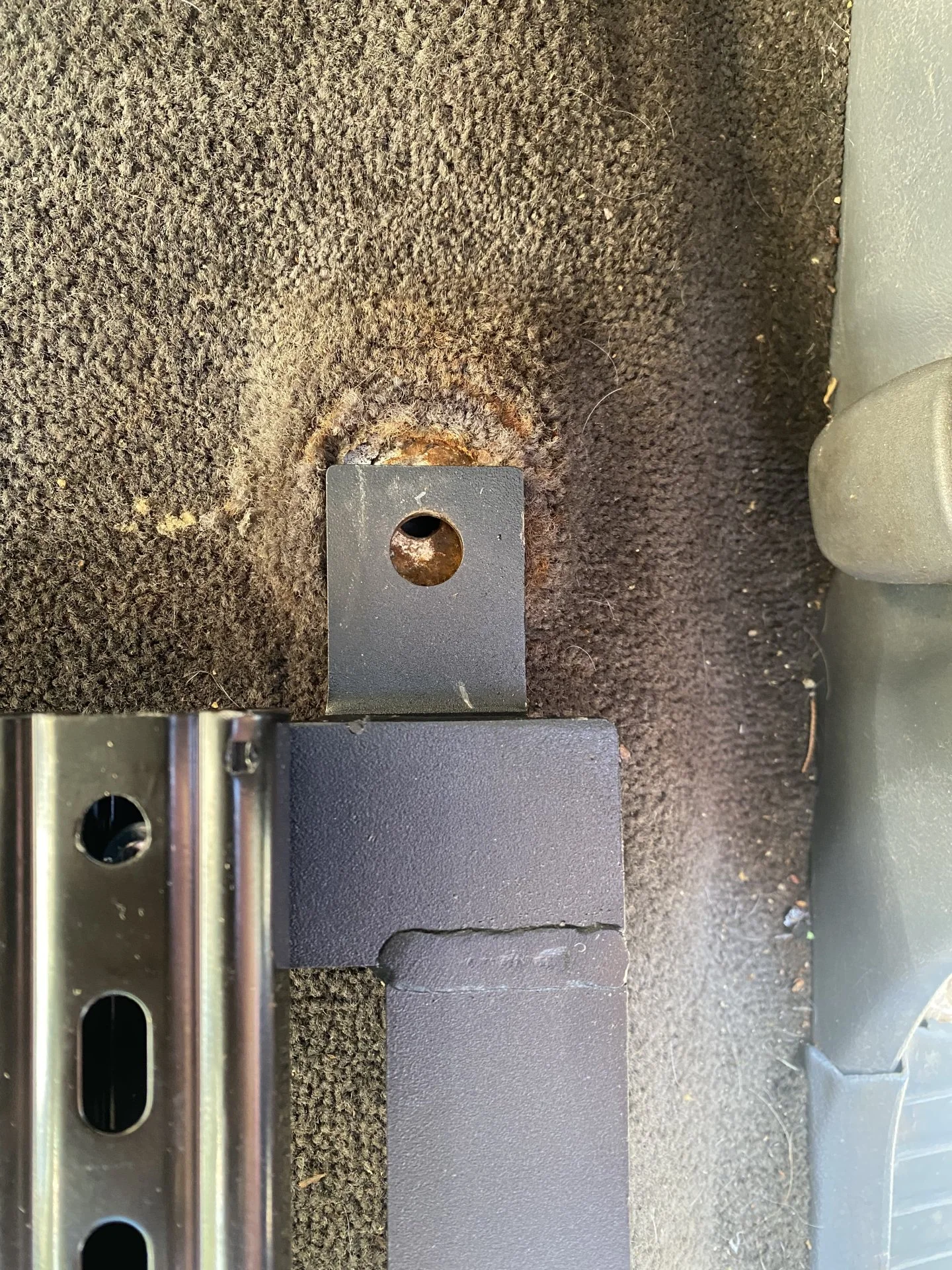

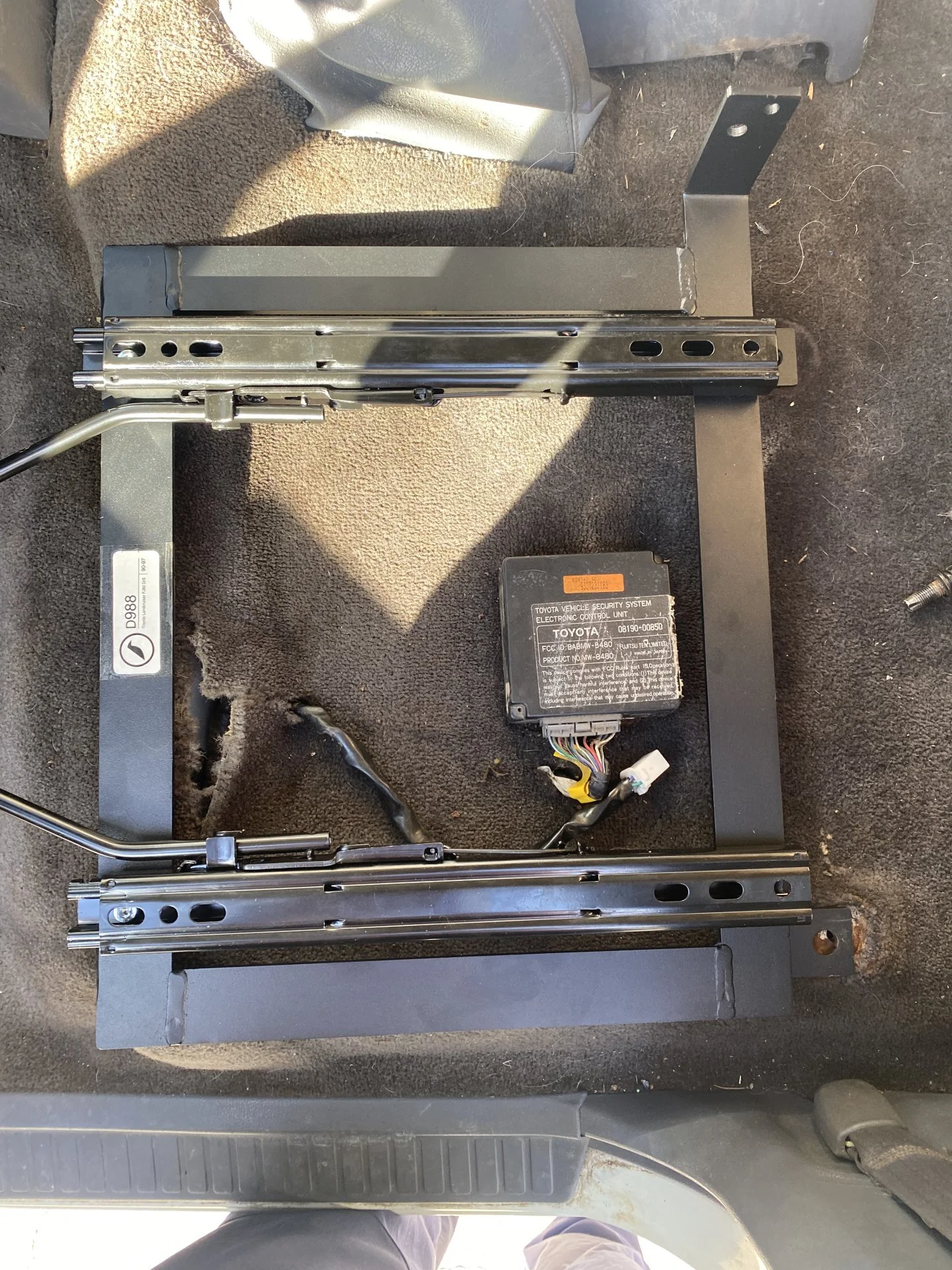

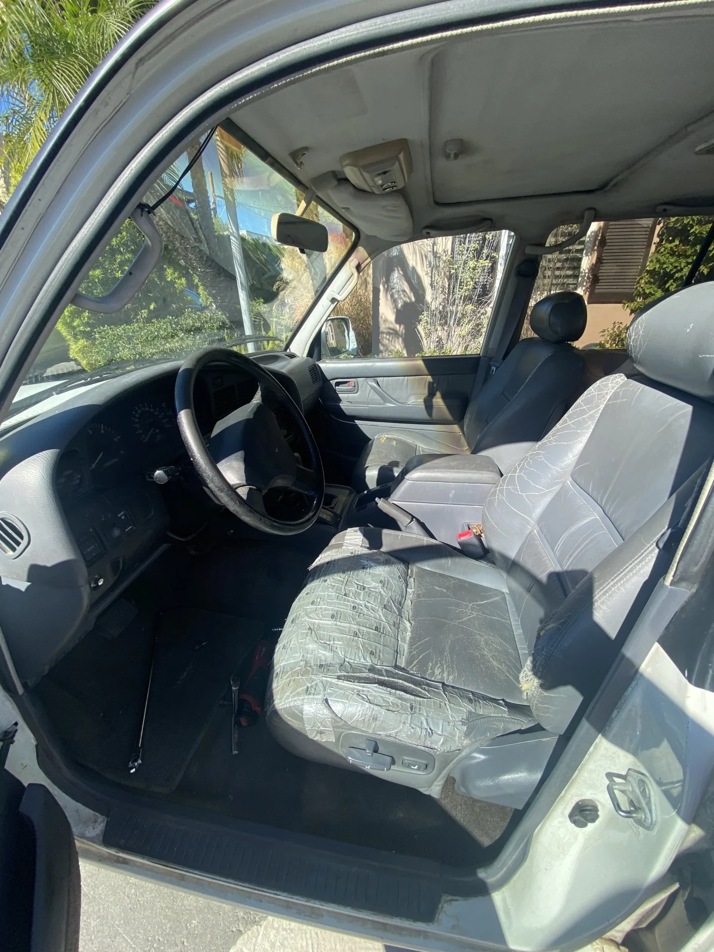

The most recent project for the truck has been replacing the tattered leather seats with an extra set of FJ60 cloth seats to match-ish my cloth rear seats.
I ordered the corbeau brackets to mount my 60 seats up, but the bracket is drilled incorrectly. With the front holes lined up, the rears are about a half a hole off. Seems to be the standard with these universal brackets, but I reached out to corbeau and it seems they’re able to make custom brackets to accommodate the factory holes if I send them some measurements. Going to return this set and see if they can get it right.
Best part about the seat swap is getting rid of the heavy power seats for manual sliders. Probably will save 35 lbs in total. Good news for my drag racing.
Before and after
Did you steal the seat from your 88 fj62? Or did you have a spare? You must have had a reason to go this route...the seat swap journey is obviously a personal one. My 93 has seats that are starting to look tired, and the variety of seat solutions is like a menu at Dennys-seemingly endless choices, but none of them are what I really want.
