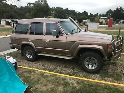

1985 HJ60 High Roof Sahara. Australian Spec as far as I can tell.
2h with aftermarket ARB turbo
Stock everything else.
It's spent the past 3 months living a hard life with backpackers, but the body is good with rust repairs being completed and an OK respray being done.
Now for the bad news. Below is a list of repairs the mechanic has identified to just get the vehicle road worthy. It runs and drives right now, but it smells like diesel inside the car and it huge clouds of smoke blow when I accelerate :-)

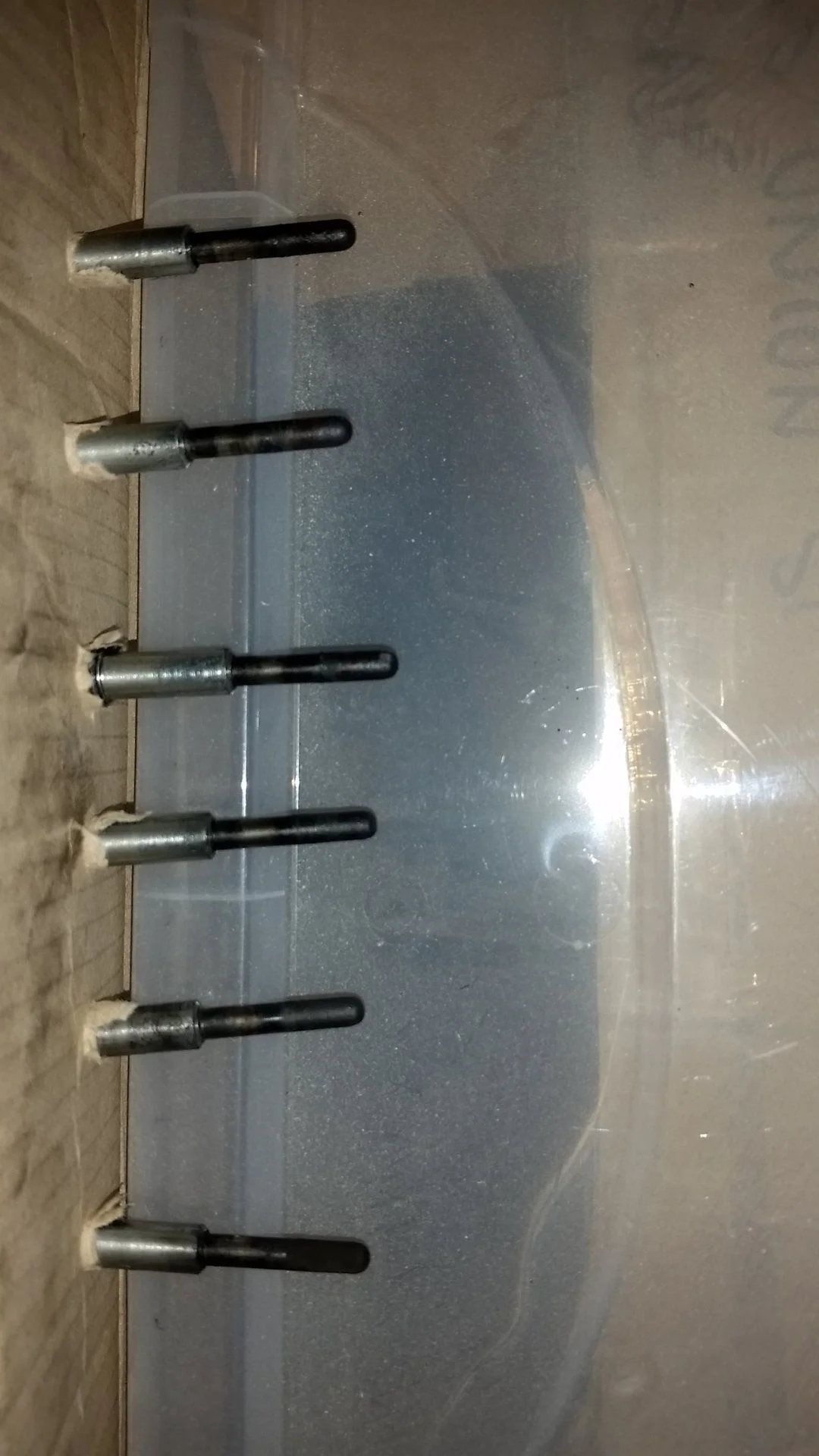

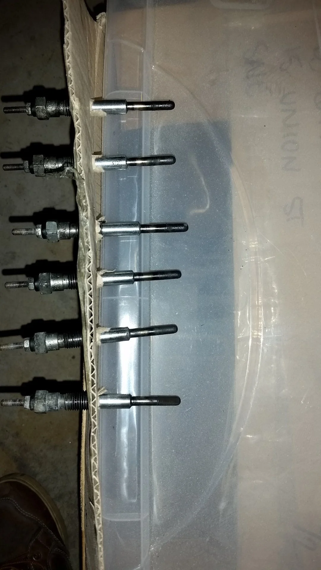

But the glow plugs look pretty fouled up though. Should I be changing them?
1999424
Yep, normal looking glow plugs. If stuff builds up on them, they can be hard to remove from the engine, so carefully clean off any crunchy bits clinging on and reinstall.

Thanks guys. Good to hear they're ok. Reinstalled them.
