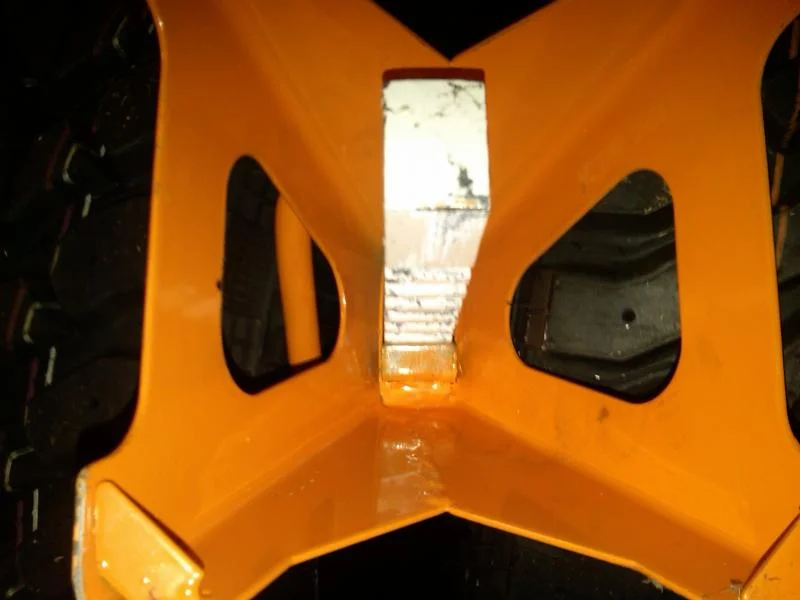

To make a short story longer... two and a half weeks ago, I was under the front of the truck. I had done the lift on three corners with just the driver's front to go. I still had the passenger front tire off and the frame supported on a jackstand (mistake :frown:)
I was on my left side removing the steering damper when the jackstand failed. That's right, it didn't slip off, it failed. The truck came down on the brake disk and the ARB hit me on the right collar bone compressing my chest into the driveway. I was yelling loud enough that the nieghbors and my wife came running.

I do take responsibility for the stands being too small. I figured a 3ton stand would be plenty for one corner. I've used then on numerous cruisers for years. In my defense. I've had these stands so long that I didn't know they were HF specials. I should be dead. The really scary part to me is my three year old was helping me. Fortunately, I make her sit on the porch when the truck is up on stands. I can't imagine what she'd have had to deal with if she had watched me kick off. I'm hoping to finish the lift in a couple of weeks (it may be longer :rolleyes:) and get some progress pics.
Anyway, here's the pics. Sorry for the quality of the first one. My wife was trying to be sneaky. The second and third show what happened to the stand.

so, what exactly failed on that thing? the latch or a tooth or ?

It was the tooth part of the stand that failed. It's hard to see, but the whole area that the tooth attaches to bent down. The stands were just too small. I'm very safety concious, but I've had these stands in the garage for so long I took them for granted. They've done that same job in the same spot on at least three other cruisers.

From your description, I"m not sure what exactly failed. Was it the white part with the teeth, or the orange part where the white teeth engage?
And where on the frame was the stand? Was this one stand holding up half of the truck, or just one corner?
I'm amazed that failed. each stand is rated at 1.5 tons, 3000 lbs. These cruisers weigh around 5500lbs or so stock, and of course can reach up to 7500 modded and loaded, maybe even a tad more. So even with the ARB, it's hard to see that stand being loaded more than it's rated. It looks like it failed even though it had not been over-loaded.
And most equipment like this is actually built to be over-stressed and not fail, like a built in safety margin. For example, winch cable is rated at so many pounds, but they will actually take quite a bit more before failing. Not so on these stands I guess. Or maybe this particular one had a bad weld or maybe it's just crappy steel. (probably)

To answer questions, the tooth assembly failed. I'm not sure how other than it's bent downward. There's no way to get to it to look so when I'm up to it, I'm going to cut them apart and look.
The stand was placed under the frame right behind the mount for the control arms. It was only supporting one corner. I totally agree that there needs to be a more straight forward way to rate the stands. :mad:
