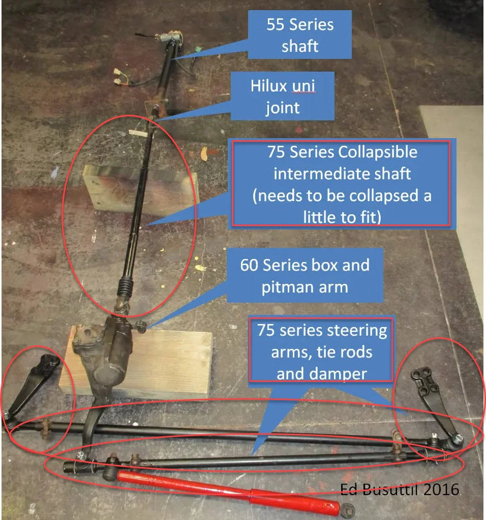

I'm about to upgrade my Oz delivered 1971 FJ40 to power steering also using a McKinnon's 60 series steer kit.
Mine's a little more involved as my early one piece steering column presumably differs from yours and I'm ditching it for a later/safer collapsible one - you don't state your year, so not certain.
I'm also repowering with a 1HZ/H55F and fitting front disc brakes, so my engine's PS pump will differ.
My collection of parts is based on the following recipe.
Note that there are 2 different 60 series PS boxes - one with offset and one with parallel mounting points, so your kit shuld match the bolt hole pattern of the box you've sourced to use.
I also won't use the exchange 40 Splined Column with Shaft and as I'm just focusing on chassis prep at the moment, I won't have the 60 Steer Fabricated Shock Towers or Custom Battery Bracket until later in the project.
Hope this helps

I'm about to upgrade my Oz delivered 1971 FJ40 to power steering also using a McKinnon's 60 series steer kit. Mine's a little more involved as my early one piece steering column presumably differs from yours and I'm ditching it for a later/safer collapsible one - you don't state your year, so not certain. I'm also repowering with a 1HZ/H55F and fitting front disc brakes, so my engine's PS pump will differ. My collection of parts is based on the following recipe. Note that there are 2 different 60 series PS boxes - one with offset and one with parallel mounting points, so your kit should match the bolt hole pattern of the box you've sourced to use. I also won't use the exchange 40 Splined Column with Shaft and as I'm just focusing on chassis prep at the moment, I won't have the 60 Steer Fabricated Shock Towers or Custom Battery Bracket until later in the project. Hope this helps View attachment 3651539
