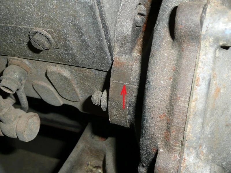

Where the marks "lined up" originally, before you removed the IP ?
The pump in the pic above is advanced.
Im pretty sure they were. Although looking at your pic seems like a very slight possibility that mine is ever so slightly out of alignment if yours is factory advanced setting..
If you look very close at the pic you'll see two marks on the IP and one on the engine block......The very tip of the red arrow is on the lower mark.
Yeah right... well i made mine dead on the long line, i think maybe i have set mine slightly retarded in that case. Really wish i took a photo of that mark before removing but i just thought the pump would simply slot back in exactly as it came out and boy was i wrong! :(
It was out of time as i didn't reassemble correctly! 😅 all good now just a tad smoky (think i damaged the IP diaphragm a lil when i removed it to adjust the fuel control lever)
