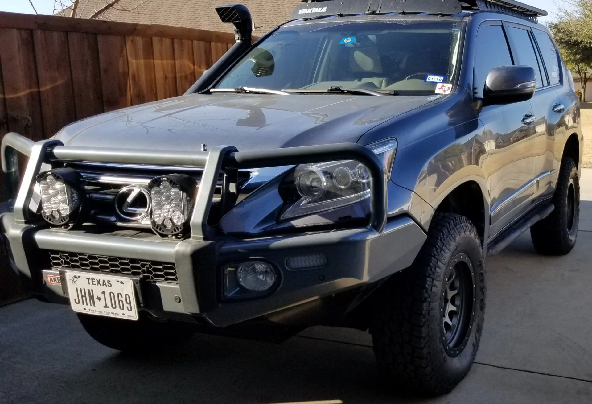

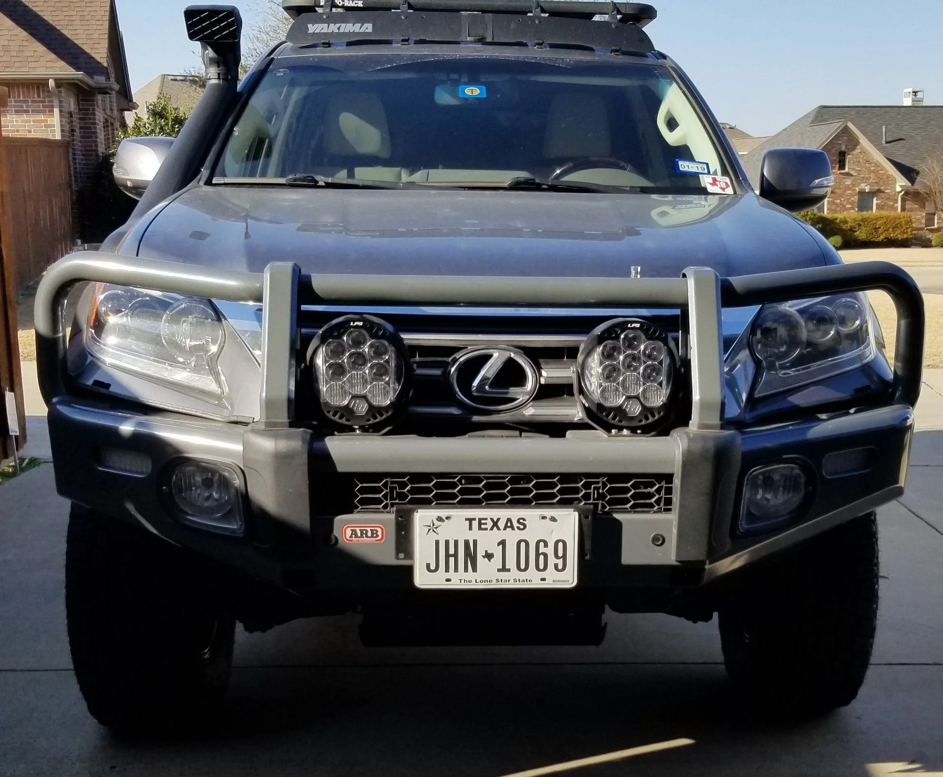

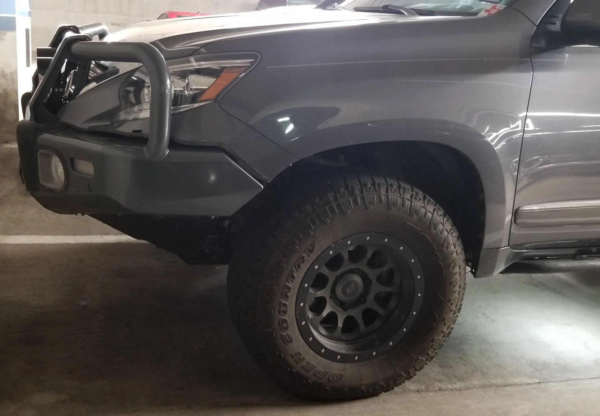

Thanks Rambler. Below are some I don't think are elsewhere in this thread. If you have any detail requests let me know and I will take some new ones.

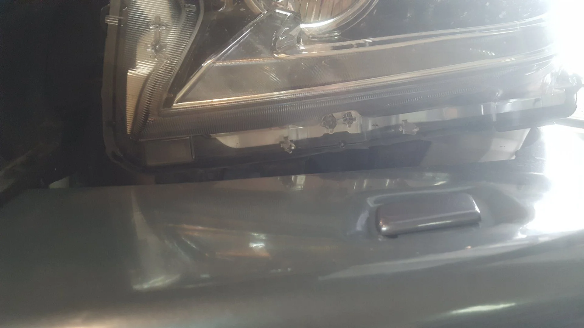

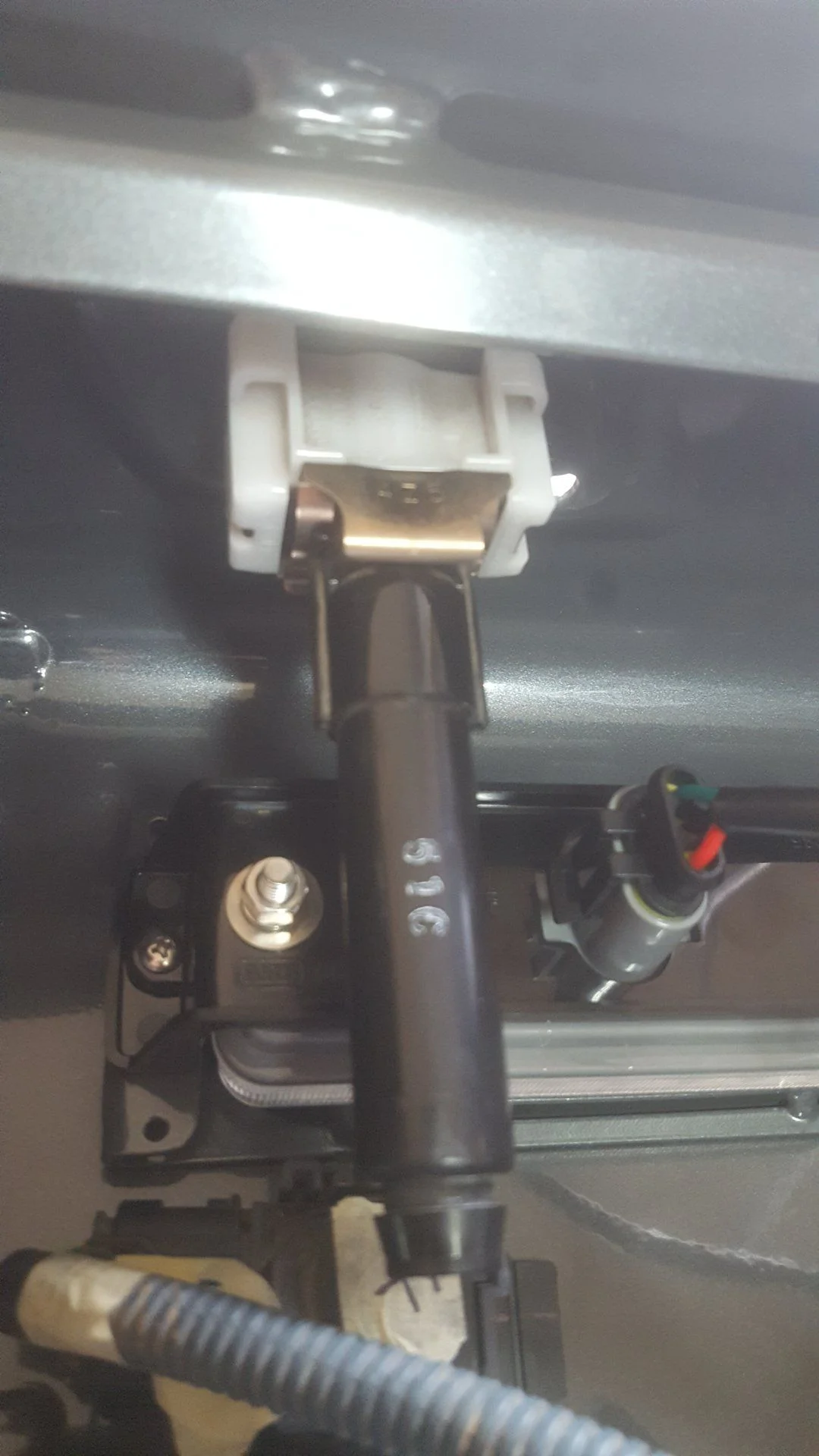

You ended up not using the headlight washers...was there simply not enough room with the added U channel trim? I did this bumper on my 5th Gen T4R and trimmed it to literally touch the bumper (used clear bra on the bumper underneath) and had no issues. So wondering if it would fit or not if extended down further to the bumper? It looks close in the pictures.
Actually I did reuse the headlight washers. They just were relocated to the ARB bumper, instead of the factory bumper trim. You can see it in the photos below (inside and outside of the bumper):
Thanks Rambler. Below are some I don't think are elsewhere in this thread. If you have any detail requests let me know and I will take some new ones. View attachment 1811851 View attachment 1811852 View attachment 1811853

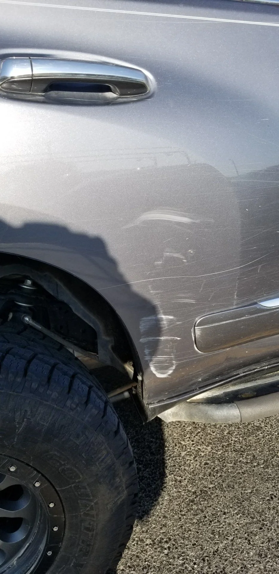

Did you buckle any body panels on that trail? Or just pin stripping.
Mostly just pin striping, some deep. I have a small dent in my passenger rear door where I bumped a tree on a turn just behind the slider, but otherwise survived without damage. In the leaning photo above the wheels and sliders kept the vehicle from impacting the wall.
