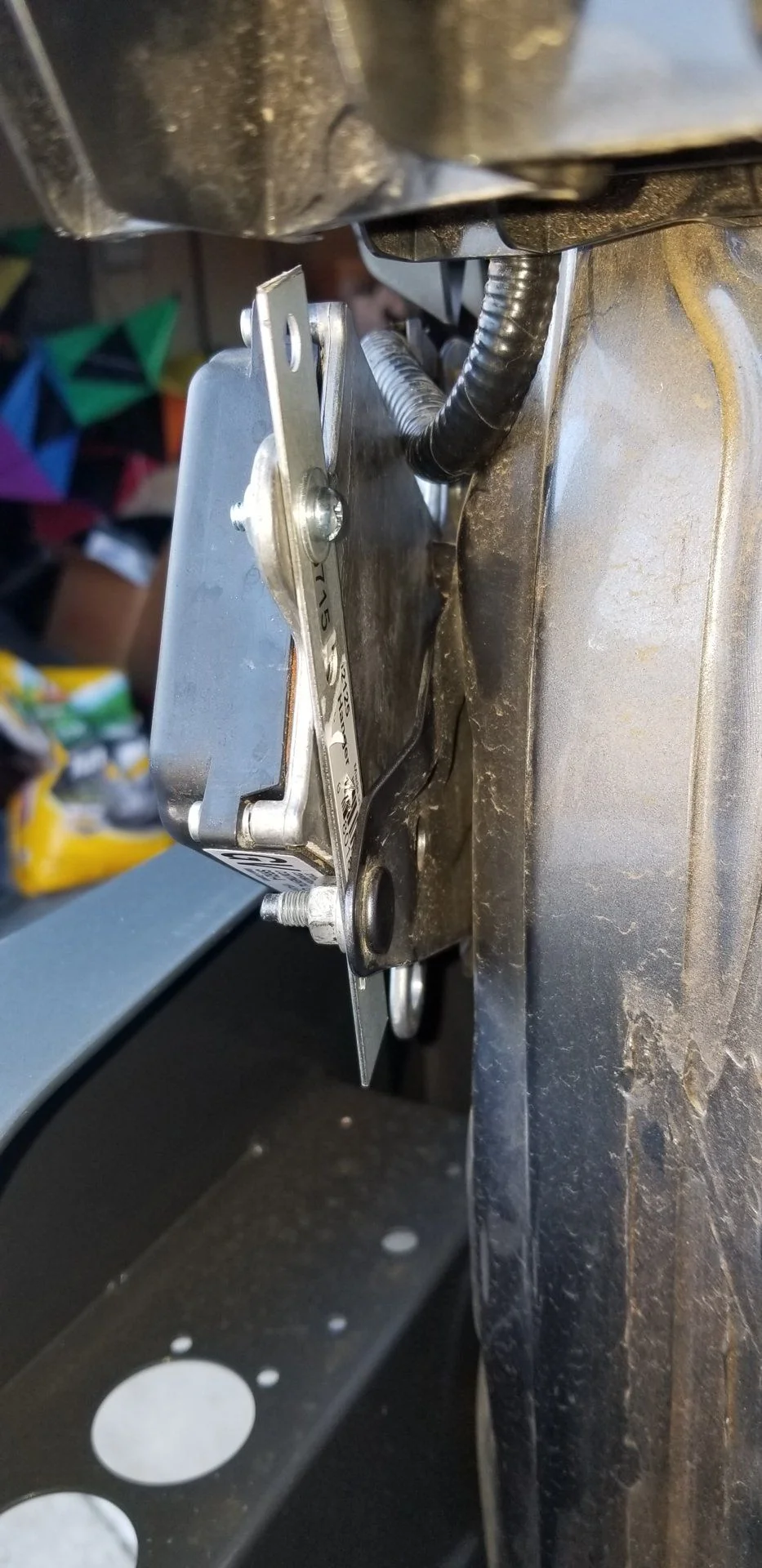

Below is a photo showing assembly of one of the sensors to the inside of the ARB bumber.
The ARB instructions are pretty decent but not great. I recommend you separate and identify all of the various hardware before starting to mount the bumper. I used calipers to identify each part and separated them into marked ziplock baggies. Note that there are coarse and fine threaded bolts of the same size and length, so be careful about thread as well.
If you are going to mount recovery points to the vehicle, make sure you do that before the bumper crumple-zone brackets are placed on the frame (you can see those here). Recovery points for the Prado 150 are generally mounted using retention nuts that are placed on the inside of the frame through the front opening. Once that gets covered up it is almost impossible to do without taking off the entire bumper assembly. Plus, the bumper has supports that are using the same bolt holes, so you may as well kill two birds with one stone.
Recovery points will generally use the same bolt locations as the support bracket shown in the photo below. So if you are going to add them, do it at the same time you are attaching this bracket.

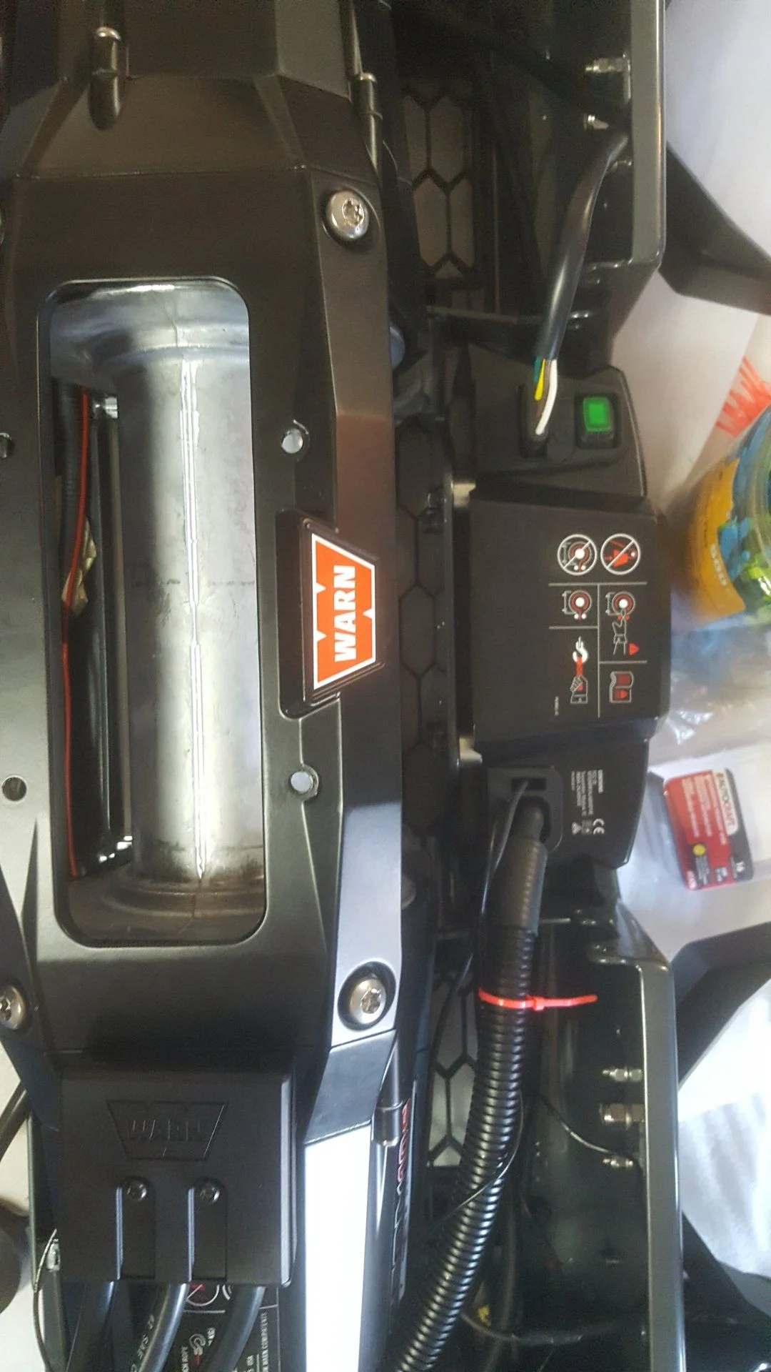

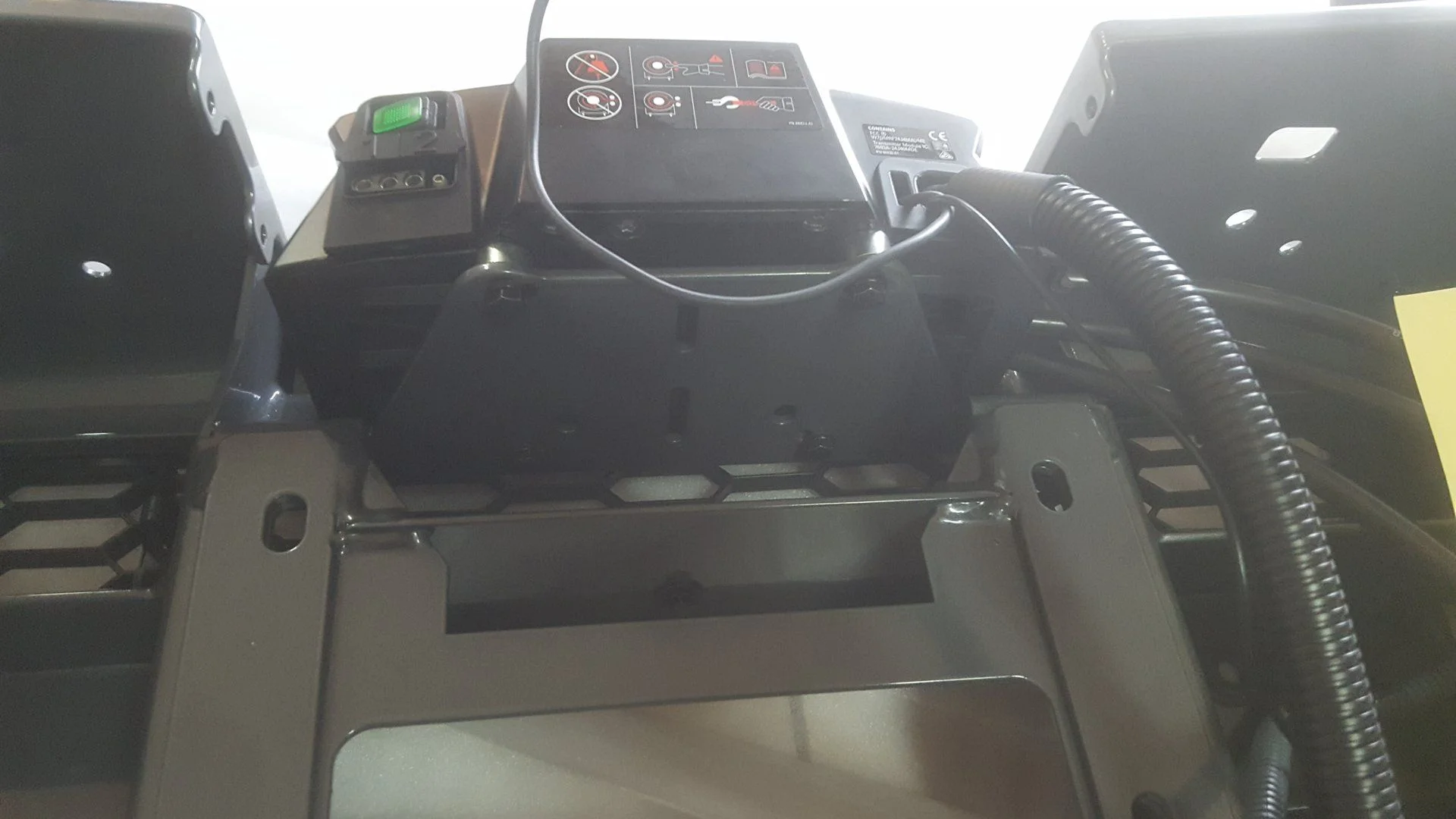

I decided on a Warn 10S Platinum winch. I liked the wireless features, speed and reliability. The ARB bumper comes with various mounting options for different winches, and one of them is for the 10S Platinum. To install it, you need to use the extension kit that allows movement of the control box away from the body of the winch so it can be remotely mounted. I also added the range extender kit that comes with an external antenna in case the body is submerged in water. Both kits must be installed before mounting the control box to the bumper.
A few more photos of the Warn assembly and mounting below.

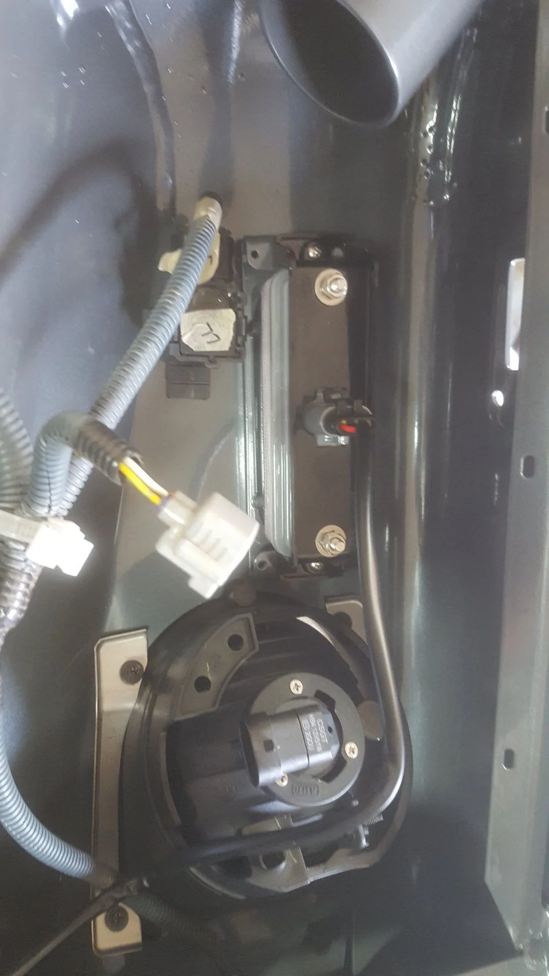

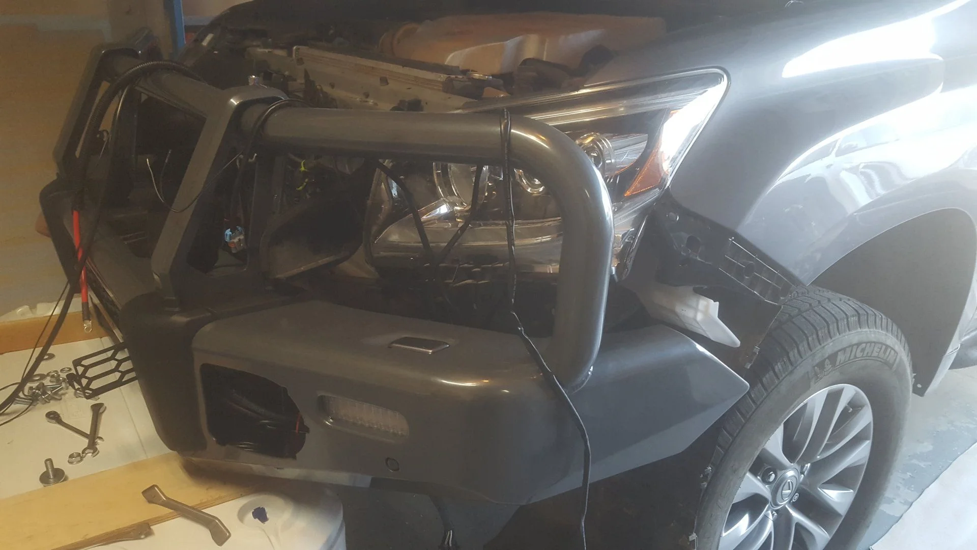

As you can see above, there is a lot going on in the bumper. When you are running wires, hoses, etc., note that the best/only place to run is through the gap between the winch control box and the bumper sheet metal (in front of the control box), because anywhere else interferes with the function of the winch.
The fog lights should be the last things you install. The reason is that they are the best access points from which you can secure the bolts holding the bumper to the frame structure. So make sure the wiring is tied down such that you can easily get it reconnected to the lights and just keep them removed. You also have some limited access from below until you screw on the lower panels, but the fog lights provide better and more direct access to the bolt locations.
The wiring loom for the fog lights, marker lights, etc. was a bit of a hassle, and what's more startling is that the LED turn signals did not come with resistors required to allow them to blink without the system thinking there was a bulb missing. luckily about $20 later I had what I needed at a local auto sound shop.

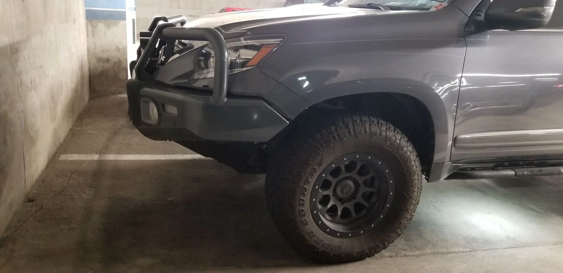

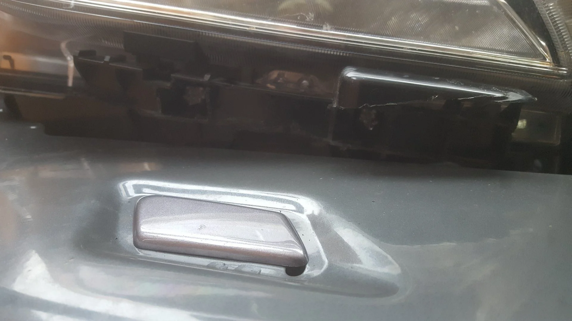

Bumper Trim.
The trim guides for the Prado 150 are worthless. Don't even try to use them in any meaningful way. Because it was possible to at least attempt installing the trim while the bumper was in place, I used an iterative approach that involved several attempts at installation, followed by additional trimming, before it was where I wanted it to be. I taped the trim and then measured the distances between different points on the body and the bumper, trying to take into account the angles of the body lines and working in a gap between the bumper and trim to allow for flex. I then drew the measured points on the taped trim, drew lines between them, and cut. Then I attempted to install, figured out where I was still having issues, and made additional adjustments.
I tried a number of different tools for this process, and found that personally the one that worked best for a good mixture of control, speed and clean lines was an electric jigsaw. Cutoff wheels got too hot and didn't work quickly enough, and a reciprocating saw didn't give me the control or clean lines I needed.

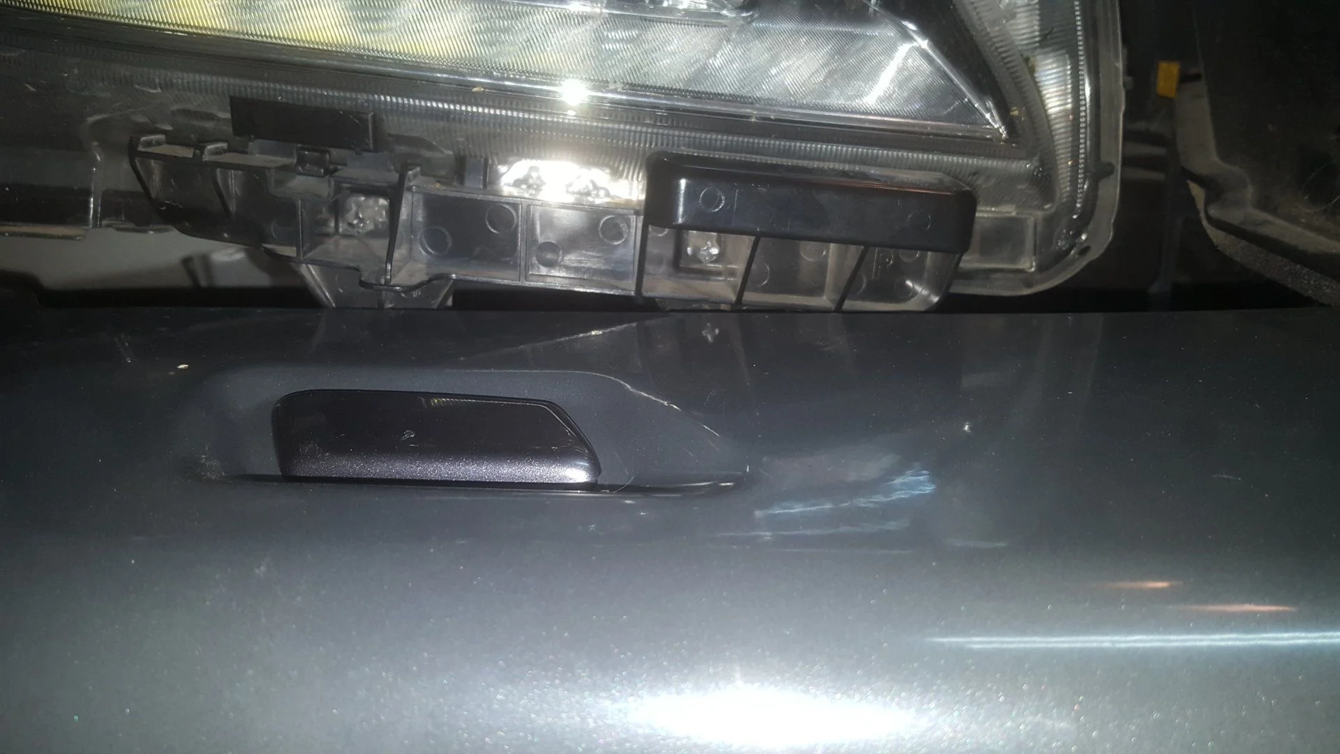

As you can see in the photos below, the bumper comes very close to the headlight locations. There is a black plastic part just below the headlights that holds the body panel in place through a notch on the top just under the headlight. But the bottom of the plastic was so close to the bumper that I was concerned about contact during flex, so I trimmed it off. It did not negatively affect the function of the part, and the body trim is still held in place without issue. Before and after below.
Another issue was that the grill no longer had any support in the middle, and I had even further structurally compromised the grill by cutting the bottom-most horizontal slats to make room for my lights' wiring harnesses. I wanted to create a brace support in the middle of the grill area behind the logo, but the only horizontal piece that goes in front of the radiator had to be removed to fit the ARB bar. So I modified the part with a cutoff wheel to clear the bumper, and was able to reinstall it. I then created a padded wood brace that attached to the horizontal piece and provided support behind the L logo to prevent movement while driving. I was planning to replace it with a metal piece later but it has worked so well it hasn't been necessary. Below is a photo of the clearance necessary for the part to be reinstalled. It also provided a good place for tying down wiring chases routed behind the bumper.

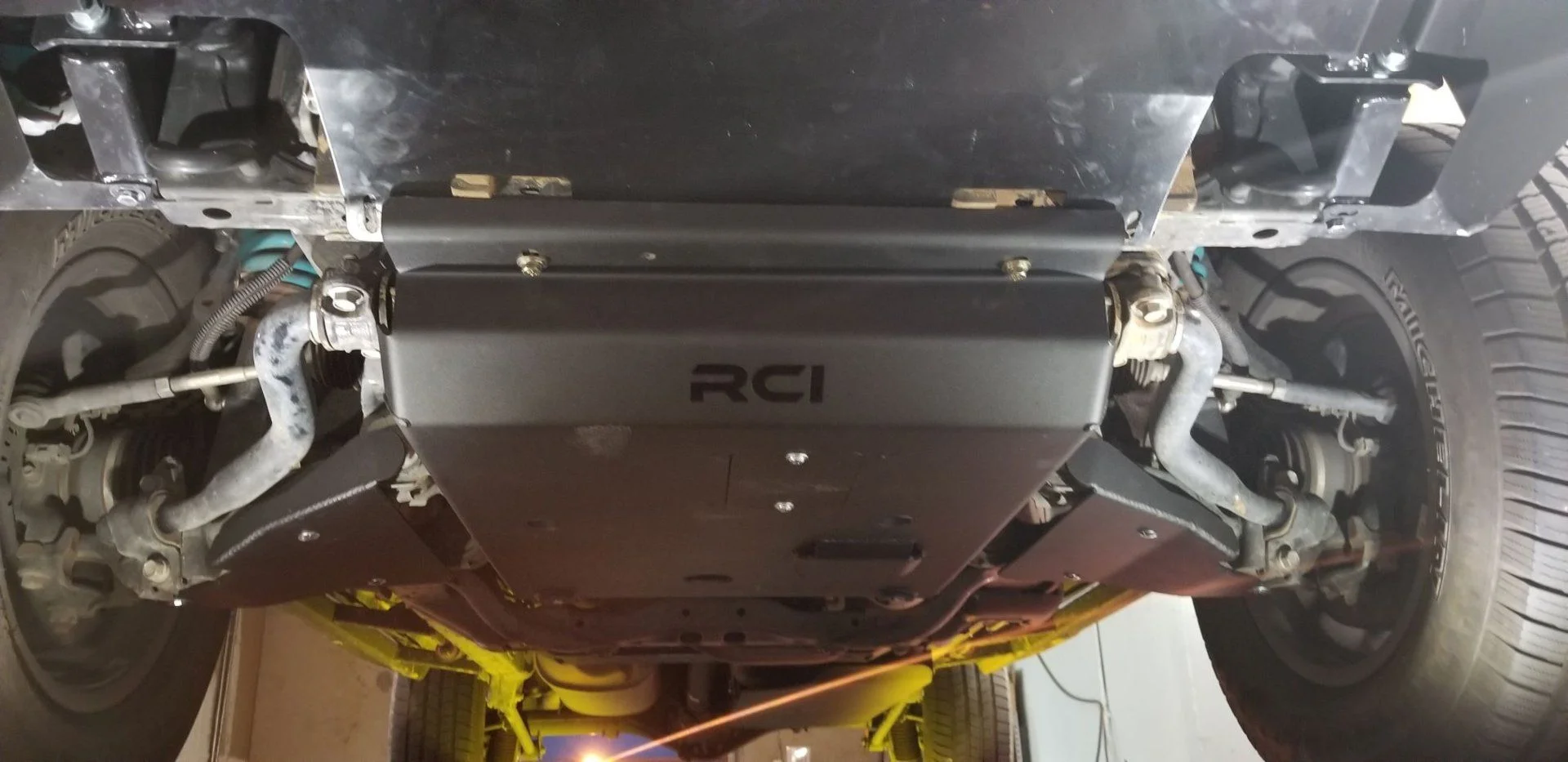

***Cheat sheet note: For GX 460, although most RCI 5th Gen 4Runner skids work (front, engine, gas tank and LCA skids), the transmission and transfer case skids should come from a 4th Gen V8 T4R. The cross brace for the transfer case skid should be from a 5th Gen T4R, and will have to be modified. The vertical wings on the transfer case skid will also need to be trimmed a little to fit.***
To date, no one makes a Lexus GX 460-specific full skid kit. It took me some trial-and-error to figure out what works. Based on our feedback and them getting in a 460 to test, RCI now sells a GX 460 kit (you may have to call them) that includes a 5th Gen T4R front, engine and gas tank skid, and 4th Gen V-8 T4R transmission and transfer case skids. You will likely still have to modify the brace over the transfer case as I outline below. RCI's LCA skids for the 5th Gen T4R fit great as well.
First, what generally works without modification: 5th Gen 4Runner gas tank, engine, KDSS front and LCA skids. In the rear, the BudBuilt rear diff skid fits great and works with the KDSS rear end without modification. In front, the GX oil filter is located higher up than the T4R one, and is oriented differently, but you can still access it through the access plate in the RCI skid. The oil drain plug is also still spot-on.
The problem with the transmission and transfer case skids is that the additional size and length of the V8 drivetrain components in the GX cause interference problems with 4Runner kits build around V6 engines. I have not tried the entire skids for Prado 150 kits made for V6 or diesel models, but I can only assume the same would likely be true due to their smaller, less powerful engines.
After much research (but before I discovered the issue above), I first ordered a full KDSS 5th Gen T4R RCI steel skid kit, including gas tank and LCA skids, and the BudBuilt rear differential skid. I went with steel because I prize strength over weight savings.
I paid for the RCI skids to be powdercoated black, while the BudBuilt rear diff skid came bare metal. I used a self-etching primer (careful to mask off the threaded bolt holes) and hammered black Rustoleum to paint the rear diff skid. The rear diff skid went on great and does not interfere with articulation or the KDSS system that I have seen.
I did not know how the RCI skids would work out and whether I would need fabrication, so I brought them to Tandem Automotive here in the DFW area for fitting. It's a great shop if you are looking for work on an offroad Toyota or Lexus platform. They can do installations, fabrication, and they even have their own line of Toyota/Lexus offroad wheels that look fantastic. Tandem Automotive

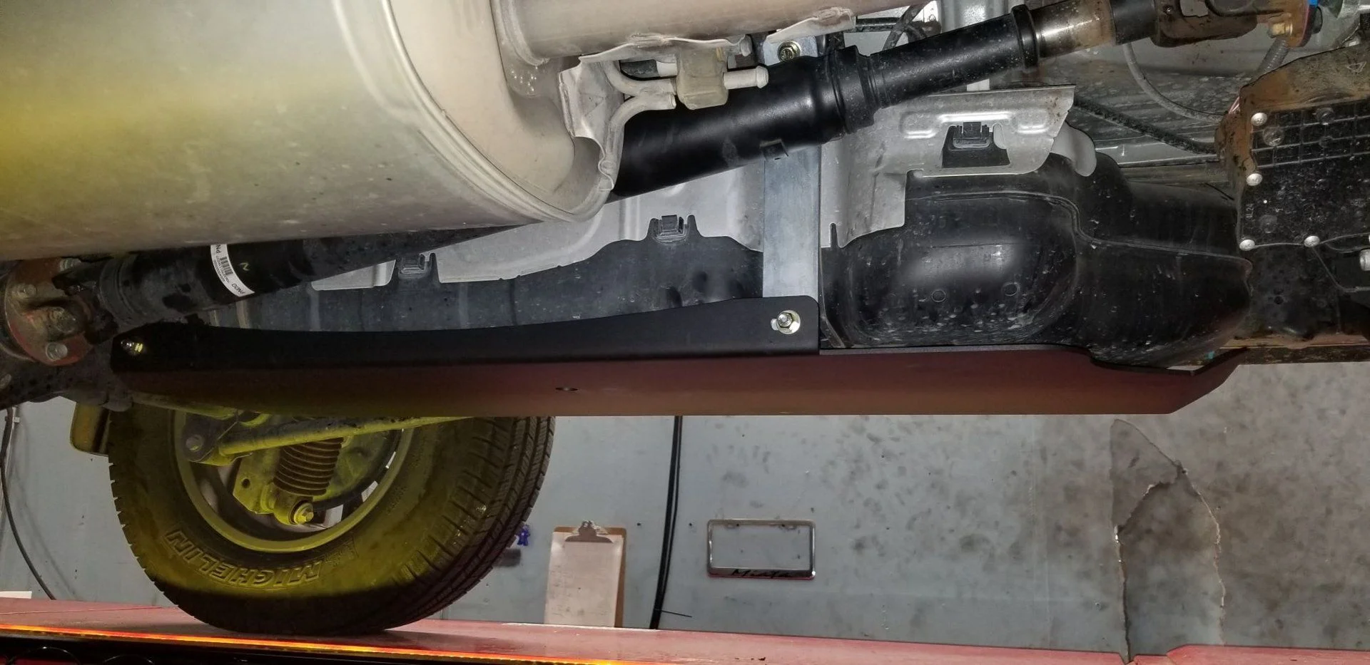

As mentioned above, the RCI 5th Gen T4R gas tank skid fits great. Photo below.

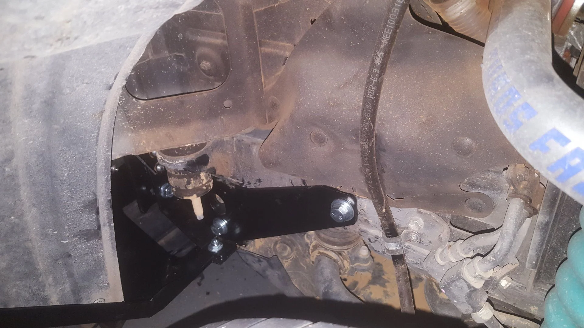

One of the first issues arose with the front skid. The front shroud of the ARB bumber attaches to bolt hole locations on the factory skid that are not found on the RCI skid, and are in fact located further outboard than the RCI skid edges.
I ended up with a simple but inelegant solution - I had them sandwich the ARB center shroud between the frame and skid, then tightened down the skid until it was flush. Below is a photo before tightening. This bent and secured the tabs on the ARB shroud to the point that it wasn't going anywhere. Several hundred serious offroad miles later and there has been no movement.

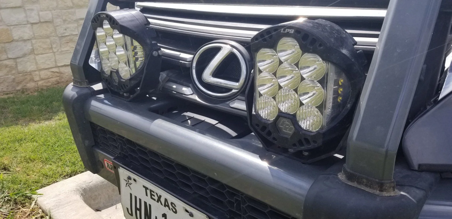

First, my front lights. Baja Designs LP9 Pros. These were some of the very first shipment of LP9s. They are different from the current versions in a few ways. First, the casing is machined billet aluminum. Newer versions are cast aluminum. Second (I found out the hard way), there were some circuit board defects in the first few batches of LP9s that made it so the spots did not turn on. Baja Designs swapped out the boards for free and with a very short turn-around time once we figured out what was going on. Great company with great customer service. They would have been willing to swap out the lights entirely, but because they no longer make the billet aluminum housings I decided to keep mine and do the board swap.
They have three modes: Amber, Flood, and Spot. The light they put out is absolutely insane. I considered tying the ambers into my turn signals but decided not to. They do give off a very nice glow at night when I decide to turn them on. I haven't tried them as fog lights yet, but I don't see them being particularly good for that.
The downside is, the light draw a considerable amount of power. I wired them off of a single switch and terminal on my SwitchPro. It works fine, but there is just too much resistance in the line with the power draw for both sets of lights, especially in Spot mode, to the point that the wires heat up noticeably. So I do not leave them on for very long if I can help it, and I will be changing out the wiring to run them in parallel to two different terminals programmed to a single button for the SwitchPro for each of the Flood and Spot modes. Amber is fine running both lights off of a single wire/terminal.

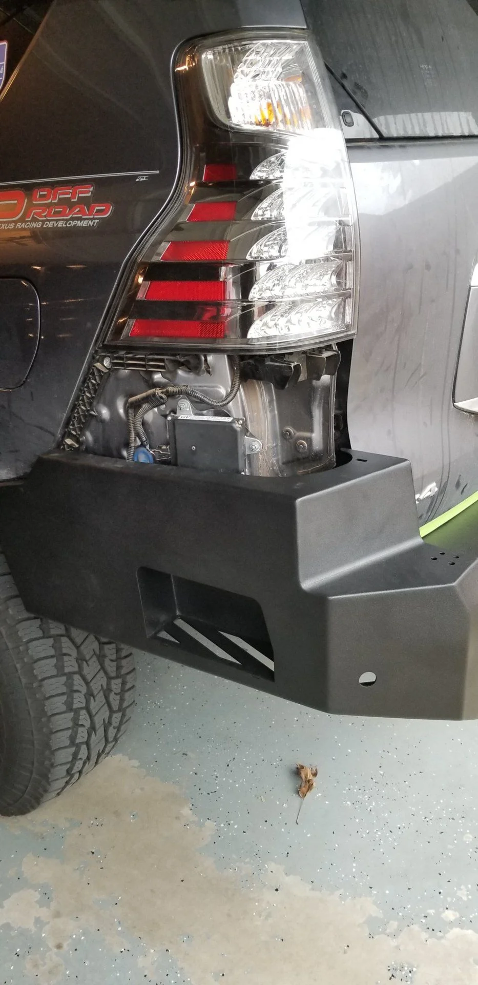

Rear bumper. There are not many options available for the GX 460 in the U.S. At the time I started my search, MetalTech had not yet released its Lancer rear bumper. I tried ordering a Kaymar through ARB (as is advertised in their Australian catalogs) and was told that ARB discontinued its relationship with Kaymar. I then tried Cruiser Brothers, who put me in touch with Gary Kardum at Mudrak Custom Cruisers. He is the current official importer of Kaymar bumpers in the U.S., but because of cost reasons he only ships a few times a year, usually in coordination with Cruiser Brothers to share a shipping container. I contacted Gary in early December to request the bumper. The order was put in to Kaymar in late January, and I received it in the beginning of July. Total cost all in (before any custom powder coating) is about $4k, so it is not an inexpensive proposition.
Because I had the Lone Star Toyota Jamboree and Red Clay Rally in May and June, I ended up ordering the MetalTech Lancer rear bumper and installed that on my vehicle, reserving the Kaymar for my wife's GX. As with the front bumper, I powder coated to match for a consistent look.

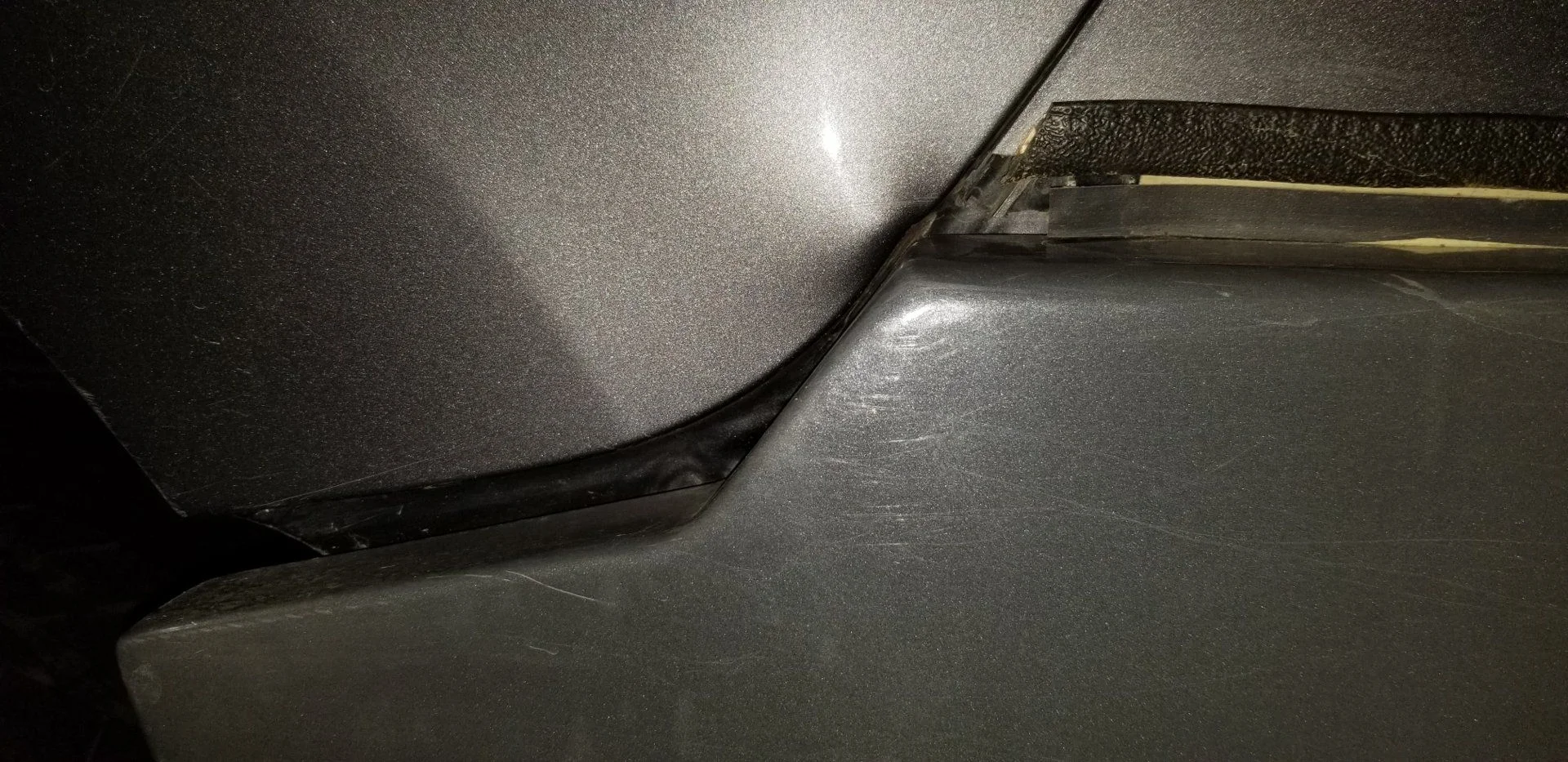

My overall impression with the MetalTech Lancer bumper is that it is a good but not great effort. I have actually been disappointed in the result for a variety of reasons. Some of them I have been able to deal with, while others cannot be fixed absent a bumper redesign.
First, general fit issues. I was a mechanical engineer working in the automotive industry before I went to law school, so I have a pretty good handle on design and tolerancing issues. Lexus has pretty tight tolerancing and good consistency from car to car, so I was disappointed when I discovered that there was no way to install the bumper without there being a significant discrepancy between how far out from the body the two sides of the bumper lined up. I don't have photos of that currently but I will take some and amend this post to include them soon.
If you have worked with body on frame vehicles, you understand that the frame moves independently of the body, especially when the frame flexes (such as offroad driving). It was therefore maddening to me to discover that MetalTech designed the bumper to sit very close to the body and even have a corner of the bumper nearly abutting the body panels. I tried adjusting for greater clearance (unsuccessfully) and also checked the photos on MetalTech's website to confirm their bumper was installed in the same location as mine. End result, the bumper sometimes contacts the body panel and dents it, as shown below.

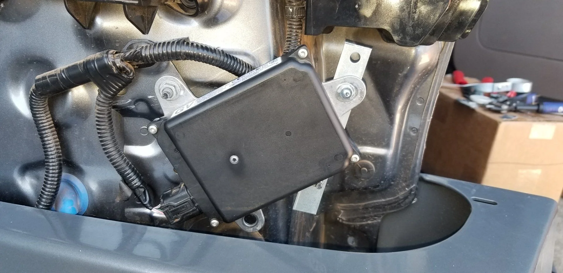

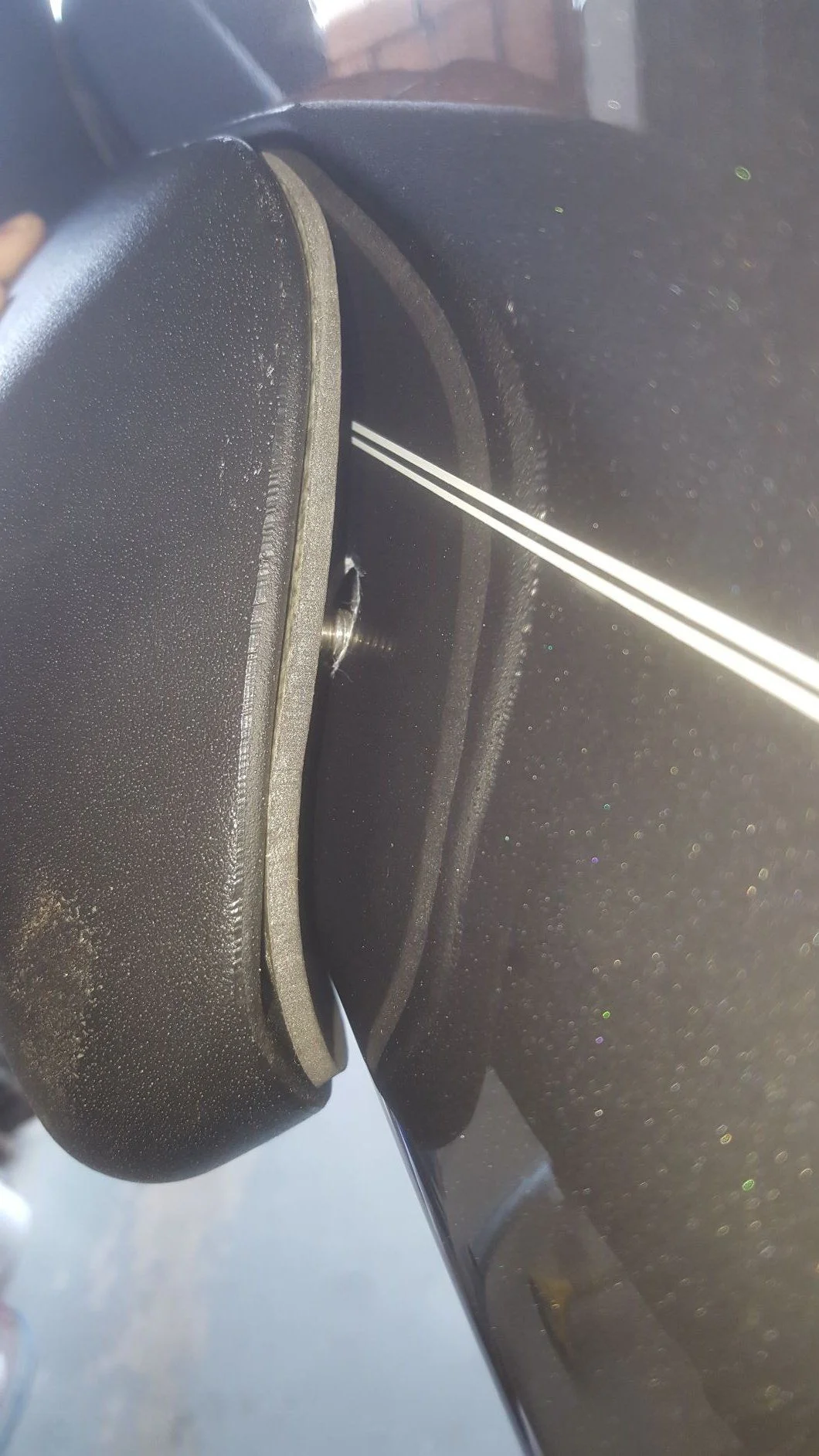

Second design issue, blind spot monitoring and cross-traffic sensors. Apparently MetalTech's GX 460 that they used for design was a base model without these sensors, so MetalTech did not account for them. As you can see below, the bumper overlaps the sensors a little. This caused a number of false sensor readings.

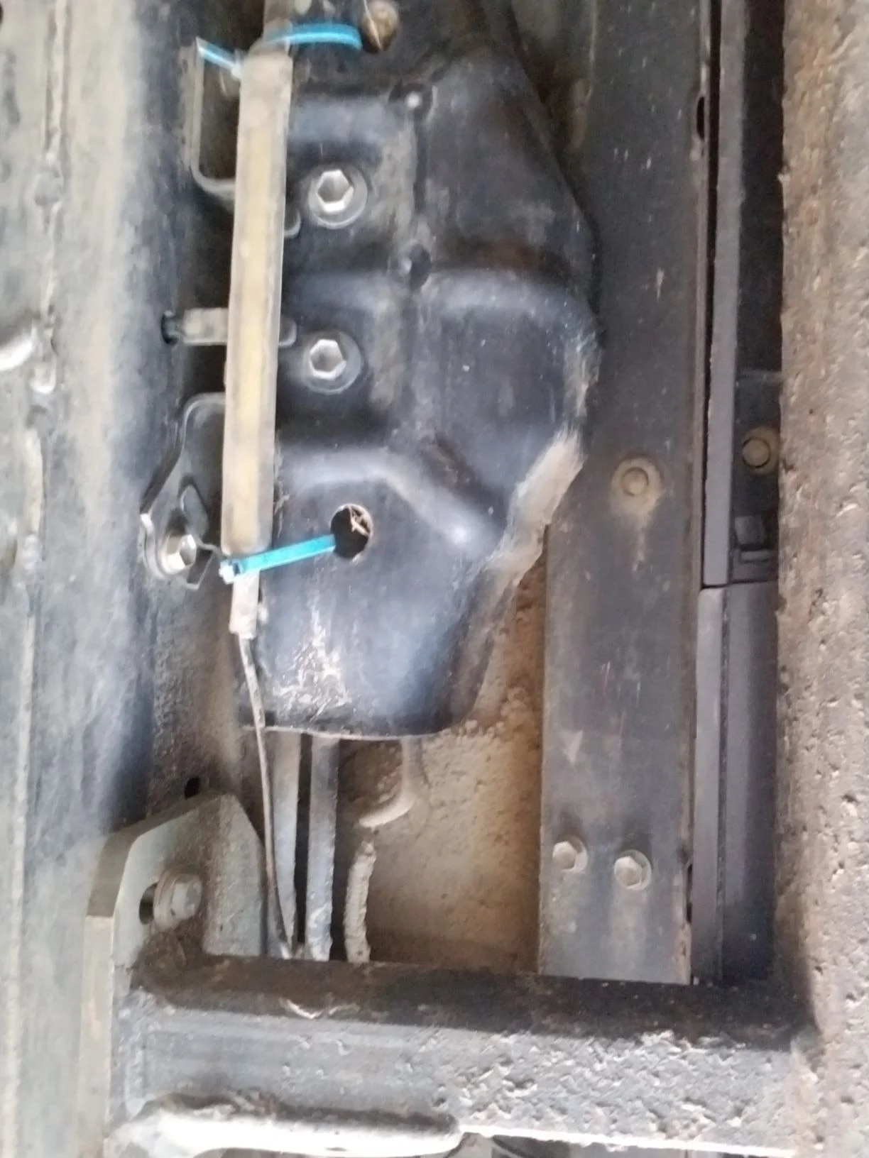

Luckily, I was able to work out a solution. The sensors are bolted on to a bracket with three welded-on stud locations (top, bottom and rear side). I removed all three nuts, then removed the sensors and reinstalled them as shown below, so that it was rotated to the point that it could be attached to the top bolt but the bottom side sat above the rearmost bolt location. I then used some bar stock to span from the rear post upward and provide a mounting location to secure the sensor. This rotation has allowed enough clearance over the bumper so that I no longer get false positives, and everything has worked as normal.
