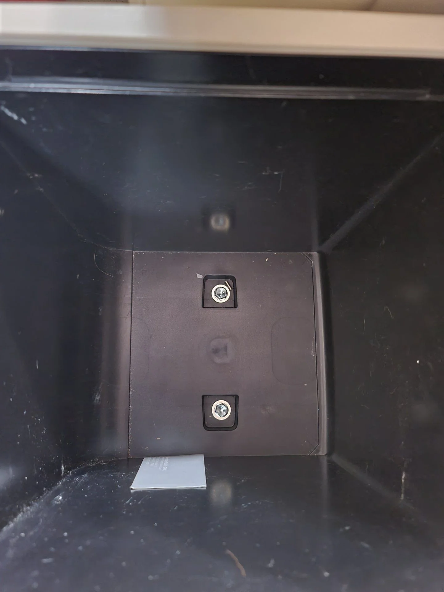

First, remove the carpet at the bottom of the console and remove the two retention bolts using a 10mm socket.

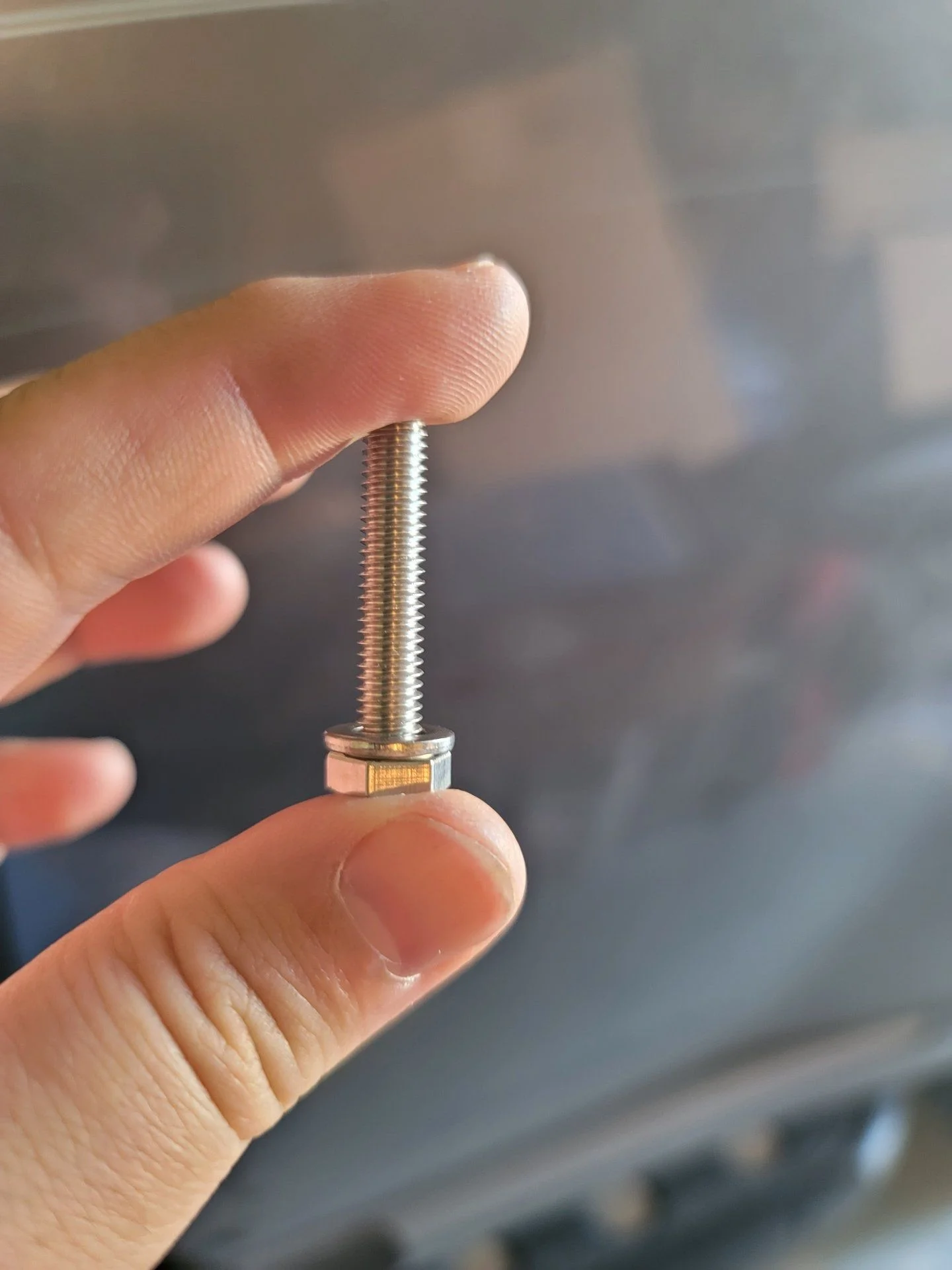

Then, prepare the Console Vault by placing a washer on each supplied bolt, opening the vault door, threading the bolts through the holes on the bottom of the vault from the inside, and then placing a spacer and plastic retention washer on the bottom side.

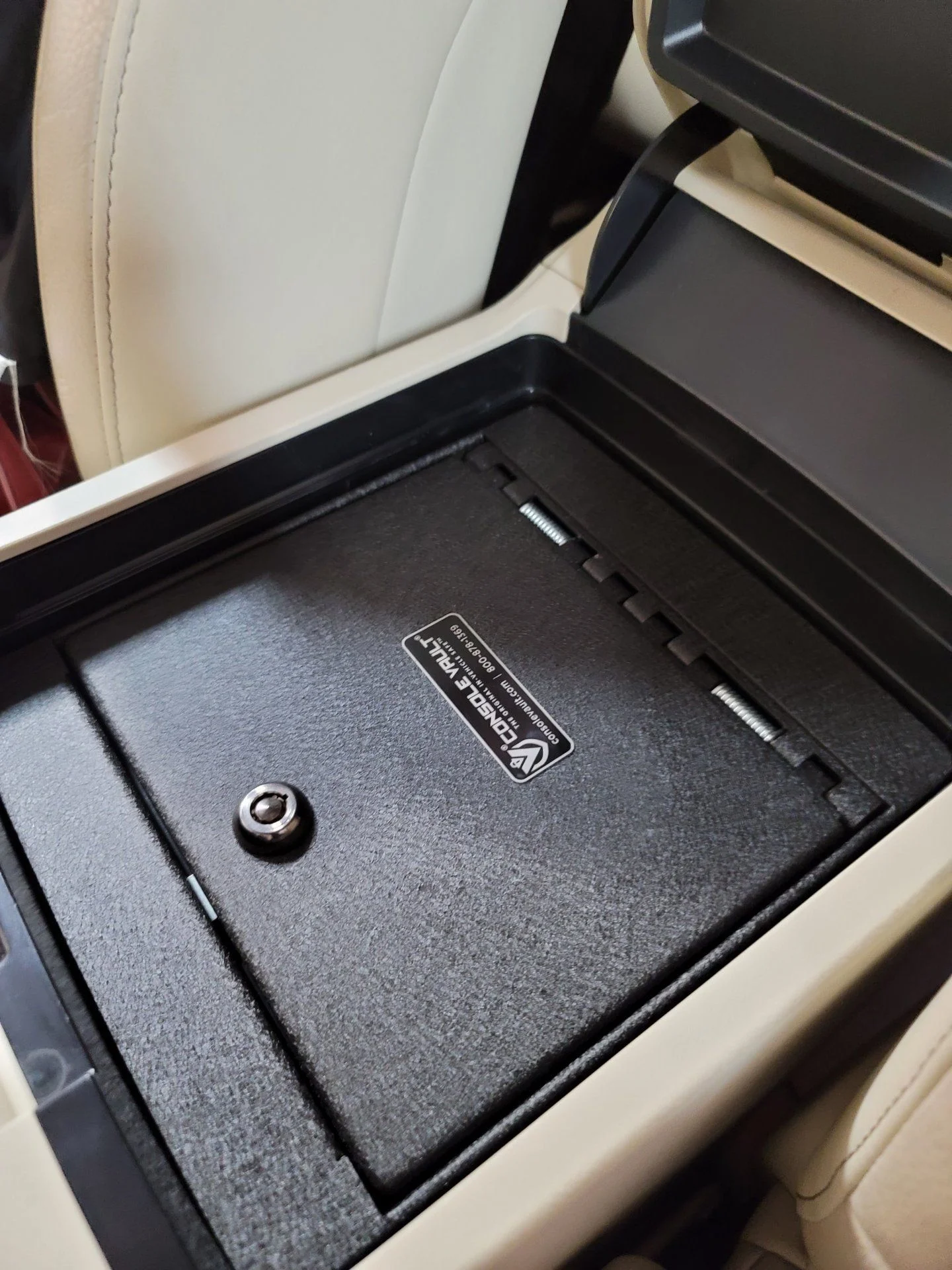

Space loss in the console is almost zero. The box is sturdy and well-made. The steel is coated with a textured product like a bedliner that seems very rugged. The top is spring loaded and opens quietly and easily. Once installed, there is not enough space for the factory console tray, but there is sufficient room to hold pens, insurance card, and other items you may want quickly accessible. Because the sides are steel, magnet-style holsters will attach to the sides if you want to secure a pistol in an elevated position.
I purchased the keyed box, but there are also options for combination locks. Although you can see the single latch point in the photo below for this model, I have tested and confirmed that the latch does not move while in the locked position without breaking something.
Overall I am very happy with this product and would recommend it to anyone interested in secure, lockable storage in their GX.

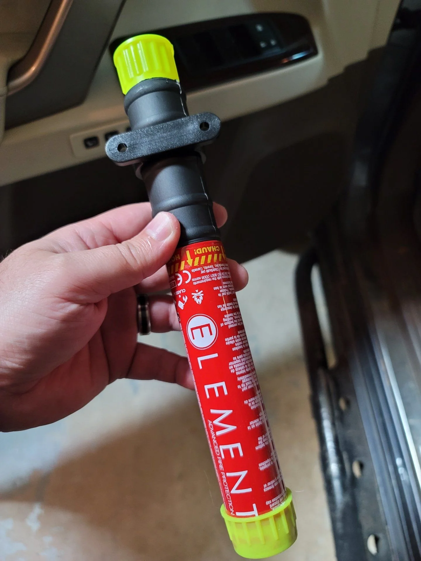

I also added a second fire extinguisher on-board. It is the Element 50. It is solid state and used similarly to a road flare (bottom cap used to strike and start reaction under top cap). Therefore it never needs charging or inspection like a normal extinguisher. Like my Halon extinguisher, it leaves no residue. But unlike the Halon extinguisher, which is an oxygen displacer and should never be used in the same space as humans, the Element can be safely used around people. And this small unit houses significantly more fire extinguishing capacity than a much larger compressed gas unit. I bought a 10 pack on Amazon and distributed them around my extended family for use in homes and vehicles, but they can also be purchased as single units. At $75-80 each they are not cheap, but they are still competitively priced to other no-residue automotive fire extinguishers. Right now it stays in the door panel, but once I find a good mounting location (maybe with a quick fist) I will post it up here.
Yea, I'd like to ditch that tank I have hanging in the back of my rig with a couple of these. I assume the coverage/volume/time (or however you compare a solid to a gas extinguisher is compared) is equal or better?
Yes, there are two models, the 50 and 100. The numbers relate to the number of seconds of fire suppression it discharges, so the 50 means 50 seconds of discharge. That is significantly better than most vehicle extinguishers, but if you want more you can get the 100 model. The only downside is the stream is continuous (no start/stop), but when fighting a vehicle fire overkill isn't my top concern.

Without the ability to "turn on/off", I would probably opt for the smaller size. One can always grab a second stick if necessary!
