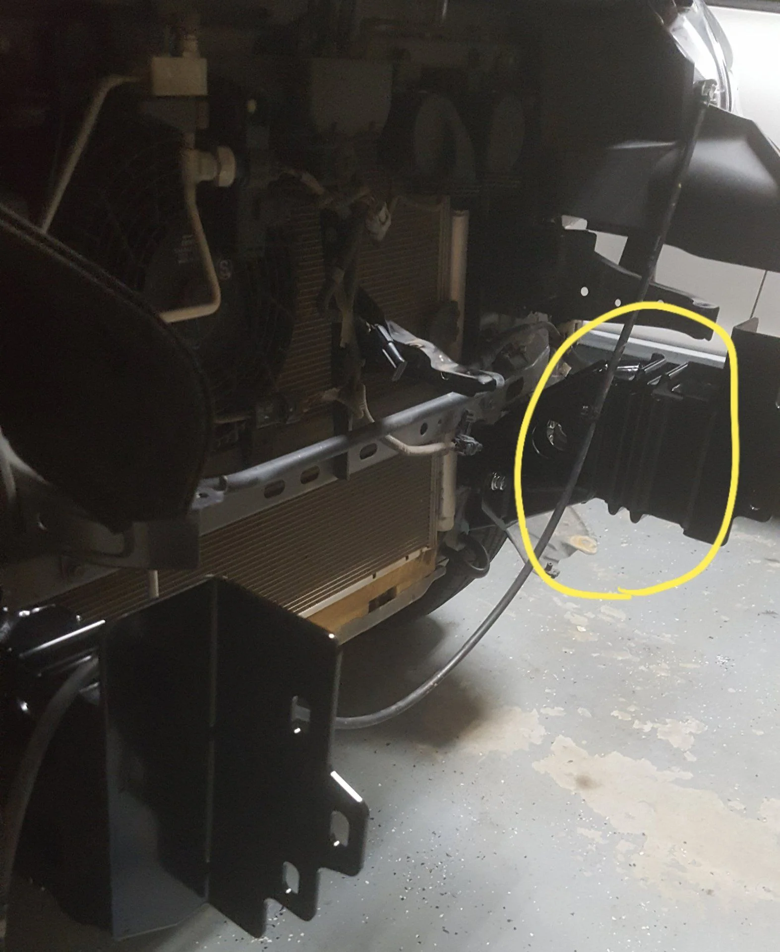

Does the Summit bar have the crush cans for impact? I believe the Deluxe bumpers did.
Yes, the summit bar has them on the longitudinal supports bolted to the frame. You can see them circled in the photo below.

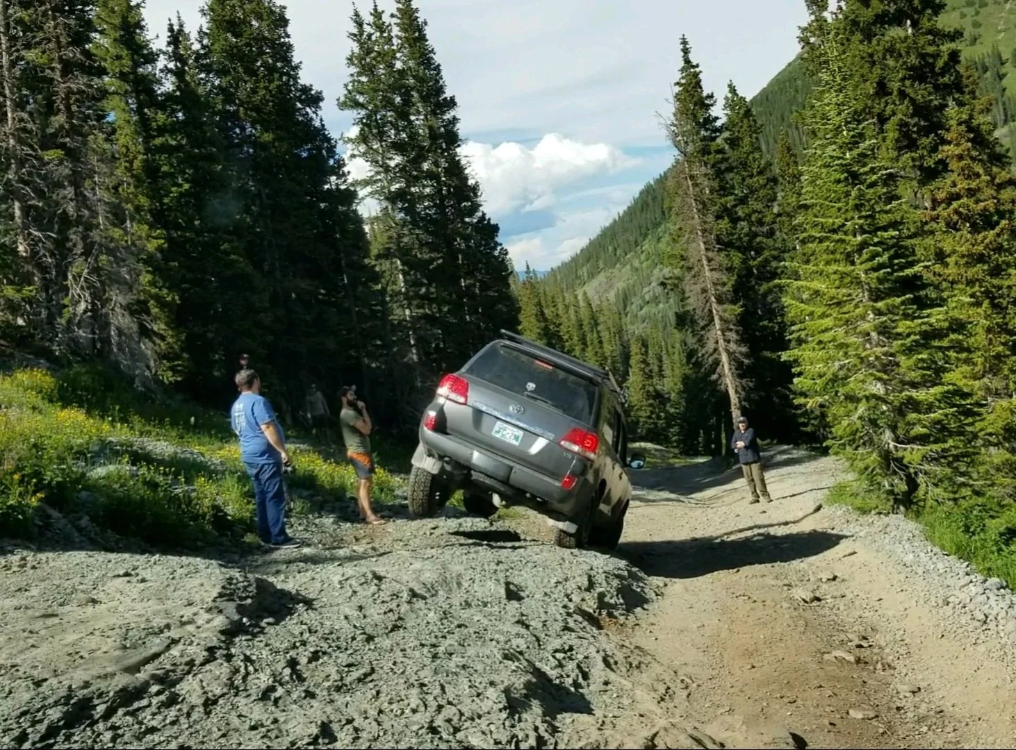

A few weeks ago we traveled to Ouray for the 200 series LCDC event. We had a recovery experience that I felt was worth sharing for a number of reasons.
Driving down from Imogene pass in a group of about 10 cruisers, the driver of the 200 series in front of us decided to try to take some difficult lines and got himself in a little trouble. He dropped his front passenger tire off a boulder with the rear driver tire about 9 inches in the air.
The driver acted correctly - he stayed where he was and waited for help. Although this isn't the worst position I have seen someone in, and it is very possible he could have driven out of it safely without assistance, the safest and most prudent approach was to prevent a roll. What I found surprising was the general lack of preparedness of everyone there. No one else in the group was carrying any recovery gear. One driver had a winch, but it was pretty much useless in this situation where there were no nearby trees on the side needing support. Some drivers were suggesting people hang from the roof rack on the rear corner for ballast. I hope everyone reading this understands how dangerous a situation that could be for any number of reasons.

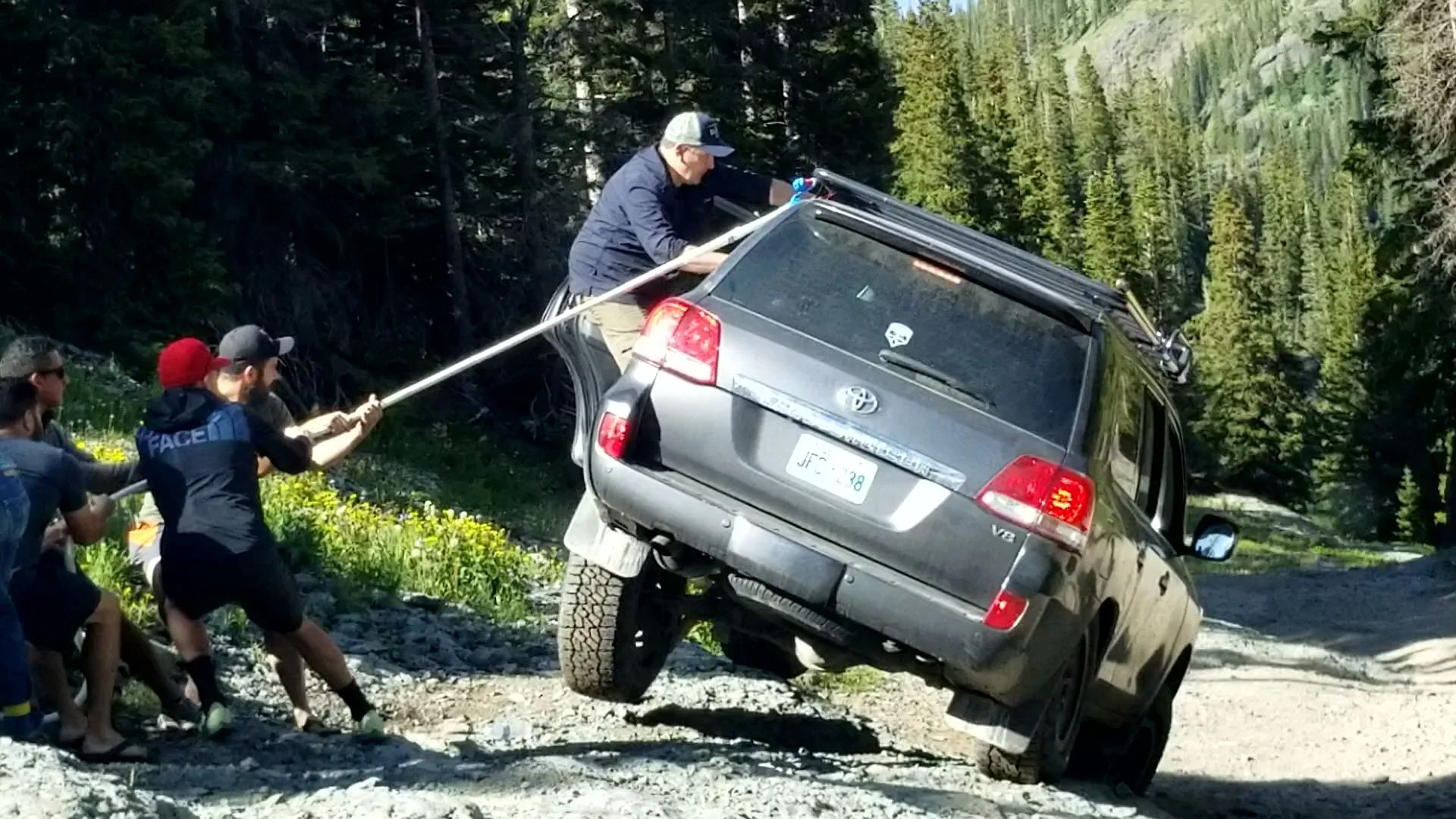

Luckily I always carry at least some recovery gear with me. Although we haven't yet put on a front bumper or winch on the 200 series, I always carry some tow straps (both static and kinetic), soft shackles, hard shackles and a load equalizing bridle from Treaty Oak Offroad when driving offroad (and much of this equipment stays in the car 24/7 just in case.
The kinetic rope and soft shackles were just the ticket here. We secured the end of the rope to the corner of the roof rack using a soft shackle, then had several people pull down for ballas using the rope while the LC drove down (the person securing the rope in the photo below got off the rig before the vehicle started moving).
This way, if the rig began to roll uncontrollably, everyone outside the rig was safe and could let go if absolutely necessary. This also allowed enough support that all passengers were able to exit the vehicle before it began moving, so only the driver remained at risk.
