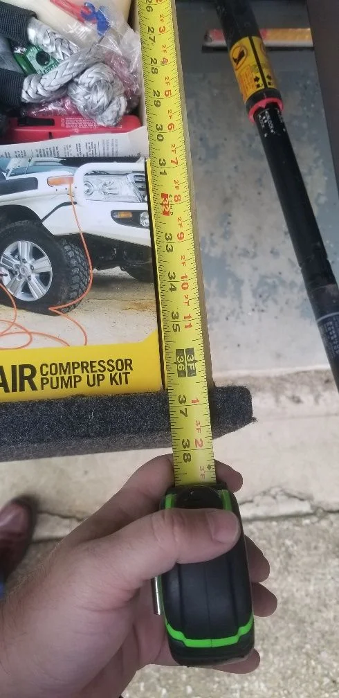

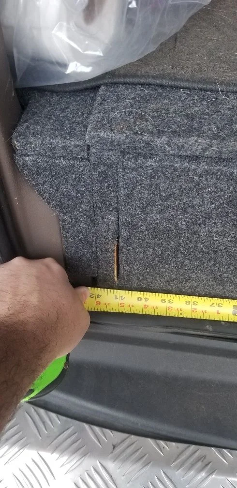

Someone asked for additional measurements/build info on my drawers, so below are some more photos (the rest of it is on page 1 of this build). I am probably going to be replacing these with a new drawer setup similar to what I did in my wife's 200 series LC (although without a movable drawer holding the fridge). When I finally get around to that I will make sure to post build information and will also try to snap plenty of measurement photos along the way to document it better.
The outside of the drawers are 42", with plywood vertical pieces, 3/4" of spacing for the drawer slides, then the sides of the drawers. This results in a 34" internal drawer width as shown two photos down. Note that this width allows for the extra space on the right-hand side for the Radflo Hydra-Jac, as shown on p.1 of the build.

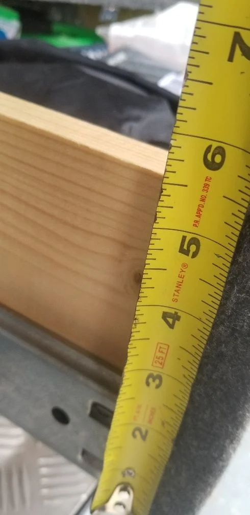

I used pre-cut lumber for the drawer internals, so they are 5.5" in height.
Drawer length (back to front) is 37.2".

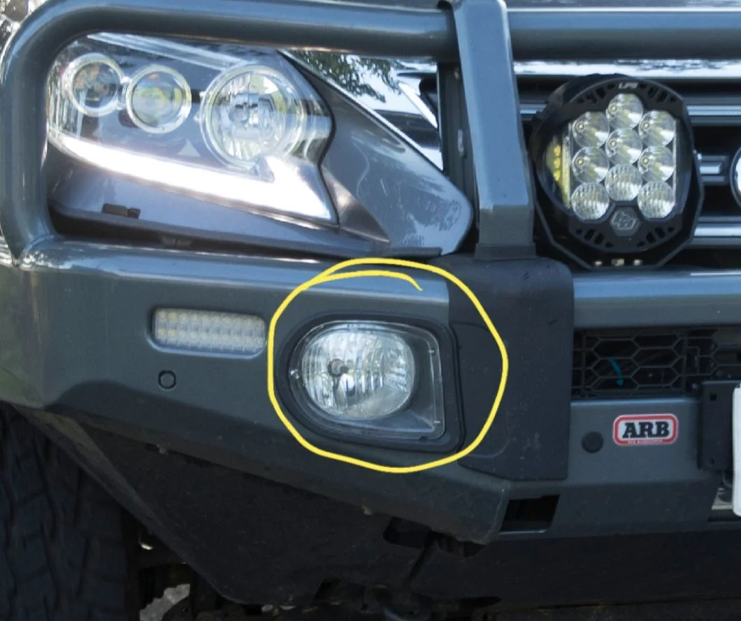

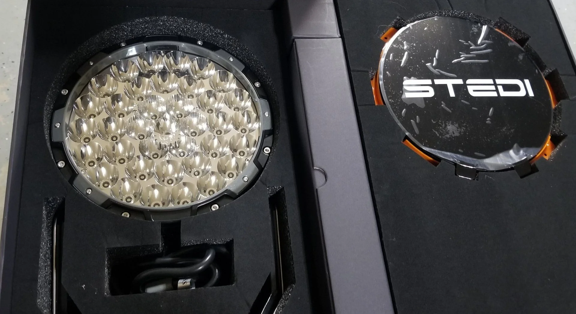

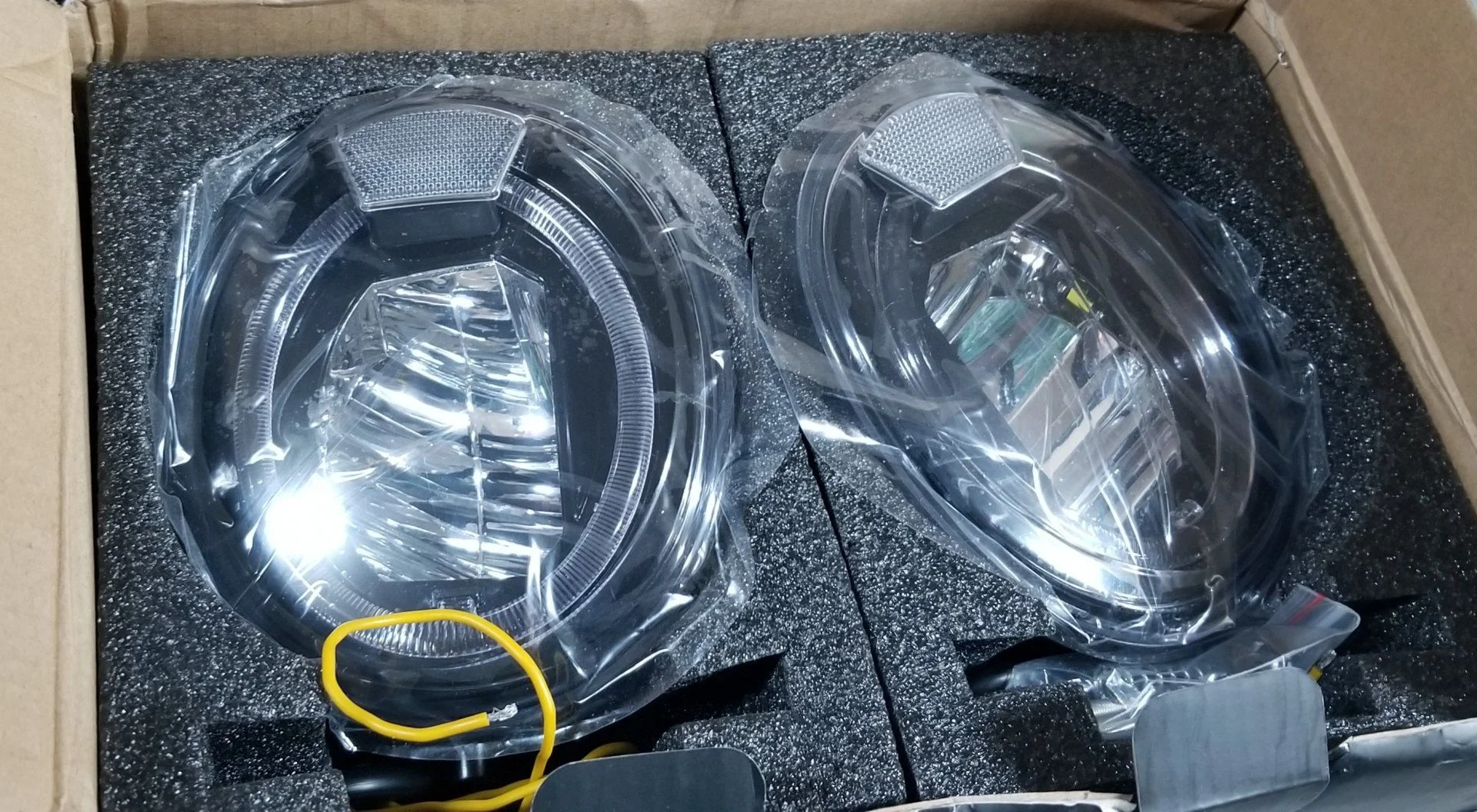

Got some new toys in today from Stedi in Australia. LED replacement fogs for my Summit bumper on the GX, and Type-X Pro driving lights for the LC 200. I am looking forward to doing a comparison to the LP9 Pros. With the current exchange rate, the Type-X pair cost about half of the LP9s and arrived in about a week. Not bad for coming from Australia. My wife also likes the fact that the Stedis have customizable color rings and covers.
The replacement fogs are plug-and-play in the Summit bumper. They have a DRL ring in addition to fog functionality. Stedi has similar solutions for other bumpers, like IronMan Premium and ARB Deluxe.

Summit bar fog replacements:
Driving lights for 200:

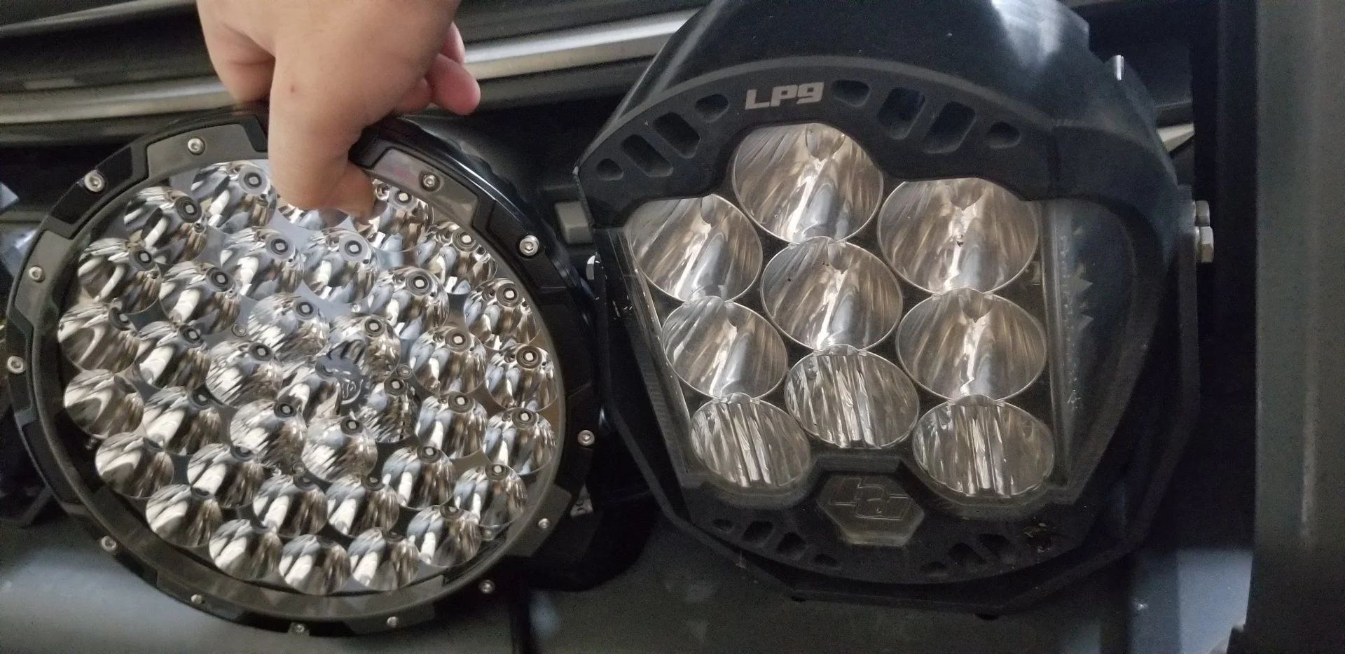

Visual comparison to LP9s:

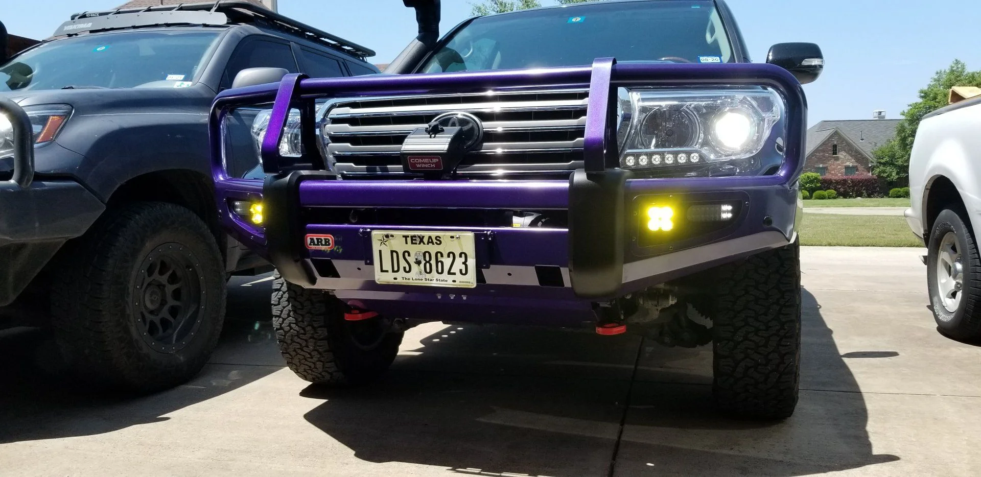

As a side note, I need to start a 200 series build thread. When I do I will link to it. In the mean time, here is a glimpse of the current state of my wife's LC. Your eyes don't deceive you, it is purple.

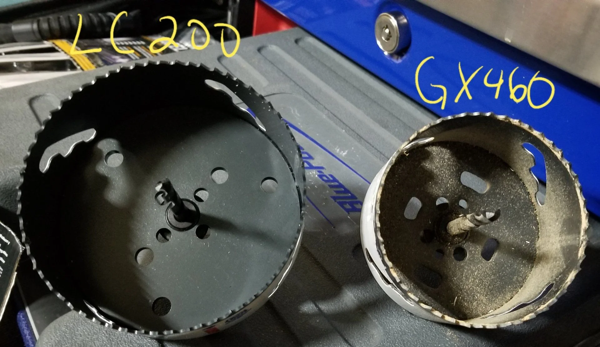

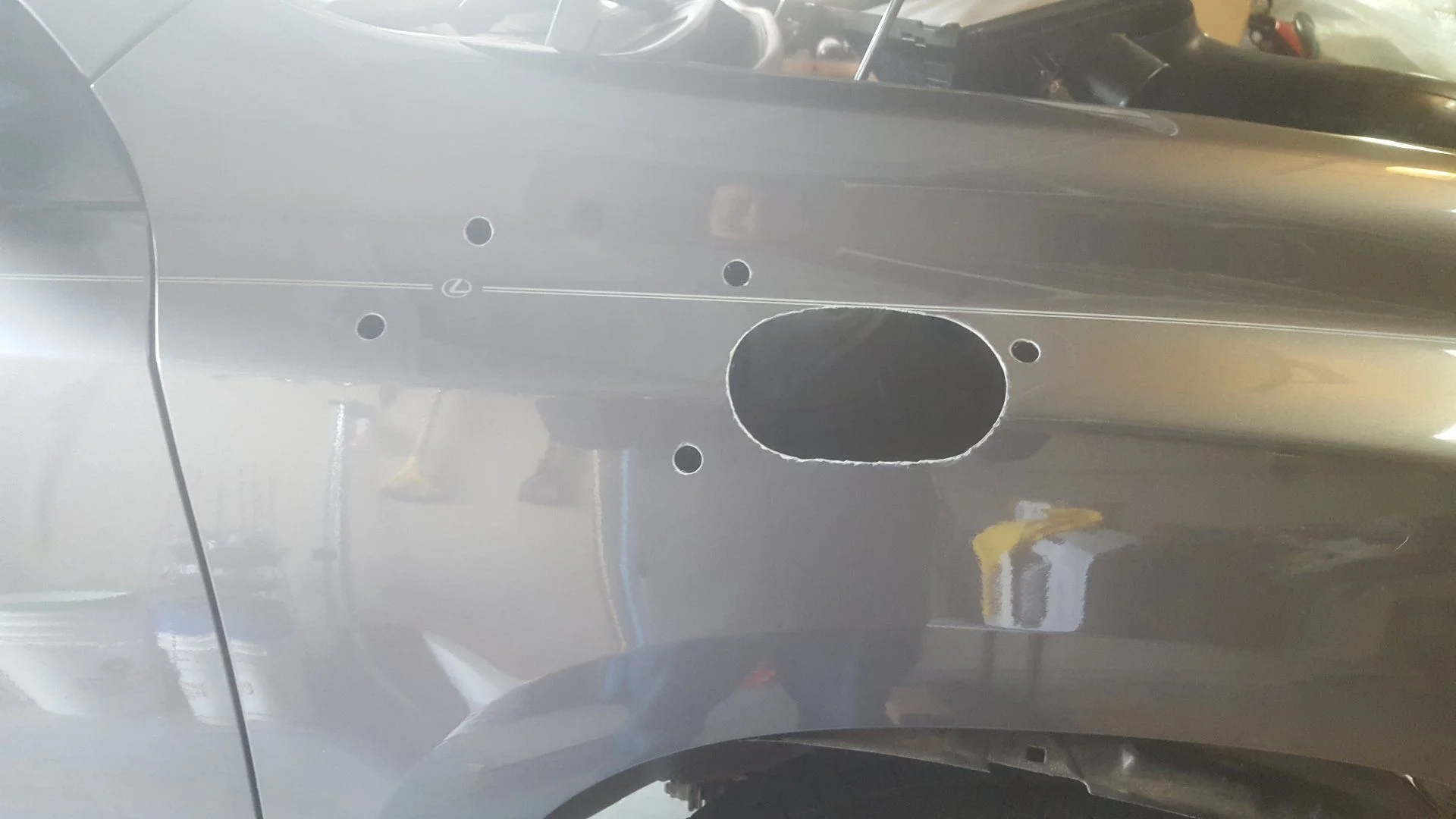

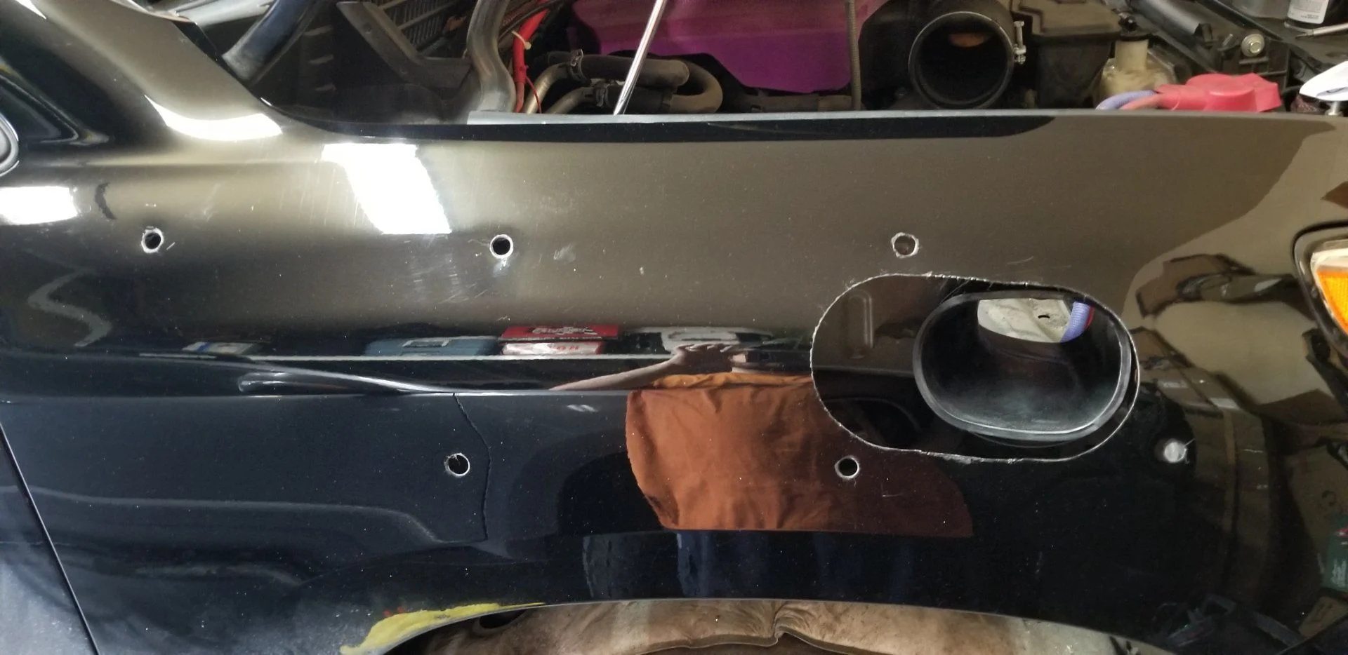

Just a fun bit of trivia, if you thought using a hole saw on a GX took out a big chunk take a look at what the LC requires.
Below is me doing my best Eddie Murphy SNL Gumby impression with the gasket for the 200 snorkel for size reference. That's a lot of air flow.
:oops:............ oh and the hole is large
How do you like the Stedi replacements. Are they just foglights or combo driving light?
I haven't gotten them installed yet. I am hoping to do it within the next few days. They are replacement fog lights that fit the ARB Summit bumper fog locations, which are an unusual size/shape. I will post photos once I am done.

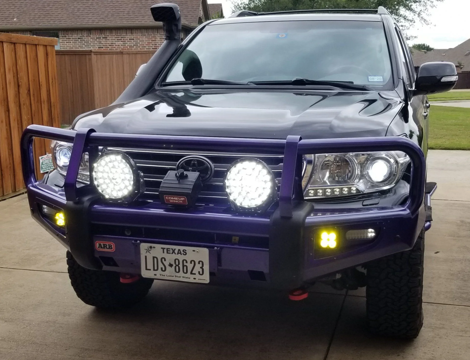

I am very impressed with the Stedi driving lights and the Baja Designs fogs on the LC so far, especially for the price. The Stedis appear very well built and are plenty bright. Photo below of driving lights and BD fogs on LC (at angle to lower blinding effect on photo). As soon as I can, I am going to do a nighttime head-to-head of the Stedi Type-X Pros with the BD LP9s.
Gotcha. I saw that they have replacements for the Ironman as well. I will wait on tour review of the driving light. That way if the results are close to the LP9 then I will order the dogs along with the driving lights.
