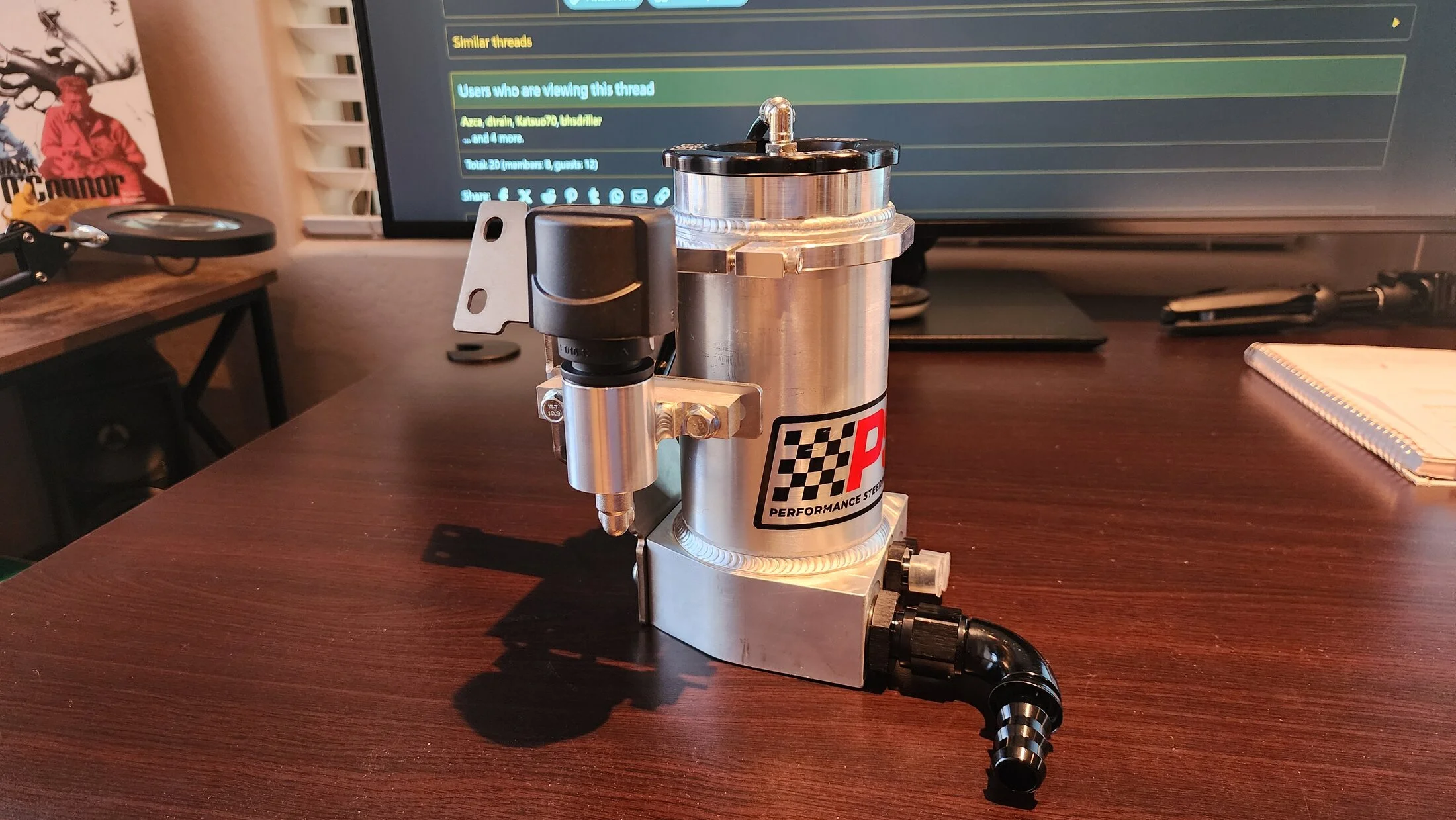

I have installed hydro assist brakes. I had whining coming from the pump even after many bleeding cycles including letting it sit after running. I have had a few people tell me it is a volume issue as the reservoir Mr. T has is now too small. We will see. I have a PSC reservoir on my desk now to be installed this weekend. Hopefully this will resolve it.

Yes they can block the flow, I'm sure you can find a few threads how to clean the screen. Or put a aftermarket reservoir something like on post #7.

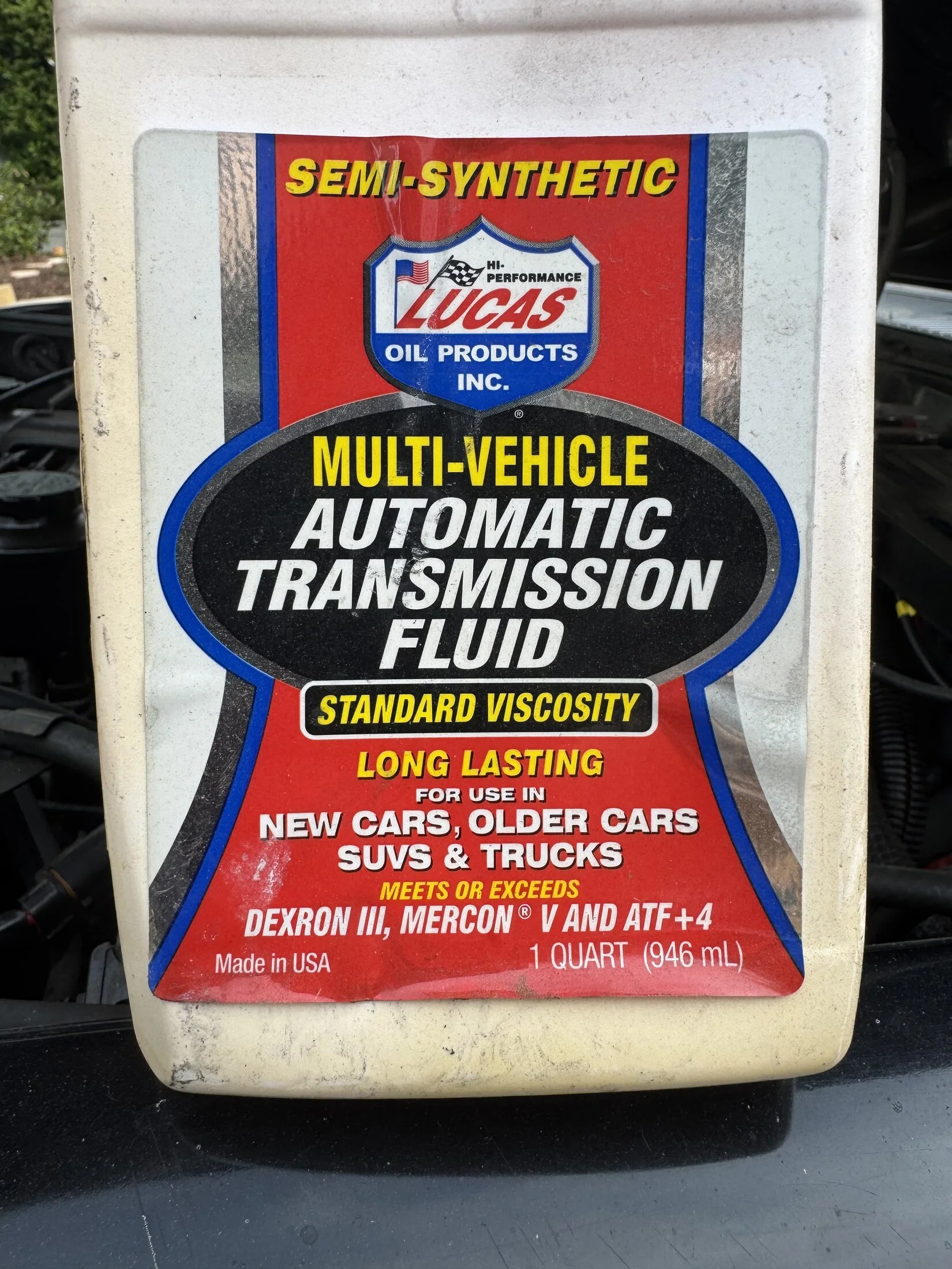

Are you running ATF in the system or PS fluid from Joe blows parts store? Toyota calls for the ATF.
My money is on a partially blocked strainer in the reservoir. I’d say there is no way air remains in the system since installing the new box a year ago.
That’s a great place to start and free (ish) to check the screen.
ATF is Lucas semi-synthetic Dex lll and Mercon V

Apparently the fluid foams and there is not sufficient distance for the bubbles to break before returning to the system. The PSC reservoir has an internal filter which is supposed to stop the foaming before returning back to the system. It is only theory on my end until it is installed and running. Crossing my fingers that it will resolve this issue.
