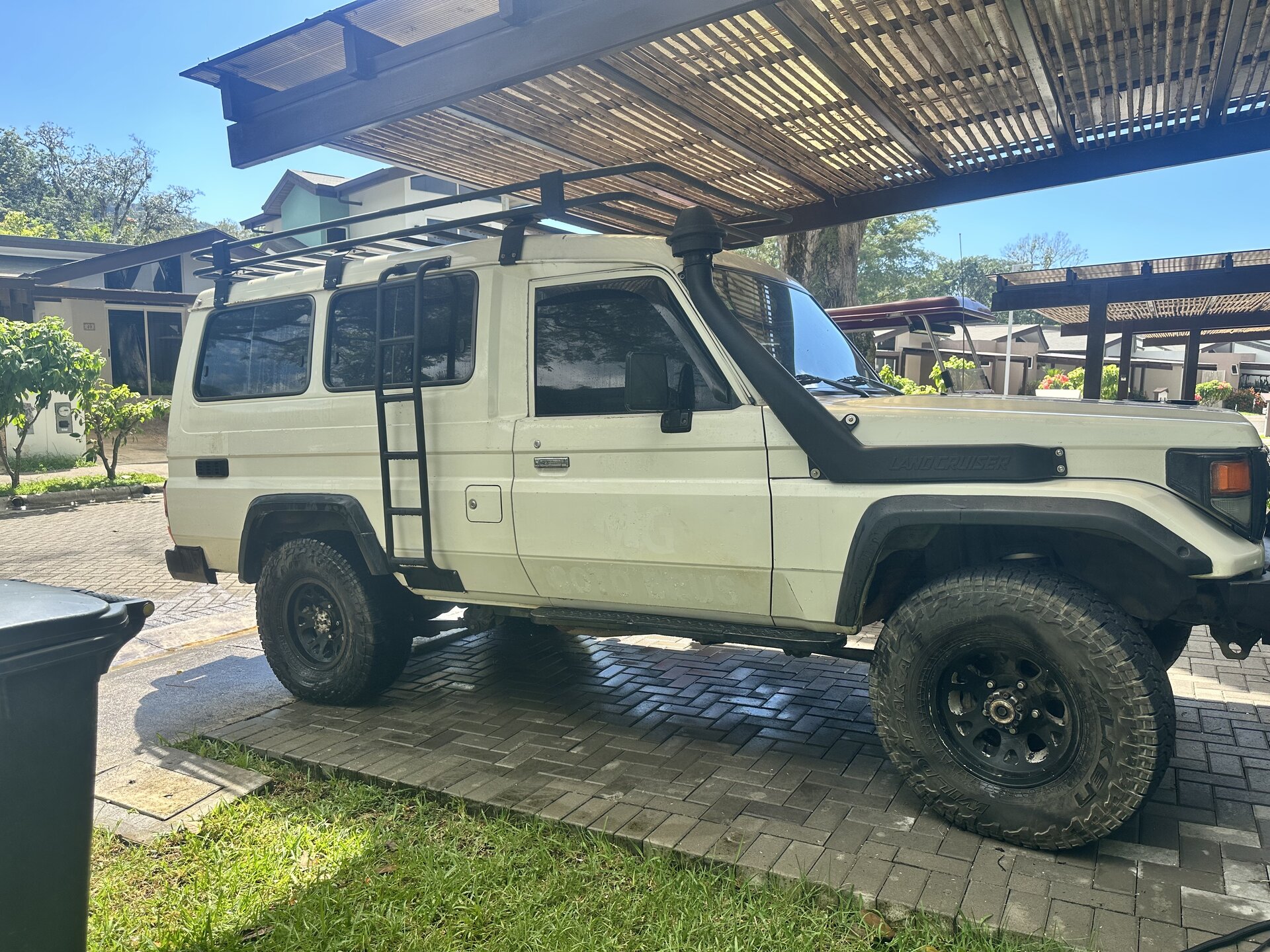

Been looking for a troopy for quite some time and finally pulled the trigger on a site unseen. I know, dumb move but it is what it is. I bought a LHD 2004 HZJ78L 1HZ R151F (according to the vehicle factory tag) with 400,000KM (at least that is what the dash says, lol) I plan on doing a complete fit-out with a pop-top and what not. In the attempt to do upgrades right the first time i am hoping I can gain so wisdom from the Gurus on this site. So here are some questions to start (please don't hate if I should know the answers)
1. Assume i need to rebuild the gearbox (hope that's the correct term) It will fall out of 1st sometimes if you have not started moving yet and when going into 4th it grinds a little no matter how you shift.
IF i am correct with the rebuild would you recommend any sort of upgrades to do at the time for the gearbox?
2. The steering wheel can be turned roughly from 10 o'clock to 2 o'clock before it turns the wheels.
IS this normal or is that another rebuild?
3. The motor cranks over a little long (at least seems long to me about 3 seconds) before firing up and the battery is good. And when you shut it off it shakes rather hard at shut off.
IS that normal?
4. I will be putting lockers on would you do any regearing at that time? It will have a GVM upgrade with 2-3" lift on 33s and all the weight of the pop-top, interior fit-out, extra fuel cell and water cell, etc.. It will be more of a tourer than hardcore offroad but I want it as capable as possible.
Would you want any regearing based on that information? Any out upgrade?
Im sure i am going to have tons of questions but i will try my best to google i just feel more comfortable hearing directly for people in the know.
Thanks in advance for any knowledge shared. Pura Vida
