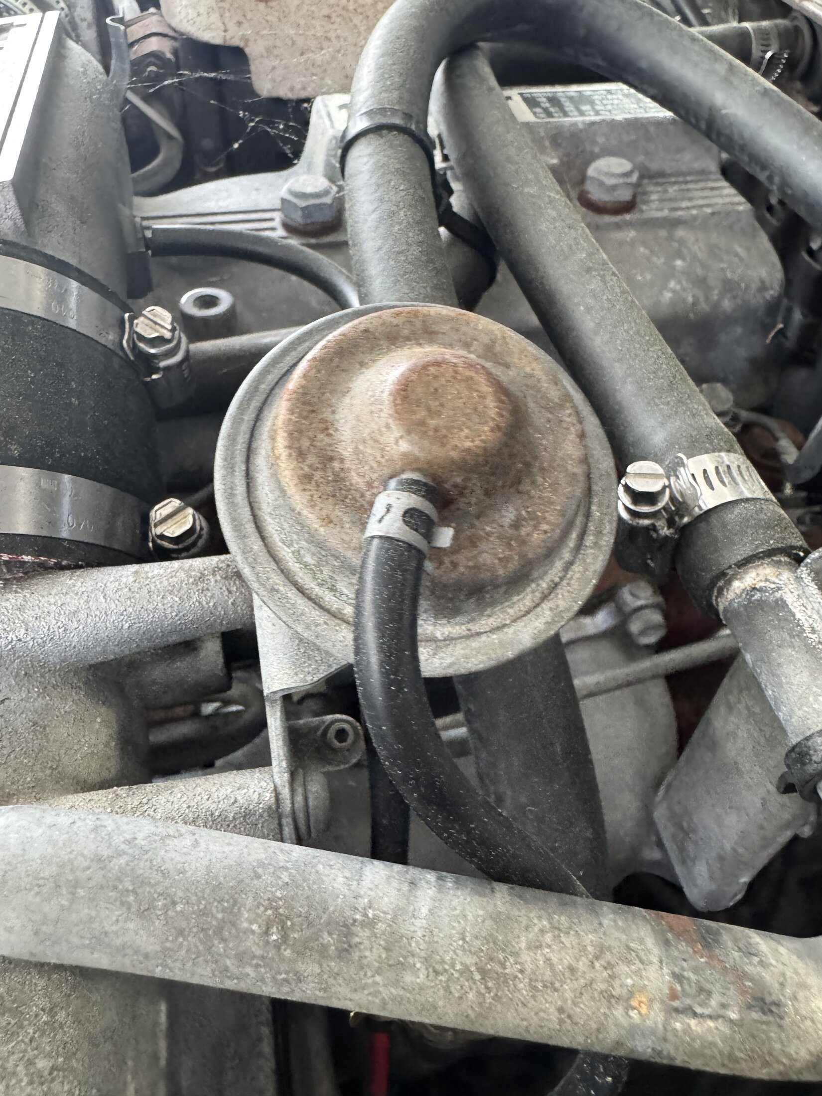

Any pics of the line. This thing has so many lines that I having a hard time finding the right one.

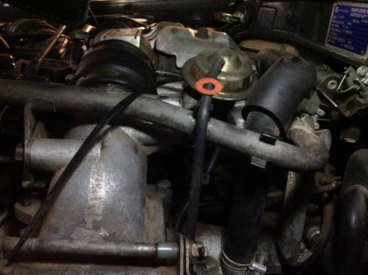

13bt shut off problem | IH8MUD.com Forum | Toyota, Lexus & Off ...
Unhook the line with the copper gasket on it.
If that’s not it, my guess is the transmission is bound up or something.
You can put the tcase in neutral and then try letting out the clutch slowly.

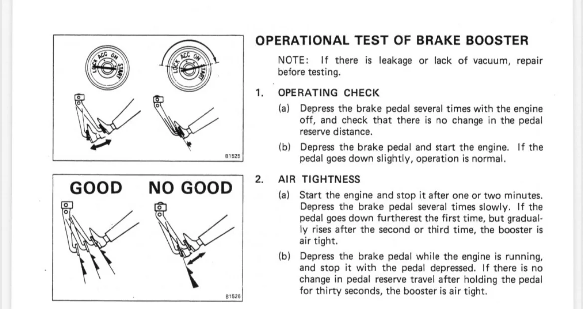

Yep. Tell tale sign your booster is going out. So that will cause the hard brakes and cab issues.
possibly your vacuum pump as well but there is a factory test I’ll have to find in the manual.
