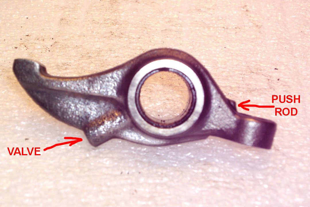

There are two oil exit holes in each rocker arm. one feeds the valve stem and the other feeds the push rod. So yes, oil should come out of 24 holes total for all the rockers.
You may see some come out around the rocker bushing as there is an outlet hole in the rocker shaft at each rocker. It depends on how worn the shaft and rocker bushings are.
Here are the hole locations on a rocker.

# 1 piston BDC is the only time the oil holes in the cam # 3 journal line up with the holes in the block. There is two positions of the cam where they line up and those two positions are when the # 1 piston is at BDC either on compression or exhaust stroke. When you picture that, keep in mind the crank rotates twice for each cam rotation.
Thanks this makes much more sense now 👍
