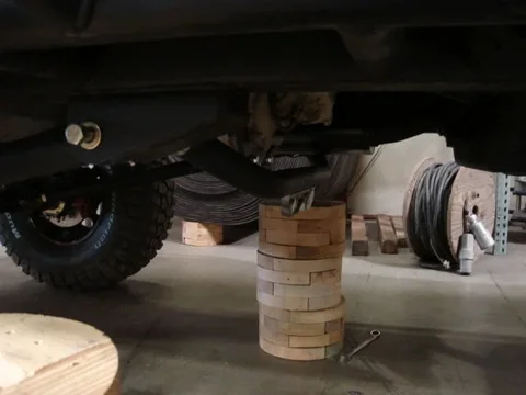

On Saturday I started on the skid plate for the belly. This crossmember is 1.75 x .25 DOM and will tie in between the two front lower control arm mounts.
Here it is burned in.
For the plate I started with 25" x 26" of .25 plate. I wanted to use regular grade 8 bolts so I cut four holes with a hole saw to countersink the heads.
On the back of the holes I welded .25 squares drilled out for a 1/2" bolt. The plate was bent up by cutting, bending, and re-welding and then sanding the welds down.
After some corner trimming and finish work it got primer.
I drilled and tapped the new crossmember and the rear lower link crossmember for mounts. The plate got a coat of "saftey red" gloss to match the highlift and hubs etc. In all I lost 2.5" of belly clearance but am happy with how it turned out.
From the front.
I painted the bolts with flat black to make them stand out. The Marlin guys are bringing me a locker guard to Moab that should compliment the plate.
