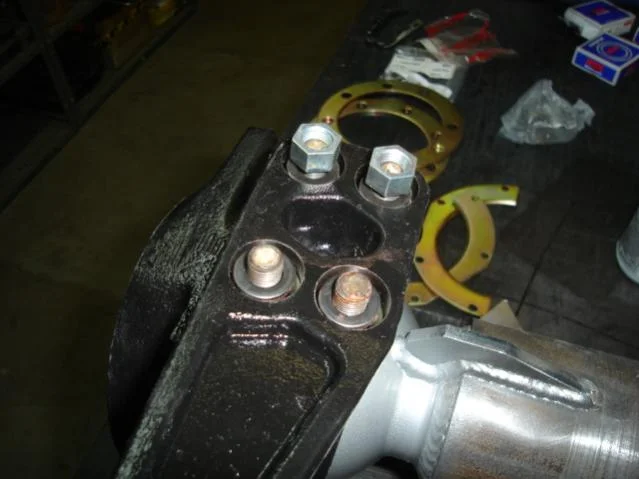

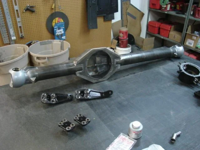

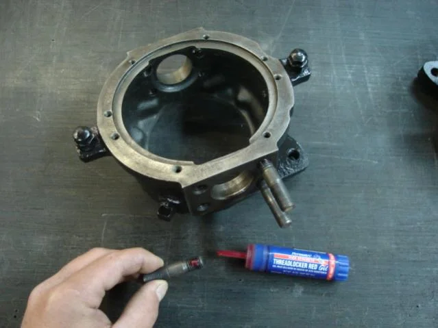

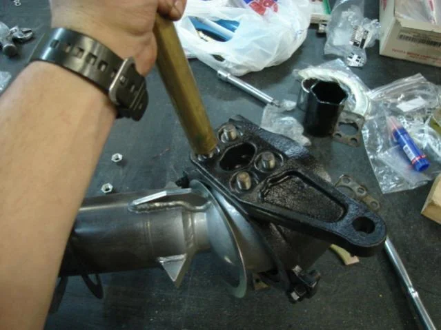

I finally got started building the front axle for the Heepetr. The next page or so is all instructions on how to assemble one of these axles. I felt like there wasn't a lot of axle builds with complete instructions/torque values so I decided to document mine. I have cleaned all the '85 parts with solvent and a wire brush and repainted. With a little patience and tape I managed to avoid all mating surfaces. Here I've removed all the knuckle studs and after cleaning them, I'm reinstalling them with a little high strength Loctite at 30ft/lbs.

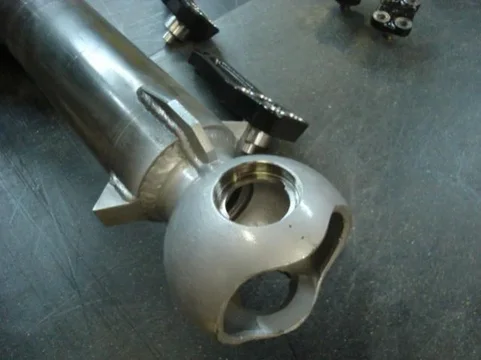

Everything ready to go.
The Diamond axle shipped with used knuckle bearing races installed. You'll want to remove these with a brass drift and reinstall new races.
With the help of a deadblow hammer and a block of wood, the new races were a breeze. I've read about people freezing them, but with a little motivation they went right in at room temp.

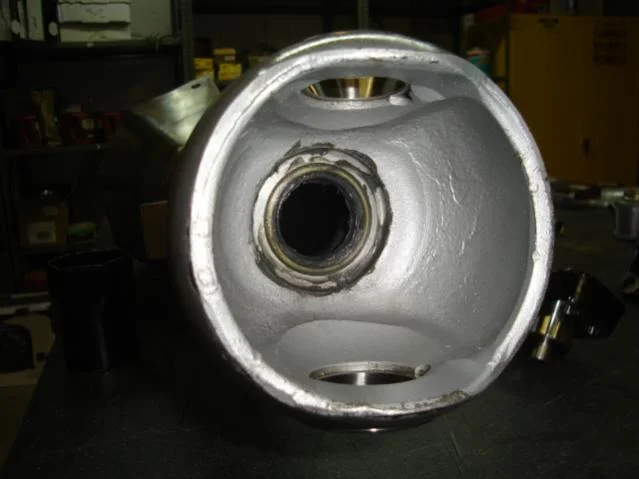

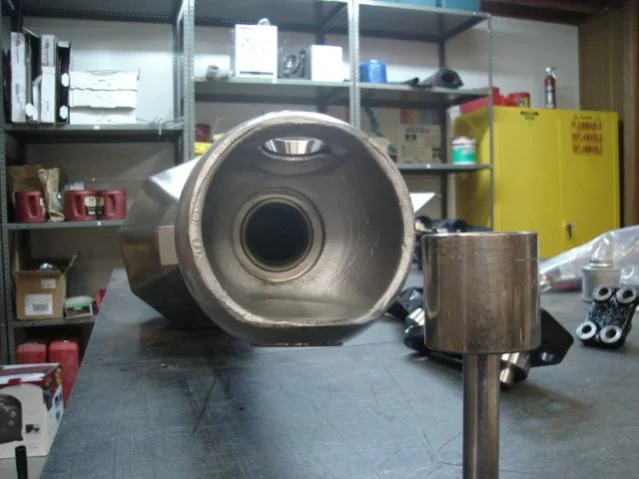

Next I installed the "inner" axle seals. I used a 1 1/2" socket with a 1/2" extension in it backwards. It made a perfect seal driver.
Next came the diff seals. The working room was a little tighter but the back of the spindle nut socket did the trick this time.
Don't forget to go ahead and grease those seals at this time. It's alot easier now then once the knuckles are on.

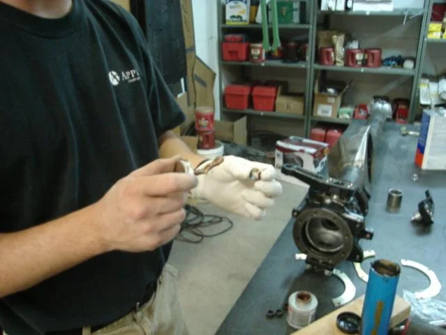

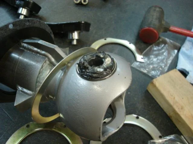

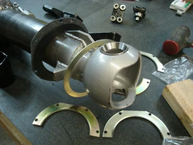

After the seals were greased, I slid on the knuckle wipes. First the felt, then the rubber wiper, and last the split ring. When I took the '85 axle apart I assumed the split ring would come with the rebuild kit and threw the old ones away. Not correct. $

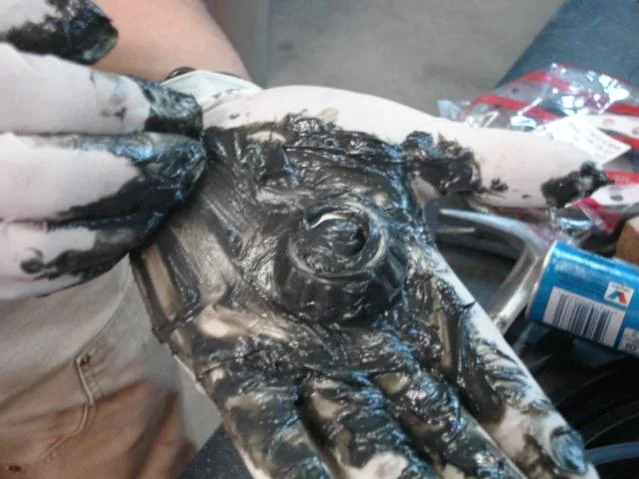

Next up, pack the knuckle bearings with new grease. I used Moly fortified grease because thats what my local master techs told me to do. Also make sure whatever grease you use that it's certified for use in wheel bearings...(high speed, high pressure).

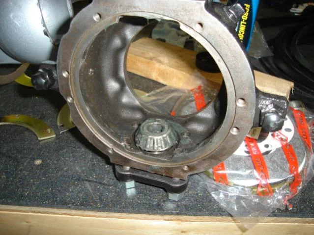

Go ahead and set the top knuckle bearings into place on the knuckle balls.

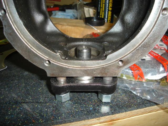

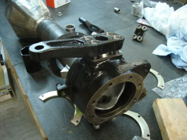

From there I assembled the lower half of the knuckles. When I took the '85 axle apart it had a thin and thick shim top and bottum. This is what I put back on the studs, followed by the cap, new wavey washers, and the nuts. Only run the nuts on far enough to hold everything on so that you can slip the knuckle into place. Too tight and it won't fit over the knuckle ball.
At this point you can slip another wheel bearing (already packed) onto the pin of the lower cap.
Slip the knuckle over the knuckle ball. I again added a thin and thick shim (like it had been on the '85) and dropped on the steering arm.

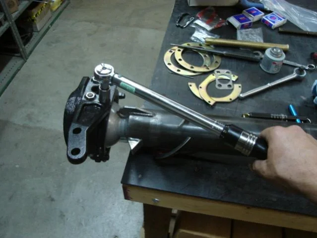

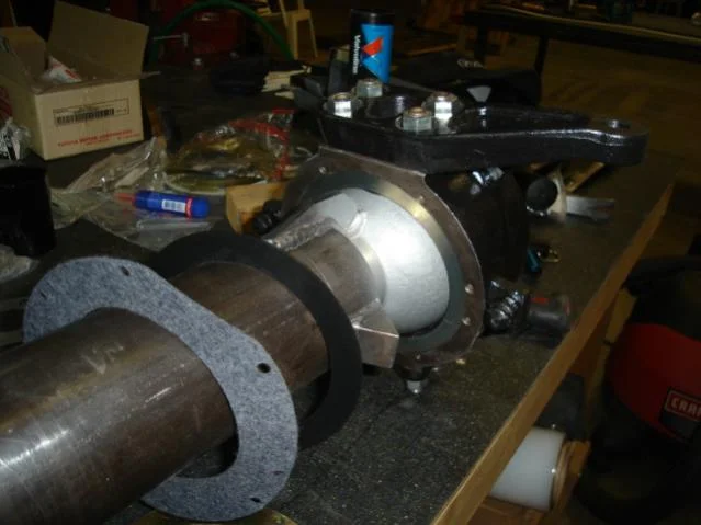

Once you have all the nuts installed torque the nuts to 71ft/lbs. I used a rotation similar to a tire install to try to bring the caps and steering arms down evenly.

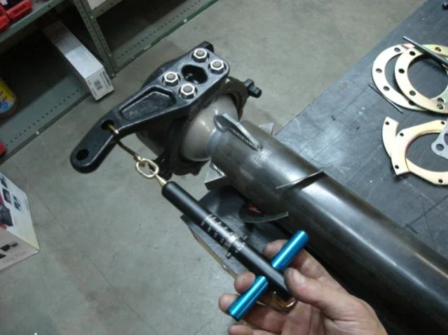

After everything is torqued up, use a pull scale to measure the turning resistance in the knuckles. Make sure to use the inside hole on the drag link side so that you're measuring both sides equally. The pull resistance should be between 7 - 13 lbs.
My knuckles ended up too tight at about 22 lbs. If you're too tight you need to add shims, too loose and take some shim out. An easy way to combat the cone washers is a heavy brass drift to the top of the knuckle studs. A few hits, and they ride right back up. The anti-seize didn't hurt either.
I tried the thin shim and two thick ones and ended up too loose. Next up was just two thick shims and the knuckles ended up good at about 10 lbs one side and close to 12 lbs on the other. After you're satisfied, you can move on to bolting up the wipes. Split ring first, followed by the rubber seal and finally the felt.

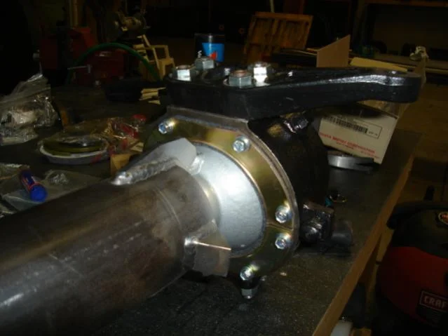

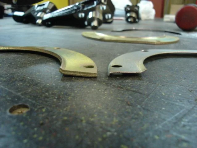

I opted to use Trail Gears' rock rings instead of the stock rings. You can see the difference here.
Make sure the rubber seal is seated all the way around and you can go ahead and tighten up the rings. I used a small 1/4" ratchet on these fasteners to make sure I didn't get carried away.
