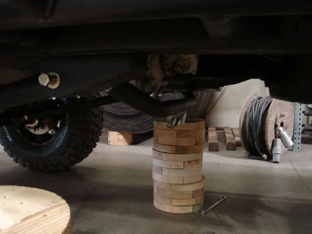

On Saturday I started on the skid plate for the belly. This crossmember is 1.75 x .25 DOM and will tie in between the two front lower control arm mounts.

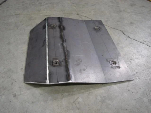

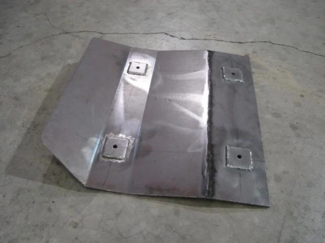

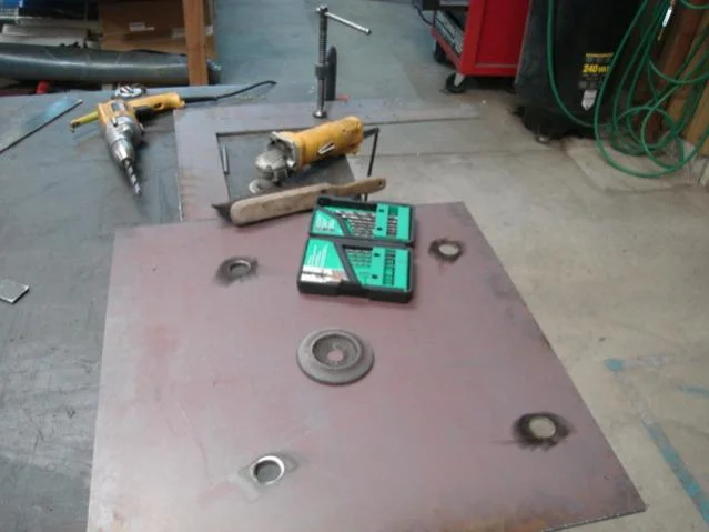

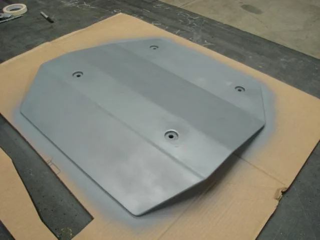

For the plate I started with 25" x 26" of .25 plate. I wanted to use regular grade 8 bolts so I cut four holes with a hole saw to countersink the heads.
On the back of the holes I welded .25 squares drilled out for a 1/2" bolt. The plate was bent up by cutting, bending, and re-welding and then sanding the welds down.
After some corner trimming and finish work it got primer.

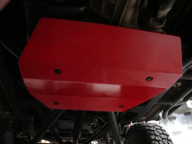

I drilled and tapped the new crossmember and the rear lower link crossmember for mounts. The plate got a coat of "saftey red" gloss to match the highlift and hubs etc. In all I lost 2.5" of belly clearance but am happy with how it turned out.

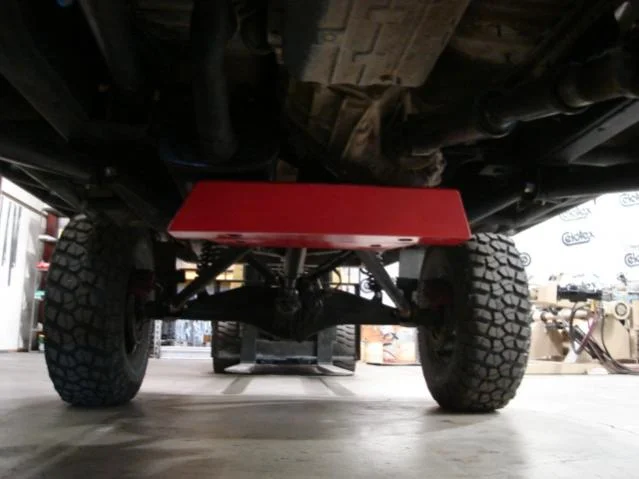

From the front.
I painted the bolts with flat black to make them stand out. The Marlin guys are bringing me a locker guard to Moab that should compliment the plate.

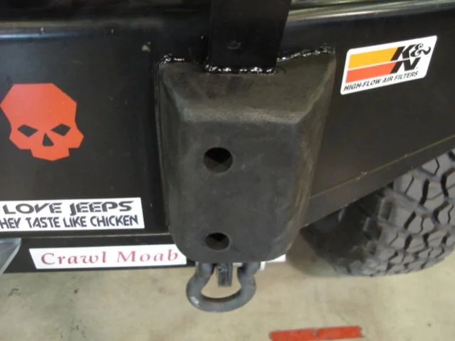

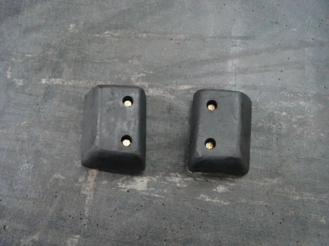

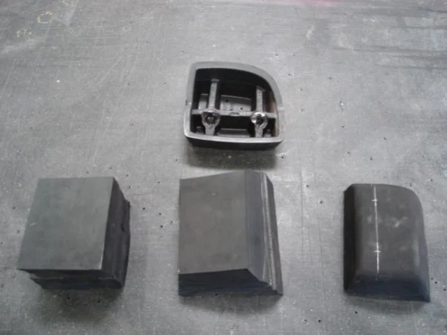

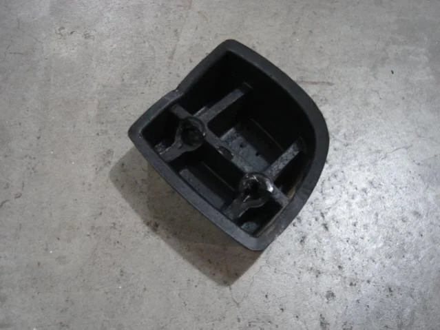

I was using my front bumper to push open a chain link gate yesterday and doing so tore the flimsy molded pad off of my ARB bumper. No the gate was not locked or latched. I was very disapointed with the strength of these bumpers so off they came.
I decided to rebuild my own from the same expasion joint material I used for the front bump stops. Here they go from block to bump with cutting and sanding.
I used a spade bit and a punch to recess 5/16" bolts into the face to bolt back into the original holes.
