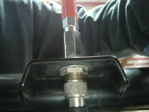

sorry to hijack, but what kind of antenna base do you have for your ARB? I have had trouble keeping my CB antenna tight.

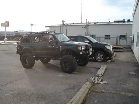

After almost 9 months I was finally able to roll the truck out into the middle of the shop. I will have to get heavier springs for the front and modify the rear axle end coilover mounts a bit but it was nice to finally see it out of the coner.

Almost 48" under the tire.
Mmml4, I'll have to check on the separation measurements and will post up tomorrow. Pillguy, not sure why you've had problems. I'm running a typical Firestik antenna with some mounting parts from Radioshack. The difference might be that I have one of those serrated external locking washers in the stack. It has been mounted for about 2 years now with no problems. If you'd like I'll take a close up picture of the mounting confirguration.
I would greatly appreciate it if you could post some close ups. Your truck looks great.

Pillguy here are some pictures of the antenna. From the top with the nylon isolator.
And from the bottum. It's hard to see but the serrated external lock washer is between the nut and the flat washer up top. It seems to help to keep it from coming loose.

Thanks dude. I think my problem has been not having a good lockwasher. I used some plastic washers to fill the gap of the hole in the ARB and it usually kept coming off after a time.

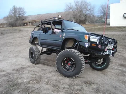

I'm glad you guys are enjoying the build. It's been a lot of work and it's always fun to see it start coming together. I hope to have the new springs in a week or so and will post some more pictures then. Both front and rear spring rates proved to be too soft. Looks like I'll be trying 150/250 front and rear. Currently it's 100/150 front and 100/250 rear. The front is way too soft and the rear would be perfect had it not been for an empty fuel cell and no recovery gear.
I had Offroad Engineering figure the initial rate and we've adjusted from there. The 100# springs were far too soft but with 150/250 at all four coners the truck sits perfect with only pre-load by hand. It is incredibly soft and needs a sway bar badly though. I finally got it out this evening for a little experimenting. Here's a couple more in the shop.
50" under the front tire before the rear started to lift.

I took the truck down to Fort Missoula for some very mild "offroading"; nothing hardcore but a chance to see how the suspension rides. Aside from needing the sway bars for street use it rides awesome and tracks straight with no hands on the wheel. Corners at speed feel like it wants to roll over but bump steer is minimal.

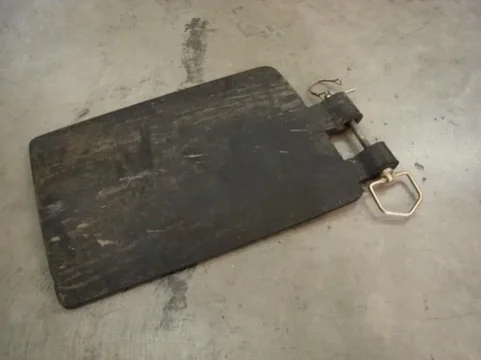

have any close up pics of the mud flap set up?

Thanks guys. Scottryana I may still have some suspension tuning to do also. I havn't run the numbers yet on the calculator and need to do some refreshing to understand where it could help given the adjustment I have. I know the sring rate was estimated using the sprung/unsprung weight and where I wanted the truck to sit at ride height in relation to coilover length. The front is just slighty heavier but I also needed a little more compresson at ride height in the front and that's why the rate ended up the same front and rear. Aside from the body roll in the corners it otherwise handles pretty well. I looked it over this morning and discovered a very slow leak in the steering box. I was sure I'd probably run into this because I chose not to put a new seal kit in the box when it was out.:rolleyes:
Benmara here's a couple shots of the mud flaps. I made them from conveyor belt I vulcanized some hoops into. They pin through the rear bumper with some tractor pins.
dammit that looks good man!:eek: The Heepetr looks hungry!!
