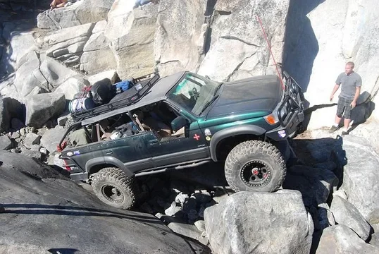

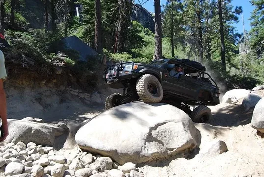

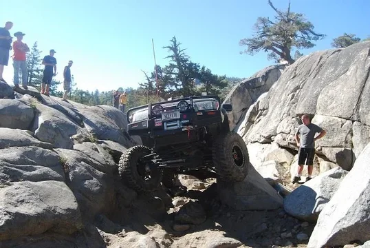

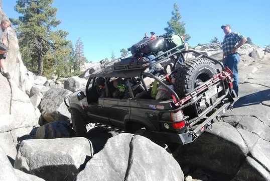

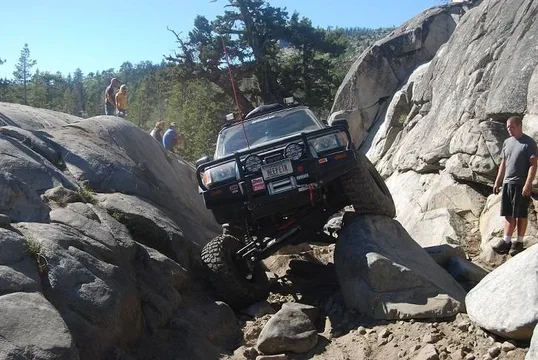

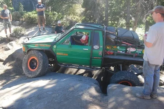

I met up with Randy and Justin for the Marlin Crawler Roundup on the Rubicon. Also met some new friends Matt and Anna with their 40. Thanks all for a great time. Here are some shots of the Heepetr on Little Sluice and Big Sluice.

I seem to remember some sort of pin striping on the passenger side...huh. It was great wheeling with you, your rig is sweet!
so are you please with suspension performance? anything you need to tweak?

Lenross1, I've been very pleased with the suspensions performance. The truck still needs sway bars to control the body on the off camber stuff. Hopefully this winter it will get a set. It took a while to get used to just how far the truck can lean, but I've found it amazing just how stable it still is. (I'm sure it has something to do with the 67" wms.)

I sent Randy the pictures from the Rubicon. You might want to get copies from him as there are a bunch of good ones with you piloting the Gecko. Here's a teaser of you conquering the Soup Bowl. Had a blast wheeling with you as always, and thanks again for all the spots!

And Matt dominating the Big Sluice.

The Gecko is awesome, one of the nicest rigs on the trail! As for my 40, I am ready for arb and an h41!

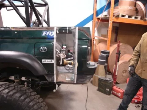

Glad to be back. What's going on...Can I help?...... I made awesome progress tonight only to come home and find out I have the wrong cable for the camera I've been using. I took all the pics on the shop camera cause it's always set up on VGA but when I got home it was the wrong hookup... Anyway I'll post pics tomorrow. We got the body cut and ready to weld back together once some modifications have been done to the crossmember or it's been removed. Good progress though...pics to follow...
The pics from last nights' work...ready to go under the knife.
I had to cut part of the cage free as it will need to be shortened.

The left side was the challenging one to get 8" out of. It's going to just work without getting into the pinch welds or losing any more support.
8" from the outside. The cuts were staggered by the width of the tape from the outside to inside. This way the welds will not share the same plane.
