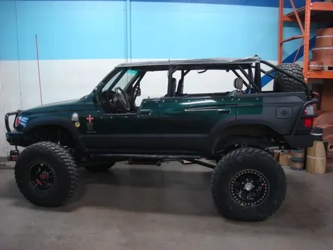

It's sitting high now without the bumper/tire/tool boxes but I'm not sure how the reduction in leverage will play out. I'll probably have to back off the pre-load a little. That will force me into limit straps also (which I should have already had on).

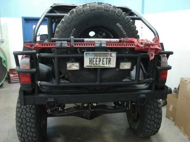

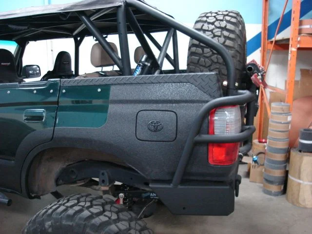

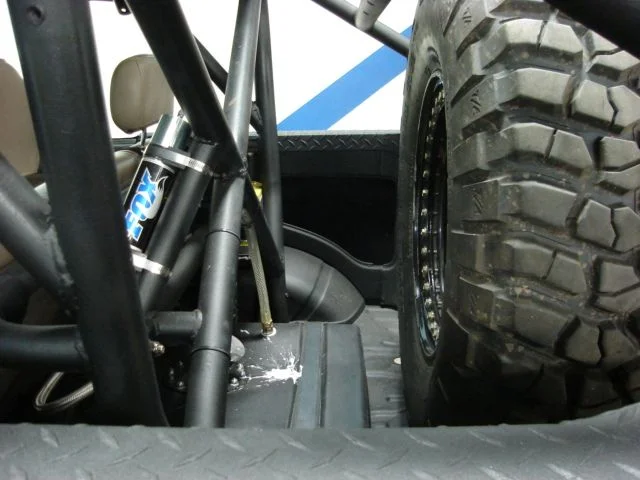

I haven't posted in a while but have been working on the truck when I can. I was trying to not burn the midnight oil before Moab but as usual that's what it's come to. The bumper finally got finished last night. It's basically a new revision of the previous one... I reused the center section with the tire carrier and built the rest from scratch. A little heavier duty this time. The main tube is 3/16 and the brake light guards are 1 1/2 - .120. I also got the bars finished for the shoulder harnesses but forgot to take pictures of them. They were also made from 1 1/2 x .120. Here are some pictures of the bumper and the lack of room between the spare and the fuel cell where my cooler used to fit!
