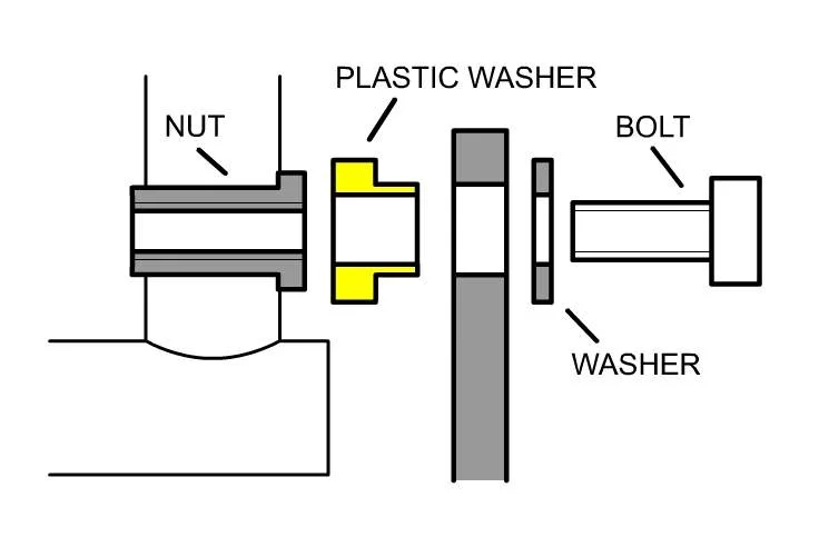

Thanks, but I just figured it out. Had to pop out a retaining ring (which I couldn't see when I first started trying to figure it out), then two bolts on the other side and it popped apart.
I try to figure it out, maybe it helps. I did it last week.
