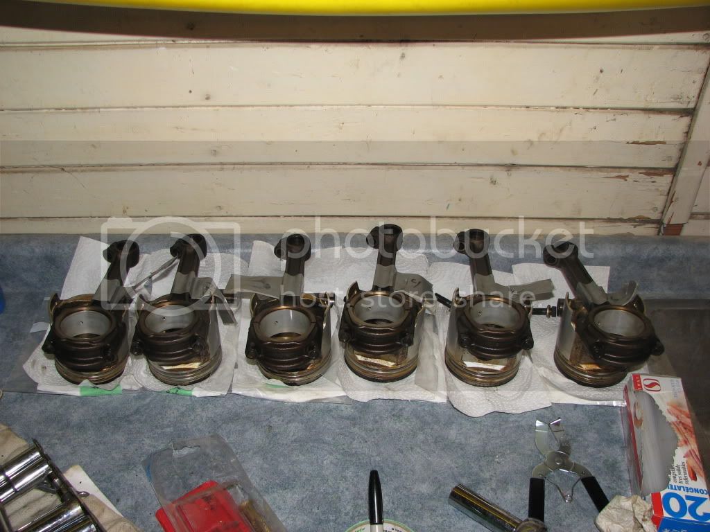

Disassembled the piston/rod assemblies yesterday so I can clean and balance them and the internal engine coatings showed up today. Hopefully I can keep forward progress on this and school going at the same time.

Just dropped the pistons on the scale after getting them most of the way cleaned up. Three were 564g and three were 565g. Might not be much involved in getting things balanced :cool:
With old bearing shells still in and no bolt on the pin end:
1- 991g
2- 1007g
3- 1029g
4- 1026g
5- 1001g
6- 1005g
So there is about a 4% spread. I'll have to make a rig before I can break that down into big end and pin end measurements.

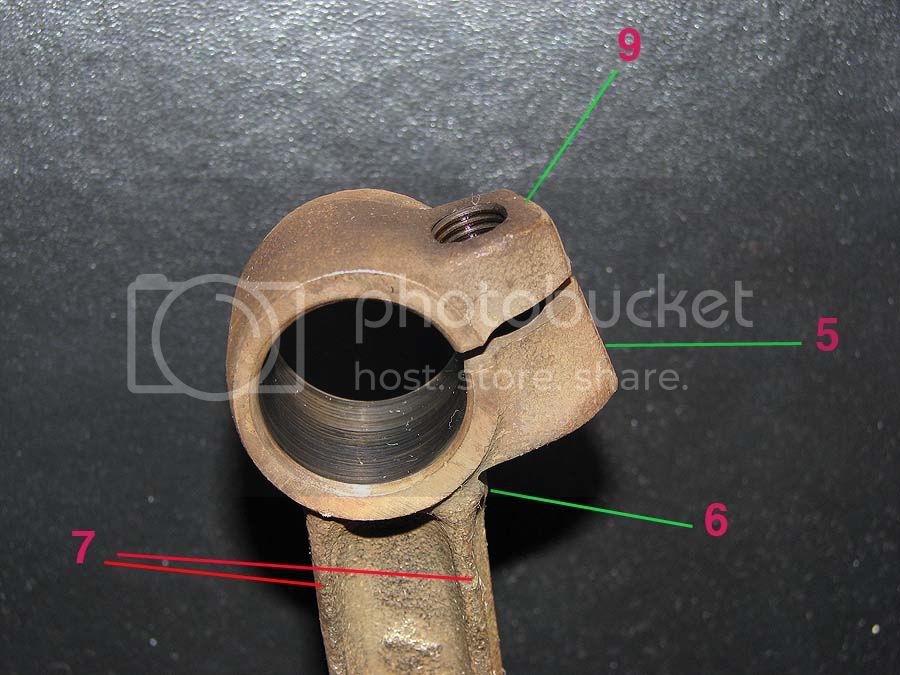

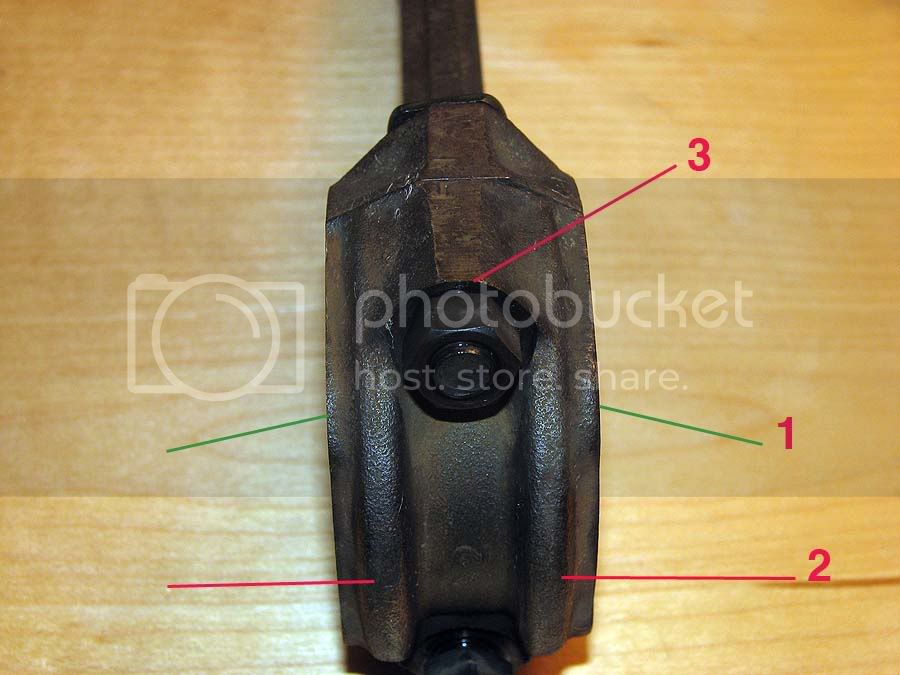

I'm getting ready to balance the rods, so I could use a little insight on where to remove material. There are no balancing pads on them, so I've gone through and identified a few potential spots to remove weight, the ones identified with green lines are ones I think would be safe, the ones identified with red lines are ones I think are questionable. Thoughts?
1. Flat machined bumps on the sides of the cap.
2. Reinforcing arches along the cap.
3. Edges of the "nut landing pad" beyond the contact area with the nut.

5. Slightly raised ridge cast in the edge of the pin bolt "boss".
6. Machined-down "bump" on end of beam near pin bolt head landing.
7. Edges of the I-beam where not stamped.
8. Edges of the I-beam where stamped.
9. Top rim of pin bolt "boss" (some excess material present here on some rods, and area is generally beyond where strength is needed for threads).
