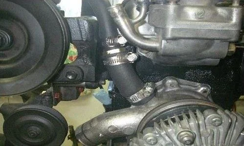

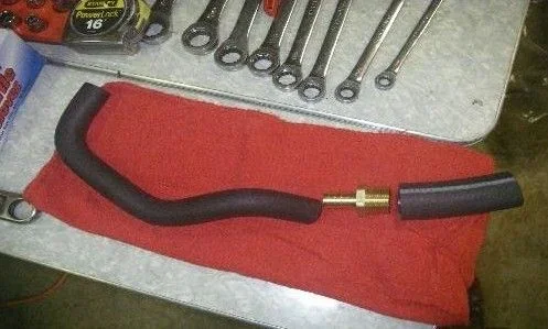

you'll have to use the 2f waterpump. The 3fe wont mount up. Hose sizes are different so you've gotta rig up a reducer.
Here's mine
Home Depot fitting

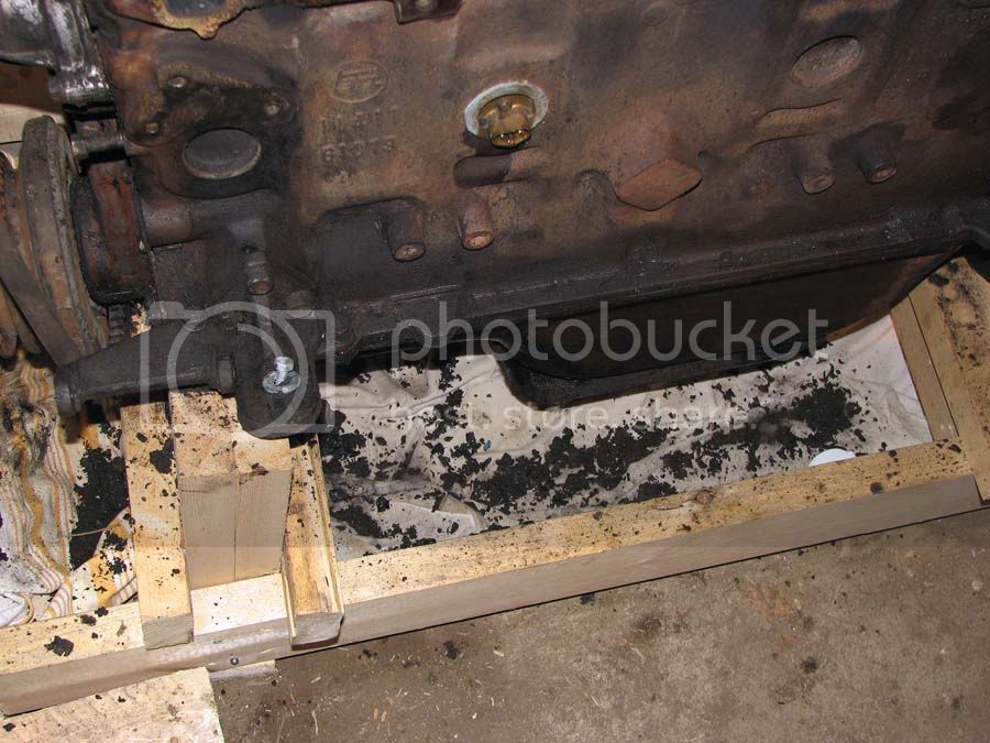

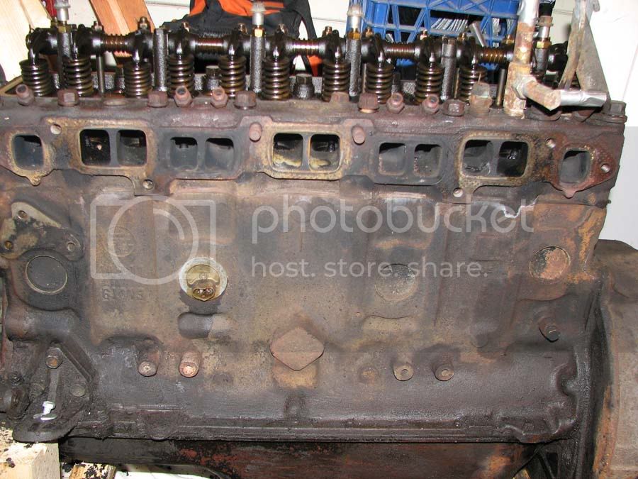

Started cleaning and tearing down the 2F. Might get the head off tonight if I don't sit watching the playoffs too long. Man 25 years leads to quite a coating of grime. :eek:

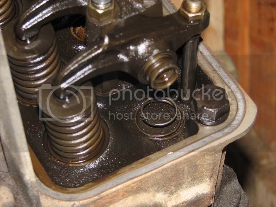

A few pics for no good reason:
Extra credit for the first to point out the obvious.
The 2F came with a block heater?
Stamped "made in Canada" ;) Likely dealer installed or installed by a previous owner when it came north.
