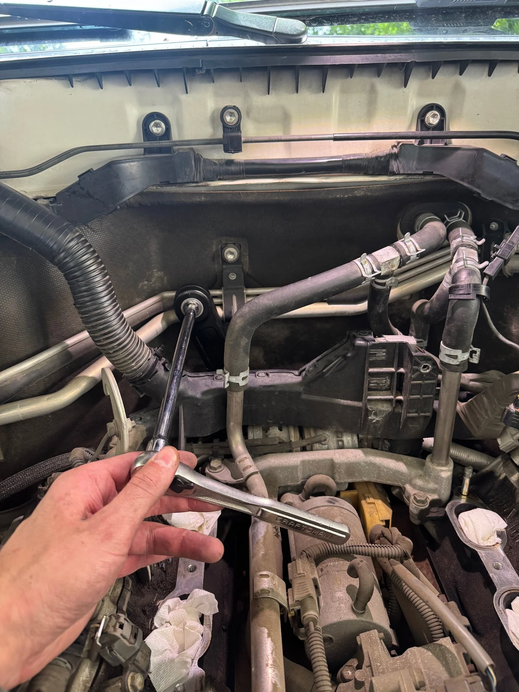

I decided to go ahead and just pull the starter. Getting the intake isn't that bad, but holy cow the starter itself is a massive PITA. Not to mention the pictures i see online of other people's engines with the intake off it looks more simple than mine; I have more components butted right up hard against the back of the starter. Its insane Toyota designed it like this, I just have to keep taking more and more and more off the engine to replace one relatively simple part. I do have a tip for others doing this though, get yourself a "tite-reach" extension wrench, it makes accessing the starter fasteners much more simple.
you should plug all the intake holes so nothing gets down inside them
My guess from your symptoms is the starter, but you'll know for sure soon . replace your knock sensor connectors while you're in there

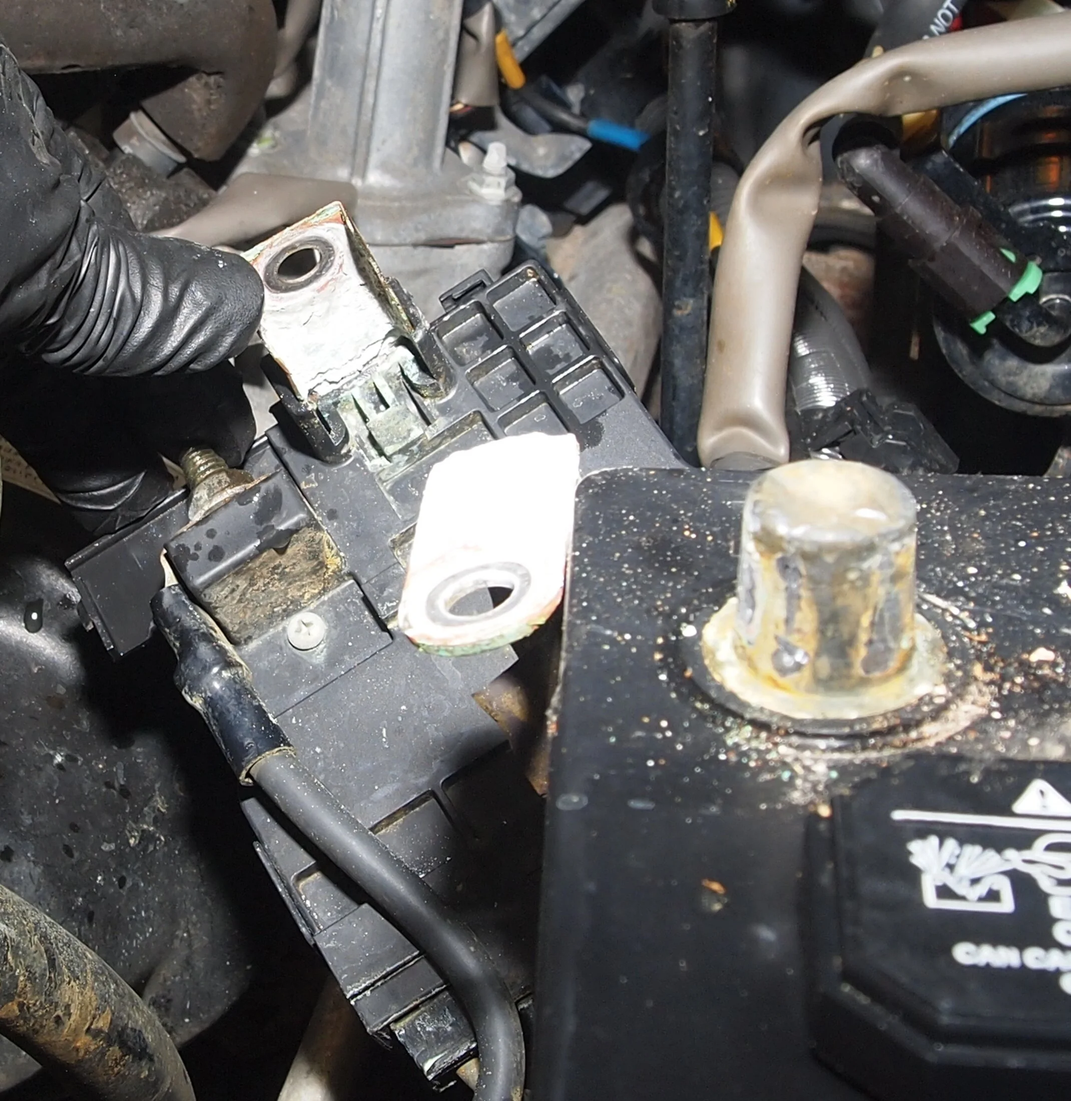

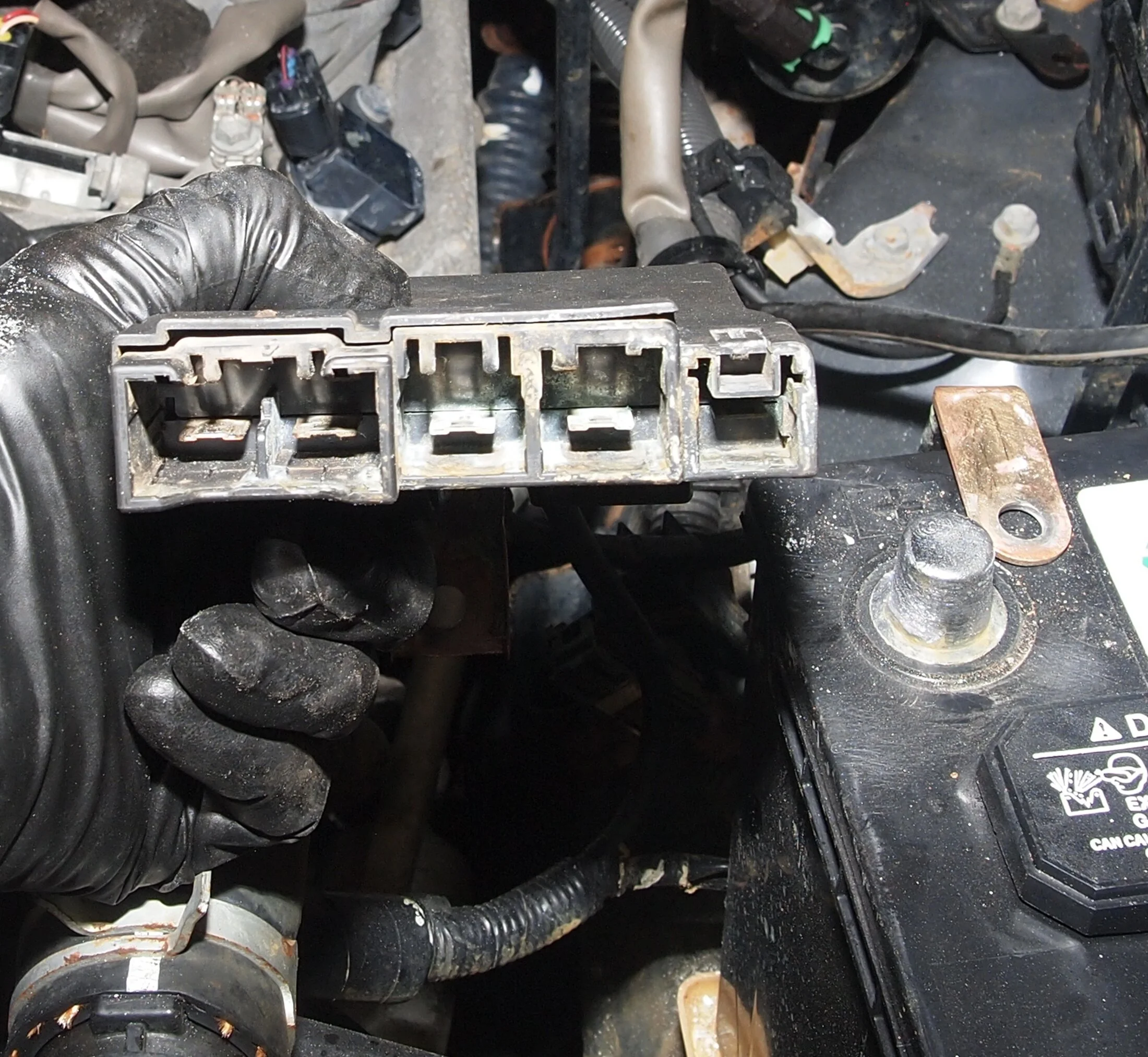

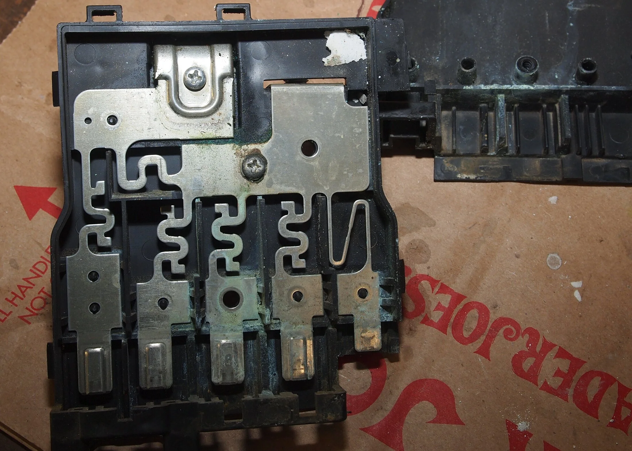

Seems you've ruled out, battery or battery cable issues. But we also want to make sure battery acid hasn't creep into fusible link ( black box, hanging off battery positive post) and wire block connected to bottom of it. This happens if battery not carried for with regular cleaning with baking soda to neutralize acid.

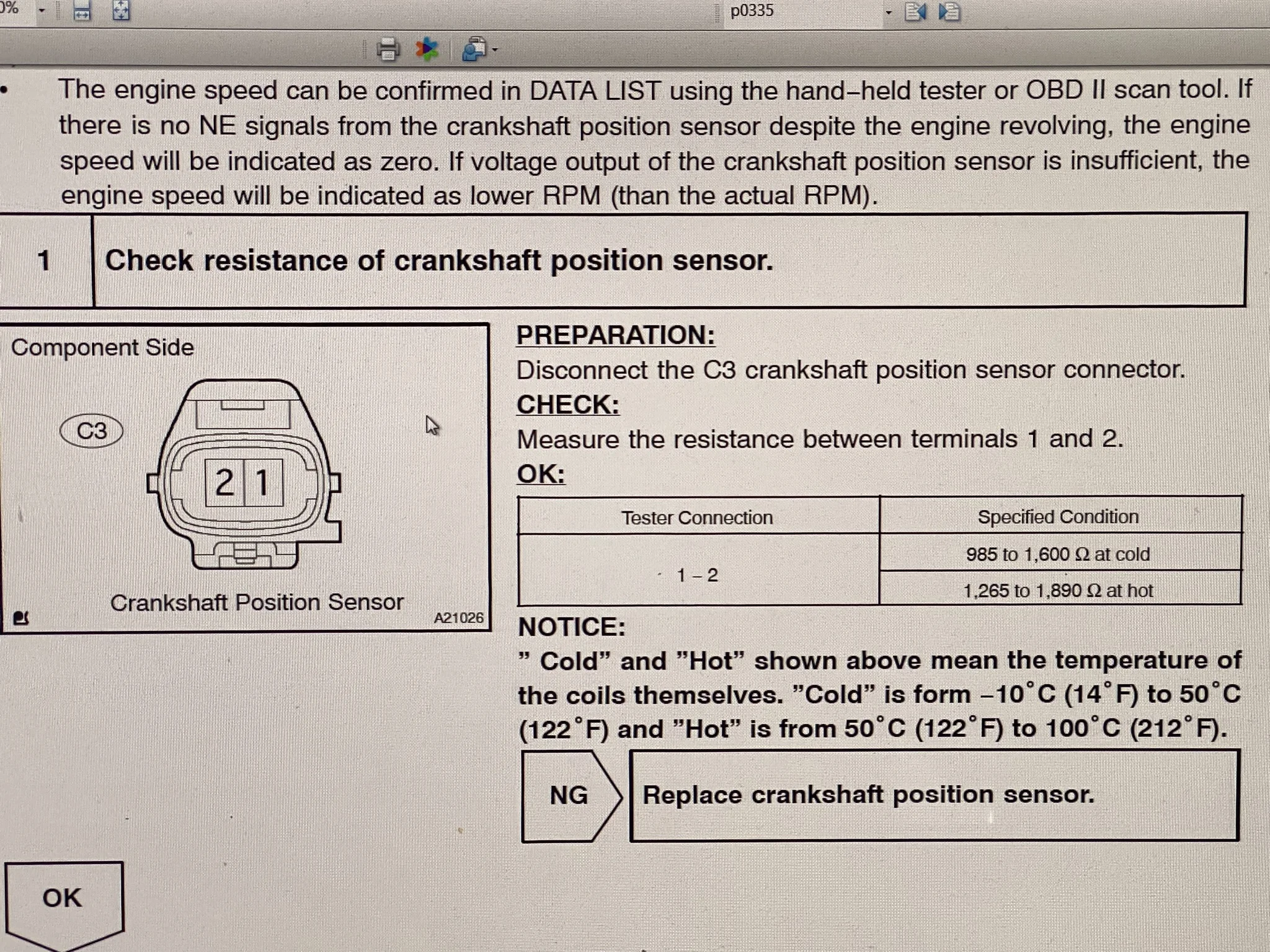

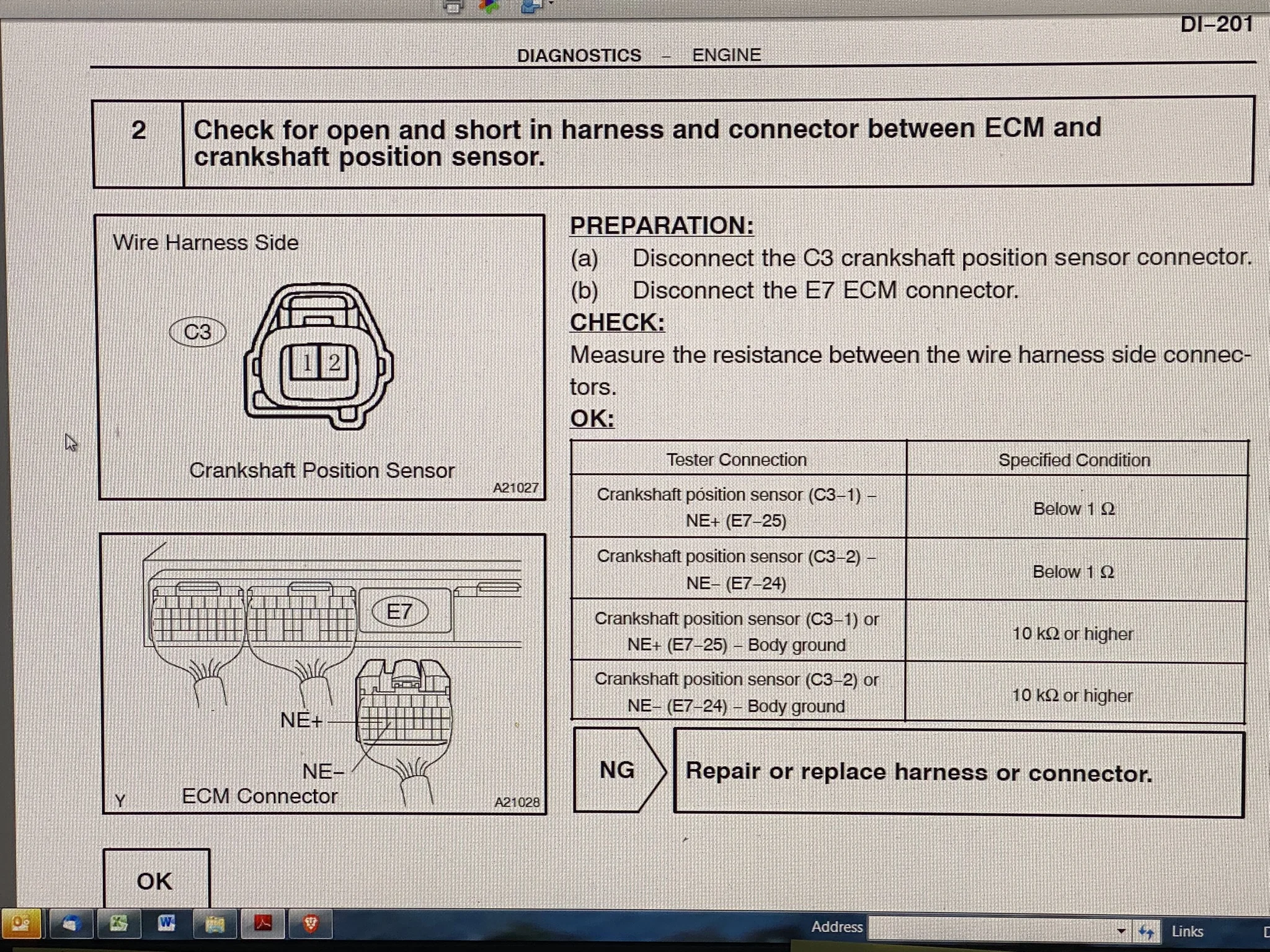

It can be spark, more often fuel is related. This is very often, a no/low fuel flow/pressure issue. Which fuel pump only engages, when engine cranking (crank shaft spinning). Which the crank position sensor (CPS) is responsible for telling ECU, to send power (12Volts) to fuel pump. So this can be a bad fuel pump or any part of the circuit to fuel pump. Even bad gas clogging fuel pump sock and or fuel filter. Watch fuel trims can yield clues here.
There is also a issue with hot start I've not seen. A TSB (see pdf attached), dealing with cam sensors. But you should see P0335 and or P1340.

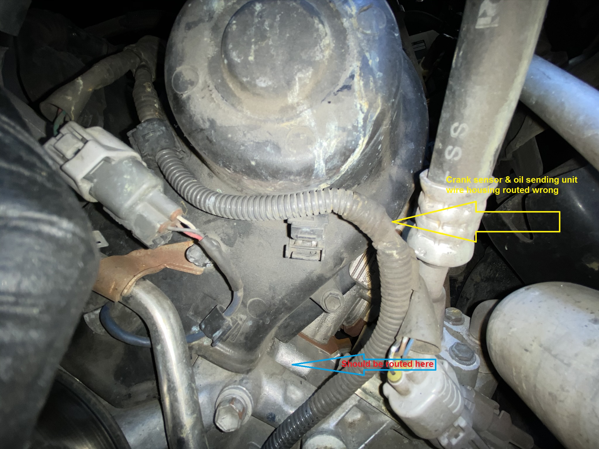

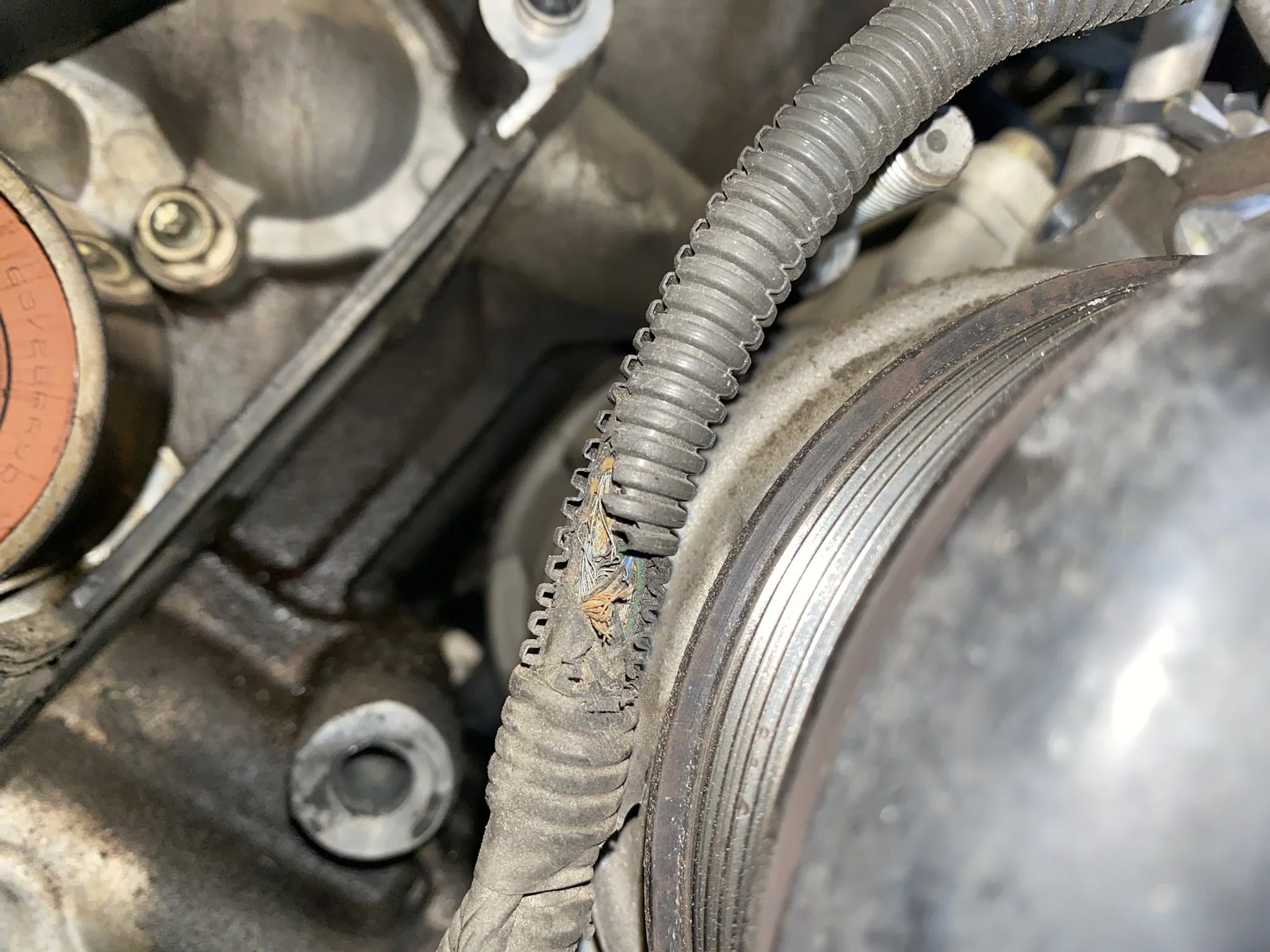

I'd also look at wire to CPS & oil sending unit. If routed wrong (in front of fan bracket), they may rub on fan belt and be cut. If only partially cut, may be intermittent short.
Wires routed wrong is common issue, after timing belt or fan bracket service. I'll be fixing this one to day, as soon as off the forum.

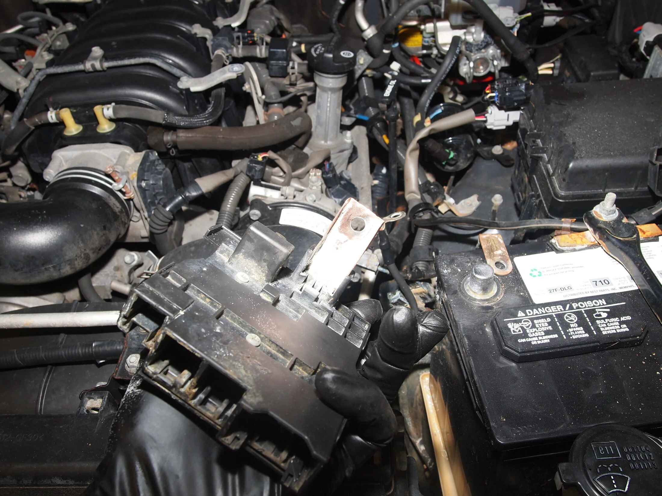

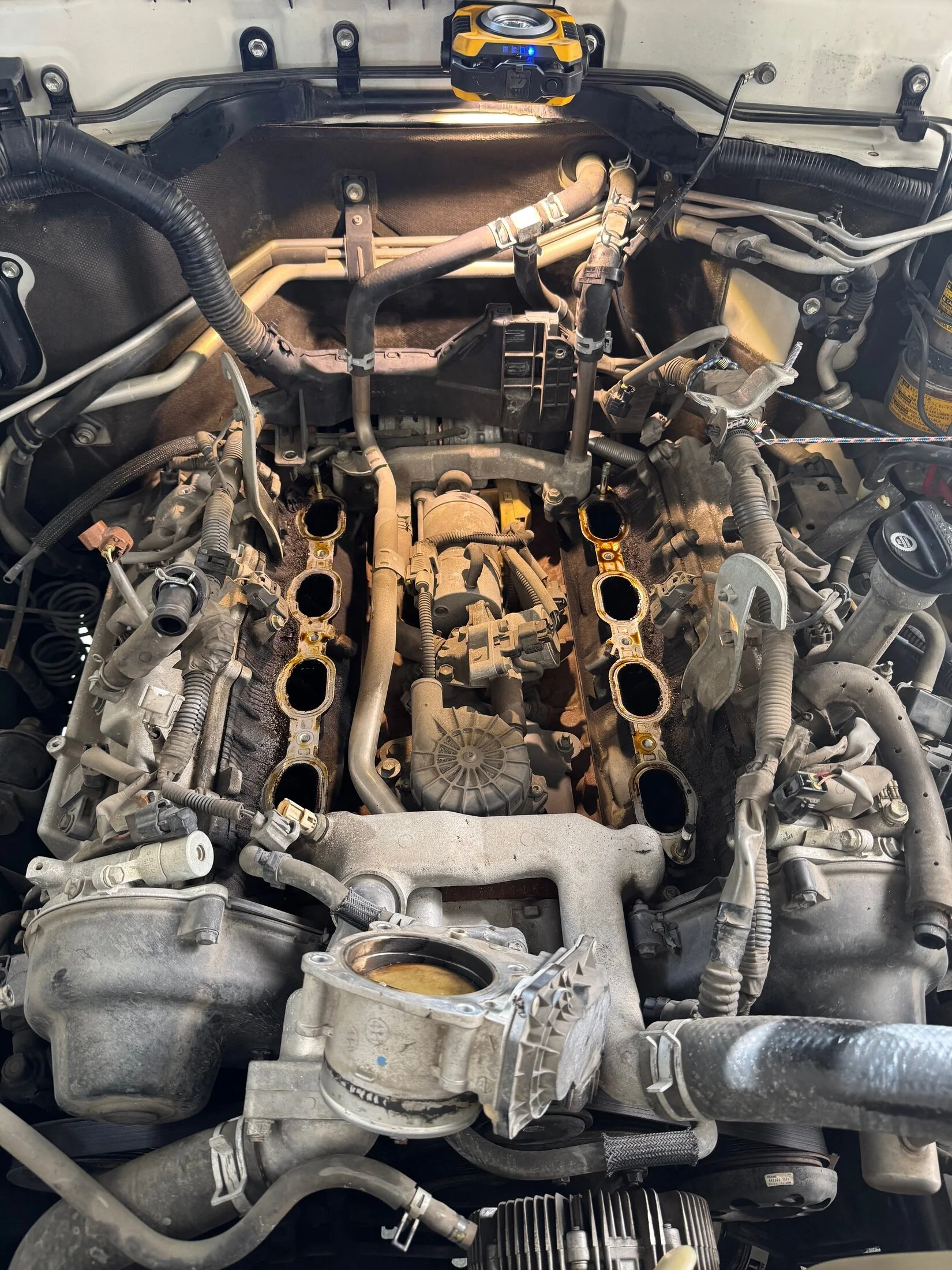

Tips for VVT starter job:
  • First as always, clean top of engine first. last vacuum out the rag from intake ports and vacuum ever spec of dust from intake ports/valves also.
  • Replace all gaskets that are removed. i.e. intake manifold gaskets. In the VVT they're rubber, and shrink with time. We then get oil seeping past them, as I see you have.
  • Use a torque wrench.
  • Just cut the long hose going from SAI main switching valve, that goes back to rear water bypass. Replace with new.
  • Unclip the wires housing blocks,from SAI pump and SW. Replace any, that the locking clip breaks off from.
  • Remove the two nut and two bolts, securing the SAI mounting plate to block. I use my 3/8" drive extension and 12mm socket. Which my extension will not fit pass the front water bypass on BK2 side, with socket on the extension to get at that nut. So I use forceps, to place 12mm socket on nut first, than extension on 12mm socket.

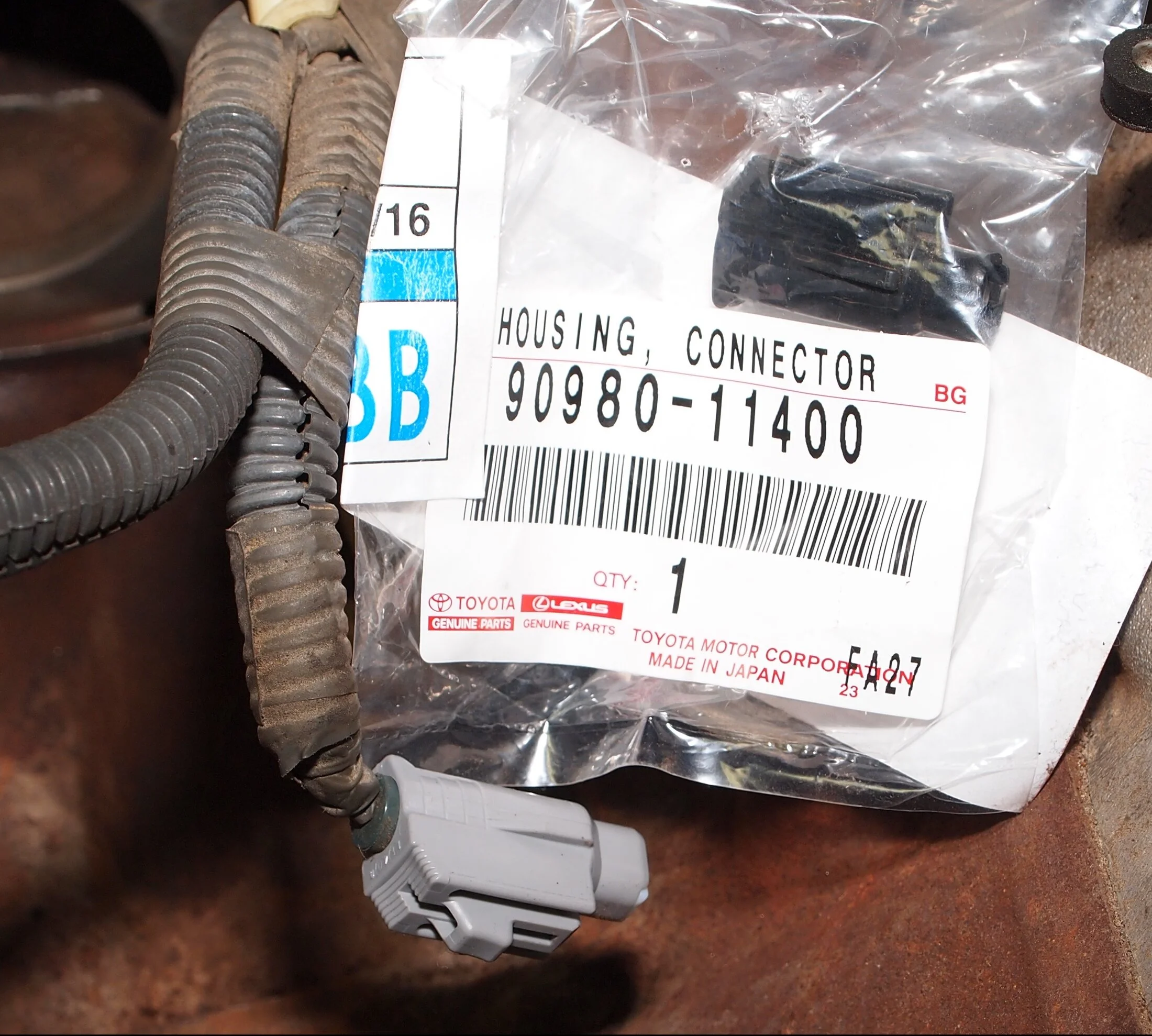

The start wire housing block (below) locking clip, breaks almost always. Replace if it does. Note, all wirehousing have suffix of part number on them. All have the 90980- as prefix
While in there! Good time to do my SAI replaceable filter MOD.
BTW:
I reset contacts plates, of all remanufactured starters. Why: If rebuilder, did get contact seat properly/flush, you starters contacts may prematurely fail.
Note: There is a small ball bearing in bottom of hole, plunger goes in. Don't lose it. Ball bearing is not (seen) in the plungers hole, in below picture.

Fusible link
Acid buildup, results in high resistance in wiring and many issue.

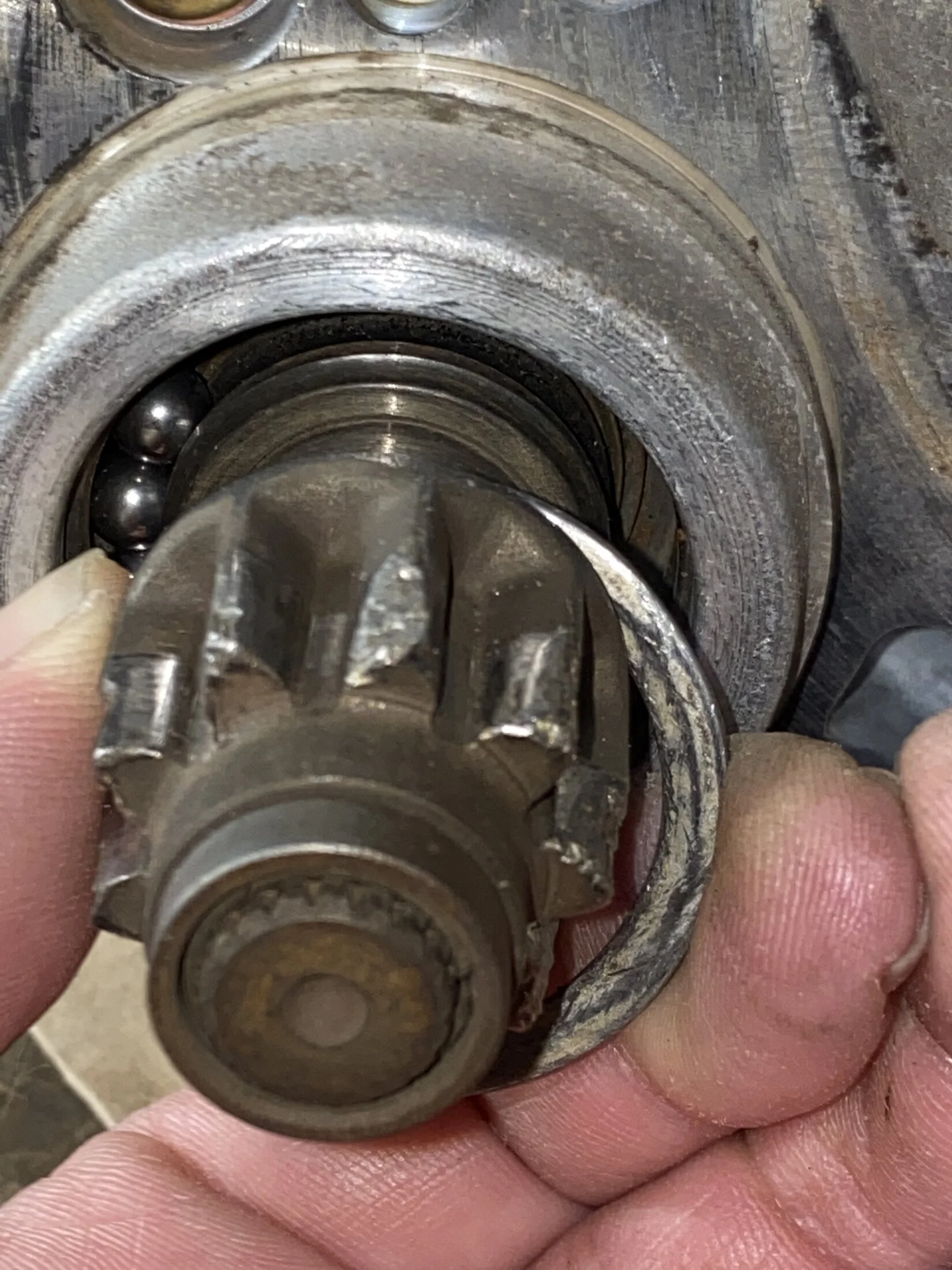

Okay now for the update! When I pulled the starter I tested it and the new one. The old one was definitely bad. I took a long time to clean everything, and I also elected to replace the fuel injector insulators and O-rings. I figure if the intake gasket was aged, then so had the injector rubbers. The O-rings actually still looked really good but the insulators were definitely starting to get really hard. I did not remove any of the fuel banjo bolts, I just lifted both rails at the same time, so I had no crush washers to replace.

Video of the bad starter:
Video of testing the new starter:
Requested photo of battery terminal
With the new starter the car now starts up like a champ! Thanks for everyone that contributed and hopefully this may help others in the future!
