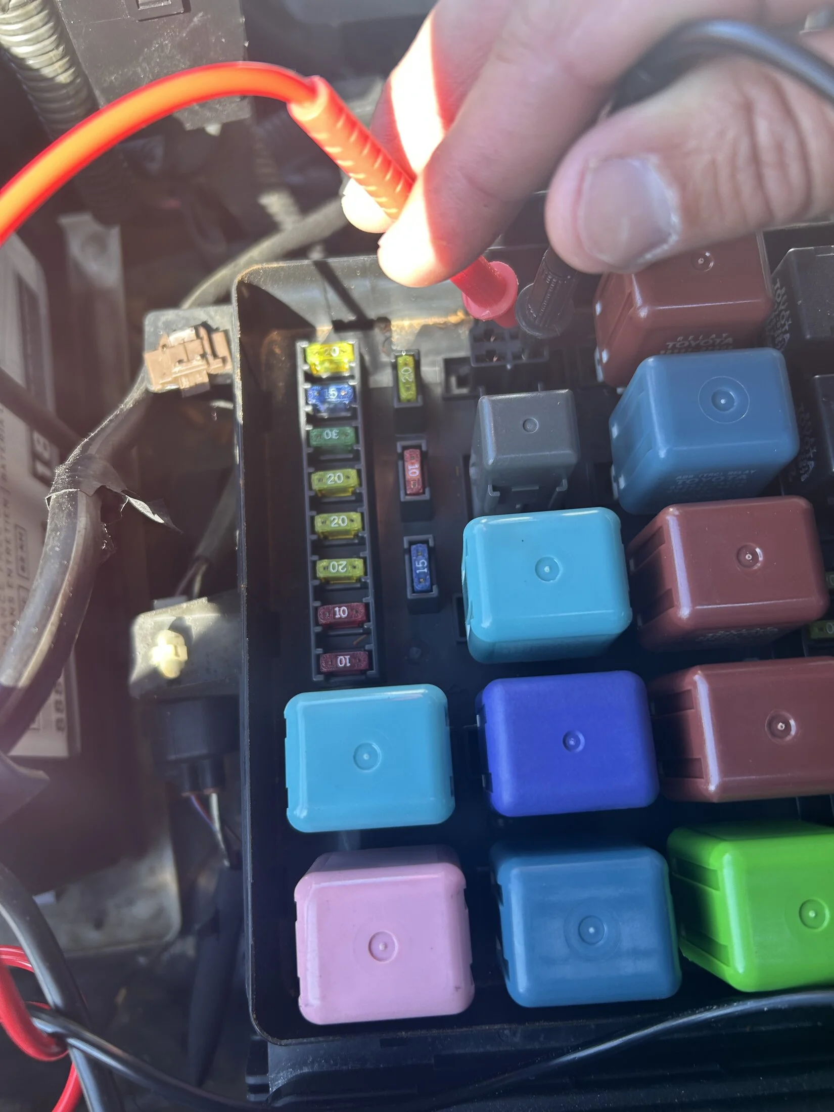

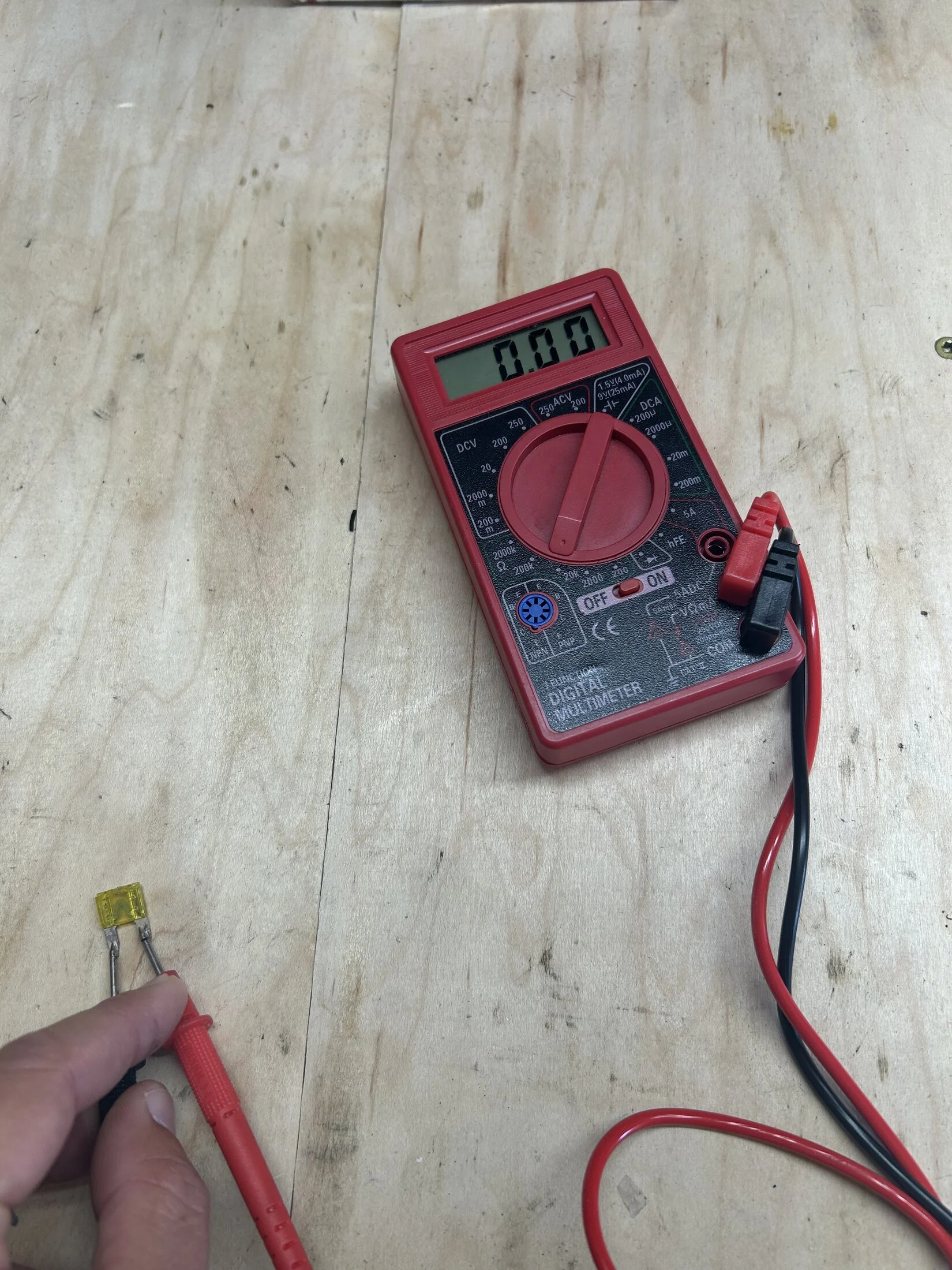

Here is the 20 amp fuse for the EFI.
This also passed. The prongs were a bit dirty so I gave it a very light pass with a high grit sand paper, threw a dot of dielectric grease.

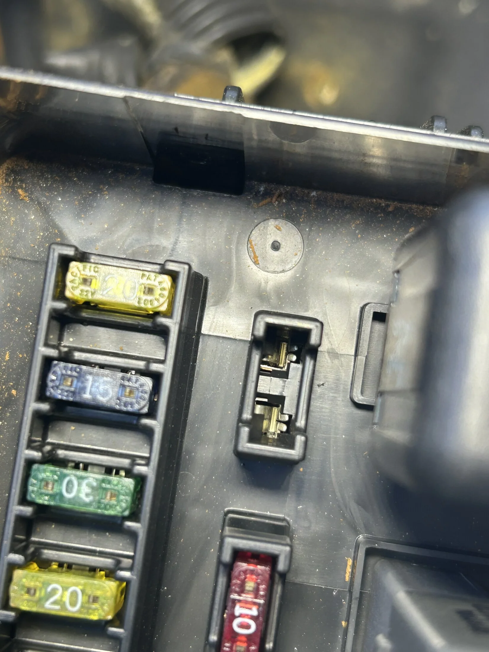

This is the space for the 20 amp fuse and it looks good to me. But also the fuse was snug coming out and snug going in. So the connection seems good.

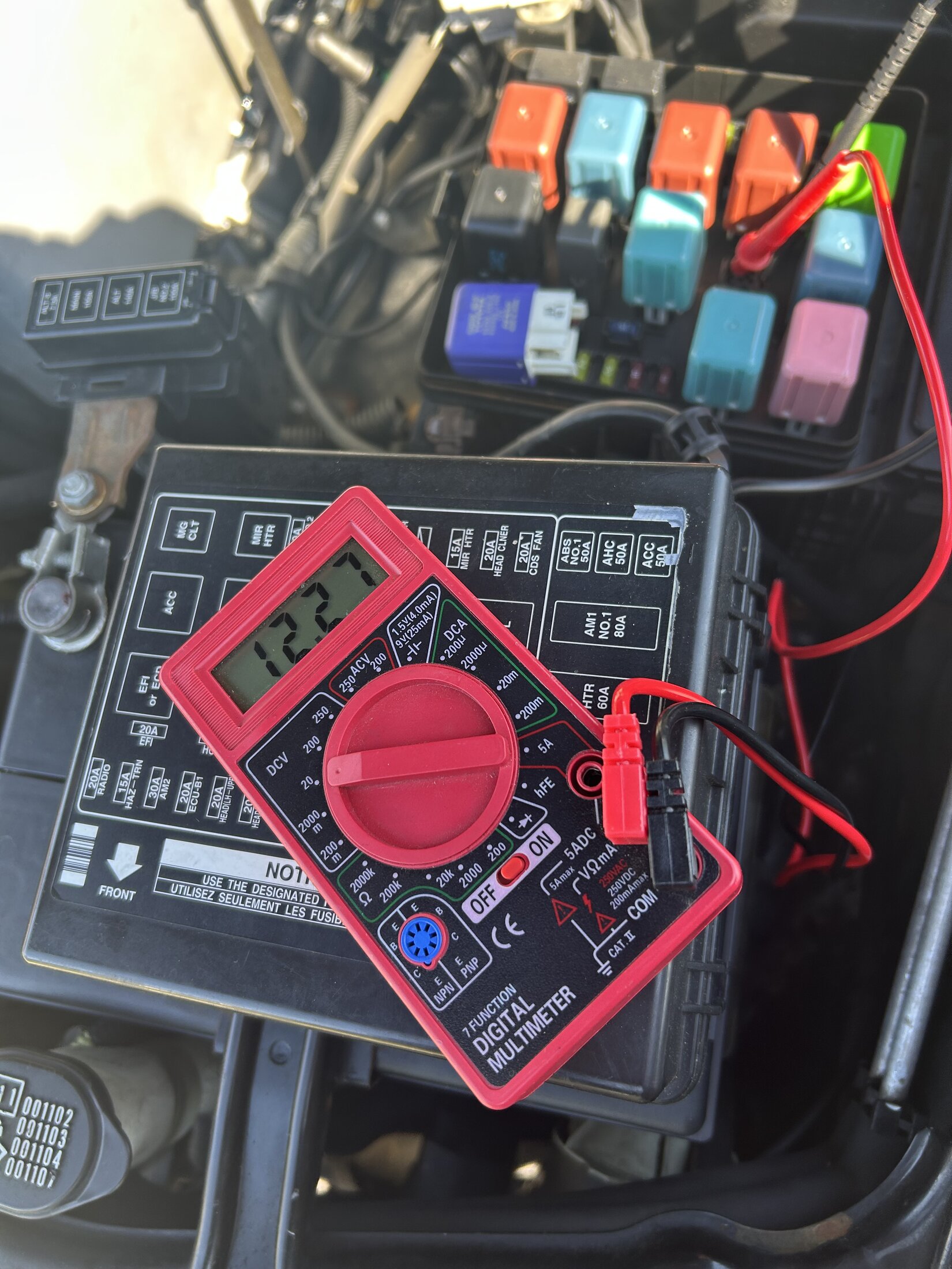

I also checked the voltage at the starter relay and got this reading:
Does this mean the fuse box most likely is not the problem and that kit being sold on here will help?

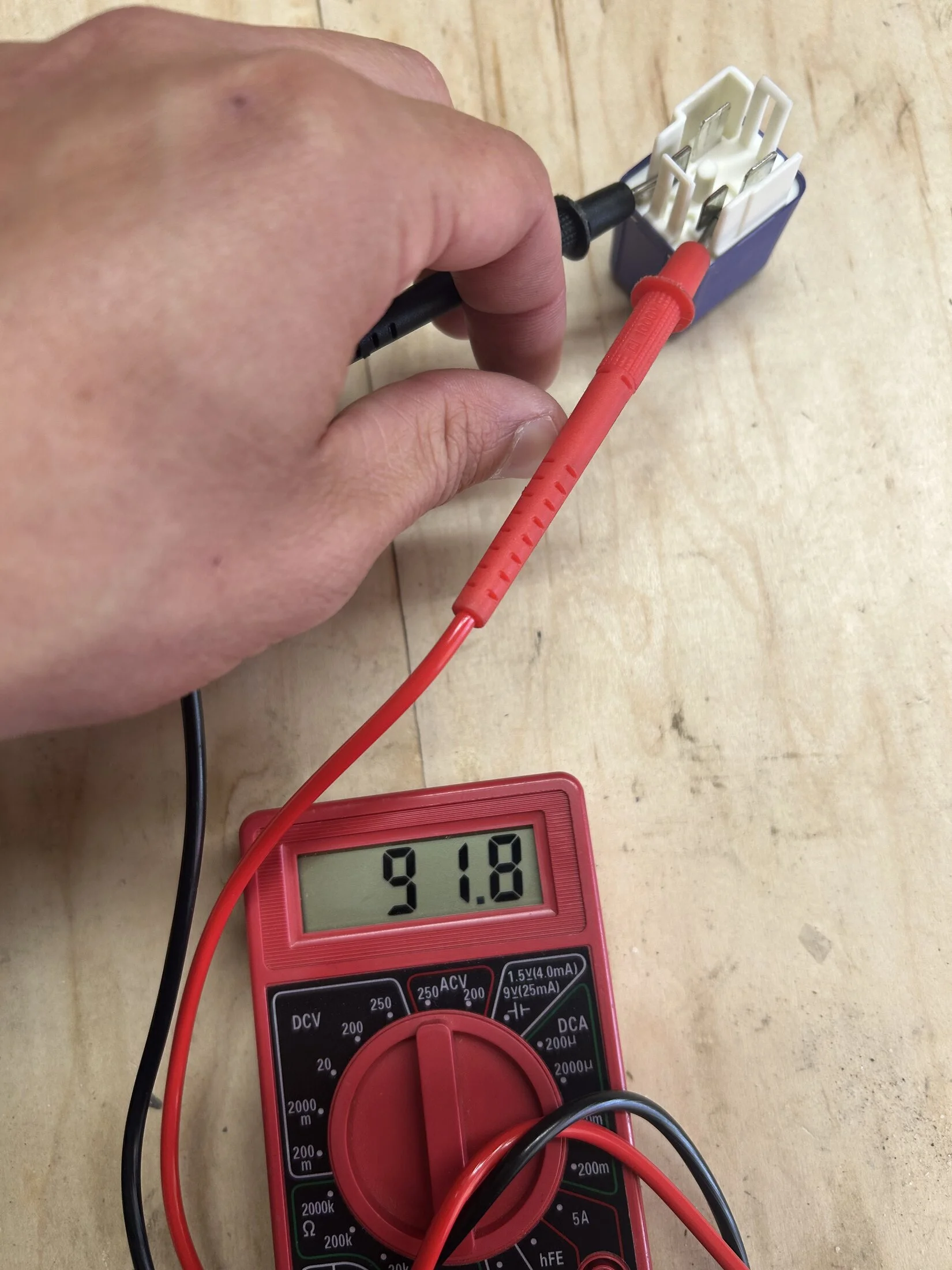

I got the EFI relay out. Very sung and the connections in the fuse box looked clean.
The relay passed the OHM test at 73. The prongs looked good too.

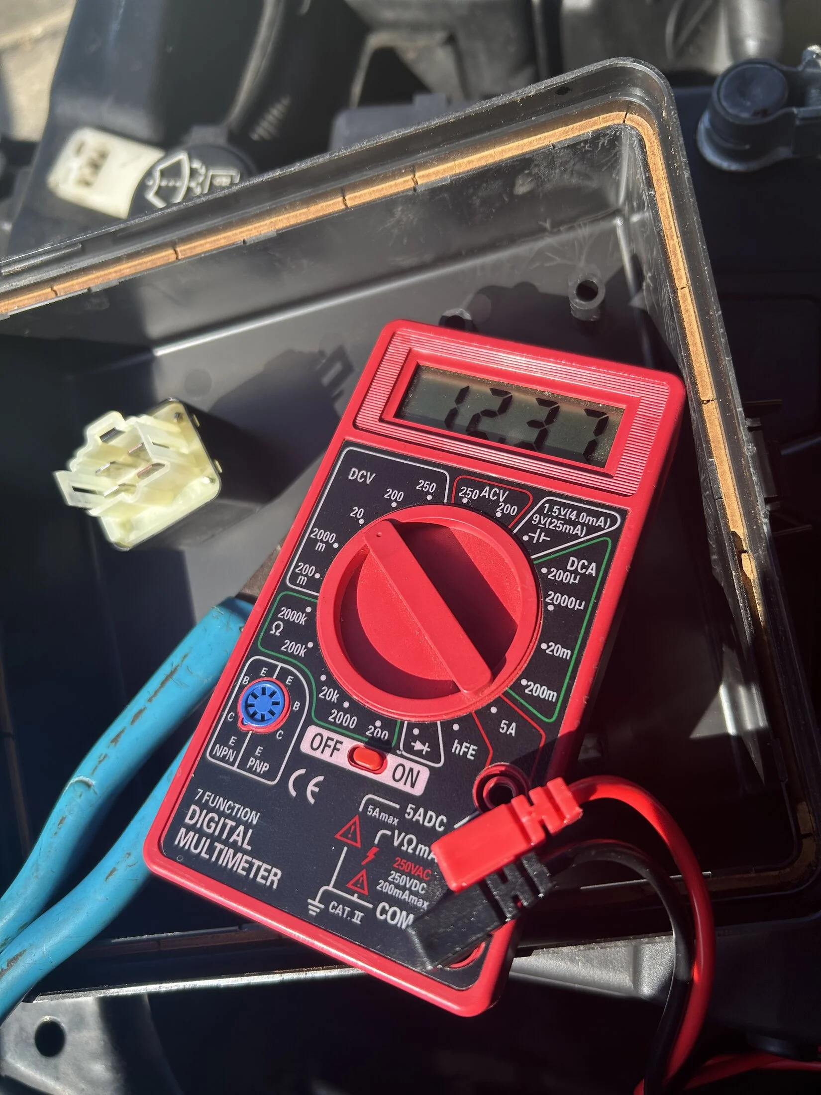

Here is the voltage at the EFI relay connection in the fuse box
These were the main things it sounded like I needed to be worried about and everything seems to check out.
