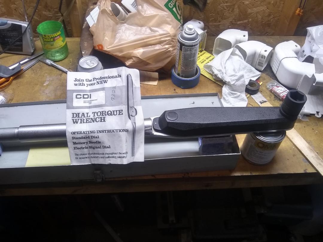

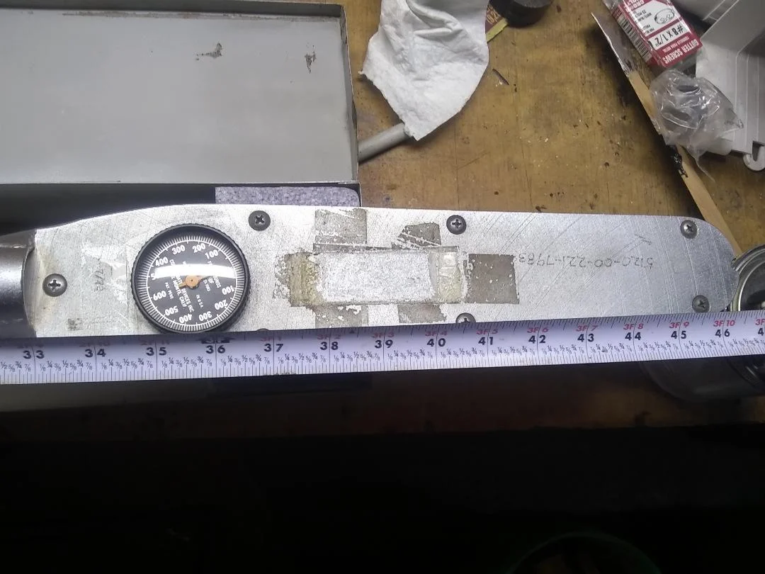

I also get to use this bad boy!!! 305 foot lbs! Lets go!!!

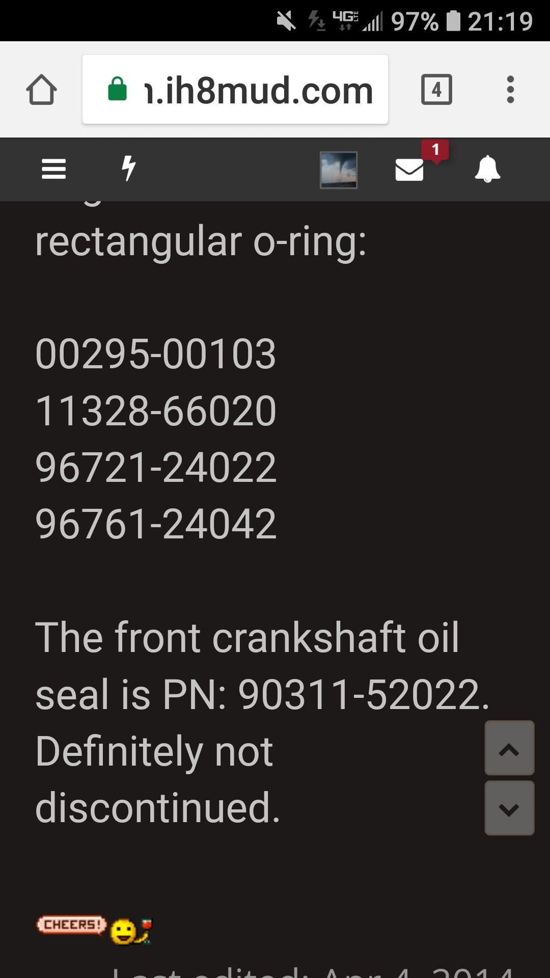

Where did you source the part? Per my search the oem front crank seal is discontinued. Thanks!

That's a helluva nice torque wrench! You buy that specifically for this job?
