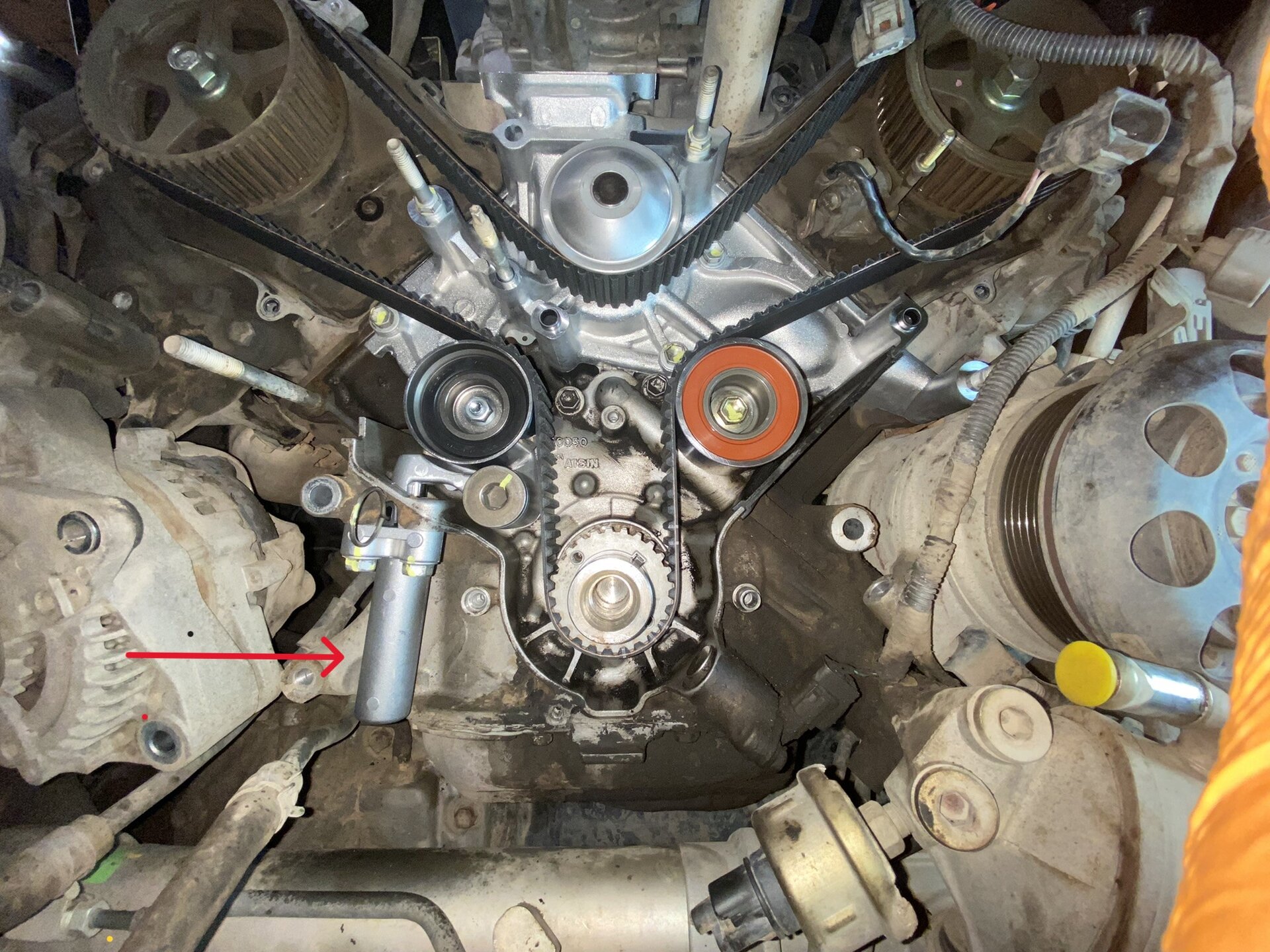

Few things to look at first:

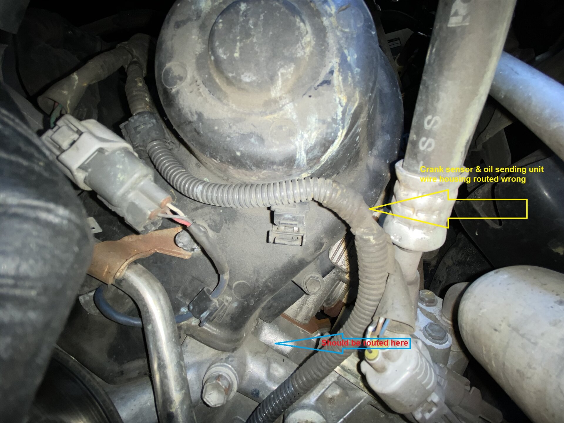

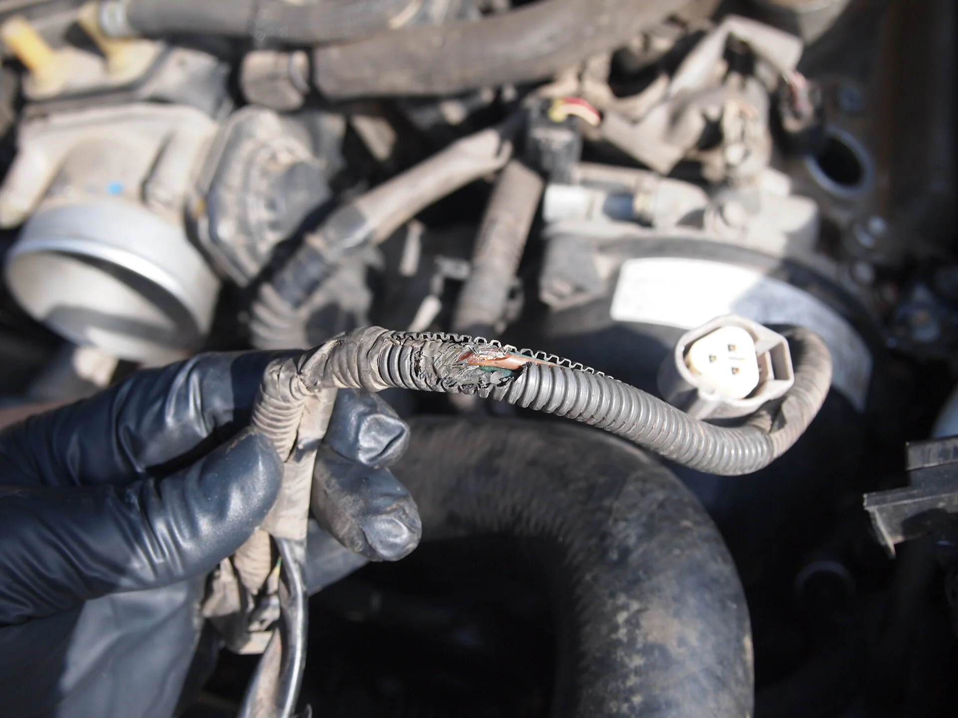

  1. Crankshaft sensor & oil sending unit wire, routing. If routed wrong you'll see in run down in front fan bracket of BK1. This can rub on belt and pulleys, resulting in a short.

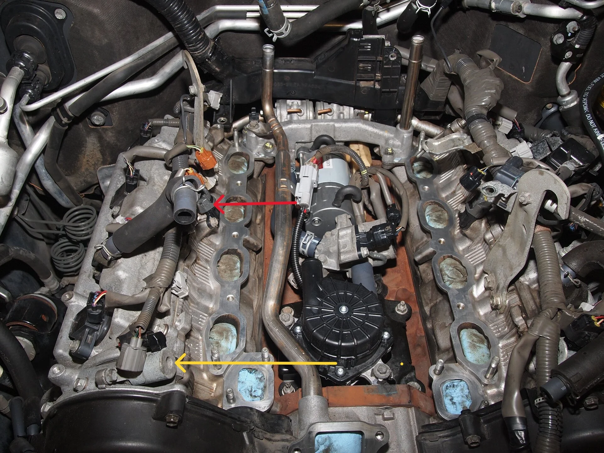

  2. Look at Bk2 Cam sensor and VVT control valve and their wires. Make sure they're properly attached to head and wires look good.
  3. Check oil and make sure last oil change was in 5W-30 best. You can vary a bit on weight. You may have issue with VVT controller valve or actuator, due to oil pressure.
  4. Look at timing belt tension, make sure bolts in taught.
Going much further than this, when you 're taking to mechanic anyway. May be to technical and or waste of time. IDK, you tell use.
T-belt Tensioner red
BK2 Cam sensor VVT red, VVT control valve yellow.
